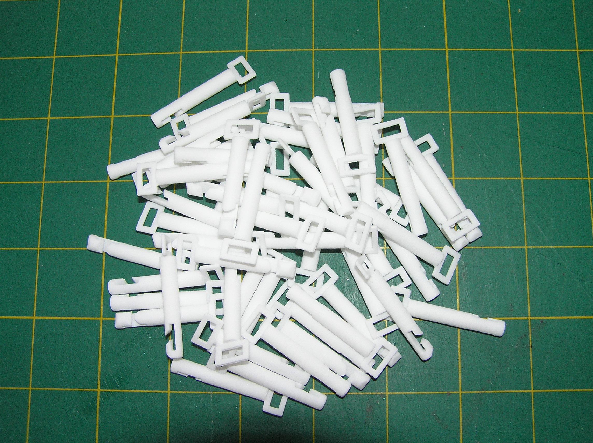

Gone West Posted February 7, 2019 Author Share Posted February 7, 2019 As an update, I had 54 hooks printed in white nylon by 3DPRINTUK, mentioned by @Temp . I am very pleased with the result. The whole process was completely painless as they keep you informed about your order and the price was reasonable. 5 Link to comment Share on other sites More sharing options...

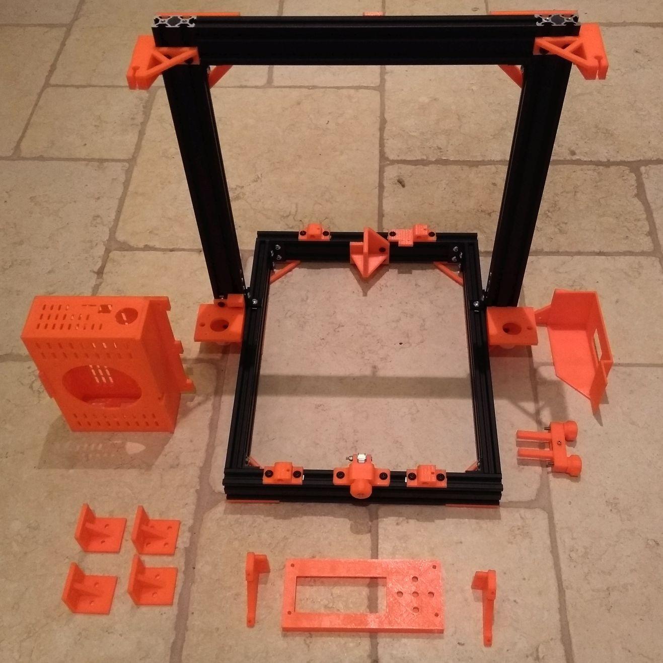

Temp Posted February 21, 2019 Share Posted February 21, 2019 Update: I've now almost finished printing all the parts needed to upgrade my cheap Anet A8 to a metal frame. The log on the printer says it's taken about 65 hours of printing time!! Not sure I believe it. That might be the total time I've had the printer on? Still it wont be much different as I don't leave it ON when not actually being used. I've gradually learnt how to speed up the printing process but this is clearly the big issue for 3D printing. If you are "time poor" then a faster printer would definitely be a better purchase. The box on the left for the control electronics was meant to be printed in two parts, a 5 sided box and the lid with hole for a fan. The main part should have taken 9 hours to print. In an attempt to print it faster (6 hours) I turned up the speed too much and had issues with the stepper motor skipping after about 2 hours. Second attempt also failed at a slightly slower speed. In the end I decided to salvaged the back from one failed print and broke the rest of the box down into 4 separate sides in Fusion 360 and printed each separately, then super glued them together. Most of the parts are from this design https://www.thingiverse.com/thing:2263216 but I took parts from several other designs (the belt tensioners, electronics case, LCD mounting brackets, PSU cover) as people have improved these elements since the original was published. Think I have one more part to print before I tear down the original printer and transfer over all the rest of the stuff. 4 Link to comment Share on other sites More sharing options...

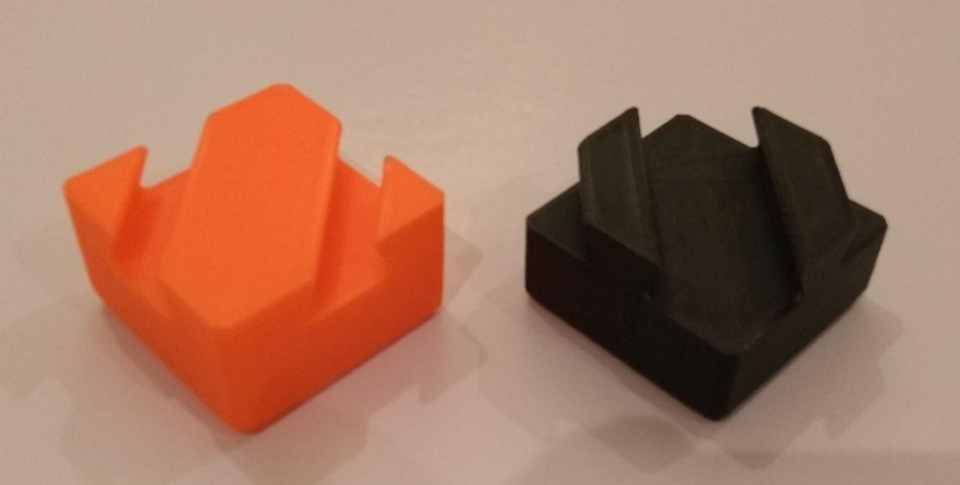

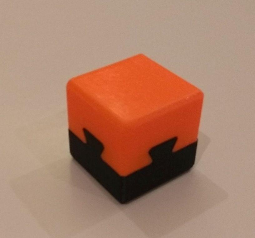

Temp Posted February 21, 2019 Share Posted February 21, 2019 Not sure if it will make it more accurate. It should help remove some artifacts like ripples from some surfaces and make bed levelling easier. Already managed to print this "impossible dovetail" which most woodworkers will be familiar with. I drew it up in fusion 360 and the clearance between the two parts is 0.2mm (as drawn). The two parts were printed separately (change of filament between) and slide together easily but not too easily. Sorry my photos are a bit out of focus it's my cheap phone. Link to comment Share on other sites More sharing options...
Ed Davies Posted February 21, 2019 Share Posted February 21, 2019 26 minutes ago, Temp said: to upgrade my cheap Anet A8 to a metal frame. Does that use printed connectors between off-the-shelf metal parts? Standard extrusions cut to length? Anything else done to the metal, like drilling a few holes? Link to comment Share on other sites More sharing options...
Temp Posted February 21, 2019 Share Posted February 21, 2019 I got a metal work kit from here http://www.ratrig.com/ . It included standard "2040" (20mm x 40mm) extrusions (cut to length), some metal L shape corner brackets, and a bag of allen key head bolts and "T" nuts. The two vertical extrusions came with the holes at the bottom end already tapped M5 (which I was expecting I would have to do myself). No other holes or processing is needed anywhere. Each joint between extrusions has at least one L shape metal bracket and one printed plastic bracket. You might be able to omit some of the plastic corner brackets but they have alignment ridges that help keep everything square even if the metal bracket is probably providing 90% of the strength. It seems there is a whole sub culture out there of people rolling their own 3D printer and CNC machines. If you know what you are doing you can buy partial kits containing a controller and stepper motors from Amazon and roll your own frame, rails and linear bearings etc. Most 3D printers seem to use the same standard heater block and nozzle also available on Amazon. Have a browse around that Ratrig site and you can find several different frame styles, some of which are intended as upgrades or to roll your own. I'm still exploring Fusion 360 but I'm amazed how powerful this software is and its free for home use. 1 Link to comment Share on other sites More sharing options...

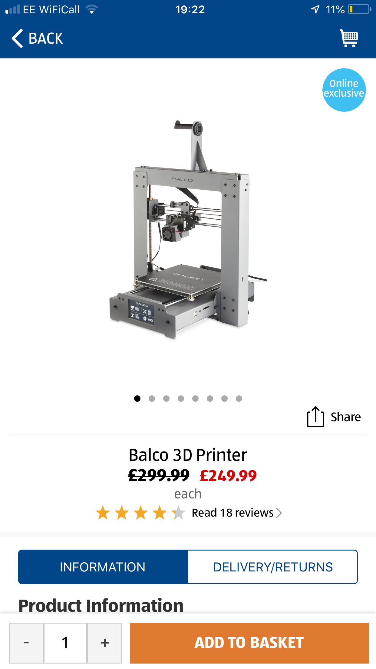

Sue B Posted February 22, 2019 Share Posted February 22, 2019 This just came up on my phone. Crikey - I had no idea they were so cheap. I presume this is basement bucket end of the market. Link to comment Share on other sites More sharing options...

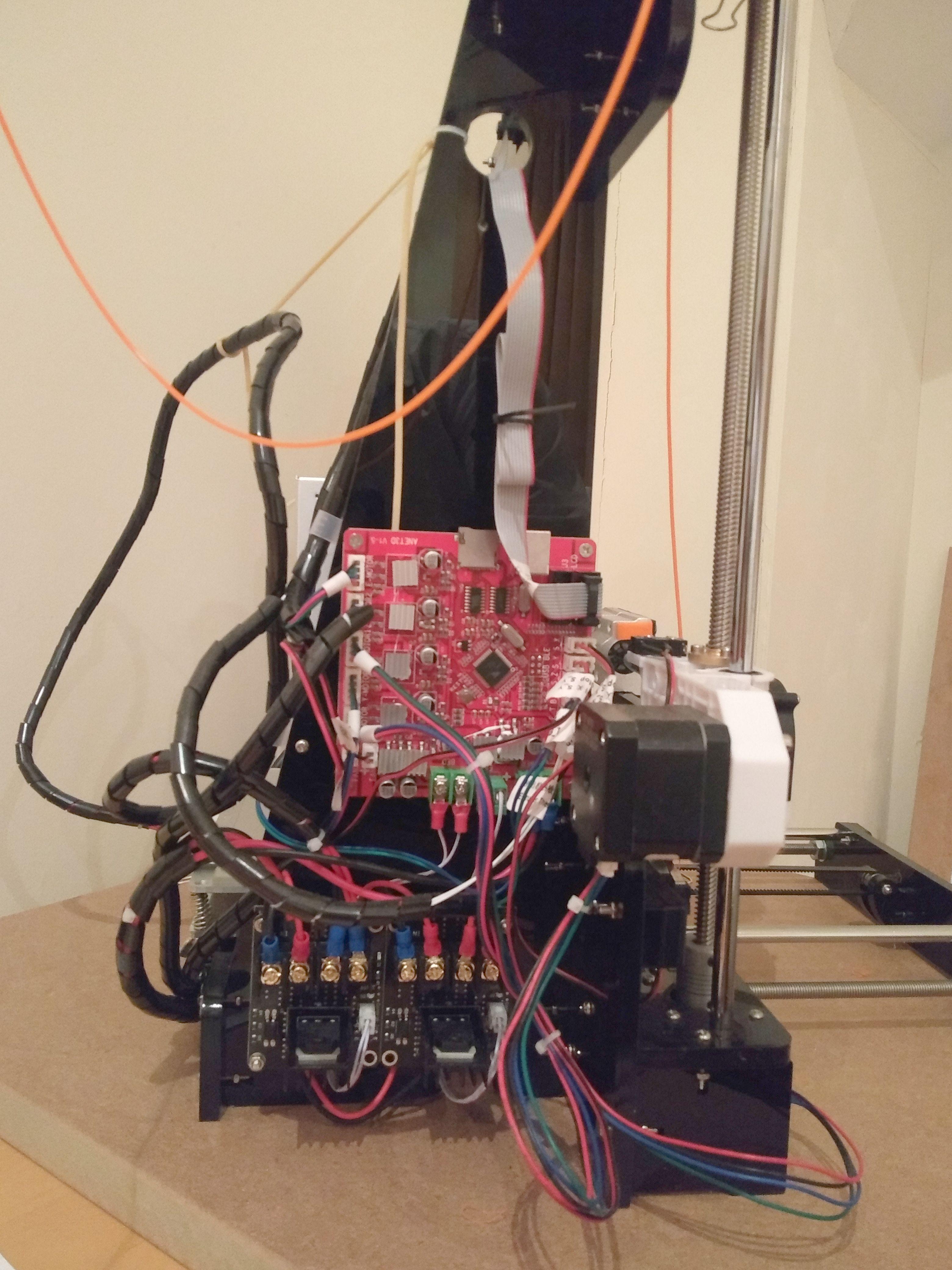

Temp Posted February 22, 2019 Share Posted February 22, 2019 Just for info, here is a side view of my A8 showing the electronics. The red PCB is the Arduino based controller, two little boards at the bottom left are the MOSFET upgrade boards to drive the bed and nozzle heaters. Click to enlarge. Link to comment Share on other sites More sharing options...

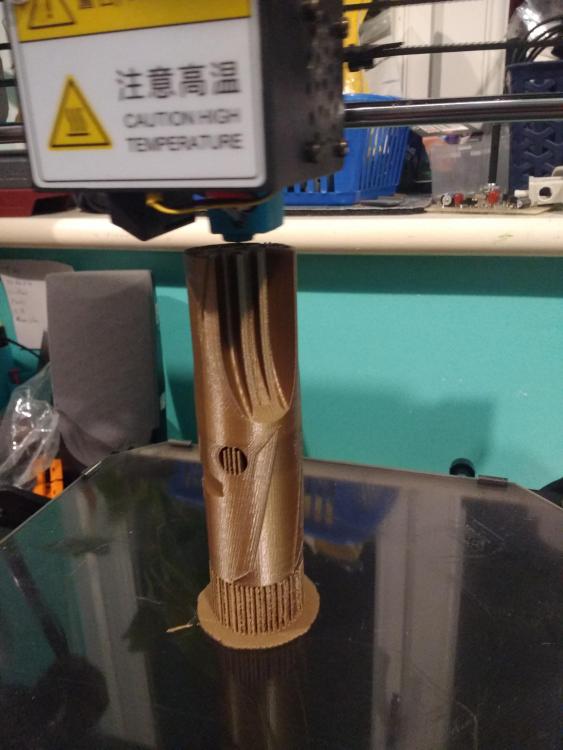

Temp Posted May 6, 2019 Share Posted May 6, 2019 (edited) I've not tried to print ABS but I've heard it's difficult. Some people say you need to put the printer in a temperature controlled cabinet but not sure how essential that is. I've printed PLA, PLA+ and some samples of metal filled PLA. Don't like PLA+ as it seems to warp a lot. Any overhangs can curl up higher than the nozzle which can hit it later. The Antique Bronze filled PLA printed ok but straight off the printer it looks like brown plastic. Sanding it exposes the metal but the effect isn't as good as I had hoped. Apparently putting prints in a rock tumbler with brass nuts improves the finish so I'm going to try that. The iron filled PLA isn't very impressive either straight off the printer. It's rather grey. It does stick to a magnet though. I plan to try rusting it to get an aged look. Be prepared for a steep learning curve. I still struggle to get some things to print. The first layer is frequently the problem. I've got a glass plate to make the bed dead flat and have tried hairspray, prittstick and blue painters tape on the bed. These are the three main things people recommend to improve adhesion. Blue tape seems to work best for me. One thing I had to learn was how to design parts so you don't need supports. Sometimes it's just faster or necessary to cut something in two in CAD, print both parts and super glue them together. Will try to post some photos when I get home. Edited May 6, 2019 by Temp 1 Link to comment Share on other sites More sharing options...
