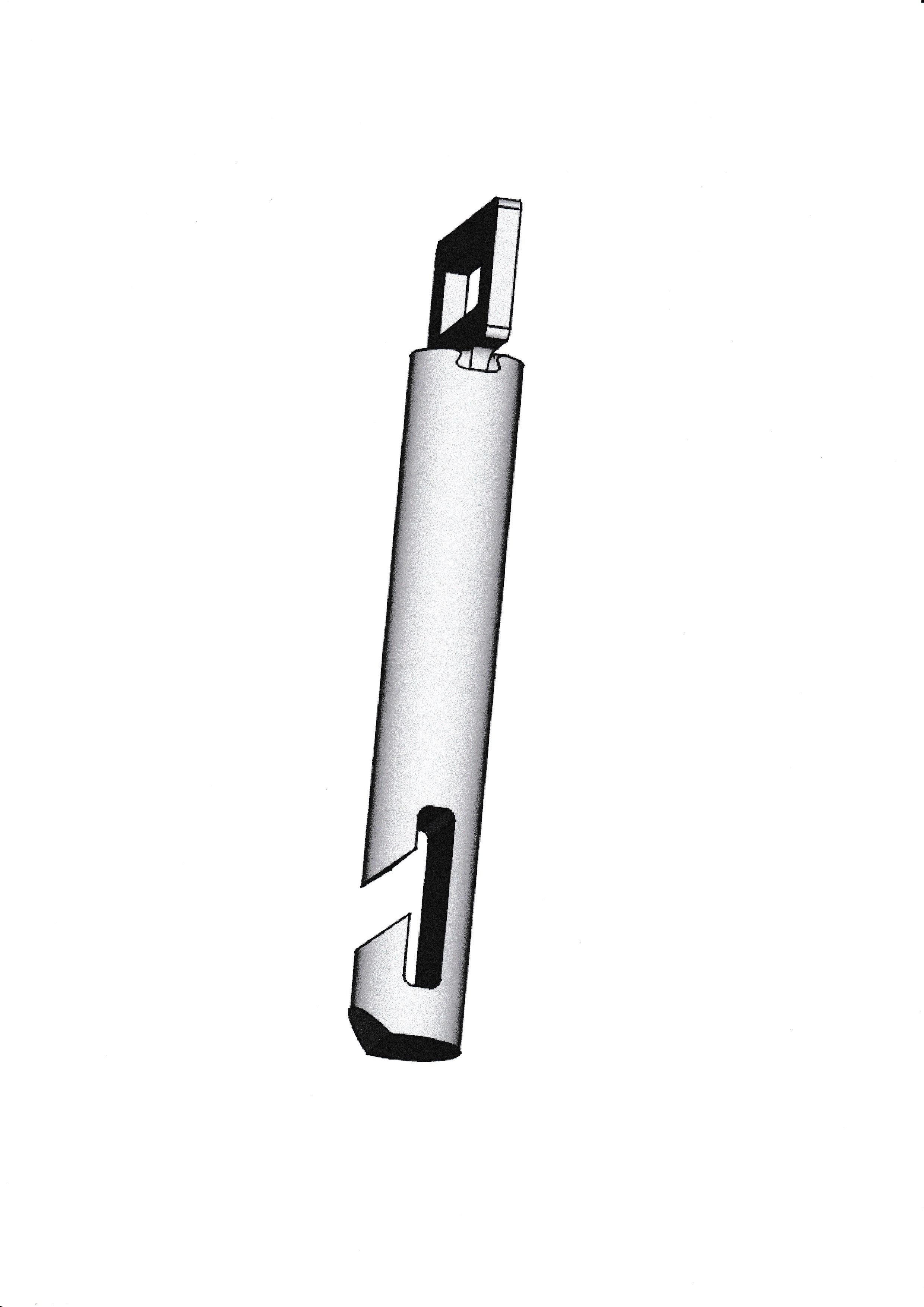

Gone West Posted January 18, 2019 Share Posted January 18, 2019 It's all in the title really. I may want to have around fifty small plastic hook and eye pieces made and I wondered if it was an easy process to get it done. Link to comment Share on other sites More sharing options...

Onoff Posted January 19, 2019 Share Posted January 19, 2019 @PeterStarck, I presume you've already done the model for these parts and produced the STL file? What material were you thinking? Link to comment Share on other sites More sharing options...
Gone West Posted January 19, 2019 Author Share Posted January 19, 2019 @Onoff No I haven't done anything yet. I was trying to gauge how straightforward it would be to have them made and what the cost would be. The item is a small extension piece for the top of a vertical blind to allow it to be used on a steep slope. I was thinking possibly ASA as there might be a lot of UV degradation. Link to comment Share on other sites More sharing options...
Temp Posted January 19, 2019 Share Posted January 19, 2019 (edited) ASA looks like the right material to use. Rigid.ink says it has good UV resistance. As I understand it the design software (the slicer?) will tell you how long the print will take and how much material it needs. I expect they charge by the hour. I doubt the material will cost much. Whole 1kg reel is about £25. Edited January 19, 2019 by Temp 1 Link to comment Share on other sites More sharing options...
Temp Posted January 19, 2019 Share Posted January 19, 2019 (edited) Googling 3d printing services finds loads but to get a quote most want to upload your design. However I found this place that will estimate cost based on dimensions before you have the design files... https://www.3dprint-uk.co.uk/pricing/ I tried entering 20mm x 10mm x 5mm, 2 bodies (whatever that is), qty 10, white nylon and it said £40. Edited January 19, 2019 by Temp 1 Link to comment Share on other sites More sharing options...

Gone West Posted January 24, 2019 Author Share Posted January 24, 2019 As an update I've created an .stl file and got an estimate from the site that @Temp linked to. It all seems straightforward. 1 Link to comment Share on other sites More sharing options...
