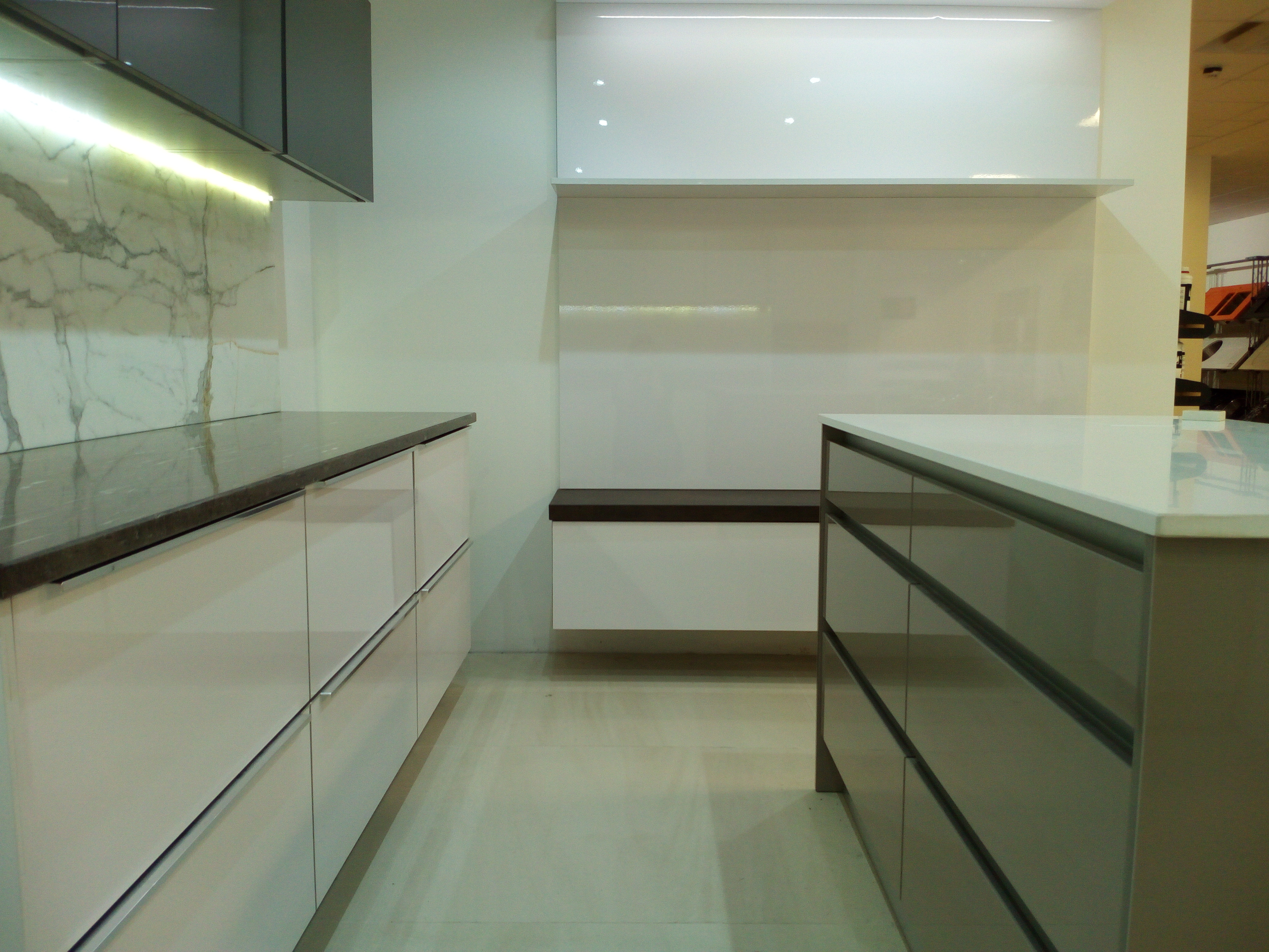

volcane Posted August 10, 2016 Share Posted August 10, 2016 The slimmer upstands look much nicer, even with the 30mm worktops. We likely will go thinner! (I also like the matt effect finish) Link to comment Share on other sites More sharing options...

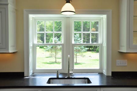

daiking Posted August 10, 2016 Share Posted August 10, 2016 Looking at that second photo, it might look nice not to have a window board and have the upstand continue up to the window on the 'sill'. Avoid that claggy gap between the worktop and the underside of the board. Link to comment Share on other sites More sharing options...

Shell820810 Posted August 10, 2016 Author Share Posted August 10, 2016 (edited) Yea that's an installed price. I think we have almost 9m2, we need 4 slabs. Just got another price of 3k for sinquastone 30mm to same spec. We have windows flush with worktop so sills and worktop is one piece which is putting the price up a bit. There's a bit of wastage. Example in photo. Easier to get window closed again when he opens it far to wide for my reach! Edited August 10, 2016 by Shell820810 Link to comment Share on other sites More sharing options...

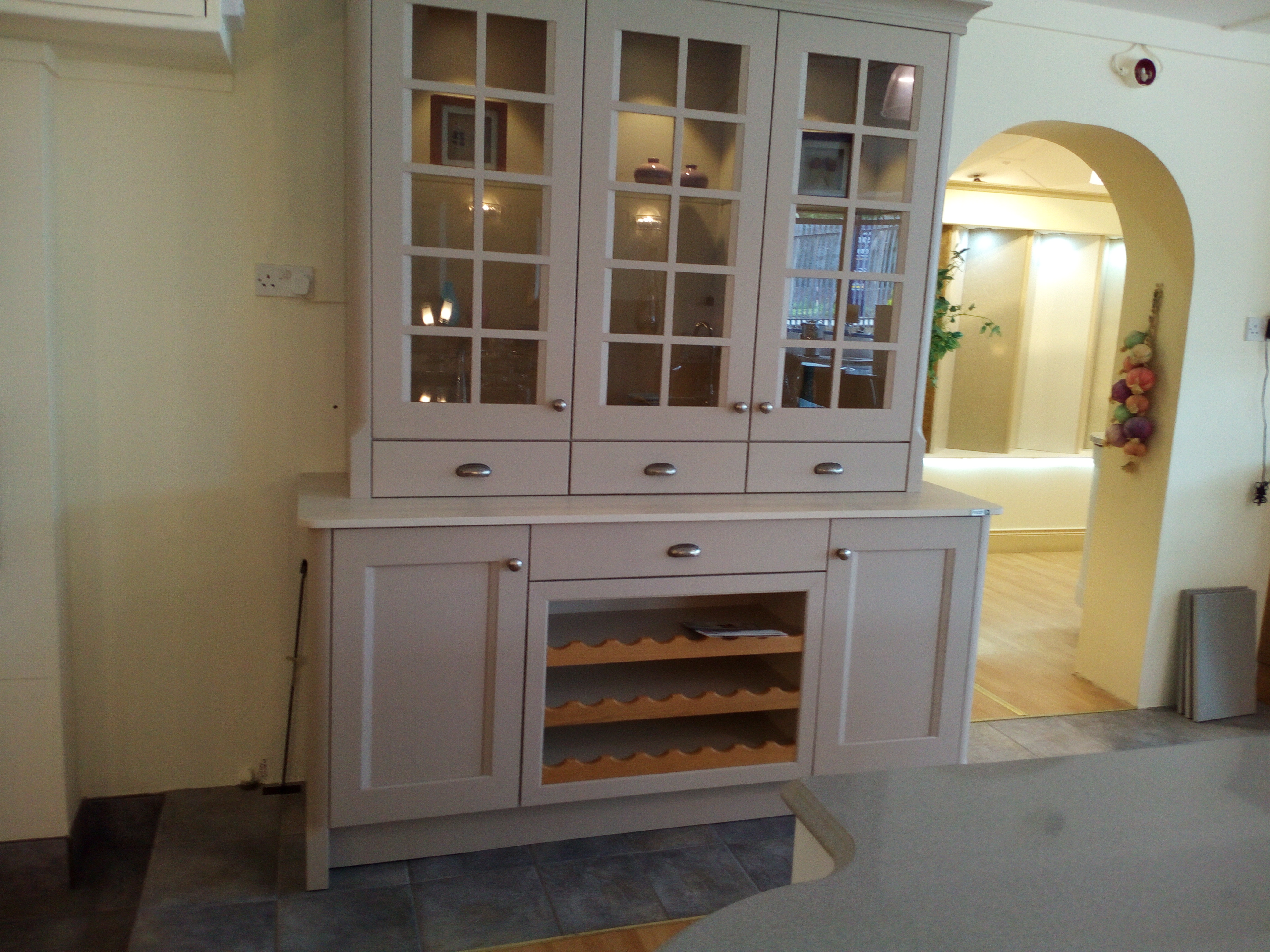

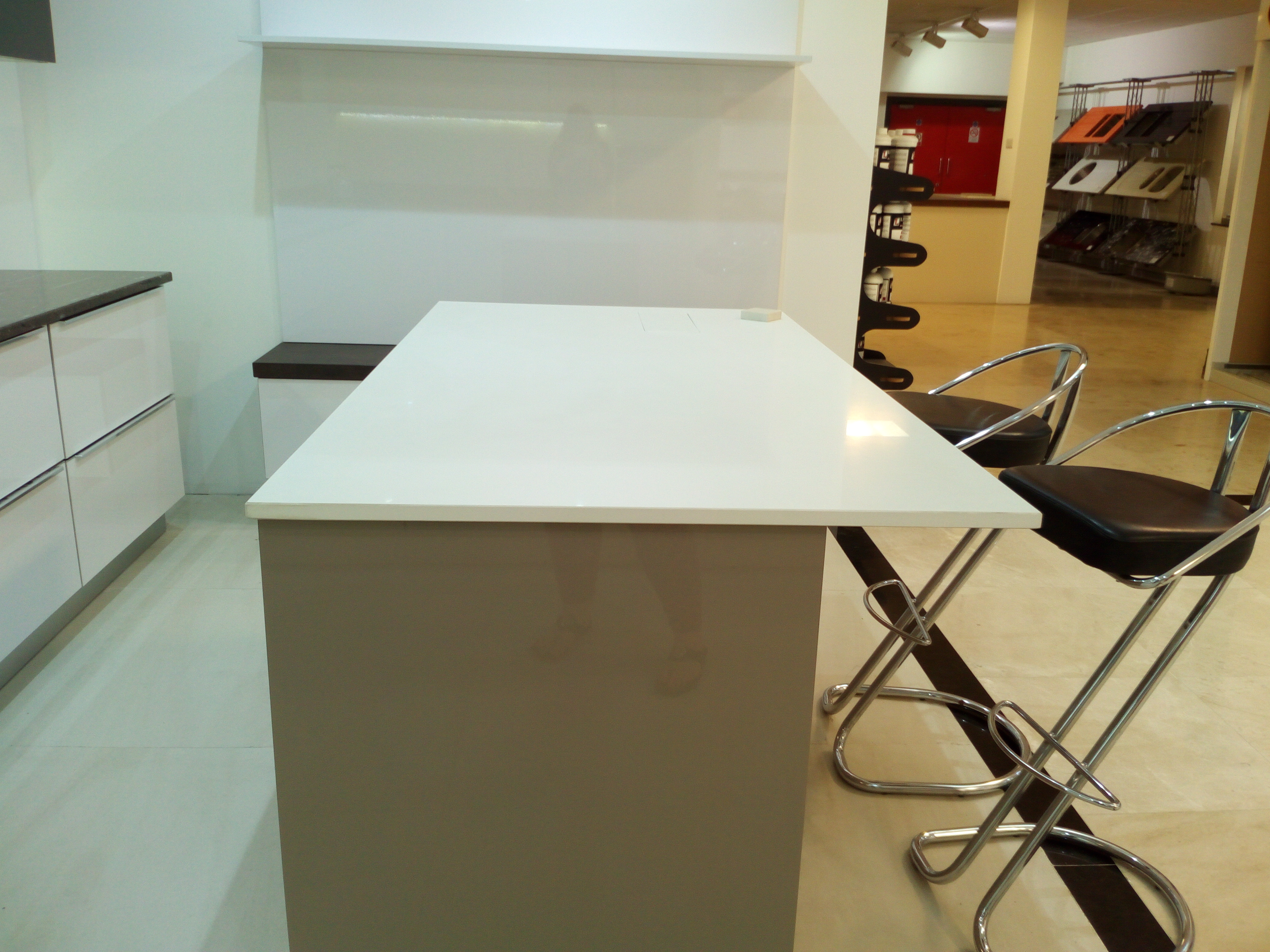

Shell820810 Posted August 11, 2016 Author Share Posted August 11, 2016 (edited) Went to a few showrooms today, we can get down to 2.5k with 20mm sinquastone. 300mm overhang is the max in 20mm. Below are two different 20mm worktops, one of which is next to a 30mm. I don't think in 3 months time I will notice the difference enough to warrant the £500 difference. It breaks my heart to put that kind of money into a worktop as it is, so I think this is somewhere we can claw back a bit. Edited August 11, 2016 by Shell820810 Link to comment Share on other sites More sharing options...
