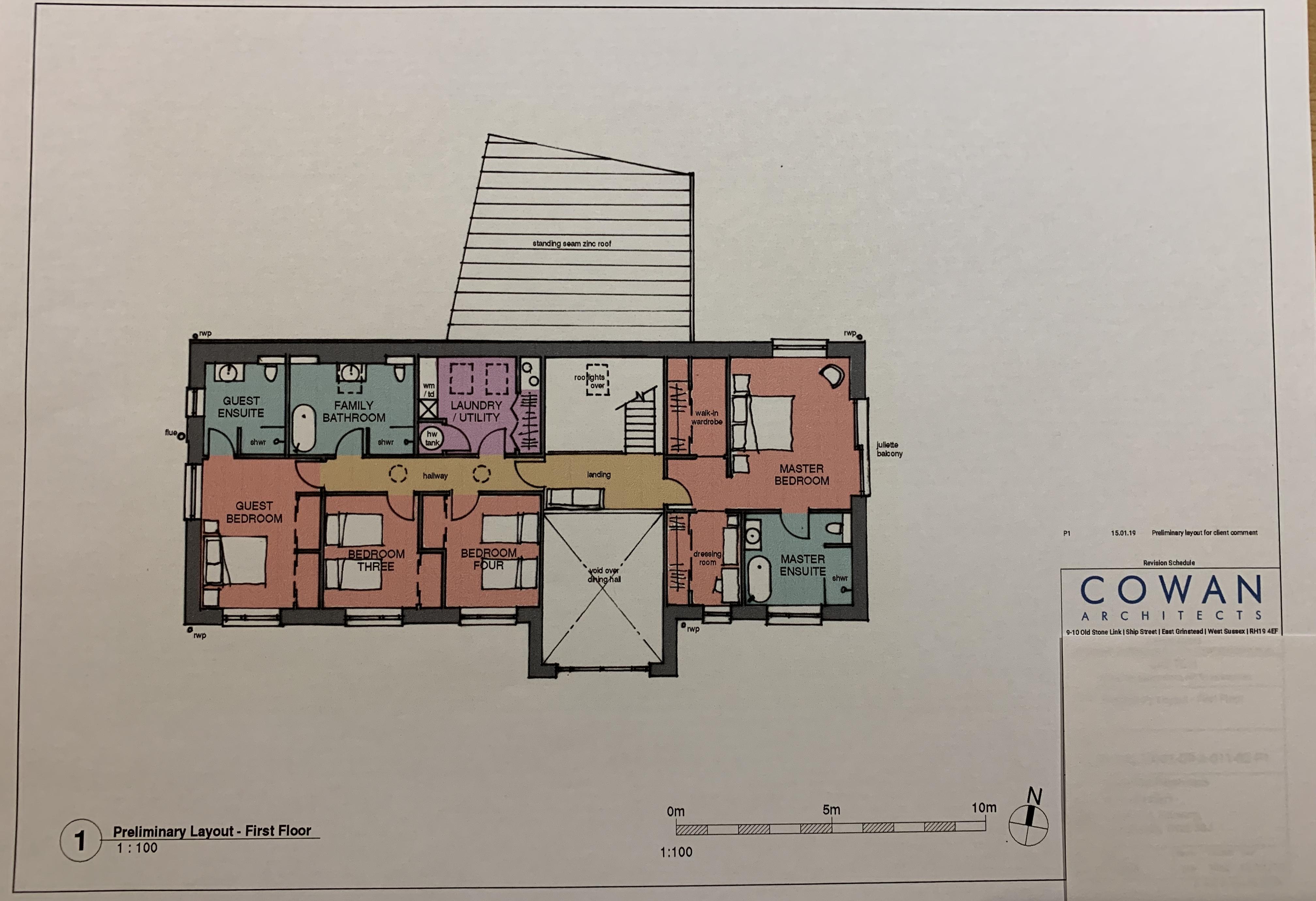

Robert Clark Posted January 16, 2019 Share Posted January 16, 2019 Hi Guys Have just received preliminary plans for our new build Passivhaus Any comments or suggestions would be appreciated Thanks Link to comment Share on other sites More sharing options...

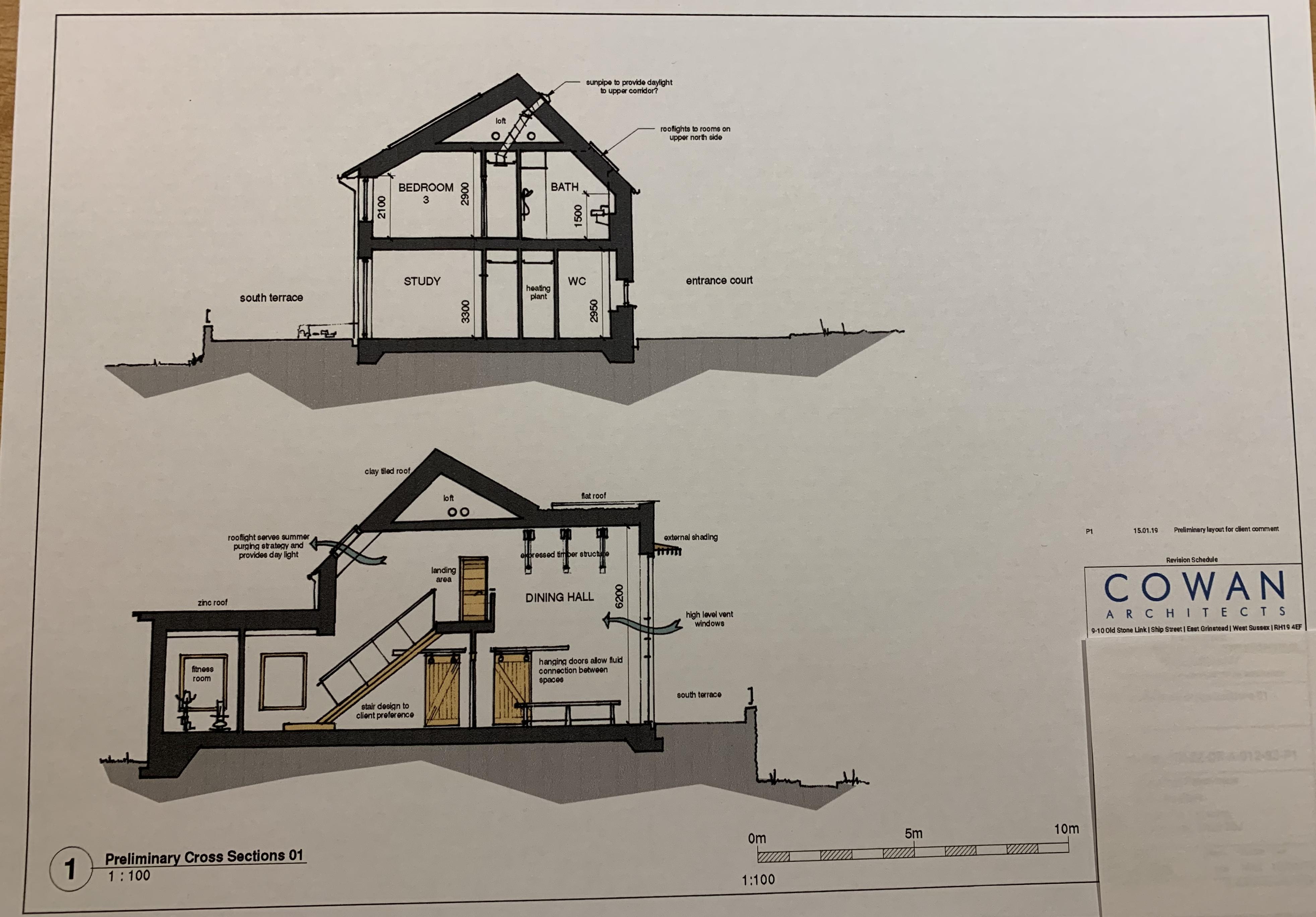

ToughButterCup Posted January 17, 2019 Share Posted January 17, 2019 Interesting. Looks very well thought through. First, compliments on the use of colour - makes the plan much easier to understand. Only one comment about the plan; consider changing the southern dressing room to a mezzanine ..... ? 1 Link to comment Share on other sites More sharing options...

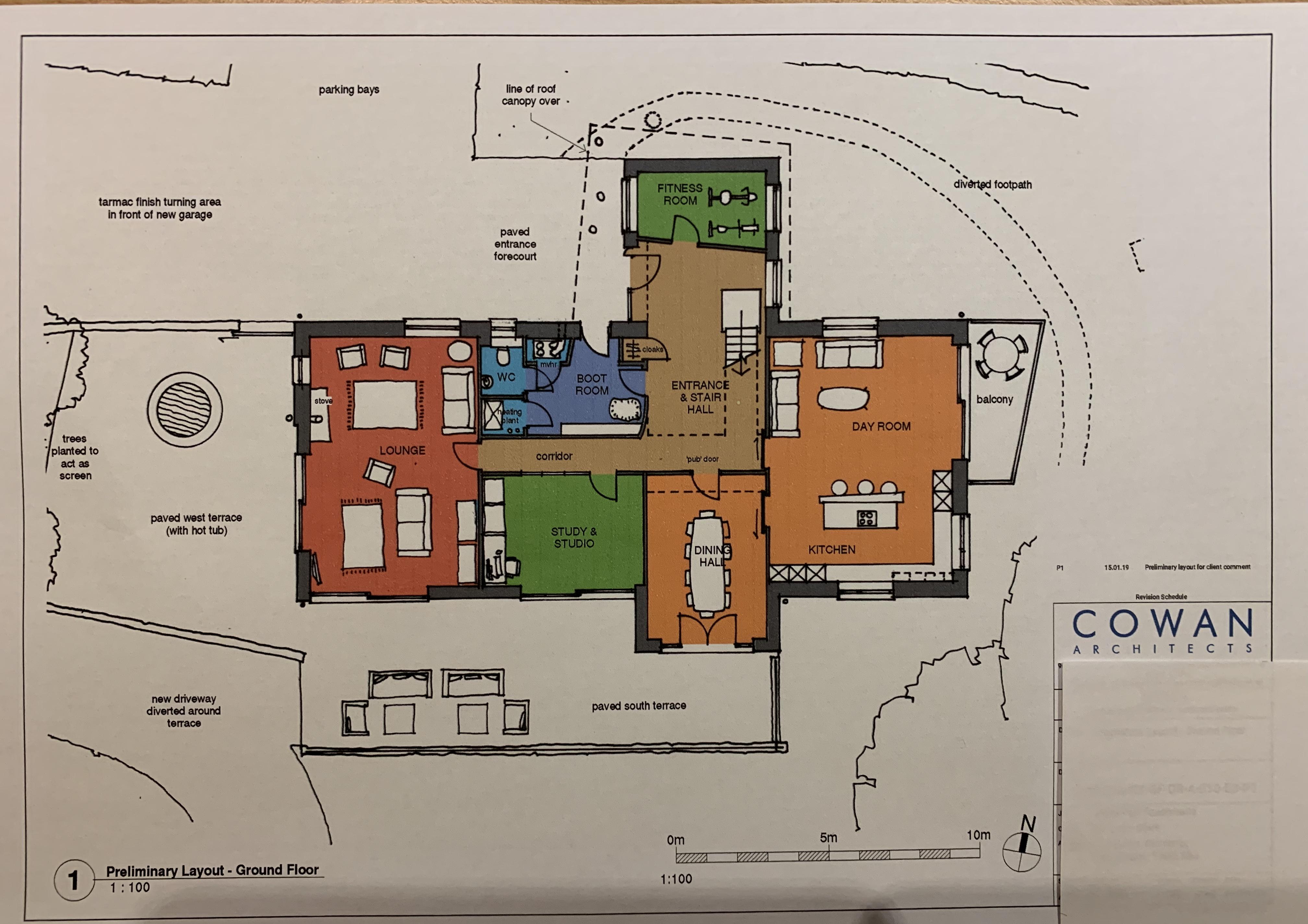

Mr Punter Posted January 17, 2019 Share Posted January 17, 2019 Very nice plans. I would be concerned with overheating and would want this modelled. The proposed overhang does not look like it will mitigate this. The lounge looks the most vulnerable. Hoping that is not a wood burning stove in the lounge as this is at odds with clean, modern living and if the house is properly insulated it would need to be minute to prevent overheating, even on a cold, cloudy day. 1 Link to comment Share on other sites More sharing options...
epsilonGreedy Posted January 17, 2019 Share Posted January 17, 2019 (edited) It would be useful to have the calculated internal floor area. The design incorporates some wow features with its baronial dining hall space and dedicated gym. I hope the internal gym wall will be mainly glazed to connect it with the hall area. I feel the kitchen is undersized for a property of this stature and the lack of a walk-in utility room and preferably a pantry is a major miss for me. I have some specific observations on the sitting room having lived in a property with a similar size room and with the internal door in the same position. The double focused furniture arrangement does not work and actually caused interpersonal schisms. I would loose 3ft of glazing on the west wall to allow the stove to be centered further south on that west wall as this will promote a central furniture arrangement. Have you and your architect experimented with larger eve overhangs? What about wide plank timber cladding? Have you or your architect lived in North America, I ask because there seem to be some design choices inspired through living in another culture. Edited January 17, 2019 by epsilonGreedy 1 Link to comment Share on other sites More sharing options...
Bitpipe Posted January 17, 2019 Share Posted January 17, 2019 Lovely house aesthetically but +1 on the WBS & solar overheating. Was snowing this morning and as I ran the hoover round in my t-shirt I was already feeling warm in our Passive standard house. UFH (ground floor only) has barely come on this winter at all. You have a massive south facing window in the dining hall which will make it very uncomfortable year round unless you use external blinds or apply a reflective film to the glass. On our build, purely by virtue of the plot orientation, we minimised south and north glazing. After a few months in an overheating caravan in the garden we specd external motorised shutters on the east windows (wall and roof) - omitted one south window in kitchen and in spring and autumn when the sun is low, it really heats up. West glazing is not as susceptible but still makes an impact in summer- we have internal lightweight drapes that reduce the effect but will probably build a bris soleil to give us a bit more shade. If your architect has considered these elements then it would be a bit of an alarm bell as to whether they understand the implications of building a well insulated, airtight home (whether passive standard or not). Get it modelled in PHPP or equivalent. 1 Link to comment Share on other sites More sharing options...

Alex C Posted January 17, 2019 Share Posted January 17, 2019 I have a passive spec house and agree with all the points made above by others that do as well. Your architect may be qualified to design a passive house but if he dosn't actually live in one he may not fully appreciate things like the risk of overheating from sun and fires. There is no way you will ever use a log burner. Your south facing double height glazing will massively overheat the room. The brise soleil as drawn will do nothing except for a couple of weeks around the longest day when the sun is really high in the sky. A normal rule of thumb with brise soleil is to make them protrude from the build by half the height of the glass they are shading. Even this would have overheating issues in spring and autumn. You have quite a good roof overhang on the south side to shade bedroom windows in mid summer, this will be helped more if you recess the windows well back into the wall. Even so the bedrooms are likely to overheat without any external shading. External venetian blinds as used by others on this forum and also myself are not an expensive luxury but a necesity in a passive house with lots of glazing. I would also worry about your lounge cooking in the evening late summer sun Bed three and four will have a real issue as there is no cross ventilation in these rooms to purge at night . I assume windows on master and guest open on north and south elevation to provide cross ventilation? My experience is that night purging with a large roof light works really well in an open plan house, but useless if it isnt open plan or you shot your doors. I would also suggest getting rid of the sun tunnels. You have. passive spec house, then are making 14" holes in it with an uninsulated tube. Budget for some quality light fittings instead. I would suggest that for such a grand house the corridor on ground floor is way too narrow. I think it is also a massive mistake to make your dinner party guests leave the grand dining hall and squeeze past your muddy boots to take a pee. Generally I think it looks a really interesting build and I'm sure will be a lovely place to live. 1 Link to comment Share on other sites More sharing options...

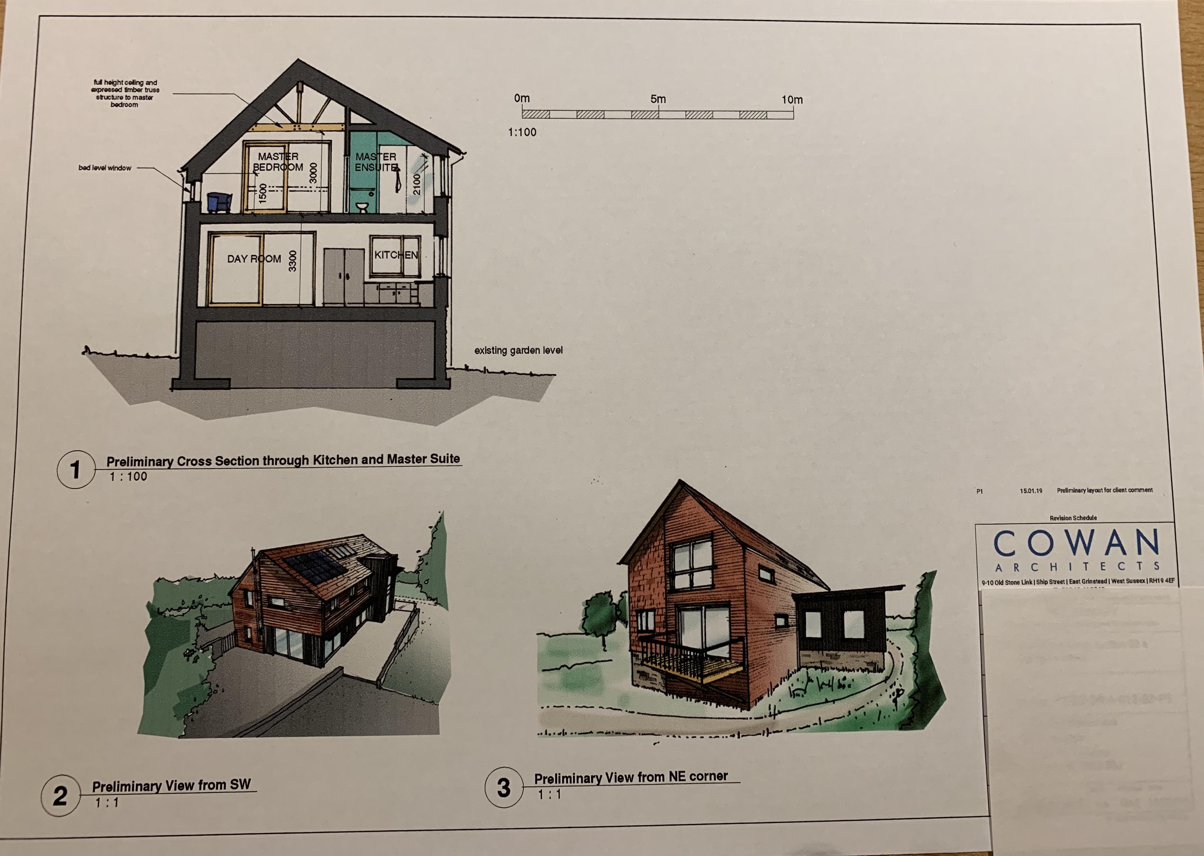

Alex C Posted January 17, 2019 Share Posted January 17, 2019 A thought on your cladding. I looked extensively into using charred timer. The black charring will wash off over time and the timber will silver. This may be good or bad but don't think your house will stay looking a nice solid black colour. As an example look at the grand designs house of the year beside the loch. It is no longer black at all as all the charring clearly got washed off by the rain. 1 Link to comment Share on other sites More sharing options...

ProDave Posted January 17, 2019 Share Posted January 17, 2019 I share the stove concerns. That lounge would overheat very quickly. We do have a stove and we do use it, but our kitchen / diner (similar size to your lounge) opens with double doors straight to the stairwell, then double doors the other side to the lounge. With all doors open it is pretty much the whole ground floor open, and a stairwell to let heat upstairs. Like this with everything open, the stove can be used carefully. But in your lounge, with little obvious route for it to heat the whole house, I think you would kust overheat that room very quickly indeed. 1 Link to comment Share on other sites More sharing options...

Alex C Posted January 17, 2019 Share Posted January 17, 2019 I designed my own passive spec house to have at least 2 opening windows on different elevations in each room (but only 1 in my office as it has rooms on both sides) and also with 2 large roof lights at the top of the open plan landing that open automatically at 25 degrees c. This makes purging heat in any room really easy as opening a window in the overheated room moves the heat outside in just a few minutes. There aren't that many times a year that opening a window at night dosen't cool a house down. This is all pretty standard stuff and is something any architect should be looking at doing in a new build. 1 Link to comment Share on other sites More sharing options...
