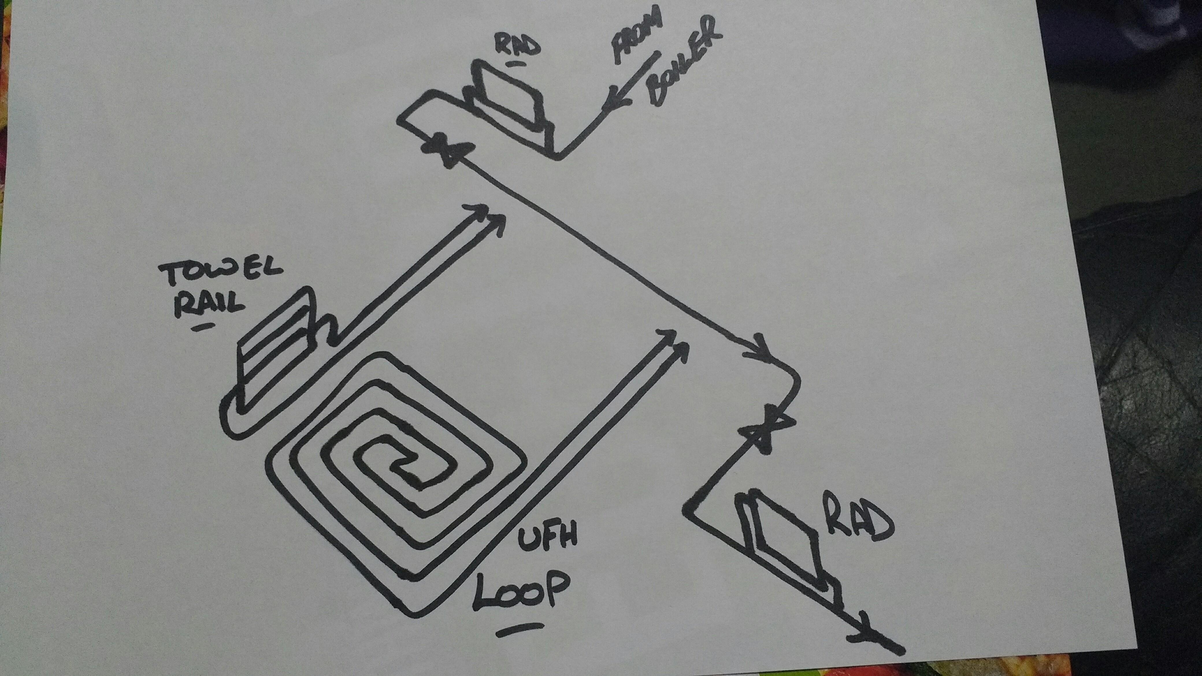

Onoff Posted January 6, 2021 Author Posted January 6, 2021 @JFDIY, ref your question on my other thread why I can't connect my bathroom up. In the bathroom I have a UFH loop and a towel rail both run in 16mm PEX-AL-PEX. The tails run out into the adjacent "stairs" room. Unconnected as yet! The stairs room floor is coming up and being dug down to have insulation underneath. The rough plan is to feed a buffer tank and have a UFH manifold in the stairs room. This manifold (pretty much central to the house) will feed out to UFH loops in other rooms. All I have in terms of an existing CH system to tap into is a 3/4" nominal bore, single pipe system, (so no flow and return). I've recently put a ball valve both ends of the run I'm going to tap into. Quite where I go from here is still up for discussion! ? If it was up to me I'd have dug the floor up/down by now but SWMBO vetoed it for the moment. Just sitting here on the vodka again and seriously wondering at the feasibility of digging down and having the buffer tank under the floor.....

JFDIY Posted January 7, 2021 Posted January 7, 2021 8 hours ago, Onoff said: @JFDIY In the bathroom I have a UFH loop and a towel rail both run in 16mm PEX-AL-PEX. The tails run out into the adjacent "stairs" room. Unconnected as yet! The stairs room floor is coming up and being dug down to have insulation underneath. The rough plan is to feed a buffer tank and have a UFH manifold in the stairs room. This manifold (pretty much central to the house) will feed out to UFH loops in other rooms. All I have in terms of an existing CH system to tap into is a 3/4" nominal bore, single pipe system, (so no flow and return). I've recently put a ball valve both ends of the run I'm going to tap into. Quite where I go from here is still up for discussion! ? Gosh, I'm confused by that lot, why can't you just tap back into the return and not have a buffer tank?
Gav_P Posted January 7, 2021 Posted January 7, 2021 35 minutes ago, JFDIY said: Gosh, I'm confused by that lot, why can't you just tap back into the return and not have a buffer tank? Exactly my thoughts... it’ll be fine for the time being and at least there will be heat in the bathroom. I guess the UFH will just need a blending valve and pump to make sure it doesn’t get too hot. 1
Onoff Posted January 7, 2021 Author Posted January 7, 2021 (edited) 1 hour ago, JFDIY said: Gosh, I'm confused by that lot, why can't you just tap back into the return and not have a buffer tank? How confused? A room with a towel rail in and a UFH loop under the floor. In the next room the old fashioned single pipe system passes across, buried in the floor. There is no return per se. The UFH loop would be too hot surely? Risk of cracking the floor tiles maybe? Edited January 7, 2021 by Onoff
JFDIY Posted January 7, 2021 Posted January 7, 2021 3 minutes ago, Onoff said: There is no return per se. The UFH loop would be too hot surely? Risk of cracking the floor tiles maybe? Bring a new return to the room, in Flexi if needed, tap towel rad in in regulated, then ufh manifold with blending valve and pump for the ufh, you'll need it when you do the rest anyway? Or grab a single zone one of eBay for now, you see used ones for under £100 quite often perhaps with more ports but they can be blanked
JFDIY Posted January 7, 2021 Posted January 7, 2021 Second thought can't you buy the pumpset and mixer you want long term, without manifold, then just connect it with a few fittings to the single zone, run it at low temp and turn the pump on with a timer or stat as required.

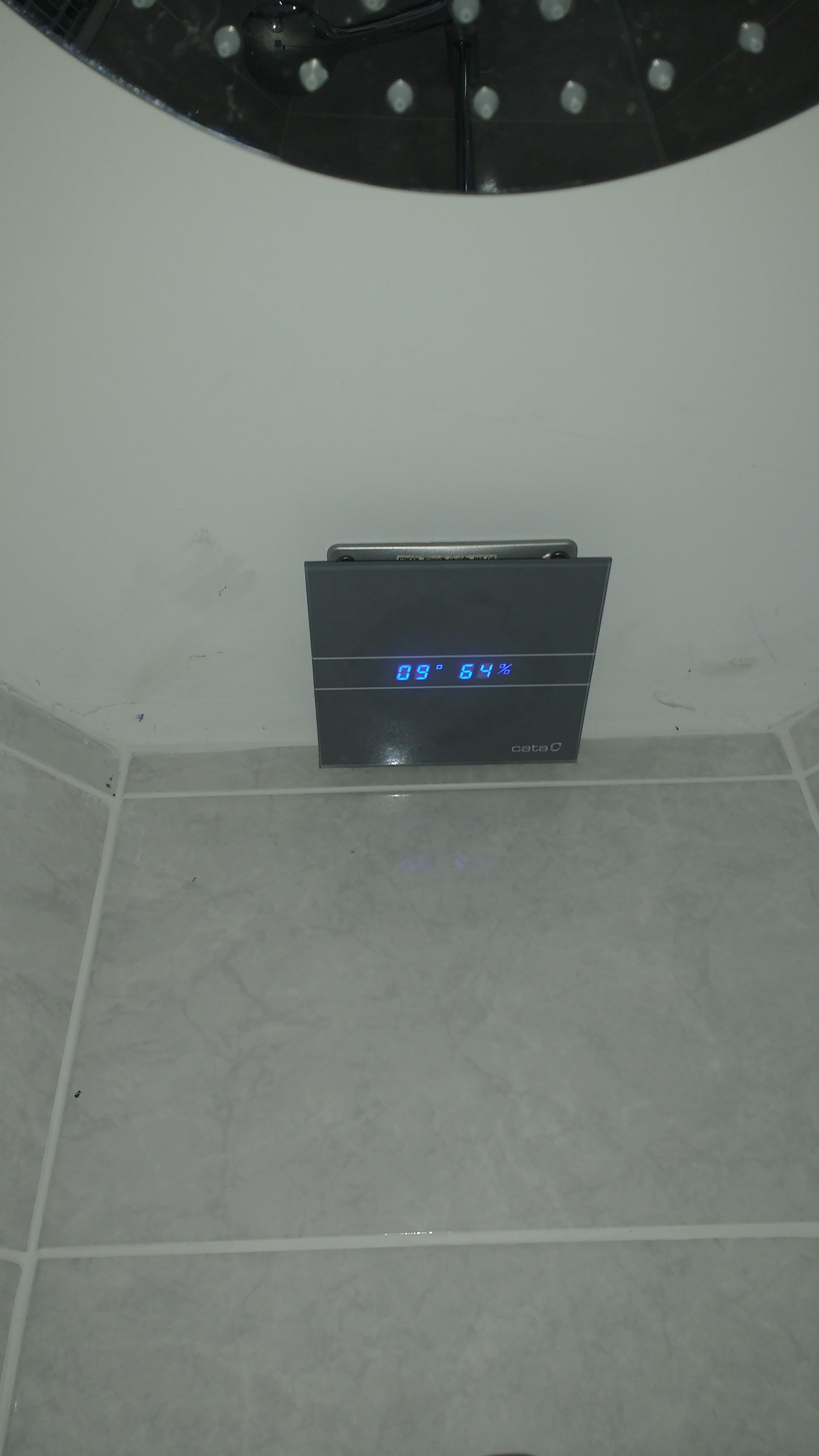

Onoff Posted January 8, 2021 Author Posted January 8, 2021 Nothing like coming in from work for a shower in a nice warm bathroom... apparently! ? 1 2 1

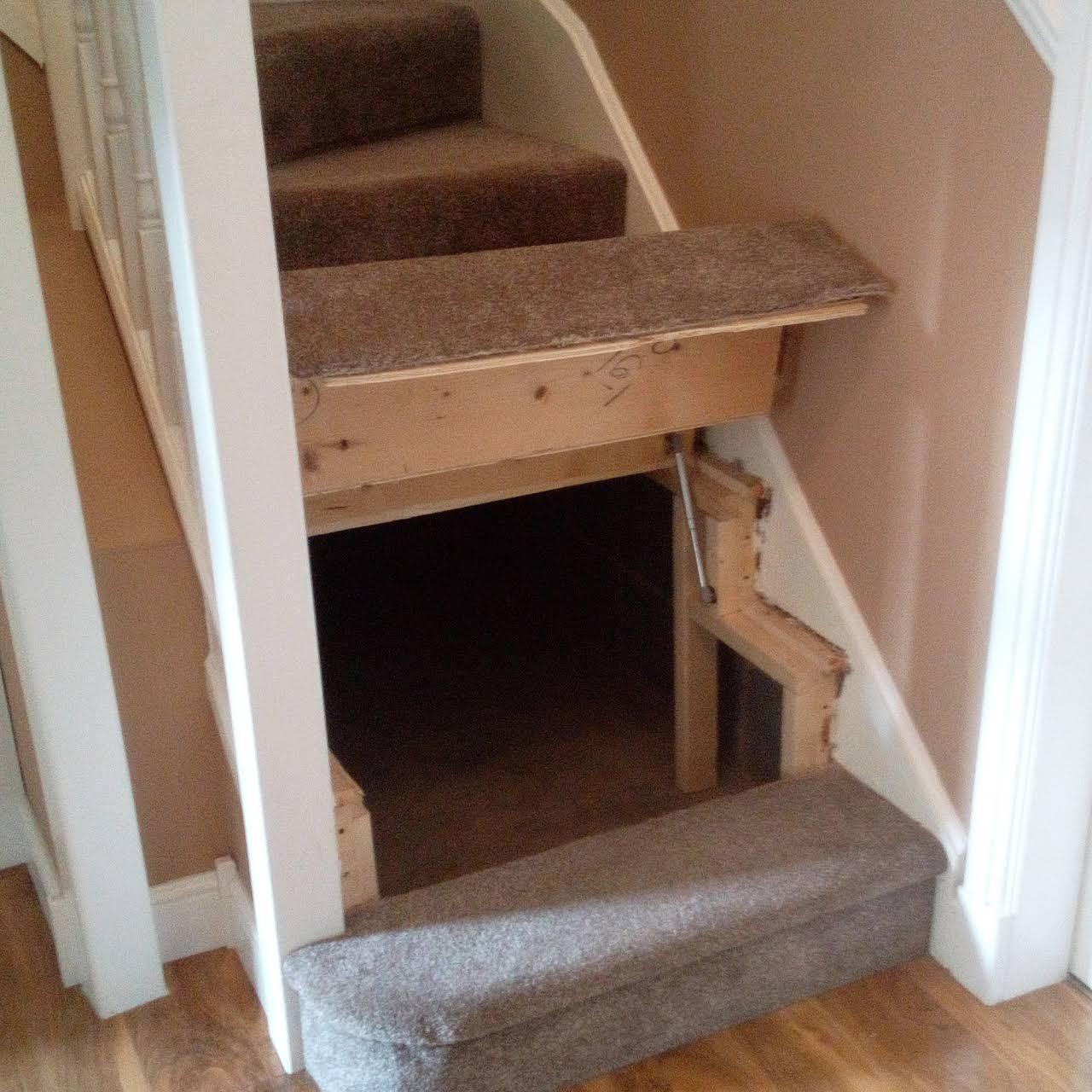

Onoff Posted January 11, 2021 Author Posted January 11, 2021 (edited) When, not if, I dig the stairs room floor up I need to decide what to do about the bottom landing. That is whether to dig down underneath it and build the whole floor back up including that section. That'll be a game! Edited January 11, 2021 by Onoff
JFDIY Posted January 12, 2021 Posted January 12, 2021 Wouldn't that only be marginal gains though? I'd cut round it and leave an island just supporting the bottom of the stairs, it will save you a lot of hassle, then just use the perimeter roll insulation to stop it sinking heat from the new heated section. In my new extension I considered building up a solid un-insulated and un-heated pad to land the stairs on, didn't think twice about the heat loss as it will be a small area in the scheme of things.
Onoff Posted January 12, 2021 Author Posted January 12, 2021 2 hours ago, JFDIY said: Wouldn't that only be marginal gains though? I'd cut round it and leave an island just supporting the bottom of the stairs, it will save you a lot of hassle, then just use the perimeter roll insulation to stop it sinking heat from the new heated section. In my new extension I considered building up a solid un-insulated and un-heated pad to land the stairs on, didn't think twice about the heat loss as it will be a small area in the scheme of things. Under that landing footprint might just be the perfect place to bring in a new flow and return from the boiler in the future. I'll try and finish the ground floor plan some time and it might be a bit clearer.

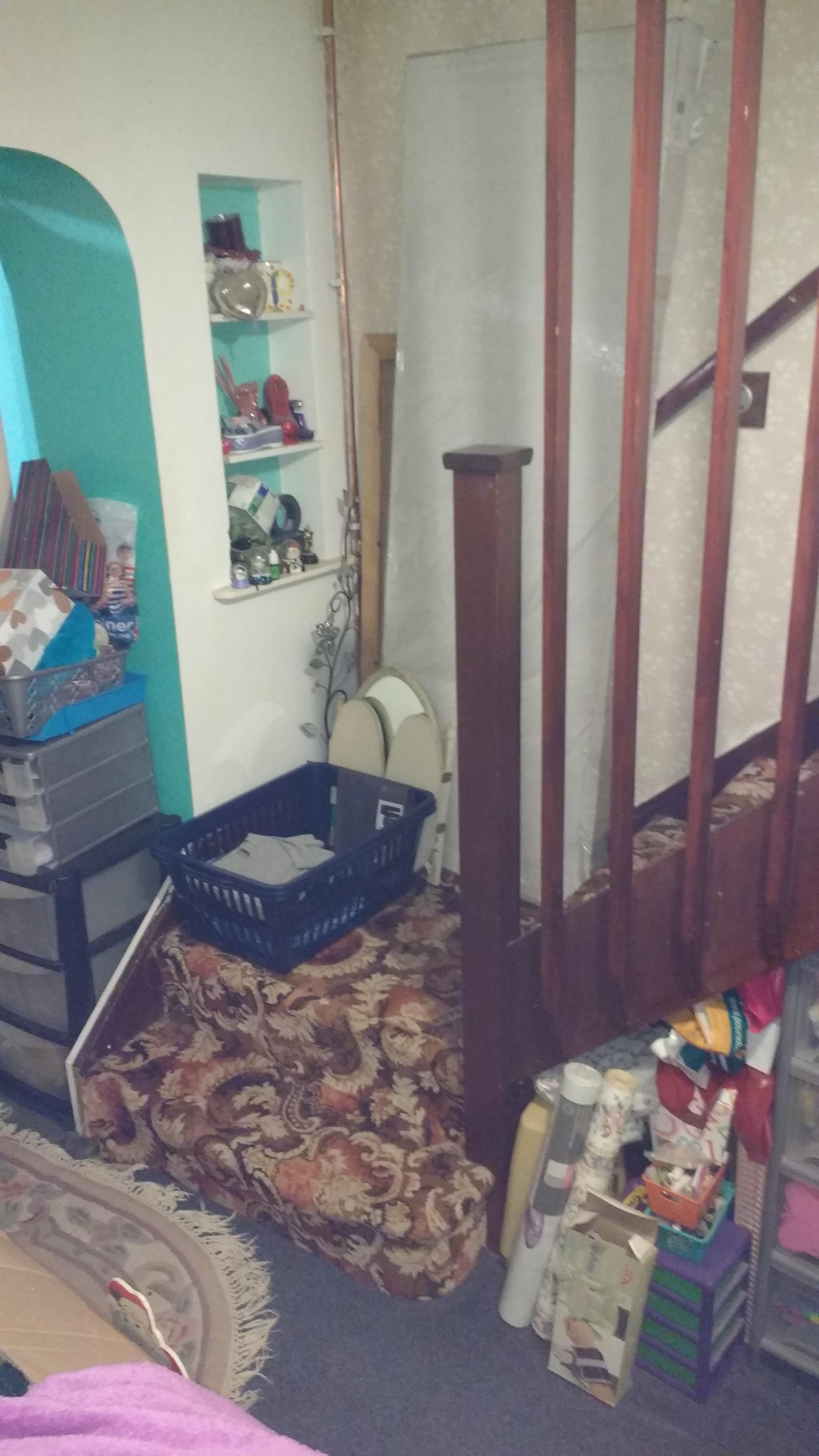

Onoff Posted January 23, 2021 Author Posted January 23, 2021 I got all excited when SWMBO cleared a corner of the stairs room. I thought she'd carry on with the other corner and under the stairs. Alas this corner is apparently for my lad's 3D printer to live. There was me thinking I'd have an empty room and could dig the floor up tomorrow! 1 1
Gav_P Posted January 23, 2021 Posted January 23, 2021 So near, so far. Start digging, they’ll soon move their shit!

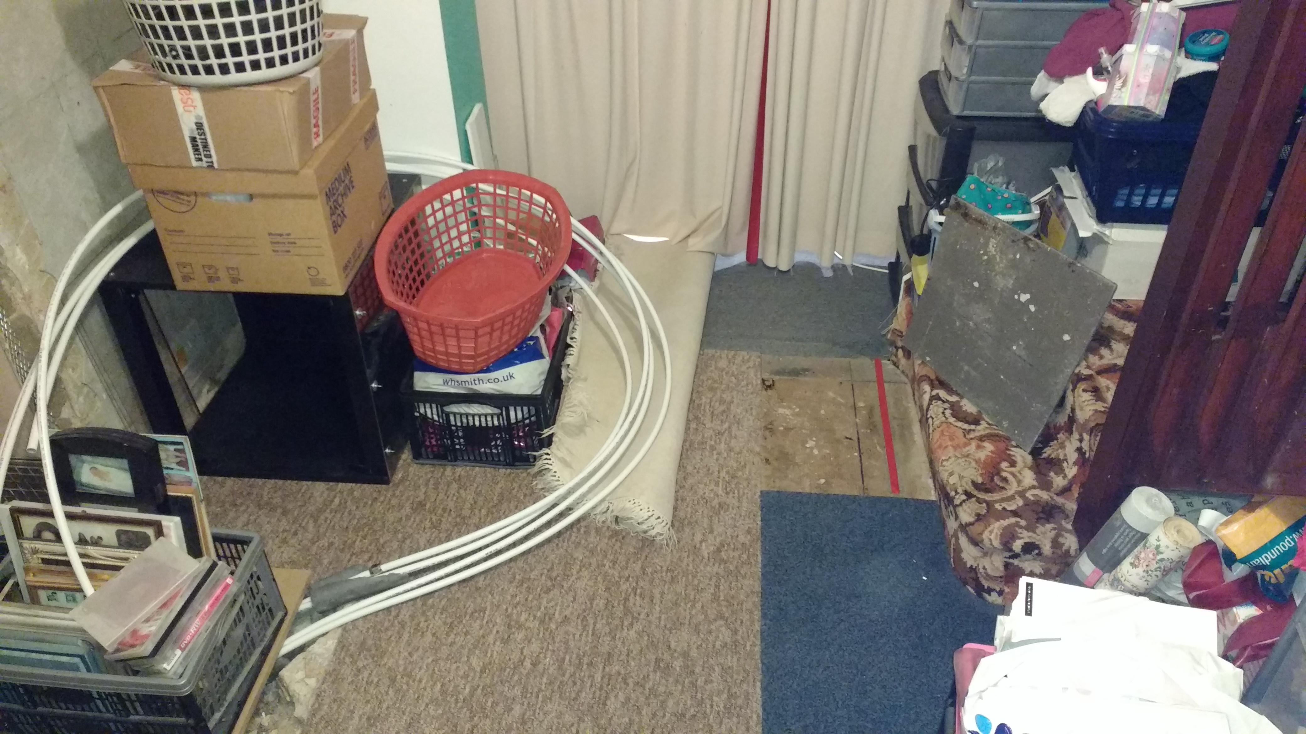

Onoff Posted January 24, 2021 Author Posted January 24, 2021 FFS she clears a space then fills it up!!! Not that I'm any nearer to digging but that red bit of tape on the floor is over the single pipe CH pipe that crosses the stairs room: If I leave the floor under the bottom landing in situ, I'll need to be bloody careful. A 9" grinder with diamond disc would be good I reckon, but for the mess I could do an L shaped cut and not disturb the bit under the landing. Kango'ing I reckon would just mean that bit under the stairs disintegrates.

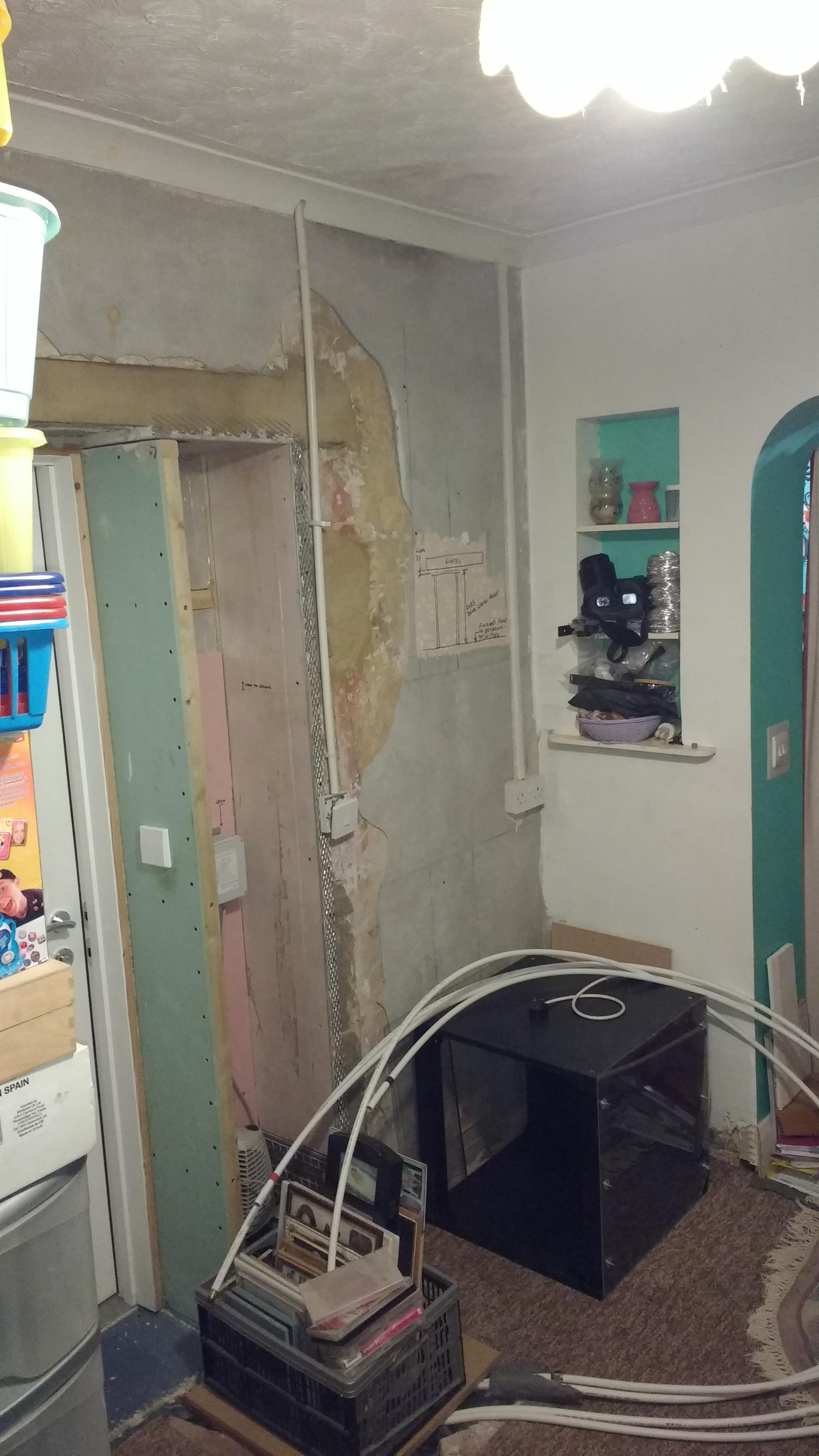

Onoff Posted January 24, 2021 Author Posted January 24, 2021 A pic from way back when I ran the pipe:
