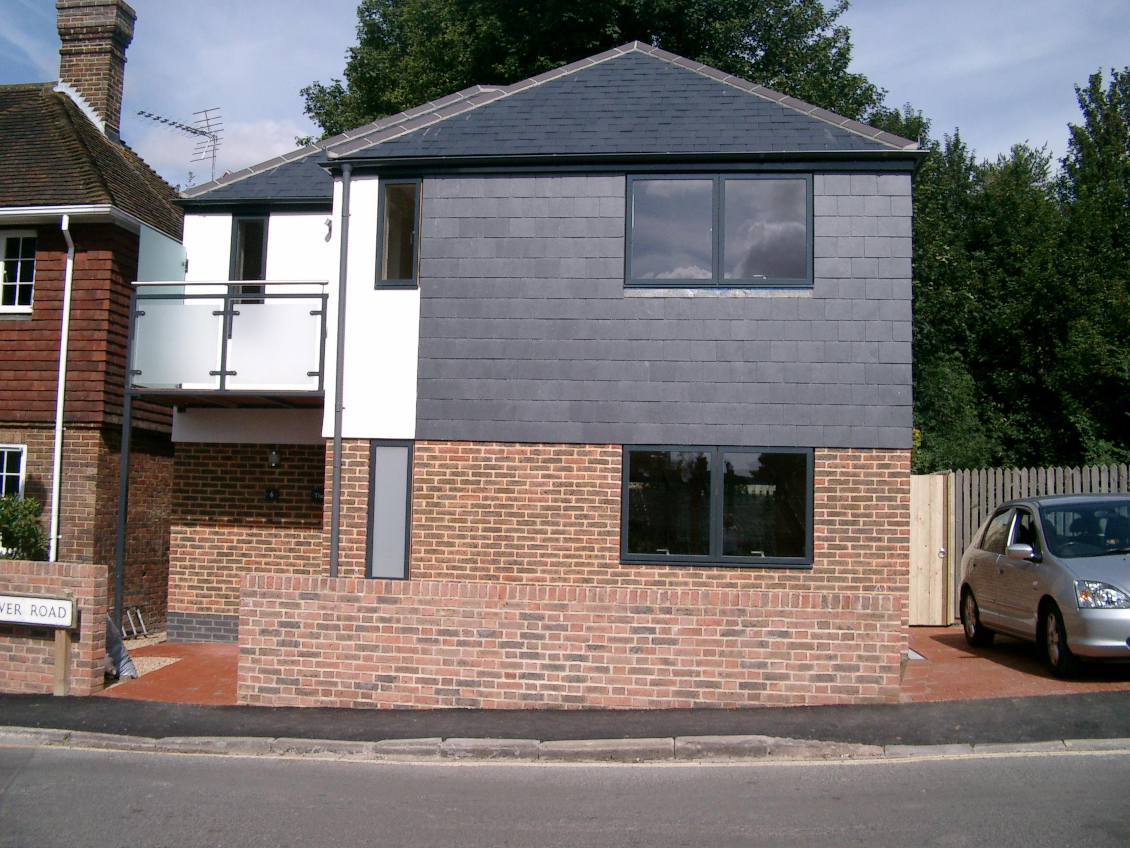

Mr Punter Posted January 16, 2019 Share Posted January 16, 2019 This one was well received by the planners and quite a compromise from the architects original proposal. A similar form to the next door house but a modern look. The owners have put planting at the front so the house now looks distinct from the front wall. 1 Link to comment Share on other sites More sharing options...
vivienz Posted January 16, 2019 Share Posted January 16, 2019 The upstairs cladding looks similar to mine - vertical slate. Watch out for lead times if you use Marley vertigo. 1 Link to comment Share on other sites More sharing options...
