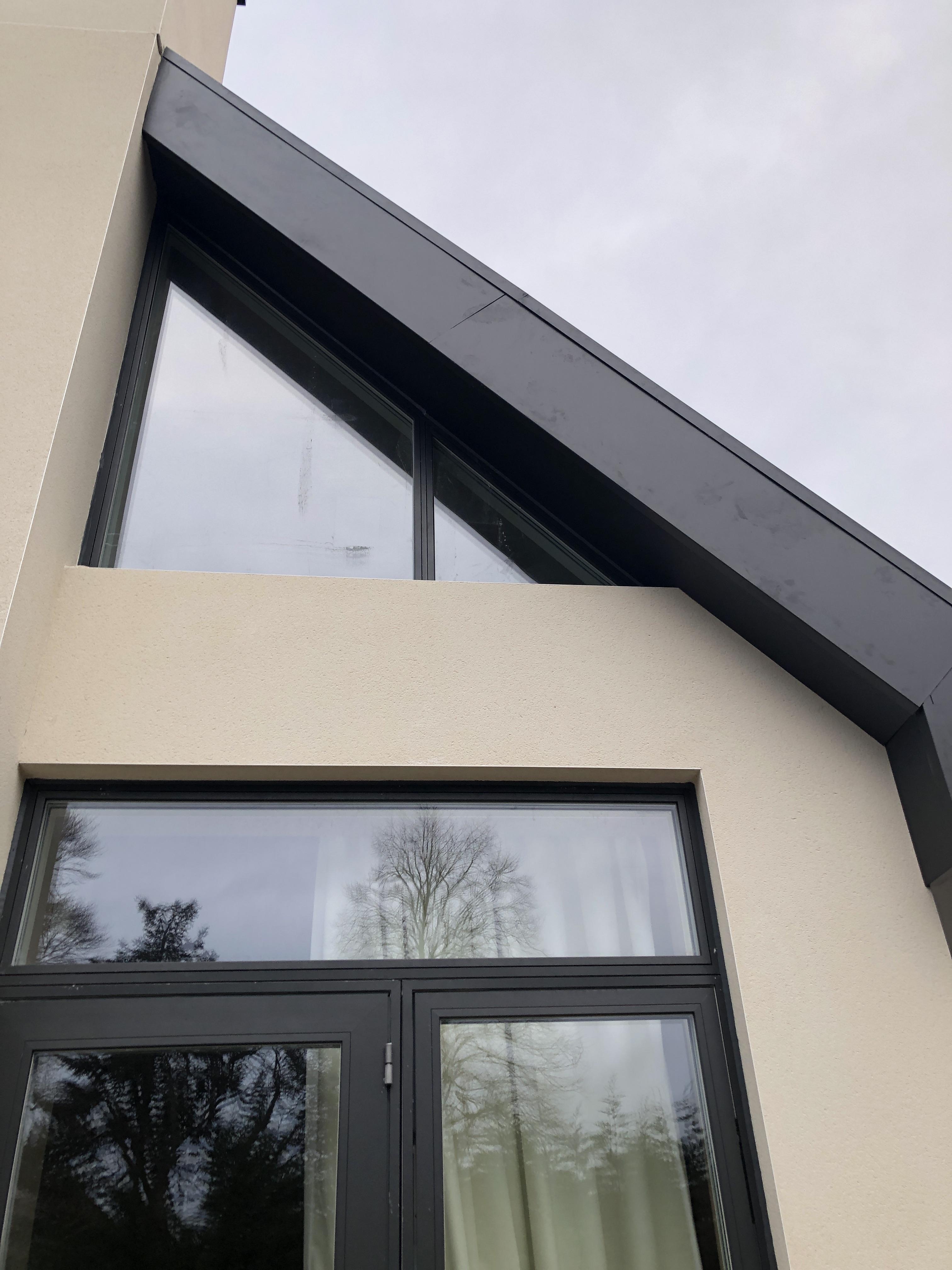

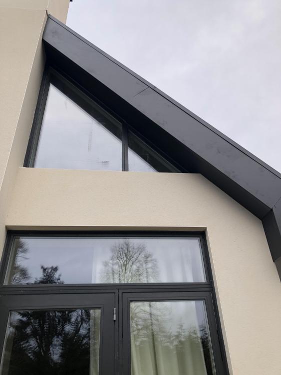

laurenco Posted January 9, 2019 Posted January 9, 2019 Our house design is similar to a house I saw once in Prestbury (see pic of the house I saw, and our design). Fully concealed gutters and aluminium cappings for the gables have been designed and the materials sourced. The only thing I'm struggling to find is a roofer who has experience doing this. My roofer (who is to lay the slates and fit the rooflights) said he'll have a go with bespoke alu lengths, but given any errors in the installation of concealed gutters will most likely put rainwater down the inside of our property, I'm keen to take an any advice from people who have gone down this route, before we mess up. Has anyone else installed concealed gutters and/or aluminium cappings onto the gables in this way? (please, no advice telling me not to go down this route - it's fundamental to the design, and ultimately, it's too late to change nowl!)
Ian Posted January 9, 2019 Posted January 9, 2019 (edited) @laurenco I've done that detail on industrial units but not housing. The main issues are having a gutter lining that is seamless (IE similar construction to a flat roof in solvent welded plastic or rubber) and also it should be designed so that the front lip of the gutter is lower than the back by a decent margin so, if it gets blocked, the water overflow is outwards and it can't come back into the building by backing up under the roof finish. Edited January 9, 2019 by Ian 2
Ferdinand Posted January 9, 2019 Posted January 9, 2019 (edited) @laurenco Clarify for us - you are talking across the bottom of the roof, not drainage down the verge? And do you want all the water from the roof to find its way into *this* gutter (which implies some sort of slot all the way along the bottom of the roof above your gutter-cover)? If it is the former, I made a neighbour do something like this along a 20m roof when his gutter was going to overhang my garden - though it was not quite *fully* concealed. My dad designed a detail for them. Essentially you sit the gutter on top of the wall, and flash underneath it and up the back and sufficiently down the face of the wall. And then you need a robust detail that will protect your wall and inside of the house, keep your gutter clear (anti-bird and insect grilles at the ends etc), and let the water get into it in a maximum water-flow event. It needs to be maintainable for when it *does* get blocked :-). You also need the face and appearance of your wall to be robust to the runoff water that lands on the gutter-cover, and overflow if the slot has insufficient capacity or gets blocked. I think my neighbour used lead flashing, but it could be one for glass fibre or EDPM. Will try and get some piccies. Ferdinand Edited January 9, 2019 by Ferdinand 1
Mr Punter Posted January 9, 2019 Posted January 9, 2019 I have done a hidden gutter with a zinc roof. We built the substrate including falls and they did the waterproofing. For your roof, maybe you could do the gutter and, say, 600mm up the slope in GRP, then tile over. The ali copings are as much decorative as anything and a number of firms will supply these made to your spec. I quite like the ones in your example being at the same angle as the pitch. Any chance of you going to Prestbury to have a chat or stick a note through the door? Not sure what you had in mind for downpipes? 1

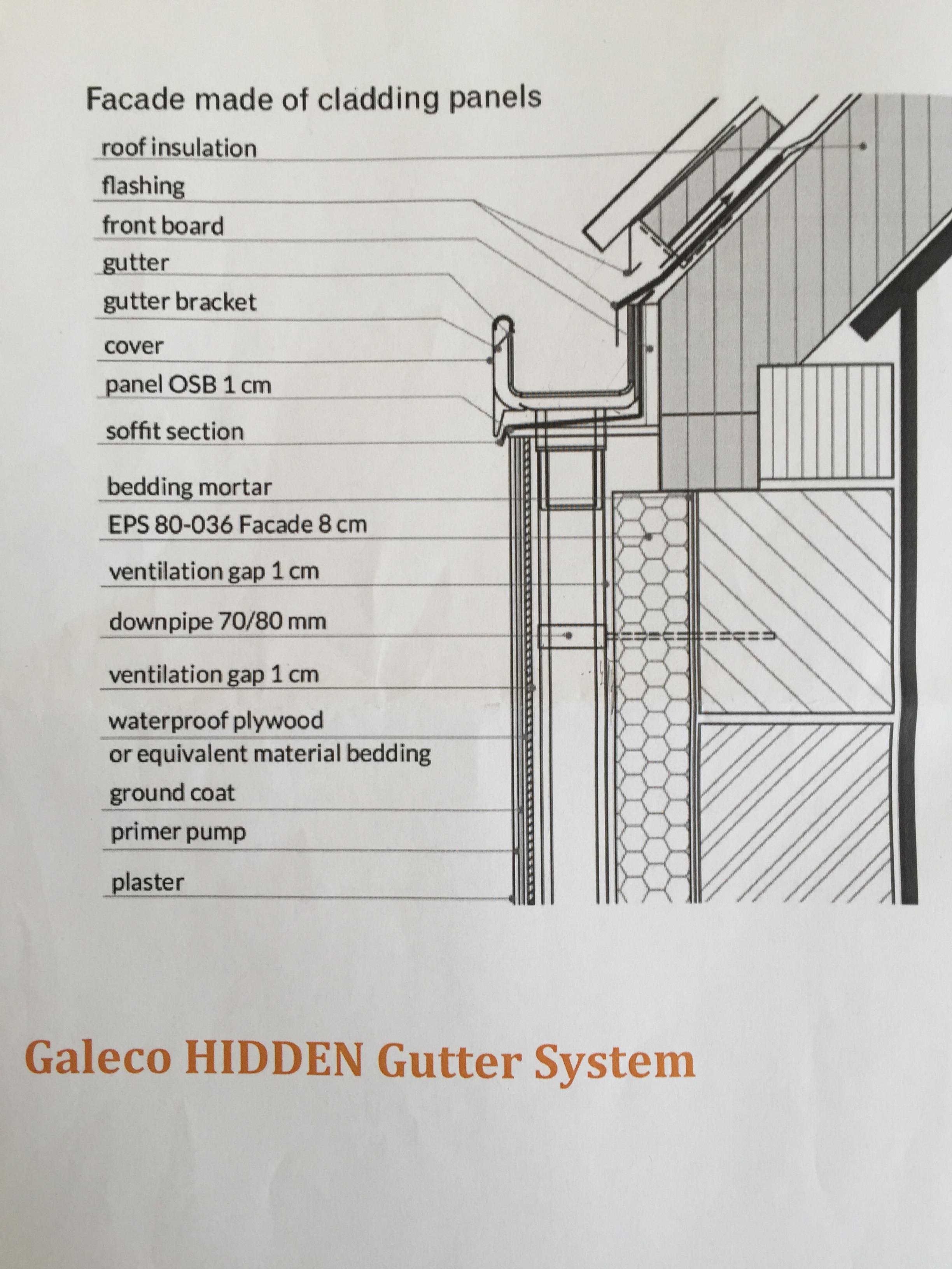

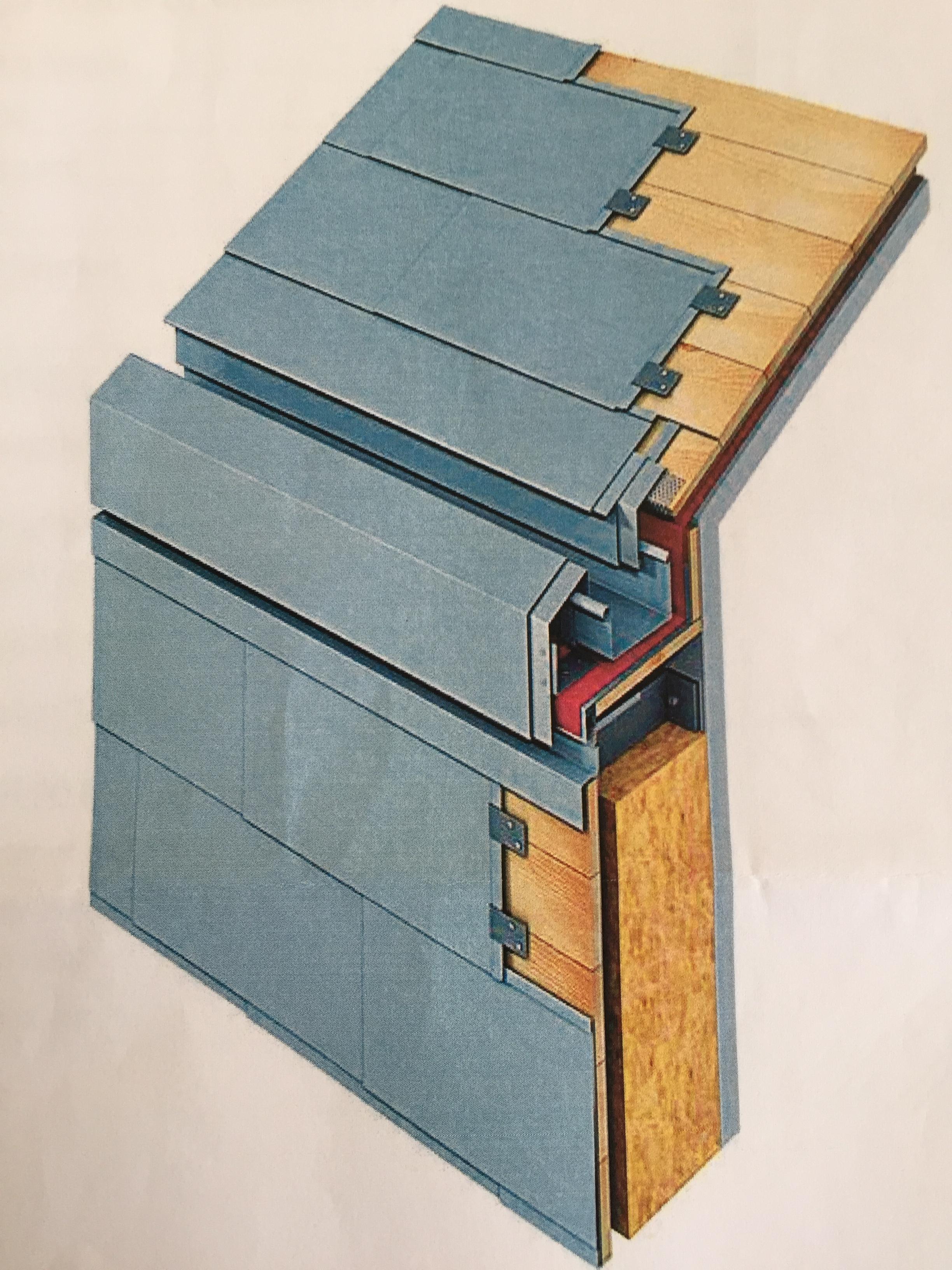

Russdl Posted January 9, 2019 Posted January 9, 2019 @laurenco We were going to have concealed gutters but I bottled it in the end, I got these two drawings of separate solutions from, I recall not where, but they may be of some use. 1
laurenco Posted January 9, 2019 Author Posted January 9, 2019 brilliant @RussdlThanks for this. I'm sorry you bottled it. Were you happy with what you went for in the end?
Russdl Posted January 9, 2019 Posted January 9, 2019 @laurenco It's not built yet, but I would have liked to stick with the concealed gutters aesthetically (I think yours will look particularly sharp) however I was getting more and more concerned about the potential issues and the shear complexity of the detail that was emerging. Weak and feeble I know!
Ferdinand Posted January 9, 2019 Posted January 9, 2019 6 minutes ago, laurenco said: brilliant @RussdlThanks for this. I'm sorry you bottled it. Were you happy with what you went for in the end? Looking at @Russdl‘s detail I would do one or two things differently. I would not have OSB sitting underneath the gutter. At the least I would use waterproof ply, but ideally something even better that is entirely unaffected by water. I would probably want a fall towards the outside wall in the sheet beneath the gutter for belt and braces. I would ideally want to run the below tiles membrane straight down into the gutter for simplicity and continuous coverage. I am not sure how I would detail that. Ferdinand 1
AliG Posted January 9, 2019 Posted January 9, 2019 Those solutions are for outside walls with cladding panels, not sure if your walls are rendered panels or blockwork. Anyway, Galenco as referenced by @Russdl has solutions for different construction methods. https://galeco.pl/sites/all/pliki/do_pobrania_eng/katalog_bezokapowy_eng_24_08_2017.pdf 2
laurenco Posted January 9, 2019 Author Posted January 9, 2019 (edited) 4 hours ago, AliG said: Those solutions are for outside walls with cladding panels, not sure if your walls are rendered panels or blockwork. Anyway, Galenco as referenced by @Russdl has solutions for different construction methods. https://galeco.pl/sites/all/pliki/do_pobrania_eng/katalog_bezokapowy_eng_24_08_2017.pdf @AliG I love this, thank you. Will probably be very expensive, but lets see.. Edited January 9, 2019 by laurenco

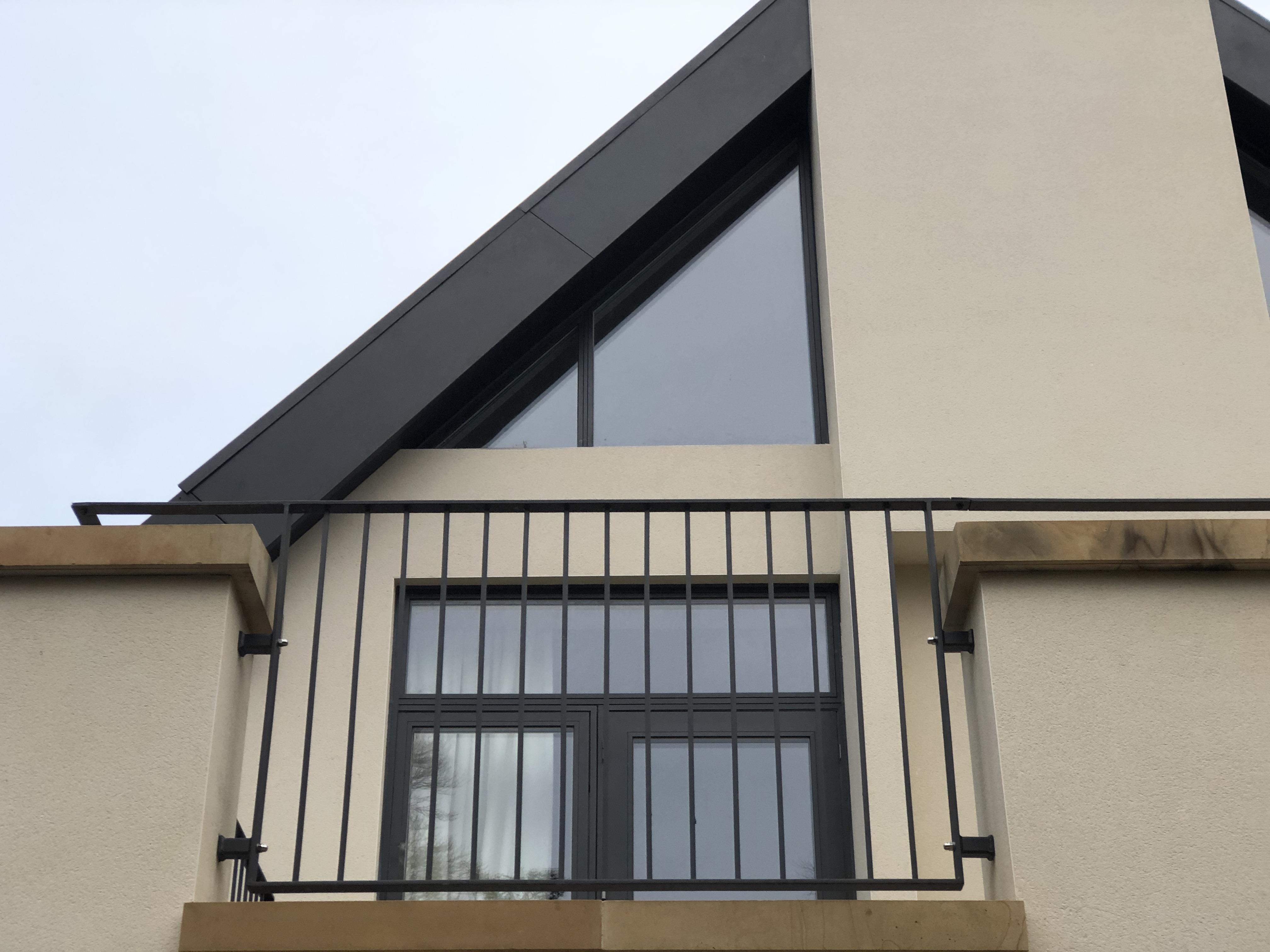

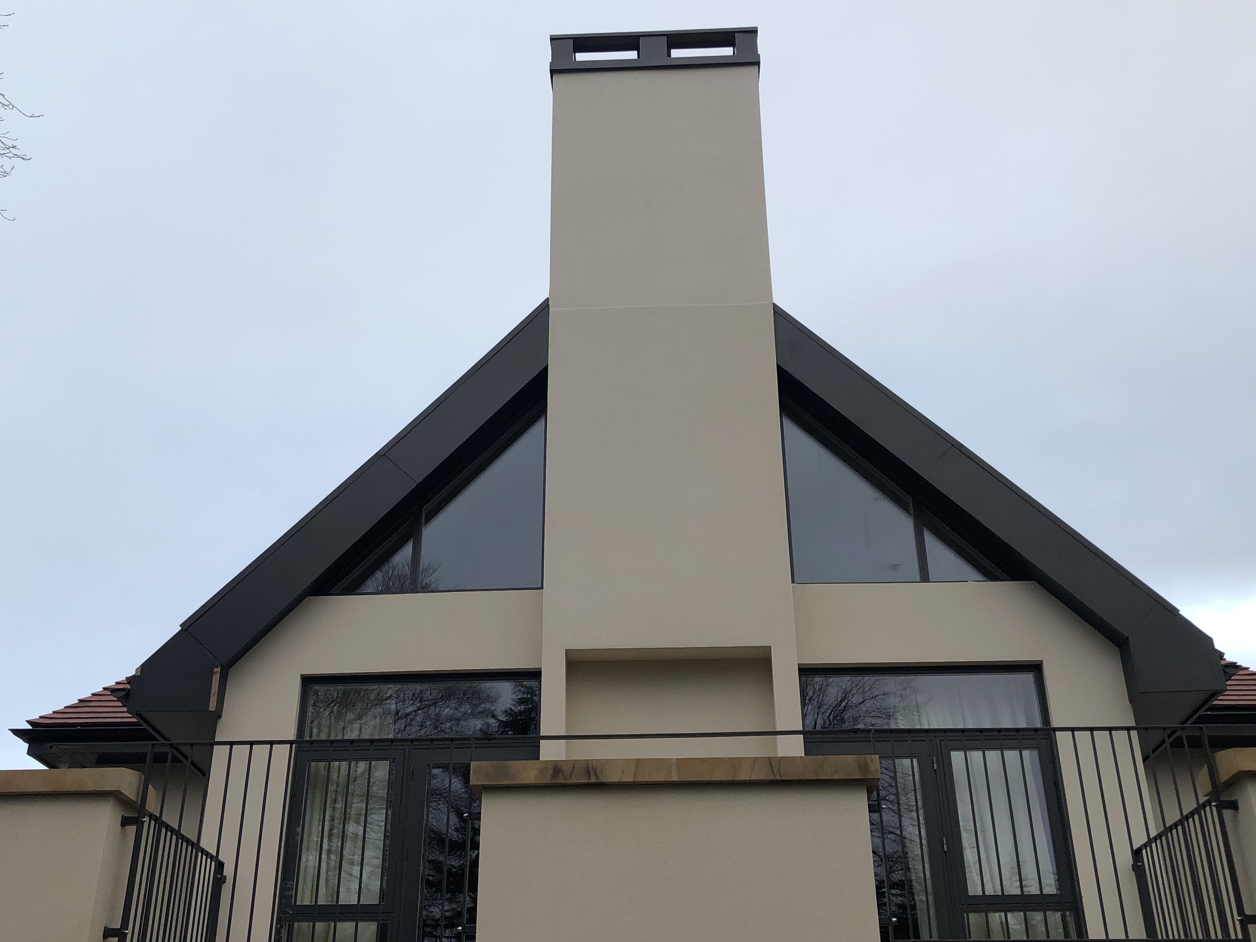

AliG Posted January 12, 2019 Posted January 12, 2019 Just took some pictures of my gable end which is clad in aluminium although not with concealed gutters. We are waiting on a couple of small corner pieces. 1
the_r_sole Posted January 16, 2019 Posted January 16, 2019 (edited) . Edited September 26, 2019 by the_r_sole
laurenco Posted January 23, 2019 Author Posted January 23, 2019 (edited) @AliG I love the aluminium. Your gable looks striking Edited January 23, 2019 by laurenco 1
laurenco Posted January 23, 2019 Author Posted January 23, 2019 On 16/01/2019 at 14:34, the_r_sole said: what's the roof construction you are looking at? and what is your wall construction? The detail changes for different roof types, you'll see a lot of the metal roof companies have standard details for concealed gutters, but it's hiding the downpipes that really makes the detail imo I don't think we can / will hide the downpipes (unfortunately). The walls are timber frame and MBC have designed the roof detail (posi joist roof) to accommodate the box gutter on the pitched roof with concrete slate-effect roof tiles. I have found a fabricator who will make and install the gutter so fingers crossed! 1
Russdl Posted January 23, 2019 Posted January 23, 2019 @AliG I presume that gable end cladding was custom made? Looks very smart and similar to the look we are after. Can I ask who supplied it and how it attaches? Apologies for drifting the thread a bit...
AliG Posted January 24, 2019 Posted January 24, 2019 (edited) I actually don't know the name of the supplier, it is just a random guy who powder coats things. Annoyingly it appears in dribs and drabs so has taken ages to put up. He turns up in an estate car with a very aggressive dog in the back. It is just aluminium powder coated aluminium sheet so a local powder coater should be able to do it. There was a lot of back and forward on who should measure it and whose responsibility it would be if it didn't fit. The straight areas were OK, but the diagonal on the gable in particular created a worry. The builders built wooden soffits and fascias as they normally would and the aluminium is either screwed or stuck to it. They and the architect spent some time detailing it so that you cannot see the screws. The soffit is fitted first and is just a flat sheet. Then the fascia is fitted, it is l-shaped with a small overhang so that the screws are in the back of the overhang and cannot be seen. This covers the screws in the soffits. The joins have strips of rubber behind them as it was felt that this provides a neater join than some kind of covering strip. Due to building the wooden version and then covering it, it was considerably more expensive than just painting the wood. It may eventually pay for itself after 40 years of not needing to be painted. I just checked the costs and the aluminium plus fitting was 140% of the cost of the underlying wood. I don't have the exact area, but it looks like it probably cost over £150 per linear metre in total. The house has very wide eaves, the soffits are 650mm wide. Edited January 24, 2019 by AliG 1
