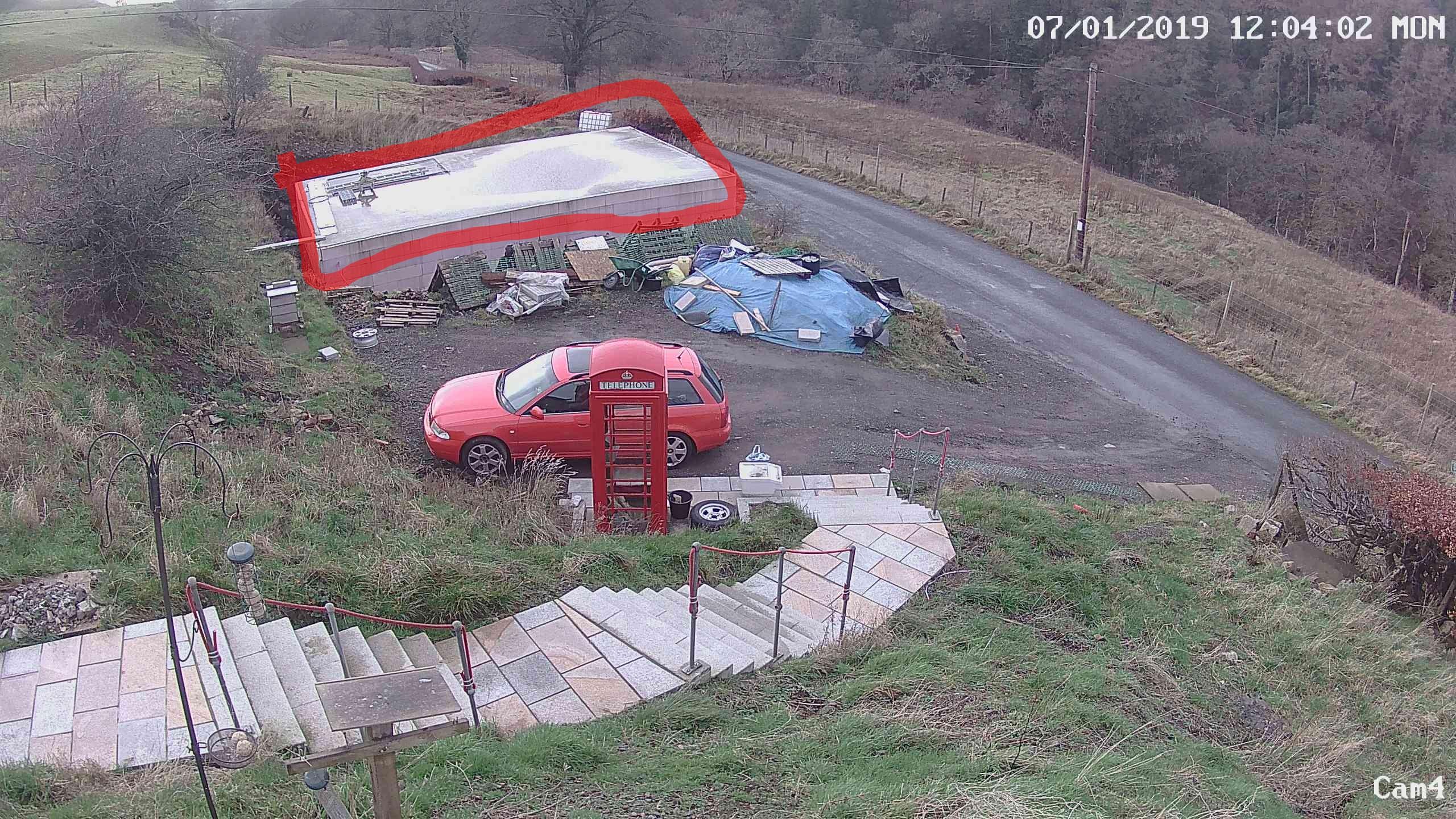

jamiehamy Posted January 7, 2019 Share Posted January 7, 2019 Hi all, Been laid up feeling sorry for myself with a cold or something. Fed up with job and wondering what the next project should be. At the back of my mind I've always thought we could build on top of the garage and now I'm seriously thinking of it. Would like to hear thoughts. I've got nothing firm other than the below: Garage roof is reinforced concrete and was rated at 10kN loading by design. Area is approx 7m x 11m Walls are 250mm reinforced concrete Thinking we could build a single bed apartment on it. With a view to a retirement income, we could build to a high spec as per a few of the folks in here and let it out. I've not done detailed study of the Local Plan yet so clearly absolute condition on that. Would be single storey with same pitch roof as main house (5degrees I think) to keep a low profile,possibly sharing the drive or steps from layby with option of wheelchair access using the main drive as required. Could I build it such that BC regs do not apply? I could use icf, would be really easy but permenent. If I did timber framed, could I build it in two sections such that it could be craned off if needed? The thinking behind it is as much around trying to generate an income that could support us in retirement as much as anything else. We have no plans moving so making an assumption we will be here when we retire. I've attached pic of garage. As you can see, driveway is not finished - if I was going to attempt something like this, I would try incorporate 'things' into the drive, like possible soil drainage to the existing outlet (water run) possibly different levels to support true level threshold and disabled access, maybe prefab concrete steps up the side(assumption is entrance from this side) Thanks, Jamie 1 Link to comment Share on other sites More sharing options...
Crofter Posted January 7, 2019 Share Posted January 7, 2019 First question has to be- what do you think the market is in your area for holiday lets? Party size, length of stay, seasonality, and of course the going rate for accommodation. Occupancy rates will make a massive difference to your income. Here in Skye, the market has shifted in recent years- people offering weekly lets are beginning to struggle, whereas those offering shorter stays are doing very well. The traditional model of a Saturday changeover is much less lucrative, so if you work full time you need to employ changeover staff to cover the mid-week cleaning. Perhaps less of an issue if you are retired, of course. Out of curiosity, what do you see as being the advantages of going BC exempt? It was a path that suited me quite well, being almost 100% DIY, but for a more typical project where trades are employed it loses much of its benefit. Link to comment Share on other sites More sharing options...
jamiehamy Posted January 7, 2019 Author Share Posted January 7, 2019 Thanks @Crofter. I've started looking at the local market. We're just outside Largs which is a popular tourist place in summer, 3 marinas within 10miles, airport 40mins and the whole of the Clyde, Argyll and the west of Scotland with all its delights on the doorstep! In terms of going BC exempt, I think I've seen what you and others have done and like the idea - potentially a cost saving on architect fees/bc fees etc. It will also help keep the design more simple I think, we'd be building it ourselves. There is also an element of the 'doing it that way because we can'. I like that, I'll admit! Let wise, we are always flexible and can work from home when needed, which is good. Theoretically there could be a market for some sort of longer term let due to the power station (esp when they start decommissioning) - friends did similar and often had pilots stay for 6 months (they were next to the airport) . Tonight is the first time I've given serious thought to his idea - previously we'd thought of buying land on the west coast and having our own wee holiday home we could rent when not there. Second home style... But I do have concerns on various levels, not least being a poor neighbour! It's not a great model for Scotland or communities so think I've talked myself out of that! Link to comment Share on other sites More sharing options...
