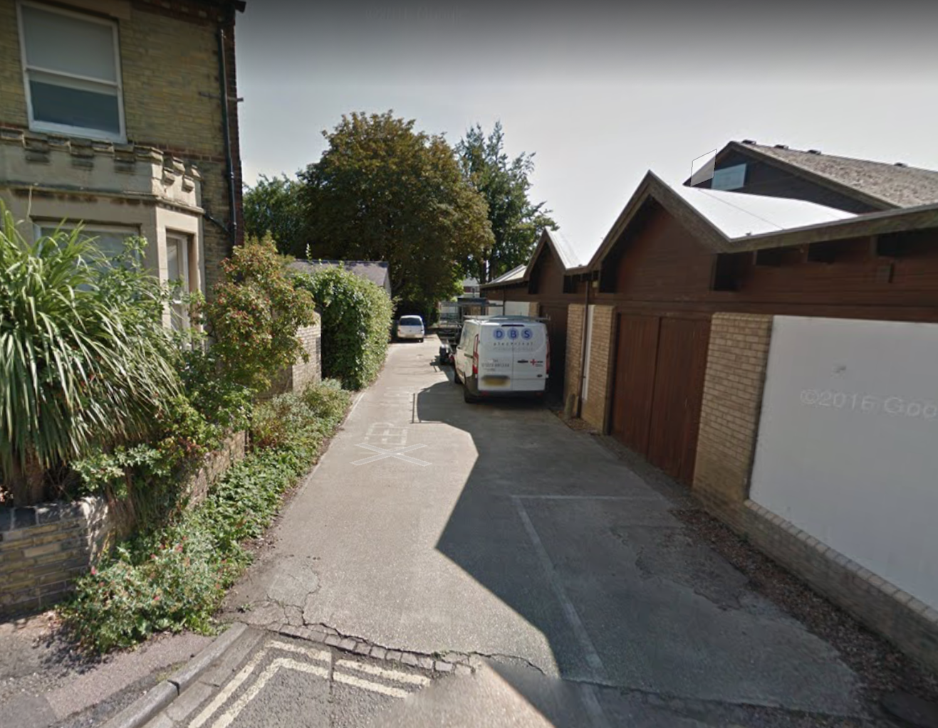

Dreadnaught Posted January 6, 2019 Author Share Posted January 6, 2019 (edited) Regarding access, here's a view down the access road towards my plot. The gate to my plot is under that (slightly brown) chestnut tree at the end past the small silver car. Hopefully in the event I can convince the various neighbours to temporarily move their vehicles on frame day. As you can see, driving a digger around may be challenging. Edited January 6, 2019 by Dreadnaught Link to comment Share on other sites More sharing options...

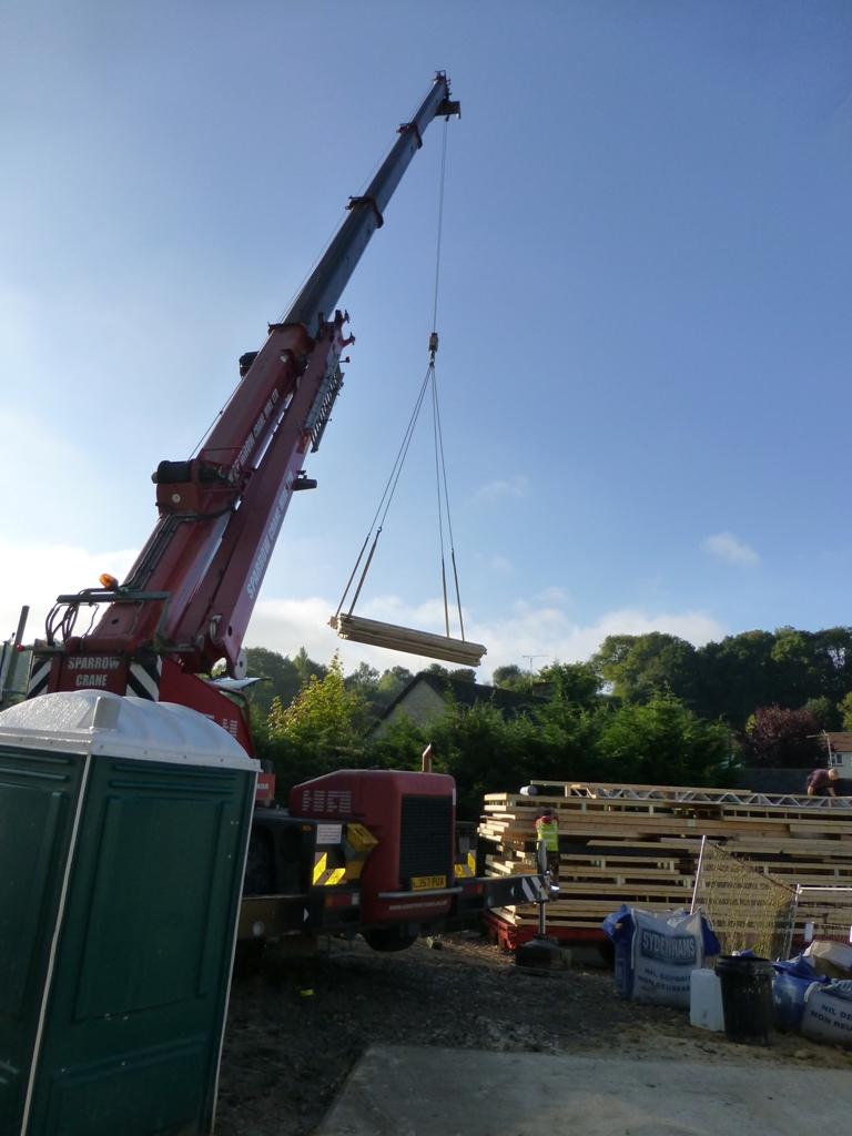

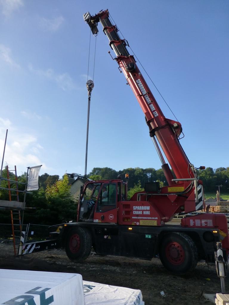

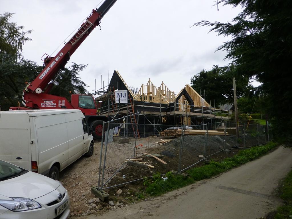

Jeremy Harris Posted January 6, 2019 Share Posted January 6, 2019 Here's our 300mm thick frame and garage being delivered to our site: That's a 38 tonne artic that had driven over from Ireland with our house and garage on it. This is it unloading, blocking the lane for around 6 hours or so: Link to comment Share on other sites More sharing options...
Dreadnaught Posted January 6, 2019 Author Share Posted January 6, 2019 Thanks @JSHarris. What a sight! And then I imagine you had a big crane for the offload, like @vivienz had? I suspect neither is a possibility on my site, which is why in their quote to me MBC allowed two entire extra days for the necessary manhandling. Link to comment Share on other sites More sharing options...
Russell griffiths Posted January 6, 2019 Share Posted January 6, 2019 Thinking of things before you get to the frame stage what about a concrete wagon and pump what about muckaway. Maybe time to go and make friends with the neighbours. Link to comment Share on other sites More sharing options...
Jeremy Harris Posted January 6, 2019 Share Posted January 6, 2019 8 minutes ago, Dreadnaught said: Thanks @JSHarris. What a sight! And then I imagine you had a big crane for the offload, like @vivienz had? I suspect neither is a possibility on my site, which is why in their quote to me MBC allowed two entire extra days for the necessary manhandling. Our site is tiny, yet we managed to get a 100ft jib crane on it (just): Link to comment Share on other sites More sharing options...

Dreadnaught Posted January 6, 2019 Author Share Posted January 6, 2019 Thanks for the photos @JSHarris. Who's MJ? Shouldn't it be JSH? Link to comment Share on other sites More sharing options...
Russell griffiths Posted January 6, 2019 Share Posted January 6, 2019 You have seen my site so for reference this is a problem I also have my roof timbers are 11m long and there is 32of them what we are doing is to get them delivered directly to a farm a couple of miles away, he will unload them with the tele handler and reload onto a flat bed trailer, we will then drive to site and unload by hand. Do you know the exact act weight of a panel ? you may be worrying about nothing. Link to comment Share on other sites More sharing options...
Russell griffiths Posted January 6, 2019 Share Posted January 6, 2019 Looking at the tree it’s lowest branches don’t look like they comply with height regulations. Or is this before it was lifted. Link to comment Share on other sites More sharing options...
Jeremy Harris Posted January 6, 2019 Share Posted January 6, 2019 3 minutes ago, Dreadnaught said: Thanks for the photos @JSHarris. Who's MJ? Shouldn't it be JSH? If you look carefully you can spot "JH" on my old Prius parked in once of the photos... MJ Scaffolding were great, BTW, if anyone is looking for a scaffolder around our area. We mucked them about a lot, with short-notice requests to changed the scaff, and they responded quickly every time. 1 Link to comment Share on other sites More sharing options...
Dreadnaught Posted January 6, 2019 Author Share Posted January 6, 2019 (edited) 5 minutes ago, Russell griffiths said: You have seen my site so for reference this is a problem I also have I have and its just as spectacular in real life as it looks in the photos. Still envious! 5 minutes ago, Russell griffiths said: what we are doing is to get them delivered directly to a farm a couple of miles away, he will unload them with the tele handler and reload onto a flat bed trailer, we will then drive to site and unload by hand. Yes, I wouldn't be surprised if that will prove to be a solution. I am quite keen to give the challenge to another company to handle, another attraction of using a company like MBC. 5 minutes ago, Russell griffiths said: Do you know the exact act weight of a panel ? you may be worrying about nothing. I don't but I did witness @vivienz panels going up and the crane was enormous. But I am also led to believe that they can manufacture smaller panels if they must. I will be quite pleased to lay the entire challenge at their feet to solve. Edited January 6, 2019 by Dreadnaught Link to comment Share on other sites More sharing options...
Dreadnaught Posted January 6, 2019 Author Share Posted January 6, 2019 6 minutes ago, Russell griffiths said: Looking at the tree it’s lowest branches don’t look like they comply with height regulations. Or is this before it was lifted. I know you know about such matters. That photo is before the crown lift but, as I am sure you know, a crown lift really only takes off the twigs (lots and lots of them) but not any main limb. There is one limb that encroaches across the gate which effectively provides a height restriction (and couldn't be removed). Its worth noting that you cannot actually see the gate in the photo. Its hidden from view on the left beyond the small silver car. Link to comment Share on other sites More sharing options...

Russell griffiths Posted January 6, 2019 Share Posted January 6, 2019 Having spent many years hiring cranes you need a crane to do your job, not one you looked at on another site. Look how small Jeremy’s one was, yet I bet his panel weighed the same crane hire is about the load verses the radius it need lifting to, height is not normally a factor unless you are on a multi storey job. What you need is a city crane developed for use in (er cities) you need to measure the width of the street to accommodate the out riggers then you need to know the load, ( which will be tiny ) then the radius to the furthest panel placements. After writing all that guff you will probably be better off unloading somewhere else and bringing to site separately. How have mbc priced this ? it could be cheaper for you to provide 3 blokes and a transit flatbed or trailer for two days to get the frame on site you can bet mbc will put a good markup on this. Who pays for the crane ? not having a crane will allow you to bribe a local farmer and pay 4 lads for a good couple of days get 10 panels on site before mbc turn up, then as they start supply them with a new panels as you transport them. 1 Link to comment Share on other sites More sharing options...
