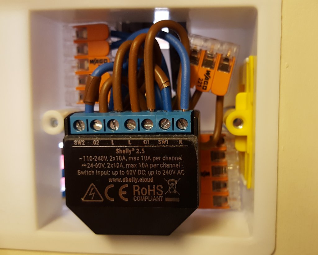

Have you seen the Shelly range of smart relays? I was considering trying out a Sonoff but stumbled across the Shellys which are designed and built by Allterco Robotics in the EU which made me feel a bit more comfortable about stuffing inside a backbox out of sight. I bought a Shelly 2.5 which provides two independent channels that can switch upto 10A, and it has built-in overtemperature and (adjustable) overcurrent protection which appealed. So far I've been mainly playing with it via the Shelly cloud but with its built-in webserver and HTTP/MQTT interface it can be operated without any external connectivity dependency. With its support for switched inputs it can operate entirely in standalone mode too.
As you can see it is tiny and easily fits inside a single backbox (that's got four 1.5mm twin+earth cables in with it too). Incidentally, this is the first time I've used Wago's relatively new '221' lever connectors and they are a considerable improvement over their existing 222 range what with them being much slimmer and having a transparent body so you can easily confirm proper insertion - highly recommended!
Yep, I'd seen the Shellys.
They need a neutral feed in the light switch backbox, which means rewiring for most houses. The LightwaveRF dimmers by contrast don't need neutral - they keep a tiny current going on the load just to power the circuitry. Neat trick.
If you have your own Home Automation server, you can also use LightwaveRF remote switches (as opposed to dimmers) to control something like a Sonoff inline elsewhere ... though as that's likely to be hidden, it starts to fail my design goal of "removable".

Yes, a neutral is indeed required in the relay's location but this wouldn't necessarily have to be the backbox in all cases. Fortunately ours have them so I didn't give that aspect much thought and I've always made a point of wiring lighting circuits that way as even leaving 'smart' lighting aside I find it far easier to manage the loop-in/loop-out/switching connectivity within a backbox than at the light fitting itself.
Quote
It's mainly the cost of the Lightwave range that put me off as I don't know how confident I can be in its longevity in any future solution, mainly because I am right at the beginning of this journey and still have a lot to learn about what options there are I where I want to go (your list has been very helpful with this). I am really keen to use as much open standards/products as possible to mitigate this uncertainty.
