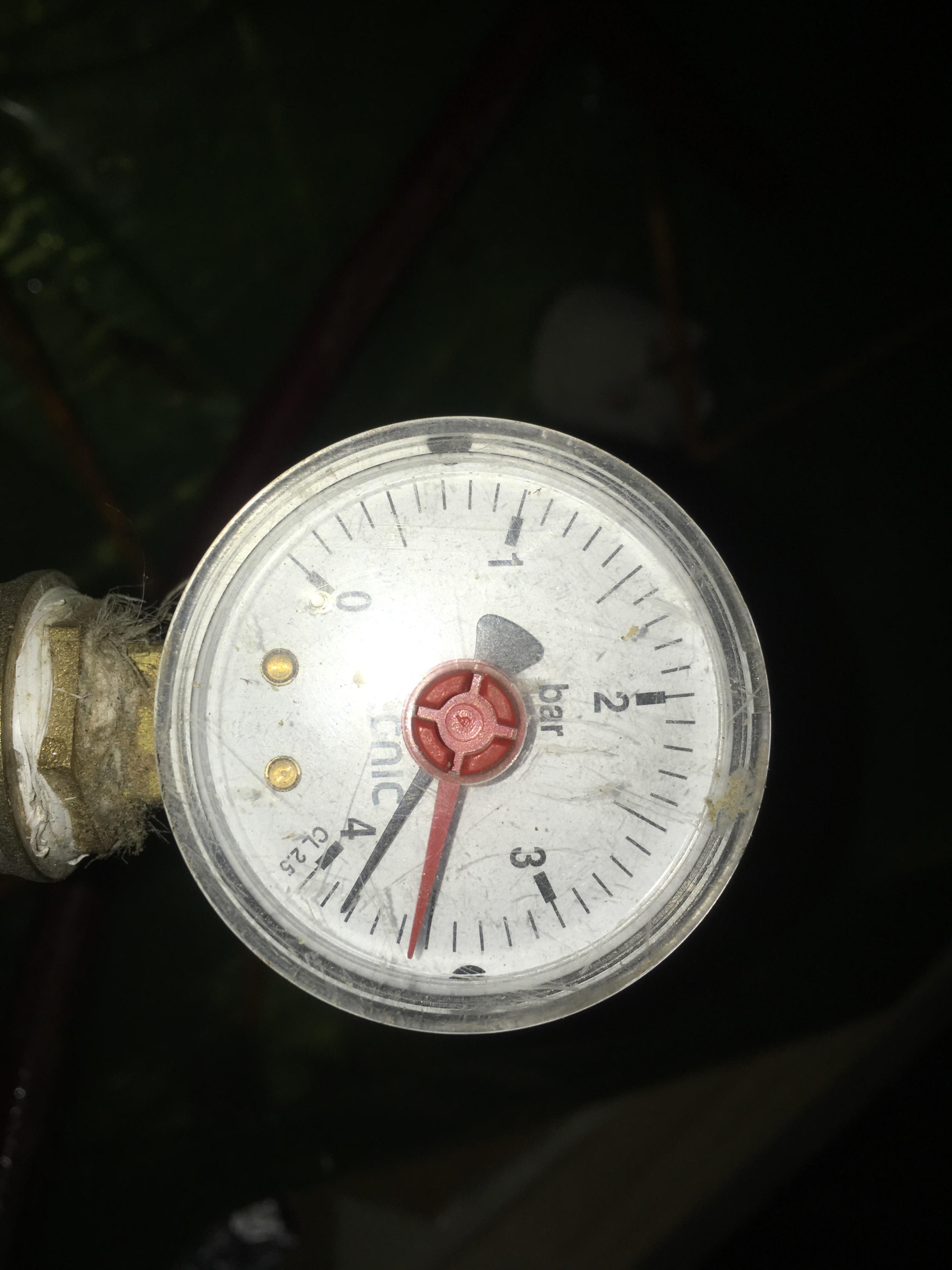

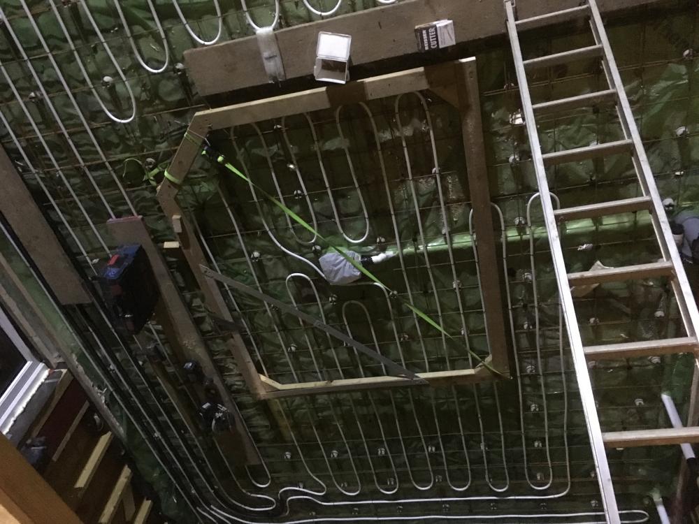

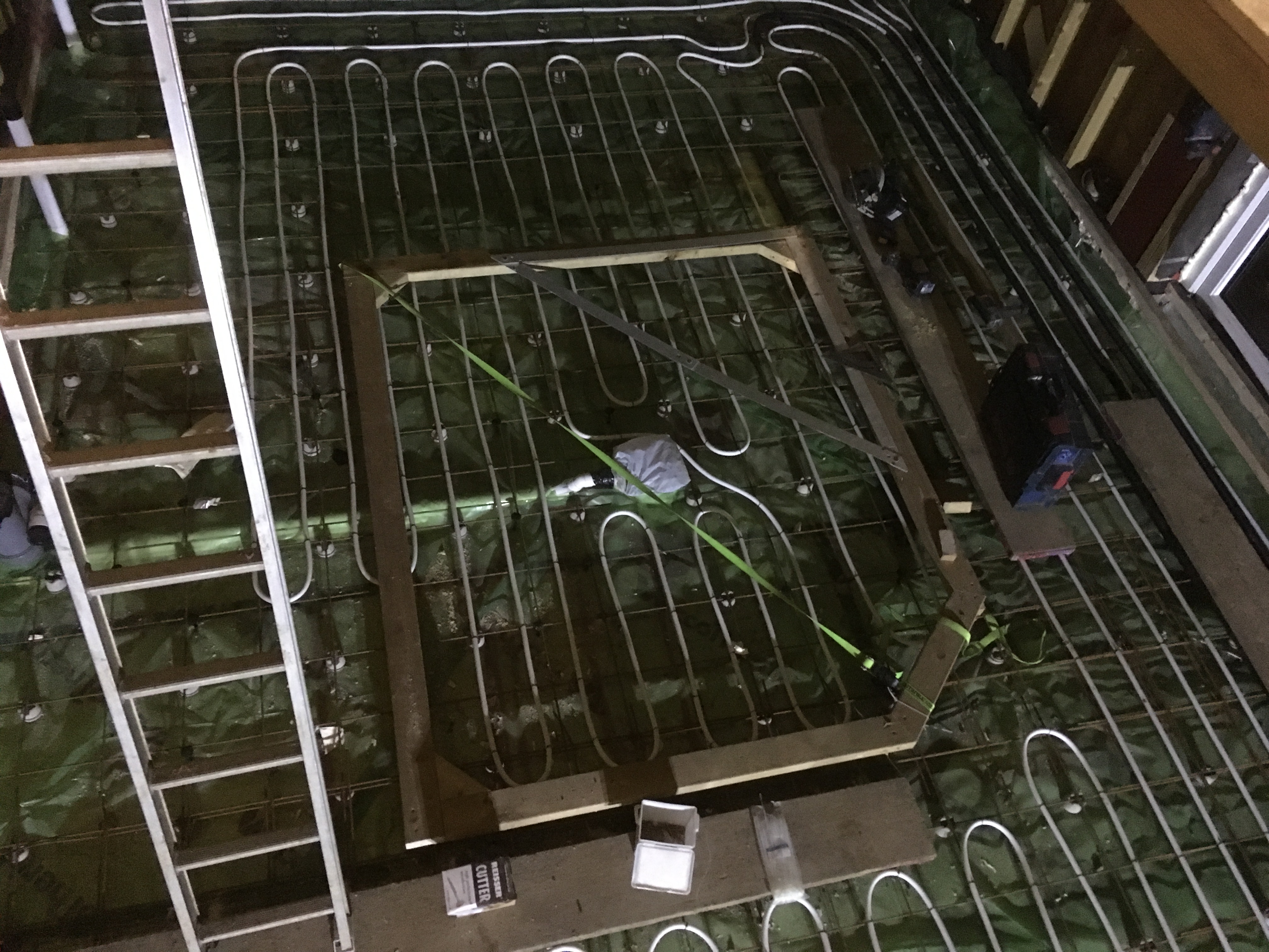

Construction Channel Posted March 10, 2018 Author Posted March 10, 2018 Well this is the start of the shower shuttering. I need to Cut a wooden brace across where the strap is and put more supports in but the corners are level and it’s in the right place. As for the pressure...... it’s gone up? I had left the hose connected which I have now taken off. So either that valve was letting by or it’s magic. Either way it’s not leaking 1
Nickfromwales Posted March 10, 2018 Posted March 10, 2018 Cold water has acclimatised to the ambient temperature and expanded a bit that's all. . 1
Construction Channel Posted March 10, 2018 Author Posted March 10, 2018 9 minutes ago, Nickfromwales said: Cold water has acclimatised to the ambient temperature and expanded a bit that's all. . Magic
PeterW Posted March 10, 2018 Posted March 10, 2018 Wait til you pour concrete over them and then watch the pressure rise ..!!!!
Nickfromwales Posted March 10, 2018 Posted March 10, 2018 25 minutes ago, PeterW said: Wait til you pour concrete over them and then watch the pressure rise ..!!!! Yup. Prob best to drop it to 2bar before the pour .
oldkettle Posted March 10, 2018 Posted March 10, 2018 On 07/03/2018 at 21:14, Construction Channel said: And just in case you wondered how I was going to hold it in the little chairs where it is trying to lift in some places I’m useing these. Technically they are for holding Teram down but they seem to be working well for this. Pardon my ignorance, but do they pierce green polyethylene layer (and if yes - is it a problem)?
Nickfromwales Posted March 10, 2018 Posted March 10, 2018 6 minutes ago, oldkettle said: Pardon my ignorance, but do they pierce green polyethylene layer (and if yes - is it a problem)? They do pierce it but tend to fill the hole they create as the membrane stretches to allow it to pass through. Not a problem. With liquid screeds it would be frowned upon. 2
Construction Channel Posted March 10, 2018 Author Posted March 10, 2018 1 hour ago, PeterW said: Wait til you pour concrete over them and then watch the pressure rise ..!!!! 48 minutes ago, Nickfromwales said: Yup. Prob best to drop it to 2bar before the pour . I will leave them at about 1.5 - 2 bar when I'm pouring, for the moment I have released all pressure and left the drain open, it's not meant to freeze any time soon but i wont be pouring for at least a week so no need to take the risk
Construction Channel Posted March 10, 2018 Author Posted March 10, 2018 14 minutes ago, oldkettle said: Pardon my ignorance, but do they pierce green polyethylene layer (and if yes - is it a problem)? yes they do pierce the green polythene, but that is only there to stop the concrete reacting with the foil on the insulation (supposedly) it's not the DPM, as Nick said the holes are pretty much filled by the peg but if a little does get by I'm not that worried. 1
Construction Channel Posted March 10, 2018 Author Posted March 10, 2018 i should add the spikes are only 150mm long, the mesh is 50mm up on the chairs so it should only sink into the top layer of 100mm insulation (140mm in total) 1
Jeremy Harris Posted March 11, 2018 Posted March 11, 2018 13 hours ago, Construction Channel said: yes they do pierce the green polythene, but that is only there to stop the concrete reacting with the foil on the insulation (supposedly) it's not the DPM, as Nick said the holes are pretty much filled by the peg but if a little does get by I'm not that worried. Which reminds me that somewhere in the garden I have a couple of experiments I started months ago, with some mortar plonked on some samples of PIR, to see how real the reaction with the foil really is. They've been sat outside, so have been repeatedly rained on and snowed on, which should be a pretty much worse case. I'll dig them out, see if I can get the mortar blobs off and takes some photos to see what the real-world damage to the foil faces is, and then post it on the relevant thread (when I can find it..............). 1

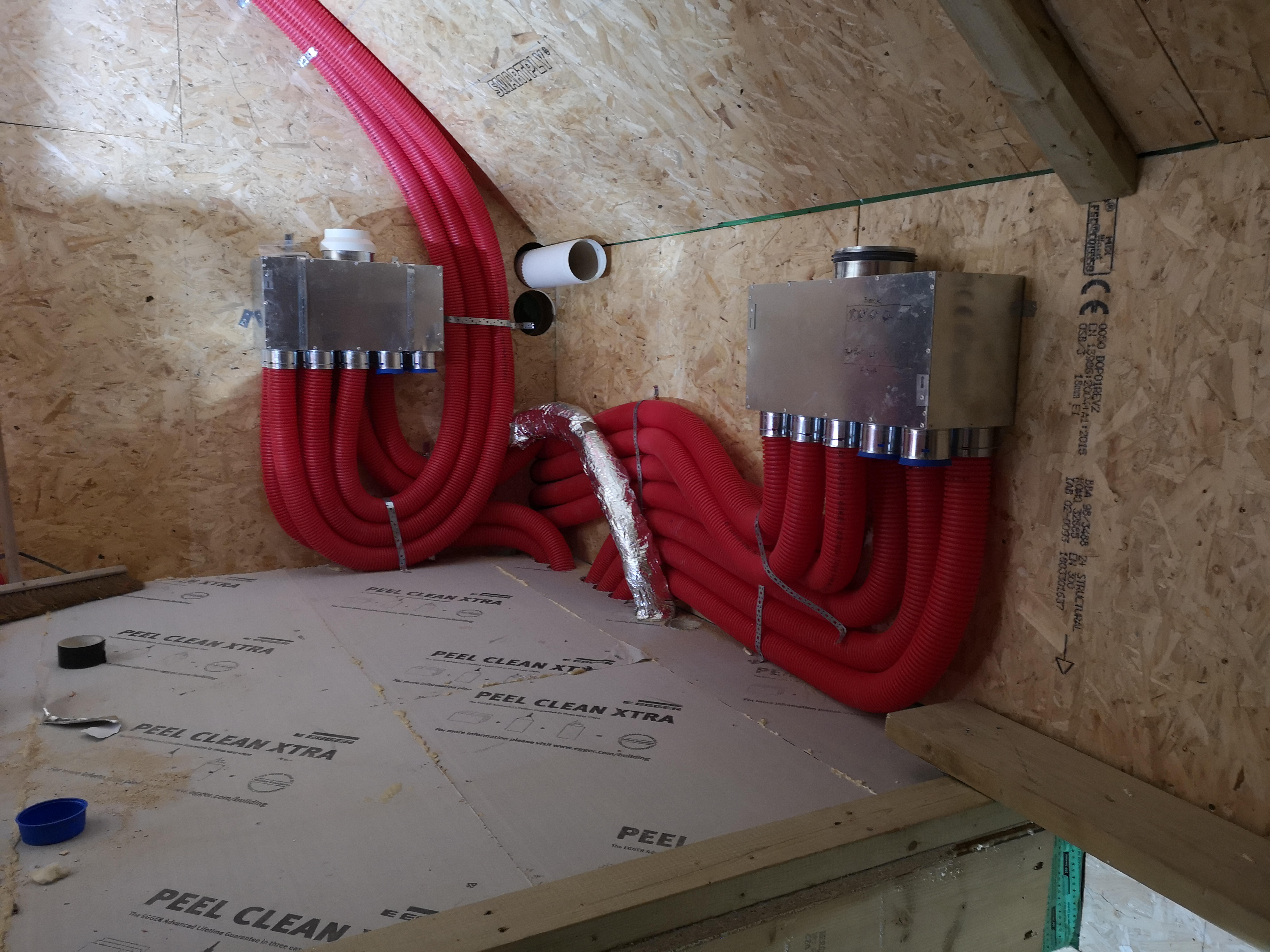

Construction Channel Posted March 27, 2019 Author Posted March 27, 2019 Instead of getting on with the big flow and return ducts. I decided to have a beer and share the monstrosity that is my mvhr manifolds ? 2
