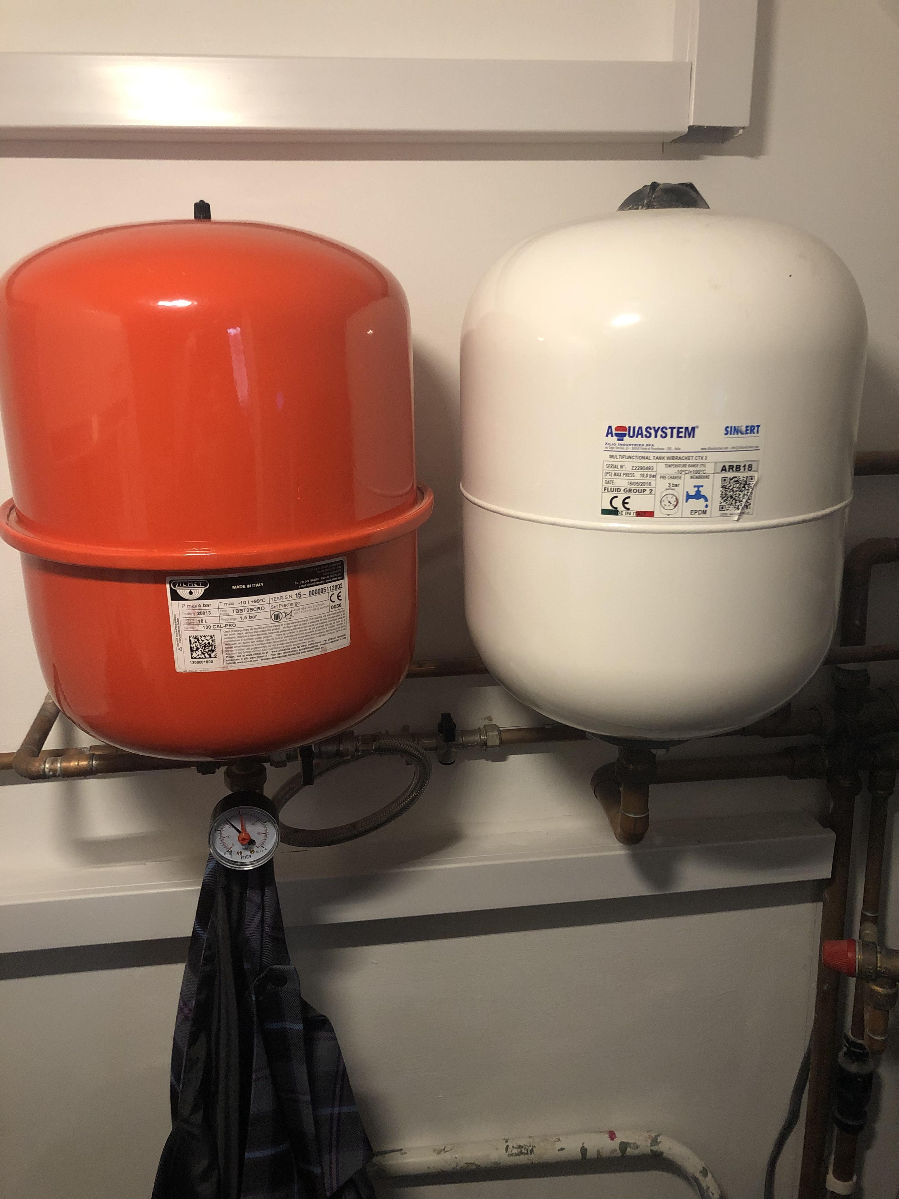

Ian Nixon Posted December 23, 2018 Author Share Posted December 23, 2018 Yes a pump that sits on the ufh manifold. no filter in the system. I think I’m going to check if there is one in the ashp outside itself. whats a buffer tank in the system. I do have 2 small tanks? Not sure what there for. I think one is to pressurises the system but not sure on other. Will get photos in a bit. Link to comment Share on other sites More sharing options...

Ian Nixon Posted December 23, 2018 Author Share Posted December 23, 2018 What is the creamy/white colour cylinder please? Link to comment Share on other sites More sharing options...

ProDave Posted December 23, 2018 Share Posted December 23, 2018 They are both expansion vessels. One will be for the heating system, probably the red one, and one will be for the unvented hot water tank, probably the white one. Turning the pump up higher is an obvious thing to try I would run it as fast as you can without it becoming too noisy. Link to comment Share on other sites More sharing options...
