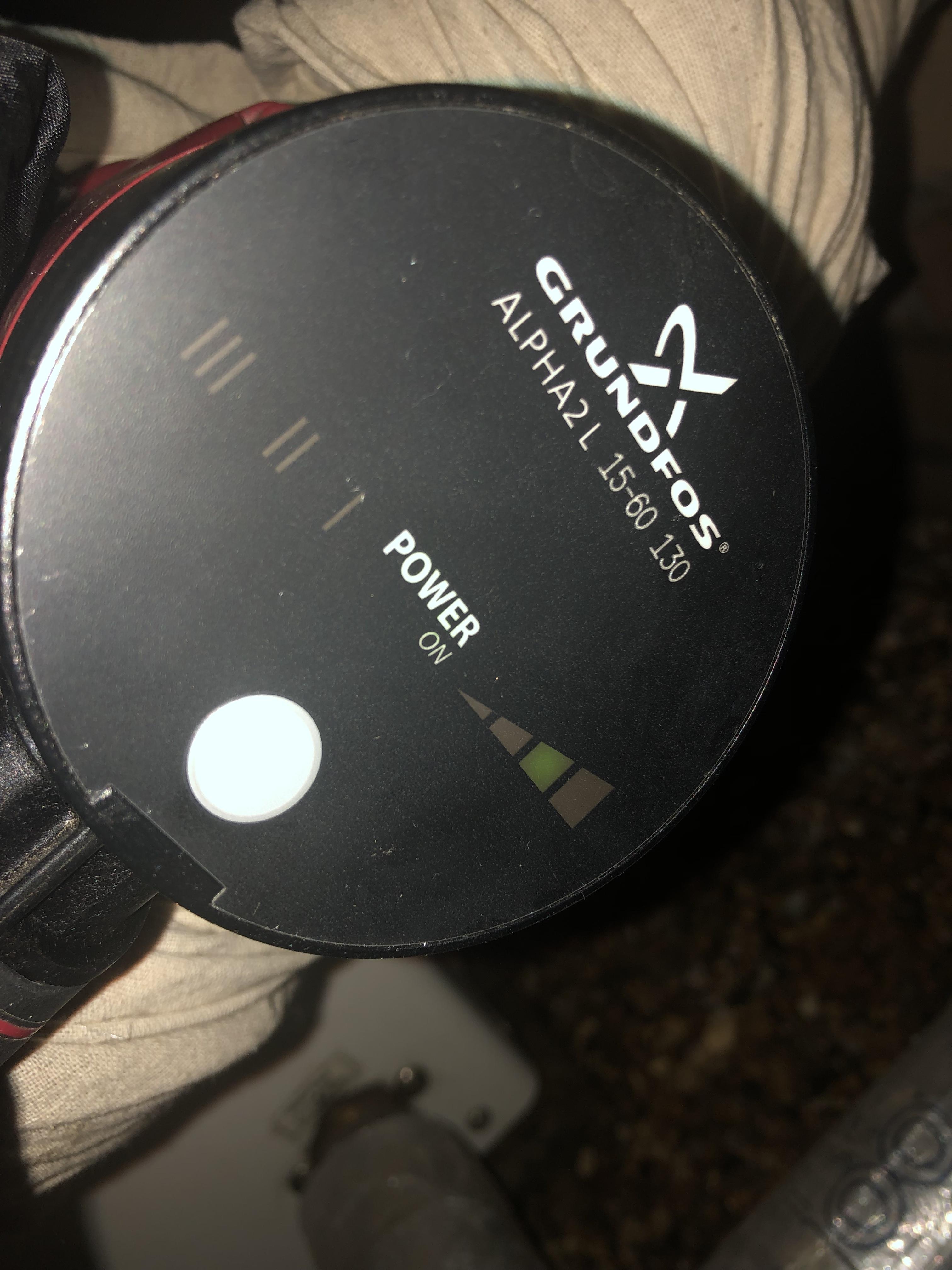

  • Mine had 4 setting, low to high. If it’s in the lowest click it up a setting and try the system out. If it trips, click it up a setting, and so on.

Hi all, ok I haven’t turned up the ashp Pump speed yet but will do but if I keep on the timer switch for hw as always on I don’t get the error but what I did notice is though the ashp isn’t operating so no need for heat or hw, the pump on the outside so next to ashp it’s always running?????  Sure if don’t need hot water should this be running 24/7.
On 23/12/2018 at 16:37, Ian Nixon said:
What I might do sometime is photo all my system and you can hopefully tell me if I have the necessary parts fitted.
many thanks to all
Did you try the faster pump speed?
Have you actually been present to see what actually happens at the instant it throws up the error?  I had a most peculiar intermittent fault on mine that I only solved because I just happened to be in the plant room when I heard it start up spuriously (when it should have been off) and then trip out.
No I haven’t tried the faster pump speed.  I will do that tomorrow and let you know.
Thank you
It was on high when I checked.  But something strange going on, I switched water off like I said I had done and then it puts the error up.  When I went through settings on pump still error but then when I got to number 3 setting which is just high like on a normal pump the error went and it started.  I switched off the air source heat pump a couple of times and now guess what I put the pump back on the setting I had it on and now no error when I have water on timer?  What the hell is all this about.  It sounds more like electrical to me????

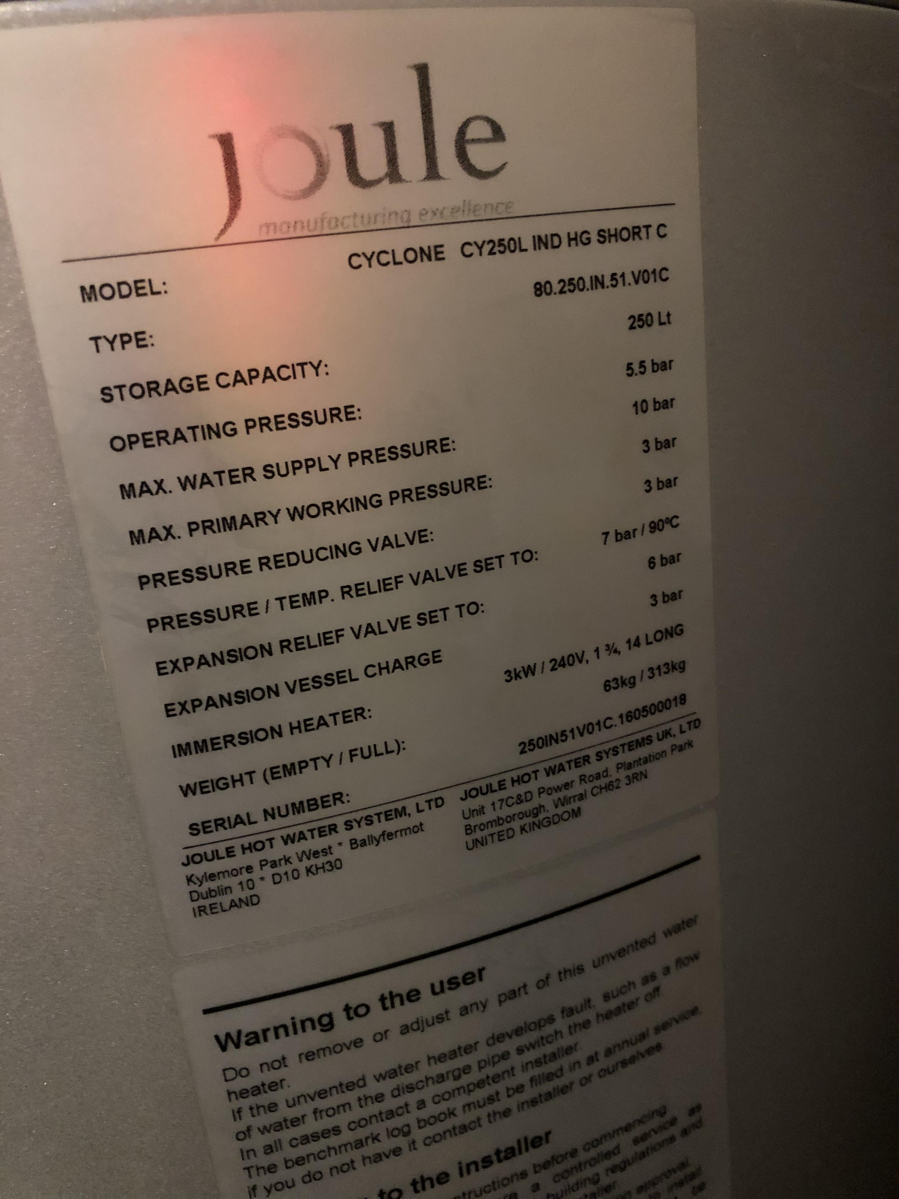

Further update if people can help please?  I have the wrong hot water tank installed.  Aparently it should be one for an ashp as they are different, can anyone offer advice please.  See picture of mine.
The difference with a "heat pump" hot water cylinder, is the input coil is larger.  With the Telford one I have it goes pretty much top to bottom of the tank, and is corrugated to increase the surface area.
As I understand it this means you can heat the tank to a given temperature with a lower temperature of input water.
I don't see how this can relate to your flow rate error, but it could result in the return temperature  being too high and a different error.  Or it will just take longer to heat the hot water.
Aparently it’s not good though having this one fitted.  Will be costing me more and not efficient?  It’s not got a stat fitted either so everything wrong with it really.  Also supposed to have a filter fitted on the return to ashp but it hadn’t so think a bit of a refit is needed.  Will the right tank make all the difference do you think??
I have never seen an UVC without a tank thermostat, that is one of the essential features I thought they all had to have.  Even though mine does not routinely use the tank stat to control temperature (it has a separate temperature probe for that) the tank stat is wired to kill power and close the 2 port valve feeding the cylinder if it gets too hot.
There must be an interlocked thermostat with a resettable over temperature function on a UVC to meet Part G of building regulations.
@Ian Nixon who installed this and signed it off ..??
Is this it but I’m unsure why my heating engineer keeps saying I need one?
