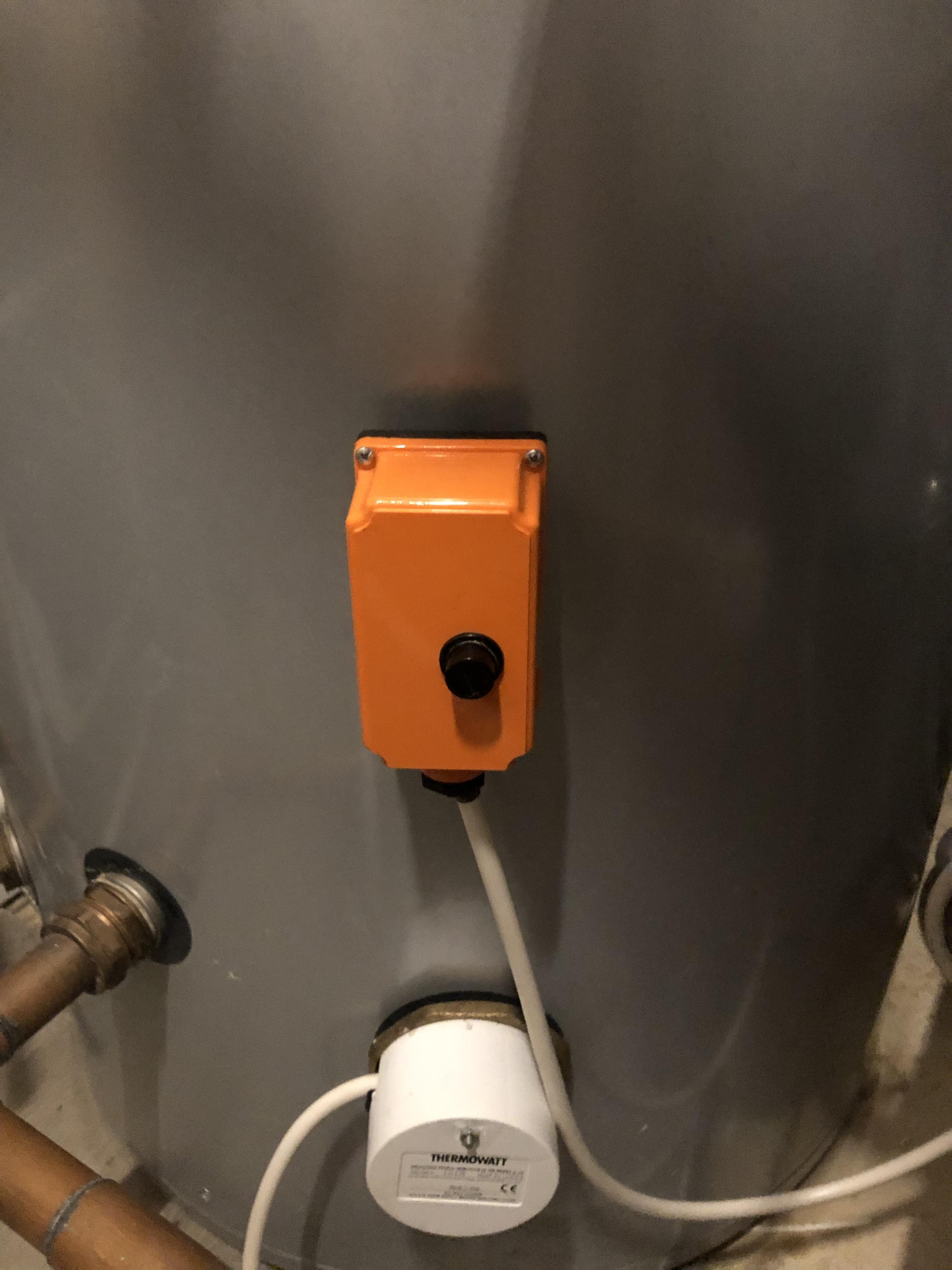

10 minutes ago, Ian Nixon said:
Is this it but I’m unsure why my heating engineer keeps saying I need one?
That looks like the safety overheat thermostat. If it trips, you unscrew that little black thing and it reveals a reset button.
But normally there are 2 thermostats, one that the user can adjust, and this last resort cut out. Often (usually) they are in the same case together.  It does seem odd you don't appear to have that one.

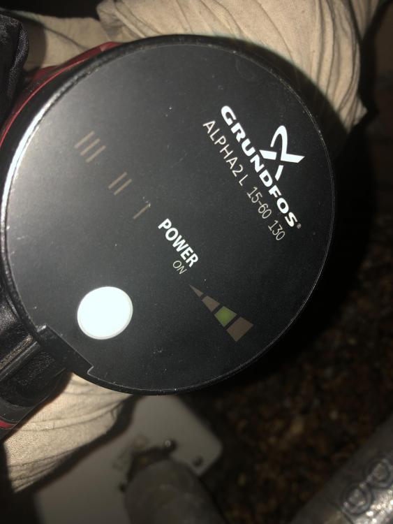

So my engineer is correct then.  I only have this one fitted.  Hence why when I have hot water timer on, the pump never stops and costs me lots but if I put the hot water on the time I go back to the bloody beginning of why I posted with the sodding EE-03 error.  I’ve tried speeding up the pump.  Not having the heating and hot water running together?  And some other adjustments.  It’s a bloody nightmare.

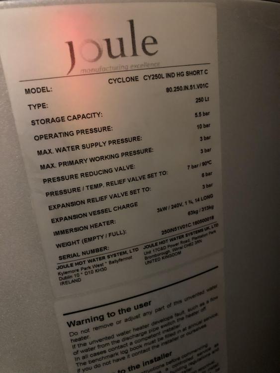

So if that is correct, and heating the hot water  is just by timer then you can’t be running a setup that meets the G-3 regs - do you have a benchmark book or installation certificate..?
Sorry don’t know what you mean by just heating hot water by timer?  What ways are there???????
Timer and thermostat - need to be tank controls to regulate the tank temperature.
Who installed all of the tank and ASHP..?
Could it be like mine, that the HP manufacturer provides a temperature probe that goes into a spare thermostat pocket on the hot water tank so does not actually use the standard tank thermostat?
What else is connected to that tank?
There is nothing else except the immersion heater.  That’s all.
im getting a stat fitted so that will sort that problem out.  But I’m still passed about the EE-03 error.  I think change the sensor is next thing but then I’m sure it will do it all the time if it was this and not just when HW is on timer ?????

What I am trying is turning off the upstairs heating which is the rads, this might be where the problem lies?  Just trying something.
