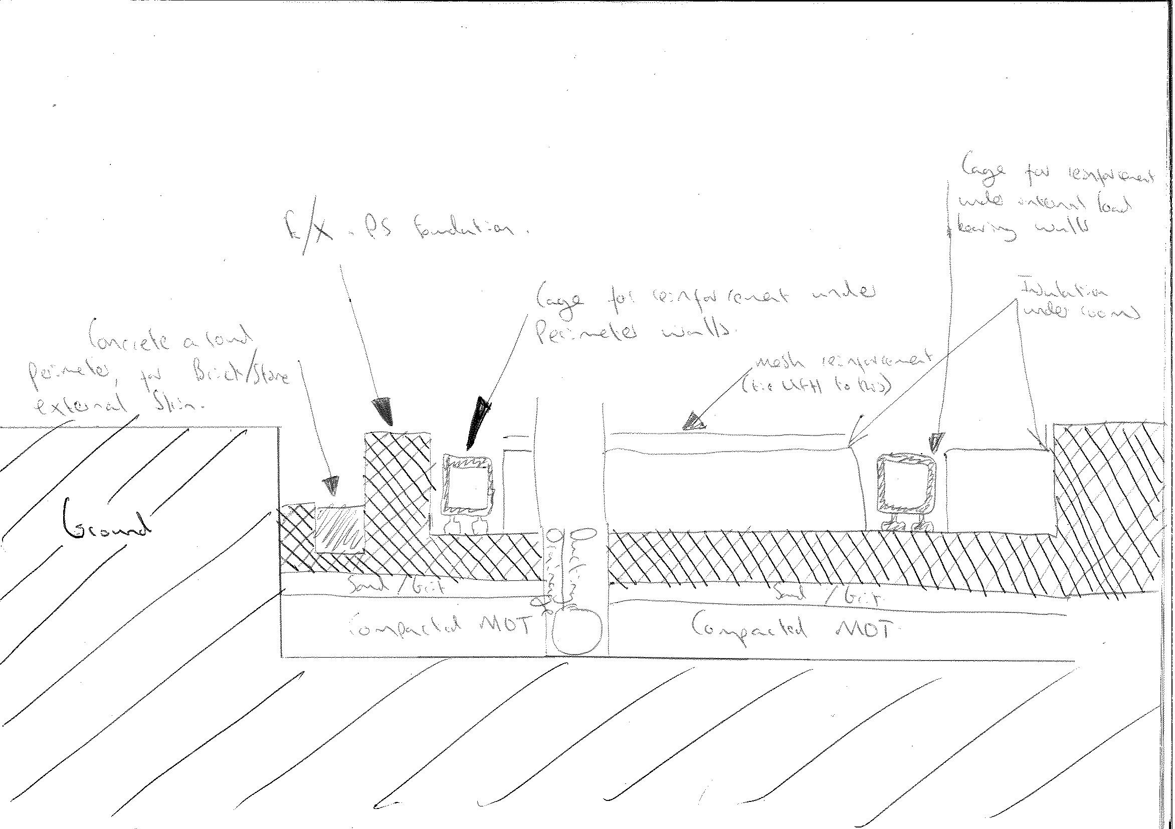

Big Neil Posted December 18, 2018 Posted December 18, 2018 Firstly I had no idea the already terrible sketch would scan so badly (my apologies), however for anyone who can make out the scribbles, have i got this more or less correct? the one thing I forgot to add whilst building this up was a DPM. Should this be immediately on the cross hatched area? Second and third pages are the same but relate to how I understand an ICF structure should go atop such a foundation. Is this also correct? Foundation.tif

willbish Posted December 18, 2018 Posted December 18, 2018 Its quite difficult to make out your scan. Here's a drawing I did of my passive slab. The hardcore layer needs to extent beyond the edge of the insulation which isnt shown. Part of the reason I chose Isoquick was because the concrete has 300mm under all areas. Some other systems have less insulation around the ring beam. Foundation Section.pdf

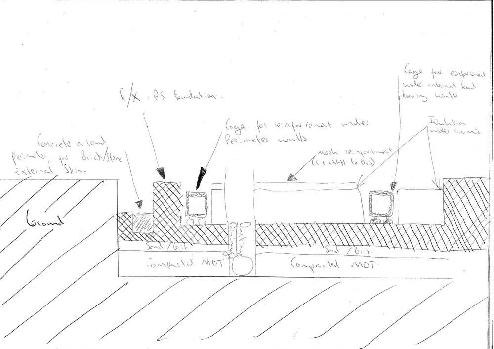

Big Neil Posted December 18, 2018 Author Posted December 18, 2018 boooom - any better for people??? 1

Big Neil Posted December 18, 2018 Author Posted December 18, 2018 To add to the original post, if the cage part of things is correct, could one forego the need for mesh over the rest, by use of fibre/micro re bar? This way @JSHarris, could one then staple to the insulation and THEN pour. Might even reduce the likelihood of abrasion.

Russell griffiths Posted December 18, 2018 Posted December 18, 2018 2 minutes ago, Big Neil said: To add to the original post, if the cage part of things is correct, could one forego the need for mesh over the rest, by use of fibre/micro re bar? This way @JSHarris, could one then staple to the insulation and THEN pour. Might even reduce the likelihood of abrasion. You won’t have a problem with abrasion unless you leave the pipe in place for too long, fit it and concrete in a week or two and no problems. I belive you get better heat transfer and a quicker reaction time if the pipe is in the middle of the slab. Tbh, at the end of the day it will be down to your structural engineer to design your slab according to you soil survey and site conditions.

TerryE Posted December 18, 2018 Posted December 18, 2018 (edited) @Big Neil, designing a passive slab is not something that should be done on the "back of a fag packet". If you get it wrong then you might never get the BInsp to sign off on it, and more to the point your house might be structurally unsound. You really need to have this done by an SE experienced in slab design. So you need to find such an SE to do this. If you want then a few of us have constructed our houses this way and can give you our SE details. There are too many variables here for there to be a stock answer. For example our SE required us to do a soil survey because the type of base materially effects the under-slab preparation: whether it is clay or sand, and the sub type, moisture contents, proximity of trees, etc. Any differentials across the site can be critical to whether a passive slab can be used and how deep the foundation layers need to be. The last thing that you want to happen is that you get any differential slump across the slab during pour. This can and has happened. My slab had to support an outer stone skin; Jeremy's didn't: we had to have internal load bearing cross members. The slab has to have a design than is demonstrably compliant to B Regs; it has to work both structurally and thermally. Edited December 18, 2018 by TerryE 2

willbish Posted December 18, 2018 Posted December 18, 2018 (edited) 2 hours ago, Russell griffiths said: I would like to add a point about icf and a slab that has underfloor heating pipes in it @willbish and @Big Neil i have just done a pour for my icf walls and found the propping system for the walls required over 120 holes to be drilled into my floor to hold the props up. Make sure you have thought of a way to hold these props up if you have pipes installed I've left a 75mm perimeter gap between inside skin of ICF walls and first UFH pipes. I'm going to fix scaff boards down at one end for the props to sit on. Like Russ says many many different ways to do it. The added faff of messing about with scaff boards out weighs cost of UFH in separate screed in my case. Edited December 18, 2018 by willbish 1
willbish Posted December 18, 2018 Posted December 18, 2018 1 hour ago, scottishjohn said: were you foreced to have the raydon sump? Yes, high radon area and full protection measures required. I agree the effectiveness of the sump is questionable in that location. I didn't want to cut a hole and a channel into my insulation to accommodate just below the slab, so I proposed placing it in the Type1 to Building Control who were happy. 37 minutes ago, recoveringacademic said: Pick your fights: this isn't worth fighting about And all for £14 and a trench Exactly ?
