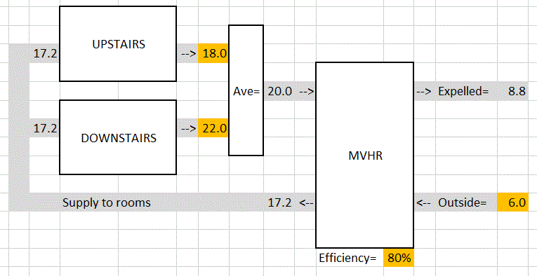

joe90 Posted December 13, 2018 Posted December 13, 2018 As some will know we have only recently finished (well nearly) our build and moved in, heating been working for a couple of months and gradually getting it trimmed. I have been a little dissapointed that with UFH downstairs only and electric towel rads and electric UFH in our en suite the upstairs room temp is a little low. Downstairs stays between 20’ and 22 but upstairs is between 16 and 18. I have just measured the air temp coming out of one of the bedroom terminals and it’s 16’. I would have thought that with 20’ downstairs I would be getting warmer air delivered upstairs. It is currently 6.6’ outside so is the temp uplift from the lossnay MVHR about right?

jack Posted December 13, 2018 Posted December 13, 2018 I knocked up a spreadsheet in summer when I was trying to understand how cooling downstairs affected the upstairs temps. You basically fill in the orange boxes with starting state, and see what the impact is on other temperatures. Assuming 80% efficiency, 6 degrees outside, 18 degrees upstairs and 22 degrees downstairs, you can see that the temp of the supply air is actually only 17.2 degrees, so : Bumping efficiency helps - at 90%, the supply temp is 18.6 degrees. Lots of assumptions in this, but as a coarse model I've found it interesting to play with. The other thing is that towel rails and other forms of bathroom heating only heat air that's already passed through the bedrooms. While they'll have an impact on the temperature of the supply air due to the MVHR heat exchanger, half of the heat they supply will end up in the supply air to downstairs. Our bedrooms are at about 20 degrees at the moment. Great for sleeping, very slightly cooler than would be ideal for getting out of bed in the mornings. 2

AliG Posted December 13, 2018 Posted December 13, 2018 That is similar to what we see with out MVHR, the incoming temperature is increased from a low outside temperate, but not to the same temperature as extract air. I don't think 90% efficiency means that you get 90% of the temperature of the extract air, you would have to calculate the energy capacity of air which would probably be based on its temperature in Kelvin. Also I assume that some of the extract air is coming from colder upstairs rooms such as bathrooms. Basically when there is a 15C+ temperature difference between inside and outside air MVHR will help but you will probably still need some heating. @Oz07 that's freezing!

ProDave Posted December 13, 2018 Posted December 13, 2018 On 13/12/2018 at 17:17, joe90 said: Ah, @AliG not thought of that, go to the top of the class. Expand I made that point in post #2, and Jack explained it with a spreadsheet in post #4 1

Ed Davies Posted December 13, 2018 Posted December 13, 2018 On 13/12/2018 at 17:11, AliG said: I don't think 90% efficiency means that you get 90% of the temperature of the extract air, you would have to calculate the energy capacity of air which would probably be based on its temperature in Kelvin. Expand It should be 90% of the temperature of the extract air relative to the outside air (not absolute zero) if the flows are balanced, there's no condensation going on and so on. e = (Ts - To) / (Te - To) where: e = efficiency (as a proportion; multiply by 100 to get percent, of course). Ts = supply air temperature (air going into the rooms from the exchanger). To = outside temperature (air going into the inlet from outside to the exchanger). Te = extract air temperature (air going from the rooms to the exchanger). The exhaust air temperature (air going from the exchanger to the outside) doesn't matter, that's lost and gone. So: Ts = e × (Te - To) + To or, if all temperatures are measured relative to outside, it's simply: Ts = e × Te 2

Ed Davies Posted December 13, 2018 Posted December 13, 2018 Suppose @joe90 's problem is imbalanced flows, how imbalanced would they have to be to see the temperatures he reports with decent efficiency in the actual heat exchanger? Suppose x is the eXtract airflow (kg/s or whatever) and y is the supplY airflow. Then the efficiency would become: e = [y × (Ts - To)] / [x × (Te - To)] The (im)balance ratio would then be: y/x = e × (Te - To) / (Ts - To). He says downstairs stays between 20 and 22 and upstairs between 16 and 18. Let's assume 21 downstairs and 17 upstairs with equal extracts from each so an average of 19 °C. His supply is at 16 °C and the outside air at 6.6 °C. Assuming 90% or 95% efficiency for the heat exchanger gives: y/x = 0.90 × (19 - 6.6) / (16 - 6.6) = 1.187… y/x = 0.95 × (19 - 6.6) / (16 - 6.6) = 1.253… In other words the supply airflow only needs to be 18 or 25% more than the extract airflow for 90 or 95% exchanger efficiencies respectively to get this somewhat disappointing supply air temperature. I'll admit to being a bit surprised, my hunch before doing this calculation was that it would be more like 50% difference. If only @SteamyTea had put some temperature sensors in @joe90's ducts ?

Ed Davies Posted December 13, 2018 Posted December 13, 2018 Yes, he mentioned the sensors in an email about something else (refrigerators). Are they logging to anything, yet? Bottom line, an imbalance of 20% or so between your supply and extract airflows could knock the supply temperature down as much as you seem to be finding.
