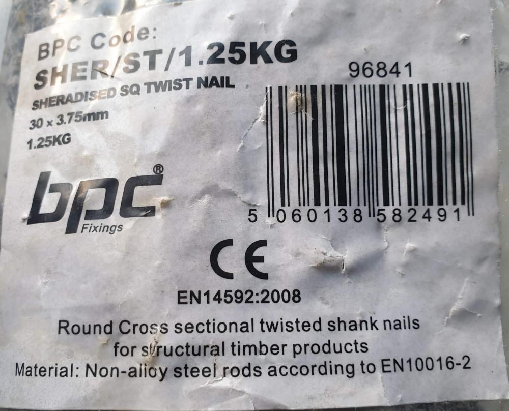

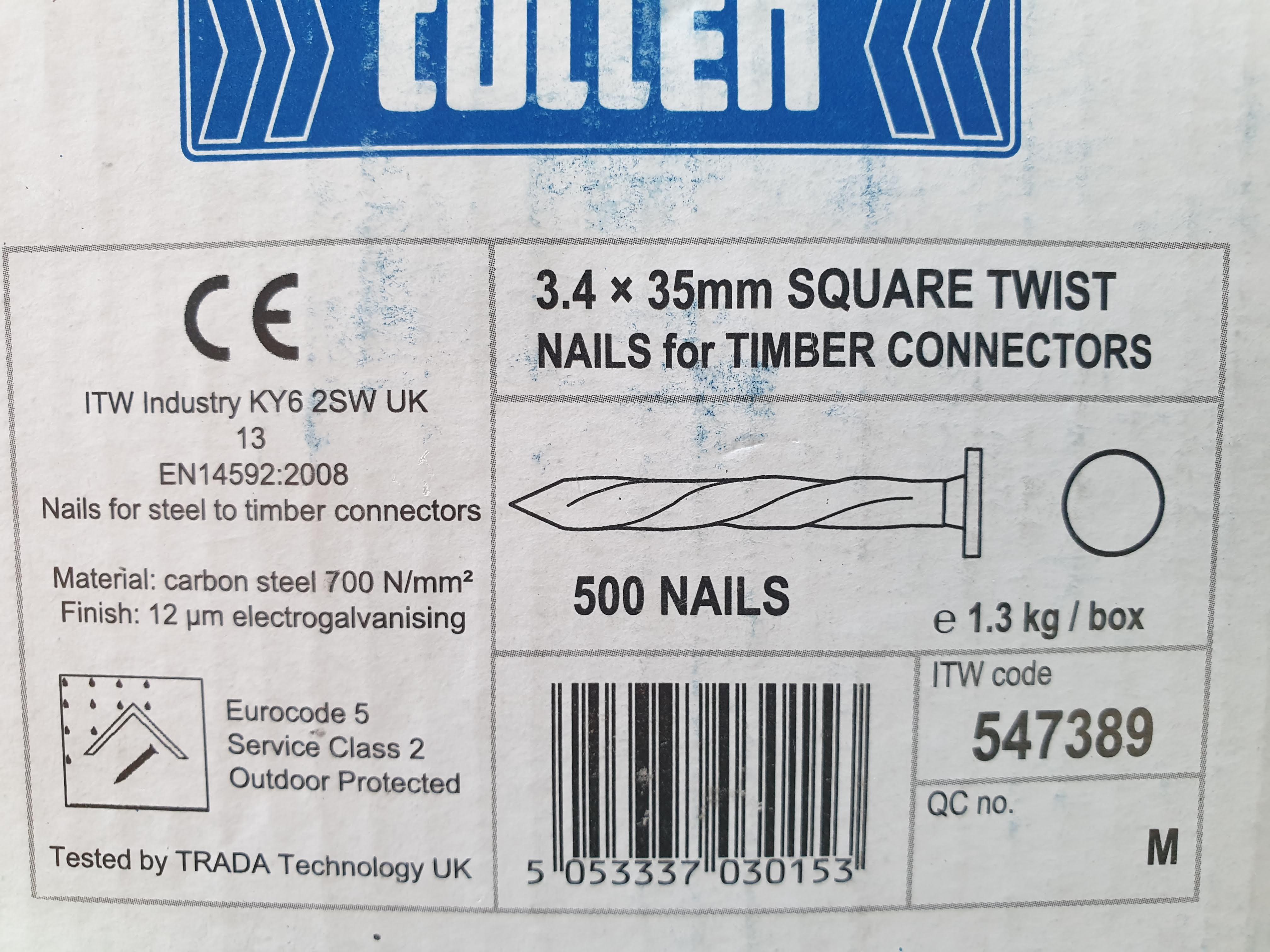

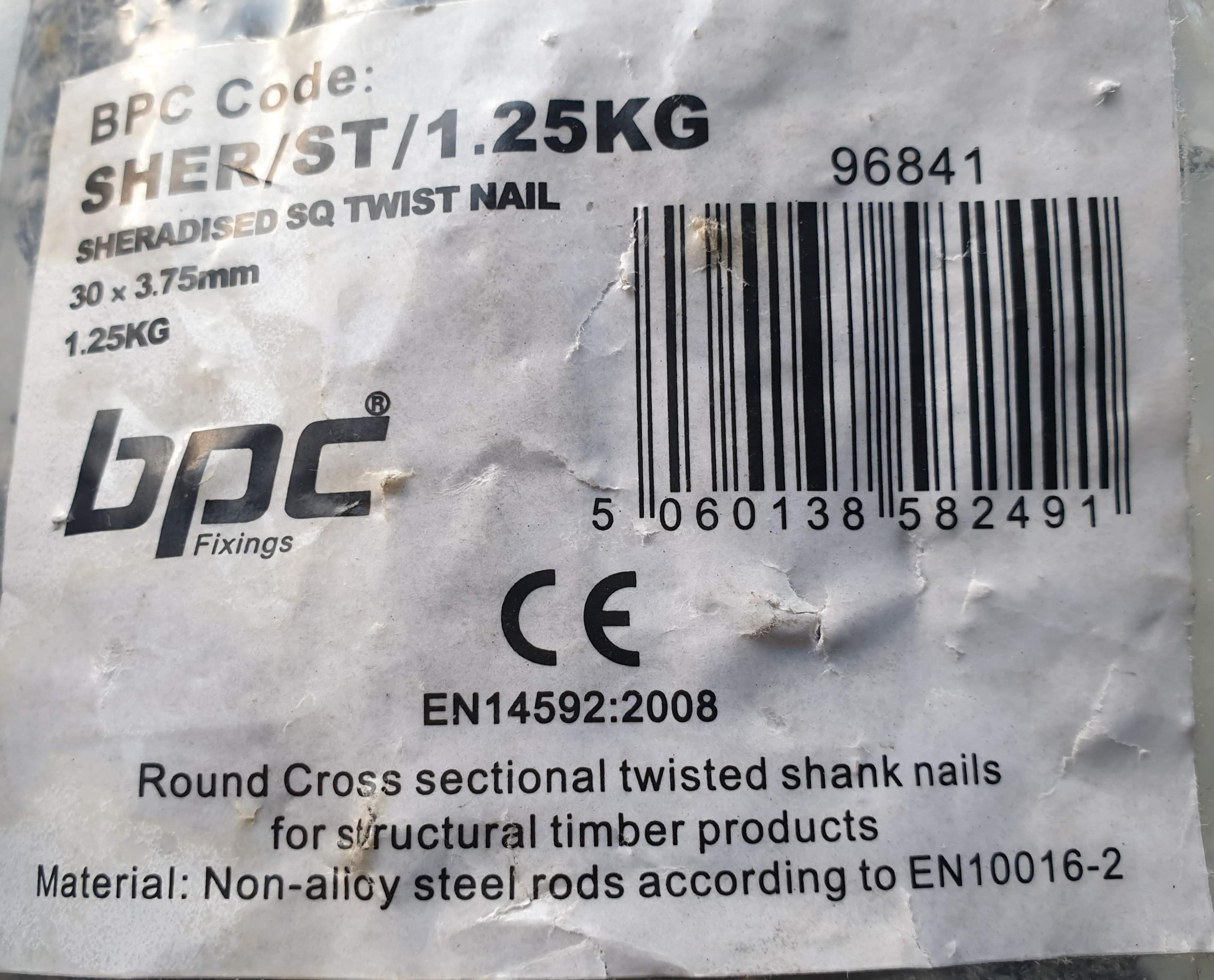

ToughButterCup Posted December 7, 2018 Share Posted December 7, 2018 Lucky this brouhaha about joists blew up. I wouldn't have noticed one little detail which, had a BCO picked it up I would, I suspect have been wailing and gnashing my teeth. ToolStation touts these nails as suitable for all (my emphasis) roofing applications that is 30 by 3.75..... Oh Yes they are! Oh no they aren't ('Tis the season innit.......) Had the POSI joist picnic not occurred, I would not have picked up that I need this spec... or 35 by 3.4 If you can buy these off the shelf, I take my hat off to you. I had to pop down to Cheshire Roof Trusses and pick some up today. Steve Grice , the designer there, was quite clear that I did in fact need these nails. Pushing on an open door with me... I just don't have the gall to pop down to TS and buy nails of a near-enough spec. Anyone know what building risk (as opposed to regulatory risk) I would be taking by using the shorter, fatter TS nails instead? Link to comment Share on other sites More sharing options...
joe90 Posted December 7, 2018 Share Posted December 7, 2018 I must confess I used 30mm twist nails on mine, no one said differently ?(but I did use all holes?), try these https://www.orbitalfasteners.co.uk/en/products/40mmx3-75-gauge-galvanised-square-twist-nail-1-0kg-pack-approx-300-nails-per-pack-?utm_medium=google_shopping&utm_source=google&utm_campaign=google_shopping&gclid=CjwKCAiA0ajgBRA4EiwA9gFOR1oirql552Shmf3eAhfR8mx7hyzJ_V92MwQLPVJjuXB_ekfb4QAv_hoCZQEQAvD_BwE Link to comment Share on other sites More sharing options...
Russell griffiths Posted December 7, 2018 Share Posted December 7, 2018 40mmx3.75 available on e bay. Timco, a good make. Link to comment Share on other sites More sharing options...

ToughButterCup Posted December 7, 2018 Author Share Posted December 7, 2018 Hmmm. £10 from Cheshire Roof Trusses. The point for me is the difference in specification. It's tiny. Anyway: live and learn........... Link to comment Share on other sites More sharing options...
