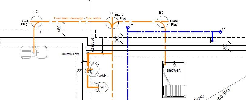

Tin Soldier Posted December 3, 2018 Posted December 3, 2018 Evening all subsequent to a fallout with the builder who was going to be doing my drainage and front steps, looks like I’m on my own so drains are in the building and exit concrete slab internally externally I have nothing yet- other than the bits and pieces simple question first my plans show a gulley trap for kitchen sink, and the showers it shows the toilets connecting straight into the waste is this right? Sinks need gulley traps? Even though the wast pipe exits way below ffl thanks scott
CC45 Posted December 3, 2018 Posted December 3, 2018 yes, correct - sinks & showers have traps to stop poo smells getting into the room while toilets have their own trap - lift the lid and look into a toilet.
Temp Posted December 3, 2018 Posted December 3, 2018 They need not be external gully traps. We have traps (u bends) under the sink then down into a 110mm via an adaptor. Then under the floor into a manhole outside.

Tin Soldier Posted December 4, 2018 Author Posted December 4, 2018 stupid stupid question the gulley traps do they need the hopper on top as you normally see 40mm waste going into or are the traps buried, with no hopper as the waste pipe exiting the building is 110mm

PeterW Posted December 4, 2018 Posted December 4, 2018 21 minutes ago, Tin Soldier said: stupid stupid question the gulley traps do they need the hopper on top as you normally see 40mm waste going into or are the traps buried, with no hopper as the waste pipe exiting the building is 110mm Needs a picture here. You don’t need to do the traditional waste out of the wall into a gully as long as there is a method to rod or clean the waste from one end. You can take a waste underground if you want but the recommendation is min 50mm and better 110mm. You can also use a bottle trap for the wastes outside - as long as there is a water seal, that is 75mm of standing water in a bend or trap - then smells can’t get into the house or out from the drains.
Tin Soldier Posted December 4, 2018 Author Posted December 4, 2018 I had two mins, so here is an excerpt from plans (you can see gulley trap noted at sinks) you can see rodding access then you have my mspaint rough an ready drawing
Temp Posted December 4, 2018 Posted December 4, 2018 (edited) If you already have 110mm pipe through the founds for the sinks and showers then you could replace the gully traps with inspection chambers. You would need u-bends under the basins and a trap under the shower as well. Perhaps this would mess up plans for a nice patio? Something like this if the falls are ok.. Notes: I've shown an inspection chamber in the middle as well because personally I wouldn't be happy with the buried "T-junction" and rodding eye shown originally. You may need more blank plugs than I've shown. It depends on how many branches there are on the IC bases. Edited December 4, 2018 by Temp
Temp Posted December 4, 2018 Posted December 4, 2018 (edited) The 100mm svp in the corner of the bathroom is probably a stack but I just noticed it says "222 (svp)" and "572 (svp)" in the middle. What's that all about? It also says "Foul drainage - see notes" what do they say if anything? Edited December 4, 2018 by Temp
Tin Soldier Posted December 4, 2018 Author Posted December 4, 2018 Hi no problem with patio unfortunately I already have rodding eyes,, traps etc, so inspection chambers would add cost - possible I could go ahead and buy them though not sure on the 222, I think that might be wall width as its where two structures meet nothing in the notes of any interest in terms of 'foul drainage;
