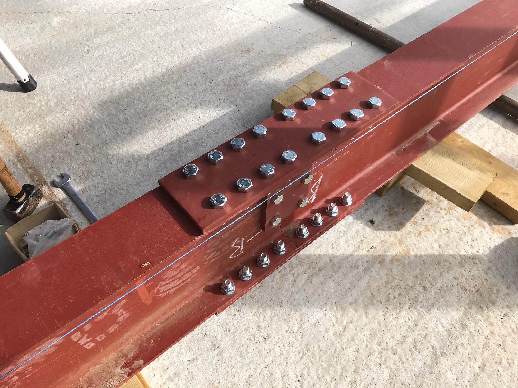

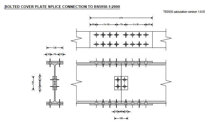

Nestor Posted November 29, 2018 Posted November 29, 2018 I have 10.5m steel spliced together with cover plate as the drawing enclosed. Unrelated to Glulam but might be helpful. 1

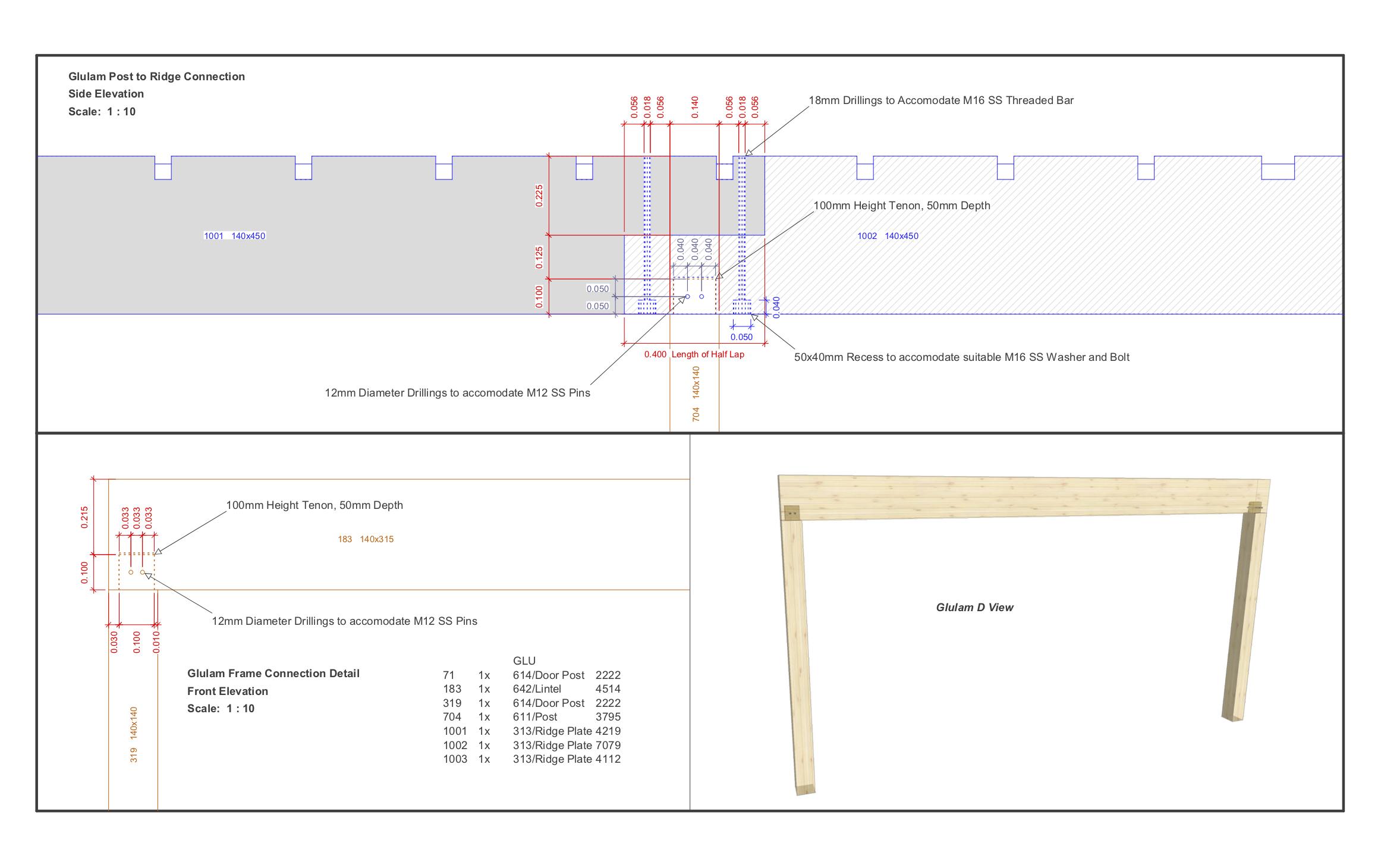

bissoejosh Posted November 29, 2018 Posted November 29, 2018 (edited) Do you definitely want to use joining plates? We've got a 140x450mm 14.9m glulam ridge beam that came in 3 pieces, one join supported by a wall the other a 140x140mm glulam post. The main beam is half lap jointed. No steel other than the threaded bar. Our post is a mortice and tenon join all pre cut. I can attach the engineering markups if it helps? Edited November 29, 2018 by bissoejosh 1
Russell griffiths Posted November 29, 2018 Author Posted November 29, 2018 Ooh Er that sounds good @bissoejosh my beam is about 17 m long 140 wide depth to be confirmed it will be split into 3 pieces with the two joins sitting on 140x140 posts and both ends into the walls i had imagined a dirty big plate bolting it all together, but a hidden join would be nice also. A drawing would be most appreciated.
bissoejosh Posted November 29, 2018 Posted November 29, 2018 1 hour ago, Russell griffiths said: Ooh Er that sounds good @bissoejosh my beam is about 17 m long 140 wide depth to be confirmed it will be split into 3 pieces with the two joins sitting on 140x140 posts and both ends into the walls i had imagined a dirty big plate bolting it all together, but a hidden join would be nice also. A drawing would be most appreciated. Here is the assembly drawing for the ridge beam element and supporting post. The same mortice and tenon join is used on our glulam frame for our sliding door opening (4210x2110mm) also pictured. I've also got the original engineering sketches but I don't think they show any more detail. 1

scottishjohn Posted November 30, 2018 Posted November 30, 2018 not happy on that half lap joint --the pillar is not under the left hand side of the half lap --so that beam is all hanging on half its depth make the support post wider to support left hand side and it would be fine. you paid this engineer for this solution?
bissoejosh Posted November 30, 2018 Posted November 30, 2018 Yes, paid an engineer who works alongside the design firm that did our timber frame and then had the whole lot CNC cut from machine file. All signed off by building control etc.
Nickfromwales Posted November 30, 2018 Posted November 30, 2018 14 minutes ago, scottishjohn said: not happy on that half lap joint --the pillar is not under the left hand side of the half lap That’s a standard detail. Look at how purlin struts have been done for eons. They’re all still up, and all those guys had back then was a bow saw and a hip flask.
