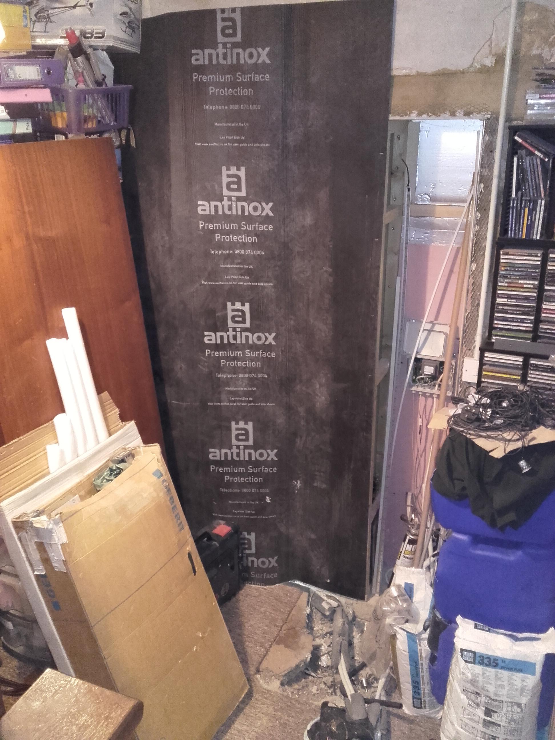

Onoff Posted November 29, 2018 Posted November 29, 2018 7 hours ago, ProDave said: We have a cardboard door on the bathroom. You're posh up there, mine's a sheet of Antinox!
