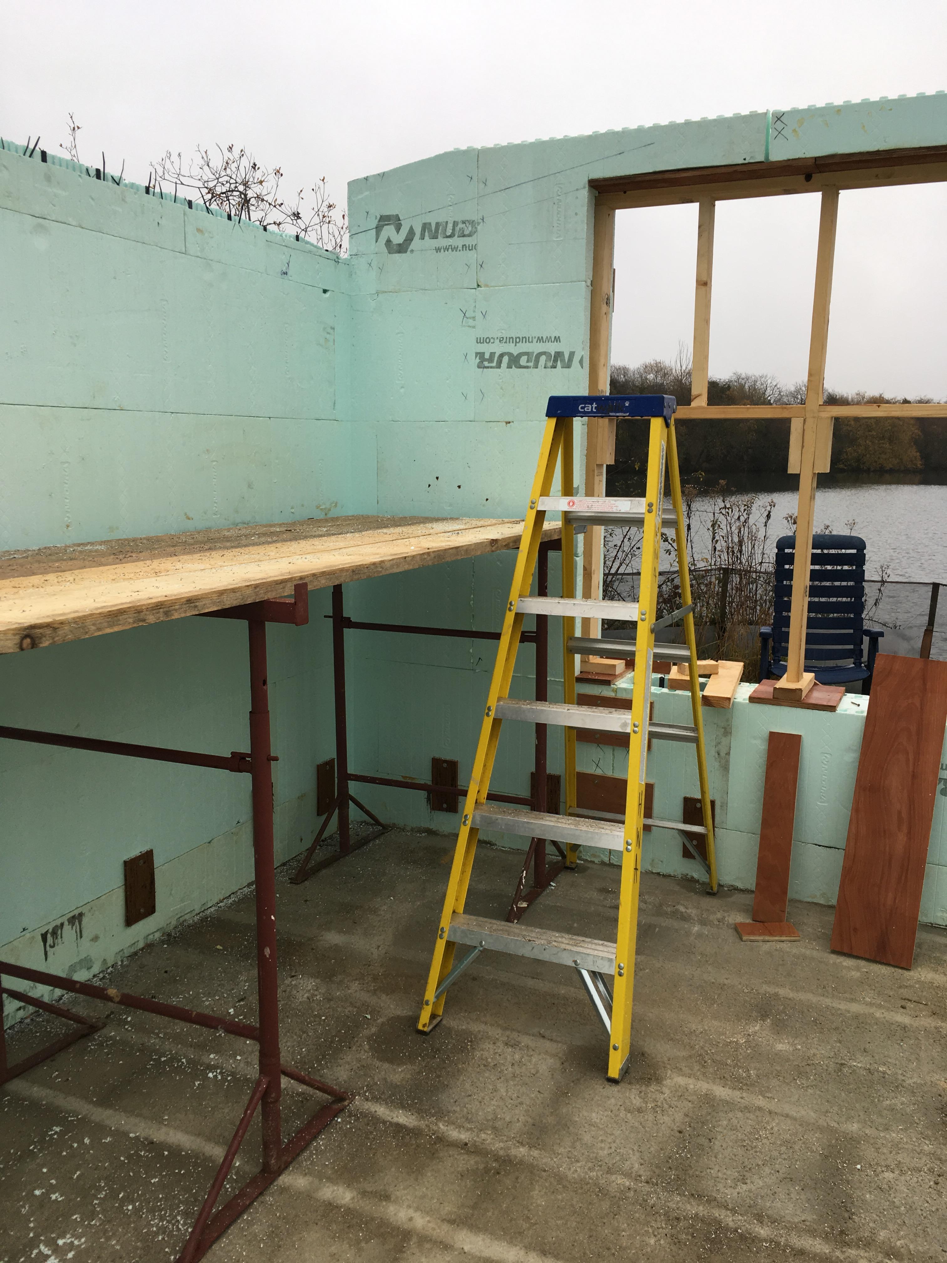

ToughButterCup Posted November 27, 2018 Posted November 27, 2018 Gottda face it, my knees are shot. They're has-been-knees, dead knees; I know a dead knee when I see one and I can see two of them now (well it's early). Getting up and down from the trestles (as opposed to a scaffold - there's progress for ya!) I wobble like a jelly, not having the courage at the top of the steps to press hard with just one knee. How do I safely get up on to a trestle? Yes: I know use a ladder: but how do you fix the ladder solidly so that transitioning from the ladder to the planking is safe and steady? I need a handrail-grab-thingy....
Declan52 Posted November 27, 2018 Posted November 27, 2018 A tall step ladder like a spark would use. Use some rope to tie it to the trestle so it won't push out when you get on it to get down.

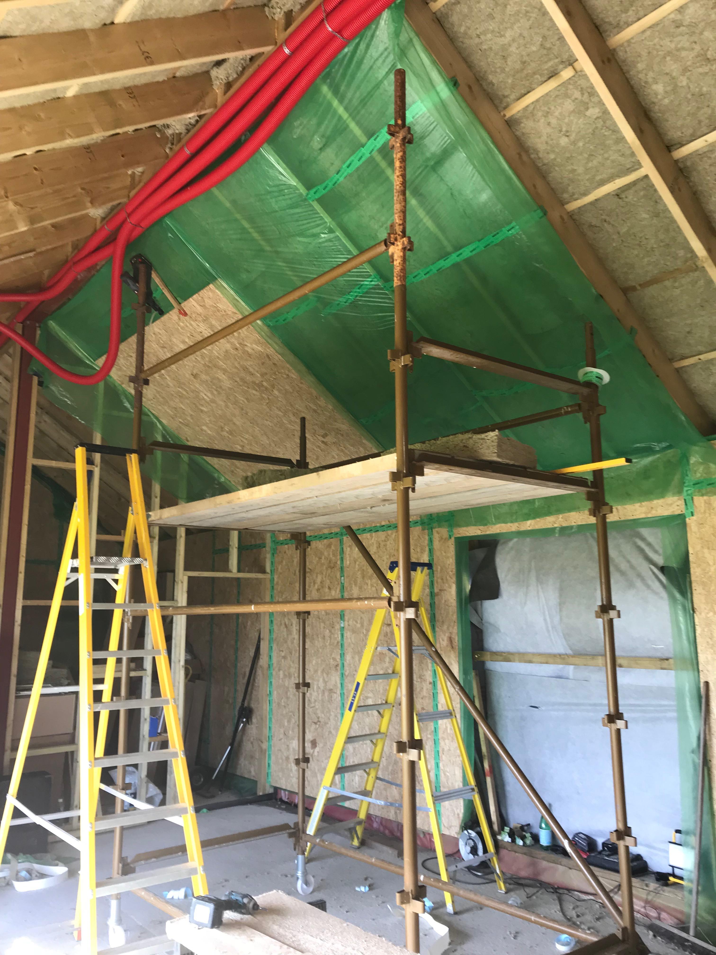

joe90 Posted November 27, 2018 Posted November 27, 2018 (edited) Rather than trestles I use scaffold tower sections, multiples of 2’, dont put the boards on the top, one or two layers lower then you have a handrail either side. I have a short ladder that I tie on to climb up. Advantage also is you can drag the whole thing around whereas trestles you have to dismantle. If you have a long section (conservatory guttering for example) two short towers and planks between. A year ago my knees were fine but this year so much worse, my tower is like this. https://www.ebay.co.uk/itm/Steel-Scaffold-Tower-With-Boards-Accessories/292832824126?hash=item442e324b3e:g:Q2YAAOSwVP5b-pLN Edited November 27, 2018 by joe90

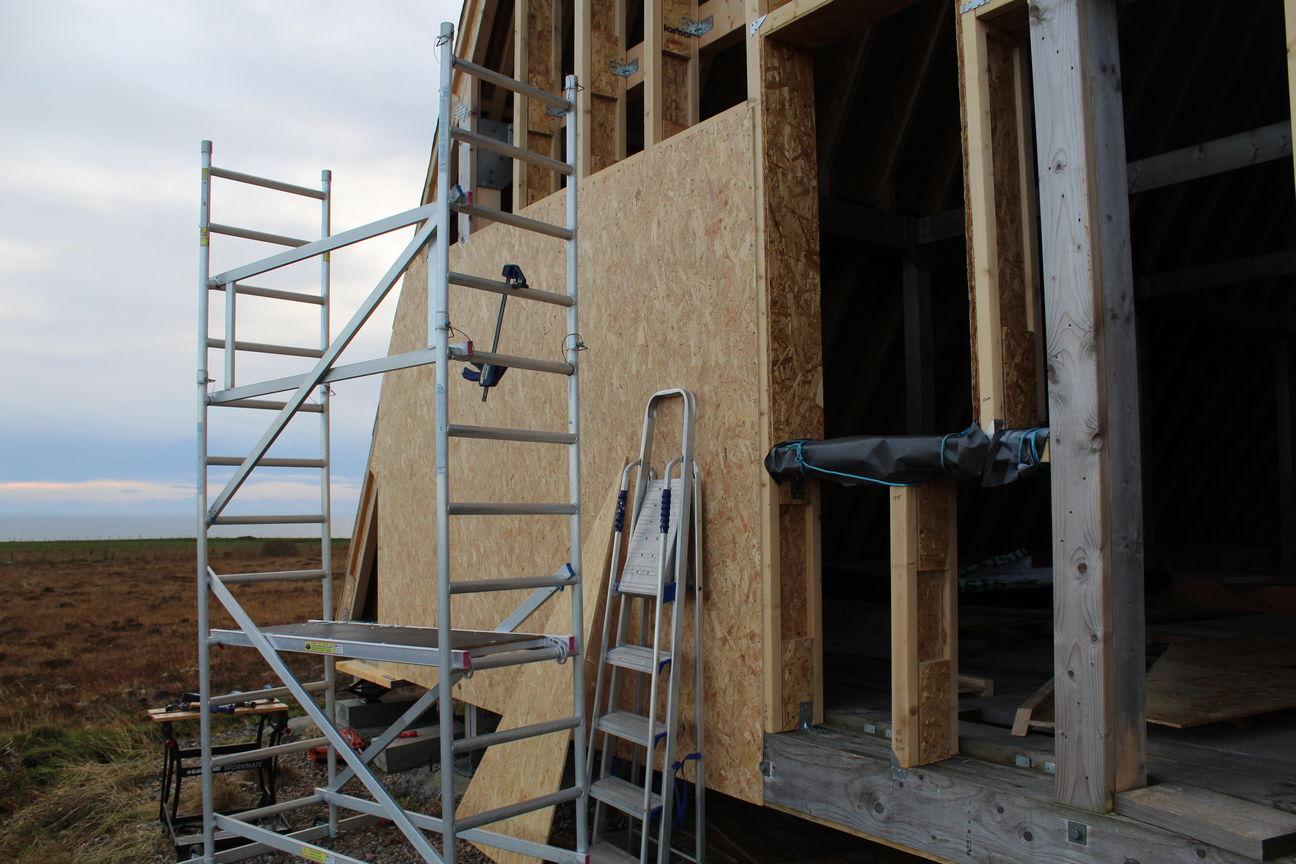

Ed Davies Posted November 27, 2018 Posted November 27, 2018 As @joe90 but aluminium scaffold tower. Deck at any height from just off the ground to 5 metres in increments of 250 mm. Handrails both sides at height, usually just one side as convenient when low down. Decks have a trap door to climb up through when high up but when low down (metre or so) it's easy to just clamber on or step off a step ladder holding on to the scaffold itself. Set up a bit oddly but only photo I have of it with the deck at one metre attached. The posts are each a one metre section on top of a two metre section. The top one metre is only really there 'cause that's how I'd had it set up earlier. 1
