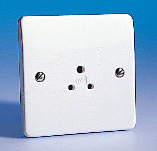

Ed Davies Posted November 24, 2018 Posted November 24, 2018 Indeed, while @Onoff was posting I was failing at web search for 3 A outlets. What are they? But when you say these outlets are switched, do you mean with a switch on the outlet (as 13A outlets usually have) or switched from a wall switch like most lighting circuits? I think the second but I'm not sure.
Jeremy Harris Posted November 25, 2018 Author Posted November 25, 2018 Sorry, my error, they are 2 A outlets, not 3 A, these ones, switched by wall light switches, that control incidental lights: What I'm after is a transmitter that can detect power at one of these outlets and turn on a switch/receiver that's plugged in to a standard 13 A outlet. My error was in not realising that we'd want an incidental light on the other side of the room from where I'd fitted the 2 A outlets. At present there is a 2 gang light switch in the room, one gang two way switches (with another single light switch the other side of the room) three wall uplighters, the other gang switches the 2 A outlets. The idea was to be able to switch all the incidental lighting on and off from the wall, without having to go around switching them on or off individually. However, we've found that we quite like having a small light on in one corner, opposite the wall with the 2 A outlets on, but which has a 13 A double gang outlet. If push comes to shove I can make something up that will do the job, but I'd rather have an off-the-shelf solution if there is one.
