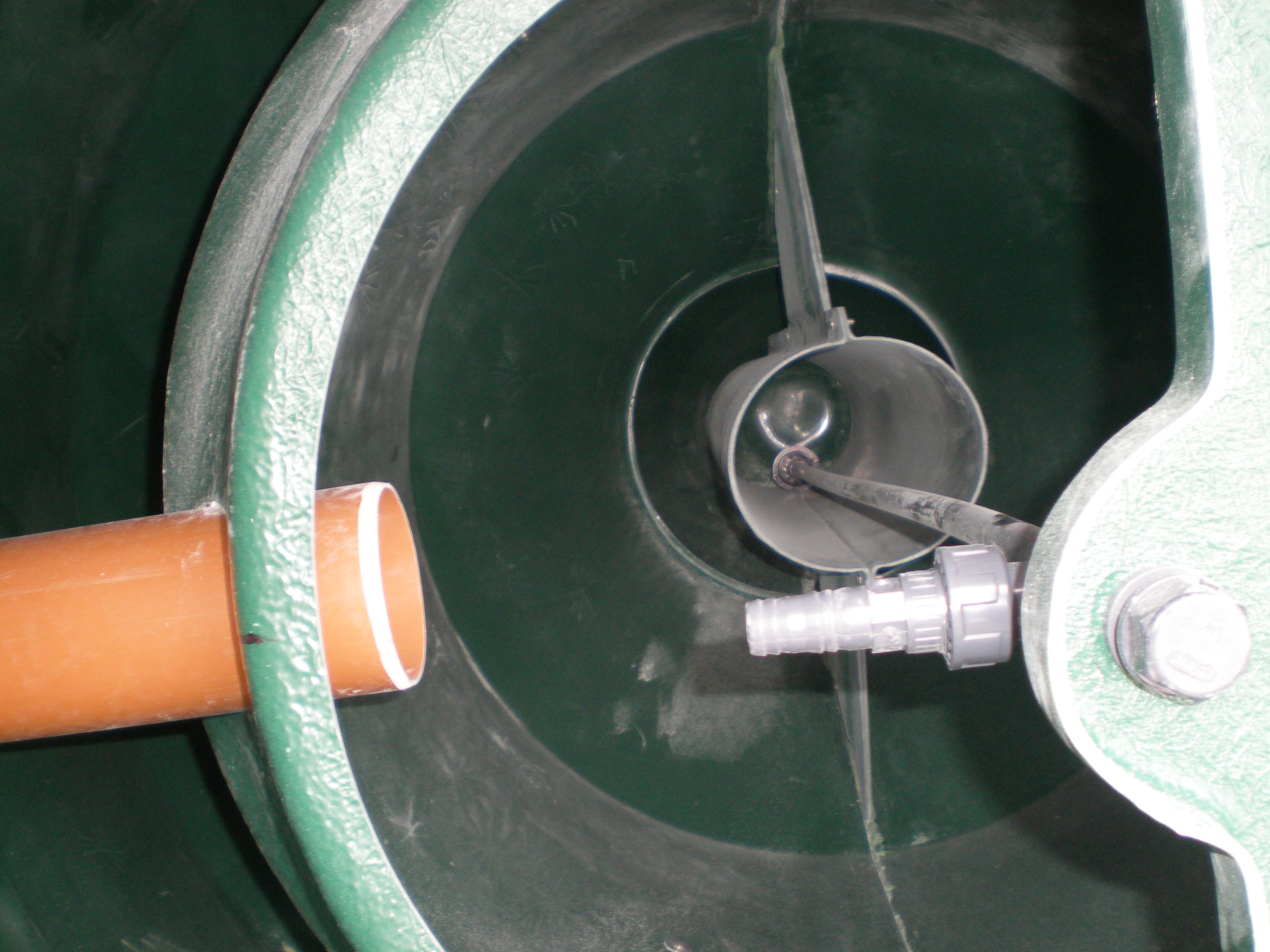

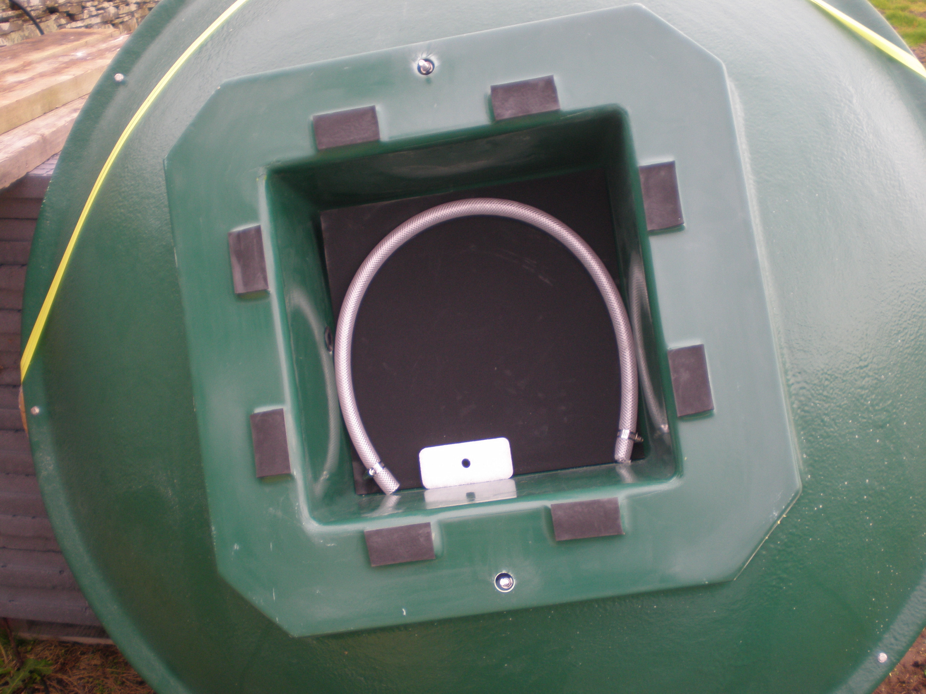

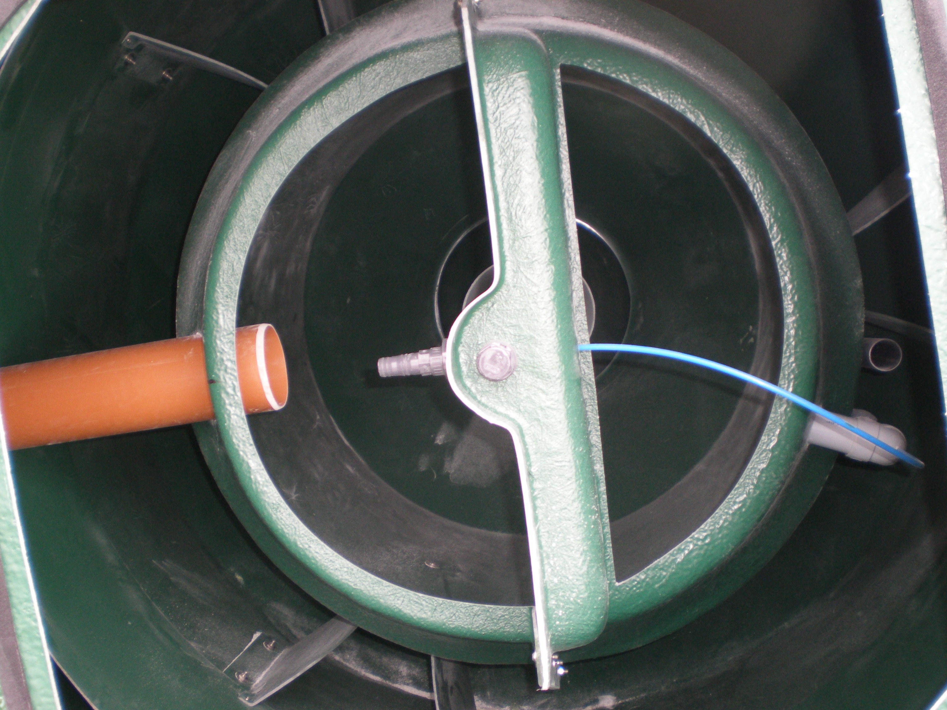

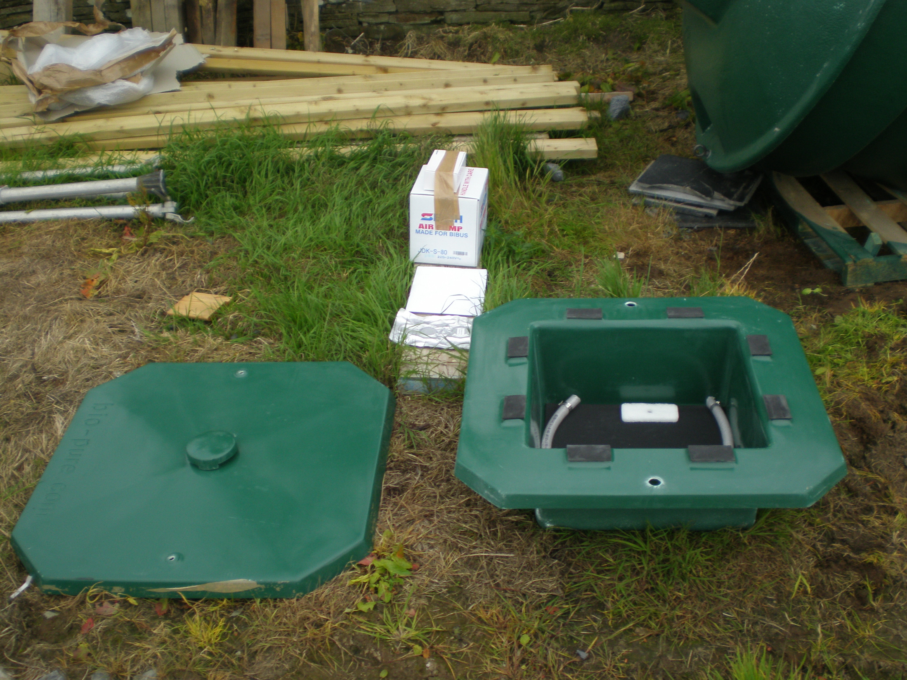

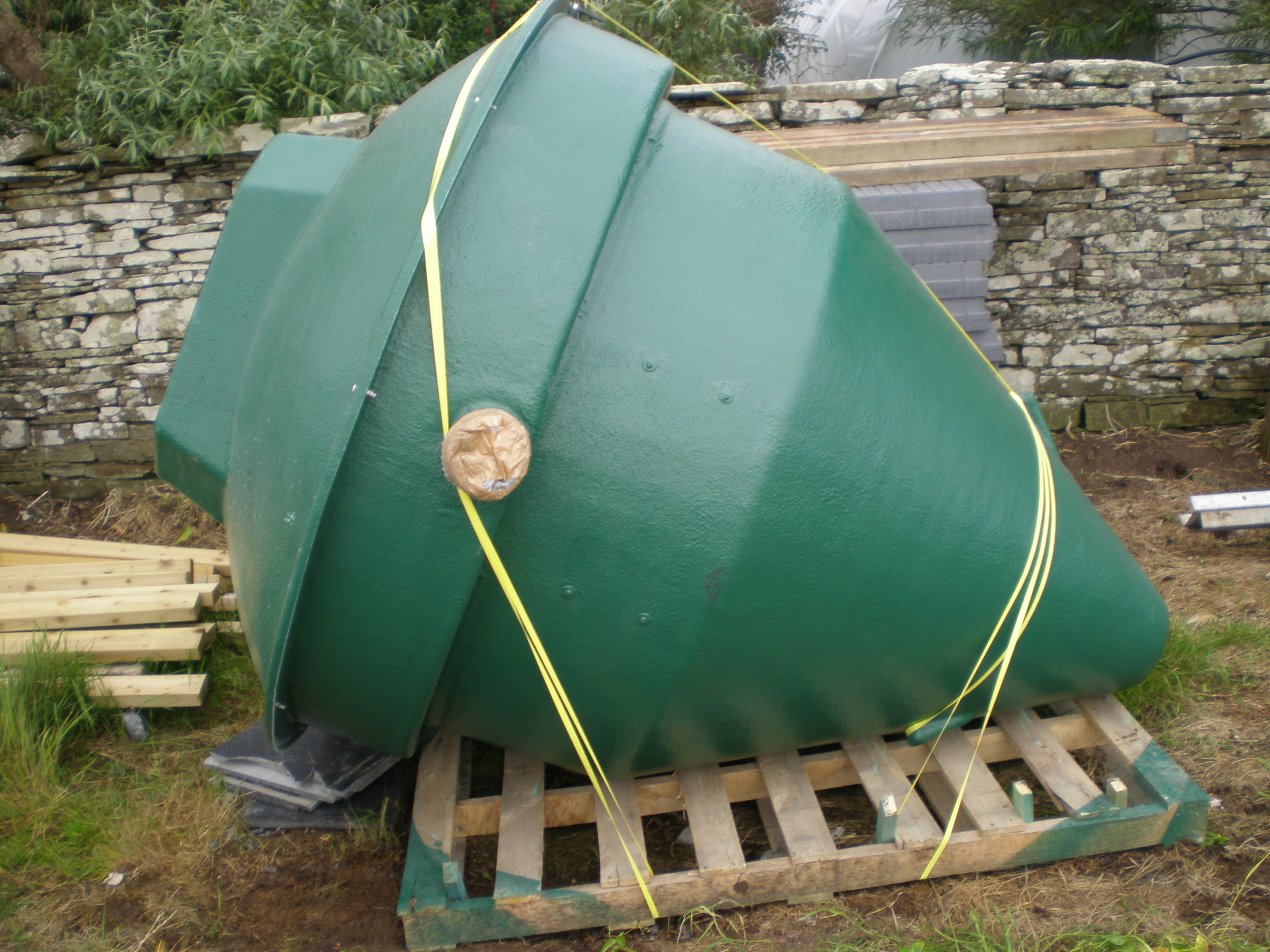

Delivered today on a pallet.  A few pictures for anyone interested:
Lid and pump housing
Internal shots

That's amazingly similar to my WPL Diamond DMS2 except mine doesn't have an integrated pump housing. Does that mean the housing has to be removed to have the tank emptied?
I know Jason's choice was limited by transport costs, but seeing that makes me glad I opted for the Conder.
I am sure the Biopure will be fine in operation but disadvantages over the Conder as I see it:
No legs, so you have to hold the Biopure upright while back filling the hole. (conder has legs)
I don't see any lifting eyes to lift it and hold it (Conder has 4 lifting eyes)
It looks like you have to lift the pump unit out to empty the tank (Conder has separate access point for emptying)
Yes, the housing sits in the neck of the unit , but would have to be lifted out for emptying.  Given the de-sludge and maintenance  requirements, I'm not too worried about this, and am willing to accept this niggle to avoid having to remotely house the pump.  As Dave suggests, a separate access point for emptying would have been good.  You don't have to have the pump housing - they supply with or without.
Without legs, installation becomes a little more difficult, i.e. requires a machine and more than one man, but for me this isn't an issue as the builders will be installing and have all the kit required.  If you were doing it yourself, I agree the lack of legs would be a short term disadvantage.
It does have two lifting eyes, both of which I've managed to exclude from the photographs!

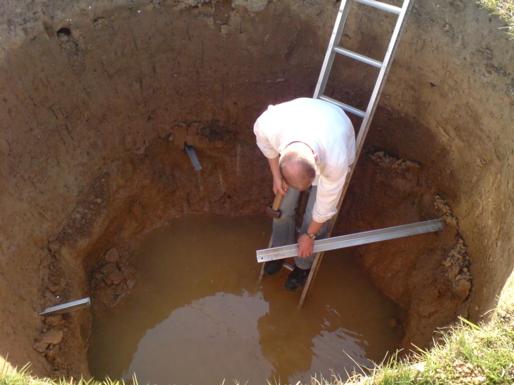

Mine is anchored with about 6 tons of concrete. We have a seasonally high water table here, and I would not be the one volunteering to climb down into a deep soggy hole to bang some angle iron stakes into the side while hoping it doesn't  collapse while I am down there.
Yes it was interesting, the water table varies a great deal around here as well.
Not just "interesting" but bloody dangerous if you ask me.  With the ground we have, I suspect it would be more likely to cave in, and in any case there are so many rocks and stones in the ground the chances of driving the angle iron in that fare would be very slim.
Agreed, I don't think I'd be that keen to do what you did Peter.  Our ground is likewise full of broken rock which would hamper the angle iron anchor installation.  For our site, concrete is the easiest solution.
Dangerous, a bit over OTT. The ground conditions are obviously very different, certainly no rocks or stones here.
I have to Say, there is nothing dangerous about what Peter is doing if your compitent doing this sort of task / being able to risk assess the situation,  but for someone without this skill set it could be very dangerous. "self build" is such a wide topic we all come with our own specific skill sets and these are generally unknown to other forum members,  (time and posts reveals more) therefore we should be carful not to be to critical of what we do not feel confident in or have experience in ourselves when to others its a daily task. ( yes there are lots of people out there / on here that are misguided or lack understanding and need helpful advise to bring them up to speed in certain areas, i am one.... But lets not be to judgmental .
I think I am qualified to make a judgement.
When building the present house, 13 years ago, we paid a man with a JCB to install our septic tank. It was in March, so the water table was quite high.
He had dug the hole, and had the tank slung from the bucket of the JCB. He was just starting to lower it into the hole when "plop" a bit of the side of the hole fell in and deposited a big rock right in the middle where the tank was about to be placed.  Without thinking, I put a ladder down the hole, climbed down and moved the rock. Even the JCB driver told me that was a very very silly thing to do, even though it would have meant him untying the tank and using the bucket to remove the rock, then slinging it and trying again.
That's why in our ground I would never ever go into a hole that deep again. I would say you have to be pretty damn sure of your ground conditions before you can say it is "safe"
