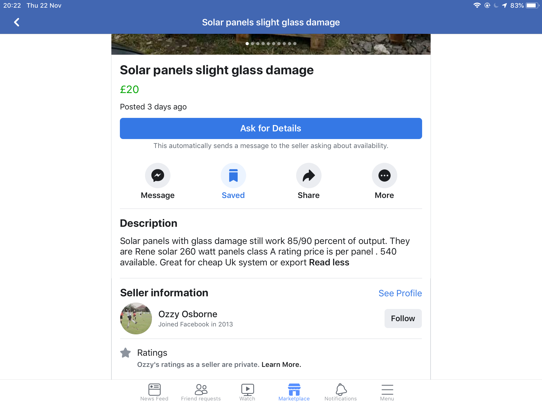

Russell griffiths Posted November 22, 2018 Author Share Posted November 22, 2018 Link to comment Share on other sites More sharing options...
Declan52 Posted November 22, 2018 Share Posted November 22, 2018 Didn't know ozzy was big in the renewable energy market. 1 Link to comment Share on other sites More sharing options...

Guest Alphonsox Posted November 22, 2018 Share Posted November 22, 2018 14 minutes ago, Declan52 said: Didn't know ozzy was big in the renewable energy market. I think the Pigeon/Dove/Bat control business dried up in the late 90's - It's good to see he's managed to diversify into sucking the light out of the world. Link to comment Share on other sites More sharing options...
ProDave Posted November 22, 2018 Share Posted November 22, 2018 At £20 a panel I will have about 30. Now where can I find a proper advert and contact details? and what about sticking them on a pallet for delivery? Link to comment Share on other sites More sharing options...

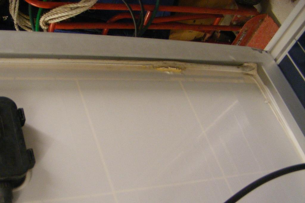

ProDave Posted November 28, 2018 Share Posted November 28, 2018 Any thoughts on the ones from Bimble with the "degraded backing" This is their picture As I understand it, that backing material is supposed to be a continuous sheet. It appears to be cracking along either the individual panel joints, or the interconnecting tapes. They say the panels are still generating the expected power. Is it a matter of just doing something to seal it up to keep moisture out so prevent the panel degrading? If so what with? Link to comment Share on other sites More sharing options...

Jeremy Harris Posted November 29, 2018 Share Posted November 29, 2018 14 hours ago, ProDave said: Any thoughts on the ones from Bimble with the "degraded backing" This is their picture As I understand it, that backing material is supposed to be a continuous sheet. It appears to be cracking along either the individual panel joints, or the interconnecting tapes. They say the panels are still generating the expected power. Is it a matter of just doing something to seal it up to keep moisture out so prevent the panel degrading? If so what with? Looks easy enough to seal up. I'd have a look at seeing if the panels can be laid dead flat and then pour a thin layer of the very runny two pack polyurethane or silicone potting compound. I had a go at encapsulating some home made panels using the water-clear (expensive!) potting compound that Dow Corning make, and it runs freely over a surface and ends up as a nice thin layer, like a conformal coating. A brush-on silicone conformal coating, like the stuff used to protect circuit boards may be just as good, but that normally needs to be heat cured. You may be able to set up a rig with a radiant heat lamp to cure the stuff, though. Whenever I've coated circuit boards with the stuff I've cured it in the oven, doesn't take much in terms of temperature, but does take a while. If the price, plus the messing about to seal up the rear surfaces, is right, then I reckon they would be a good buy. I could do with some now, as I'm typing this during (another) power cut, with the house server, modem, router etc running on my back up battery system. Link to comment Share on other sites More sharing options...
ProDave Posted December 15, 2018 Share Posted December 15, 2018 Well I ended up with a pallet of 25 of the Bimble solar PV panels. They had listed one on ebay and I won it for a little less than the price they are listed on their website that with transport works out at £50.8 per 250W panel, or 20.32p per watt. I was pleasantly surprised unpacking them. Most of them seem fine with no problems with the backing. One has a split in the backing about 1cm long, and 2 of the panels have the backing peeling at the top edge in one small area like this I think my "fix" will be to cover the affected areas with a bit of sticks like sh*t smoothed down with a finger. 1 Link to comment Share on other sites More sharing options...
Jeremy Harris Posted December 15, 2018 Share Posted December 15, 2018 Sounds like a real bargain, and great news that they aren't as bad as thought. If I had room for another 25 panels I'd have taken a punt on some, but the most I could use would be around 10, if that. Link to comment Share on other sites More sharing options...
