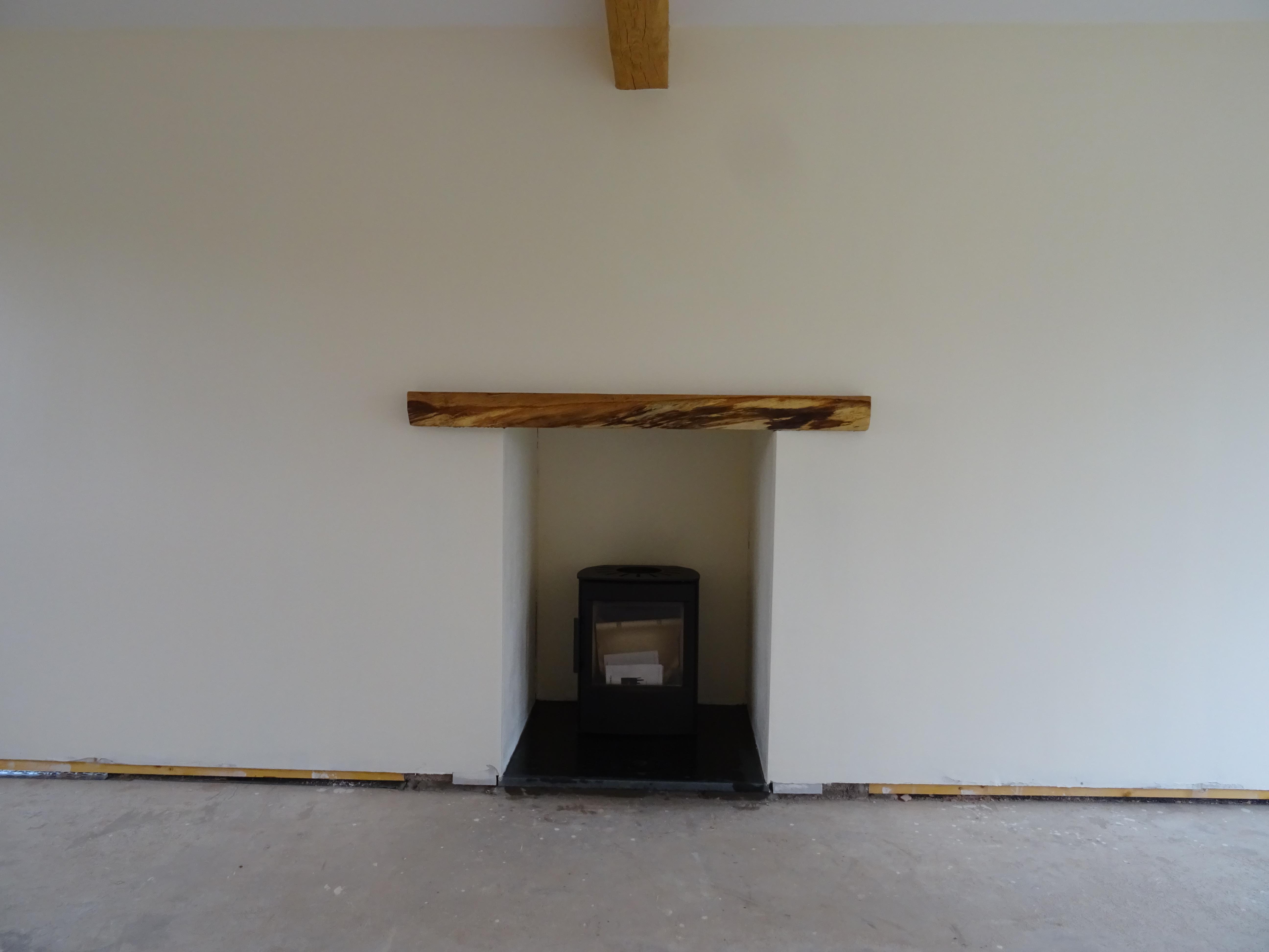

Redoctober Posted November 20, 2018 Posted November 20, 2018 (edited) We have a chimney which is to service the WBS when it gets commissioned in early December. Unfortunately the builders positioned the hole for the register plate too far back in the hearth area causing the WBS to sit further back in the "hole" than we would have hoped for. I have spoken with the installers and they say there is nothing we can do to bring it forward. I suggested a double 45 degree bend flue pipe set up but he said because it is a chimney and not a twin flue system, the pipe needs to go vertically from the WBS to the aperture in the register plate. Now, once I have been signed off so to speak is this something I could fit retrospectively or is it a complete no no ? Thoughts welcome. Edited November 20, 2018 by Redoctober typo

PeterW Posted November 20, 2018 Posted November 20, 2018 No reason why you can’t have a pair of 45 bends before a register plate unless the chimney also has bends in it too ...?? 1
ProDave Posted November 20, 2018 Posted November 20, 2018 There is a limit of 4 bends in total for a flue system. Can it come out of the back and then turn rather than coming out of the top? In what way is it too far back? too tight for manufacturers clearances or just aesthetics? 1
Redoctober Posted November 20, 2018 Author Posted November 20, 2018 Thanks @ProDave @PeterW @joe90 and @Cpd - Here is an image which hopefully will show how far back we have to have the WBS in order to achieve a vertical flue. The chimney is straight so no problems with bends etc with that.
PeterW Posted November 20, 2018 Posted November 20, 2018 So that’s a 300mm straight into the stove, 45 degree elbow with a sweeping access, and then a 45 back up into the register plate. All within regs and perfectly reasonably assuming you keep 3 x D from that oak mantle. Just check the door and the hearth though as that may be a limiting factor. 1

joe90 Posted November 21, 2018 Posted November 21, 2018 @Redoctober Just looked at the website and the flue can be top or rear, so what about rear and 90’ bend to bring it forward like you want? 1
Redoctober Posted November 21, 2018 Author Posted November 21, 2018 3 hours ago, joe90 said: @Redoctober Just looked at the website and the flue can be top or rear, so what about rear and 90’ bend to bring it forward like you want? Massive thanks @joe90 - I will certainly mention this to the installer ahead of the final set up phase. ?
Redoctober Posted November 21, 2018 Author Posted November 21, 2018 An update - thanks to @joe90 I contacted the installer and he has confirmed the flue will be coming out of the stove at the rear, so this will push it forward some mm's which in turn should improve the look beyond it's current situation. I have to say, the service I have received from the installer has been well below expectations - but as we all know, we live and learn!!
