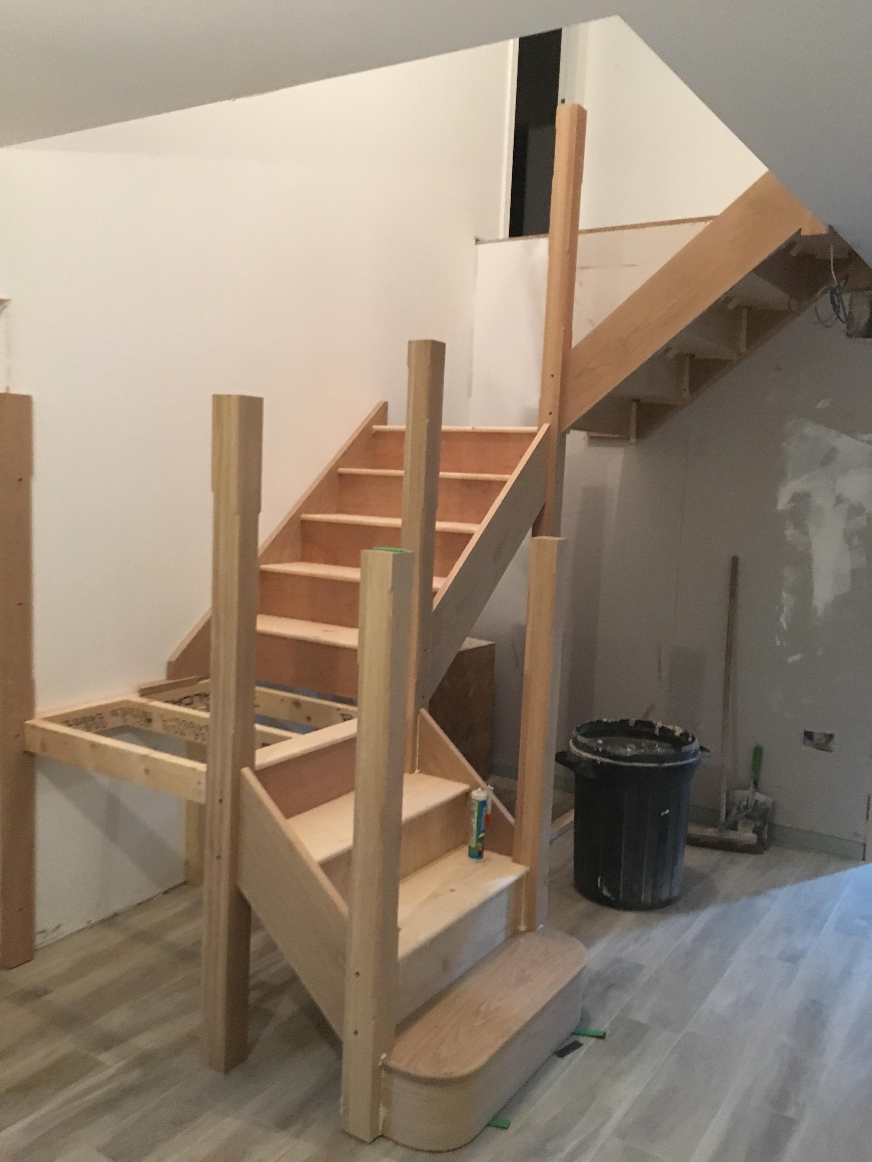

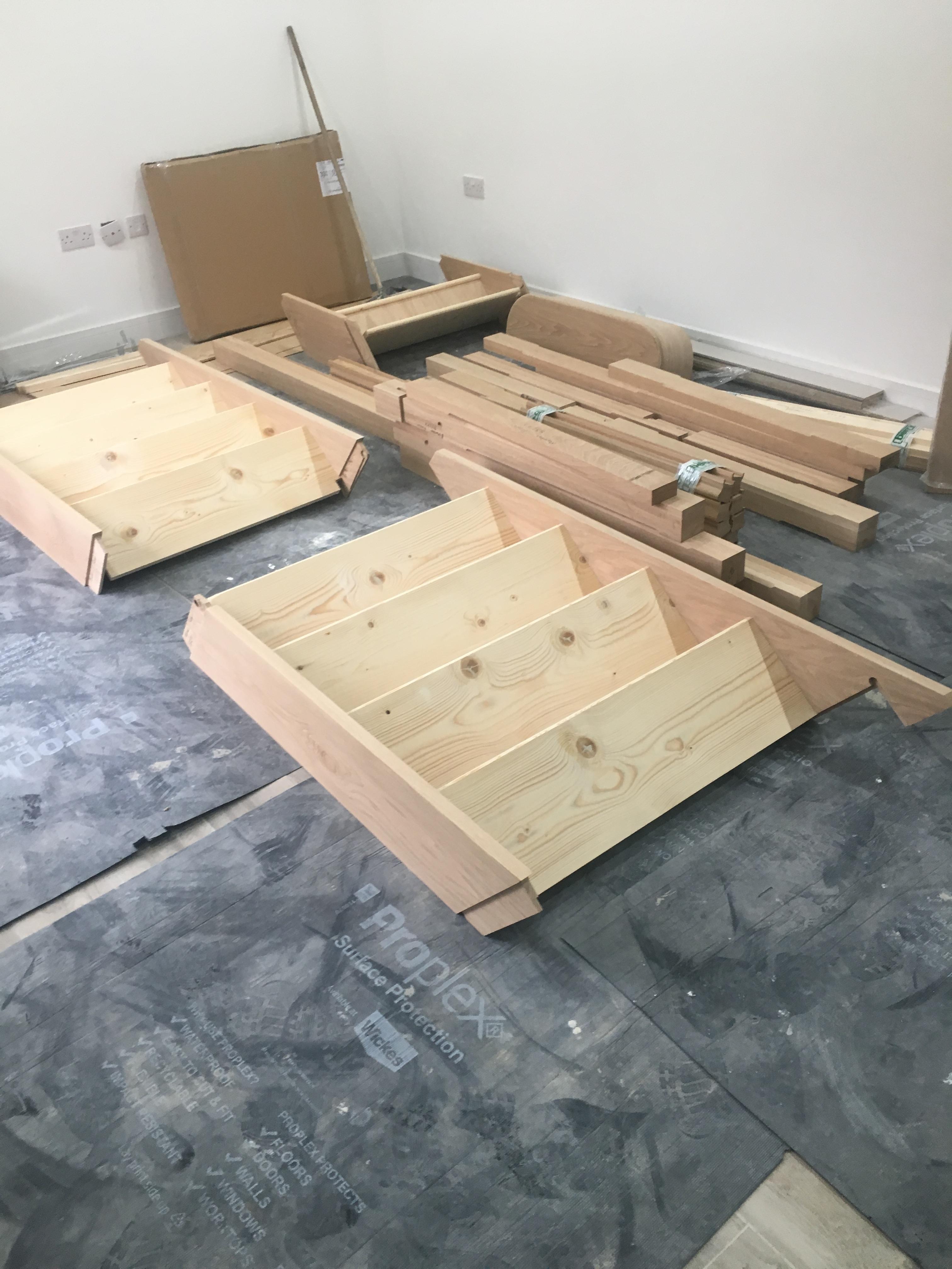

nod Posted November 10, 2018 Posted November 10, 2018 Just about to start fitting the stairs Lots of bits With me luck

CC45 Posted November 10, 2018 Posted November 10, 2018 3 hours ago, nod said: Just about to start fitting the stairs Lots of bits With me luck At least youve started in good time! Pre 6am..... ?
Simplysimon Posted November 10, 2018 Posted November 10, 2018 hi @nod straight forward job, i'm a bit surprised at the tenons to the newels. they should have a haunch in the middle as length of tenon shouldn't exceed 5x thickness to avoid weakening the timber with an oversized mortice.
ProDave Posted November 10, 2018 Posted November 10, 2018 ^^ but the mortice is into the newel posts, you are not going to tell me that will weaken them?
Mr Punter Posted November 10, 2018 Posted November 10, 2018 First fix one day for 2 chippies. Would take me 2 weeks. Would take @Onoff 6 months.
Oz07 Posted November 10, 2018 Posted November 10, 2018 2 hours ago, Simplysimon said: hi @nod straight forward job, i'm a bit surprised at the tenons to the newels. they should have a haunch in the middle as length of tenon shouldn't exceed 5x thickness to avoid weakening the timber with an oversized mortice. Never knew that. As in if tennon is 12mm thick then mortise not to be 60mm deep or are you on about length of mortice?
Simplysimon Posted November 10, 2018 Posted November 10, 2018 2 hours ago, ProDave said: ^^ but the mortice is into the newel posts, you are not going to tell me that will weaken them? it's not good practise for the mortice to be overly long without a haunch as it will weaken the timber 6 minutes ago, Oz07 said: Never knew that. As in if tennon is 12mm thick then mortise not to be 60mm deep or are you on about length of mortice? if the string is 30 x180mm wide there should be 60mm tenon 60mm haunch and 60mm tenon, therefore 1/3 @12mm thick tenon and correcty sized
nod Posted November 10, 2018 Author Posted November 10, 2018 4 hours ago, Simplysimon said: hi @nod straight forward job, i'm a bit surprised at the tenons to the newels. they should have a haunch in the middle as length of tenon shouldn't exceed 5x thickness to avoid weakening the timber with an oversized mortice. You put a haunch on a window sash or door rail Stairs there’s no need it can’t drop

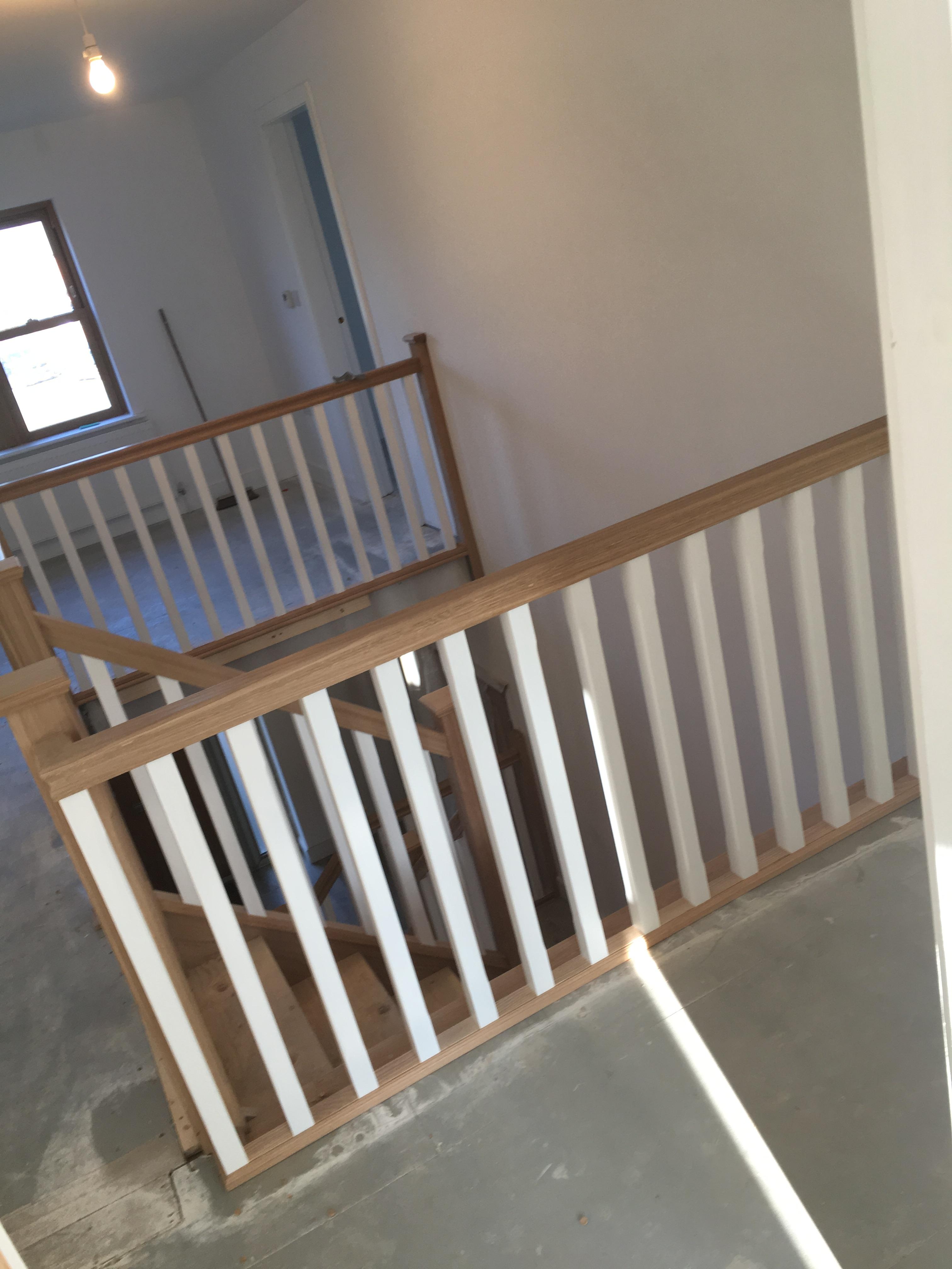

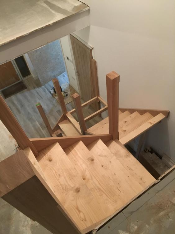

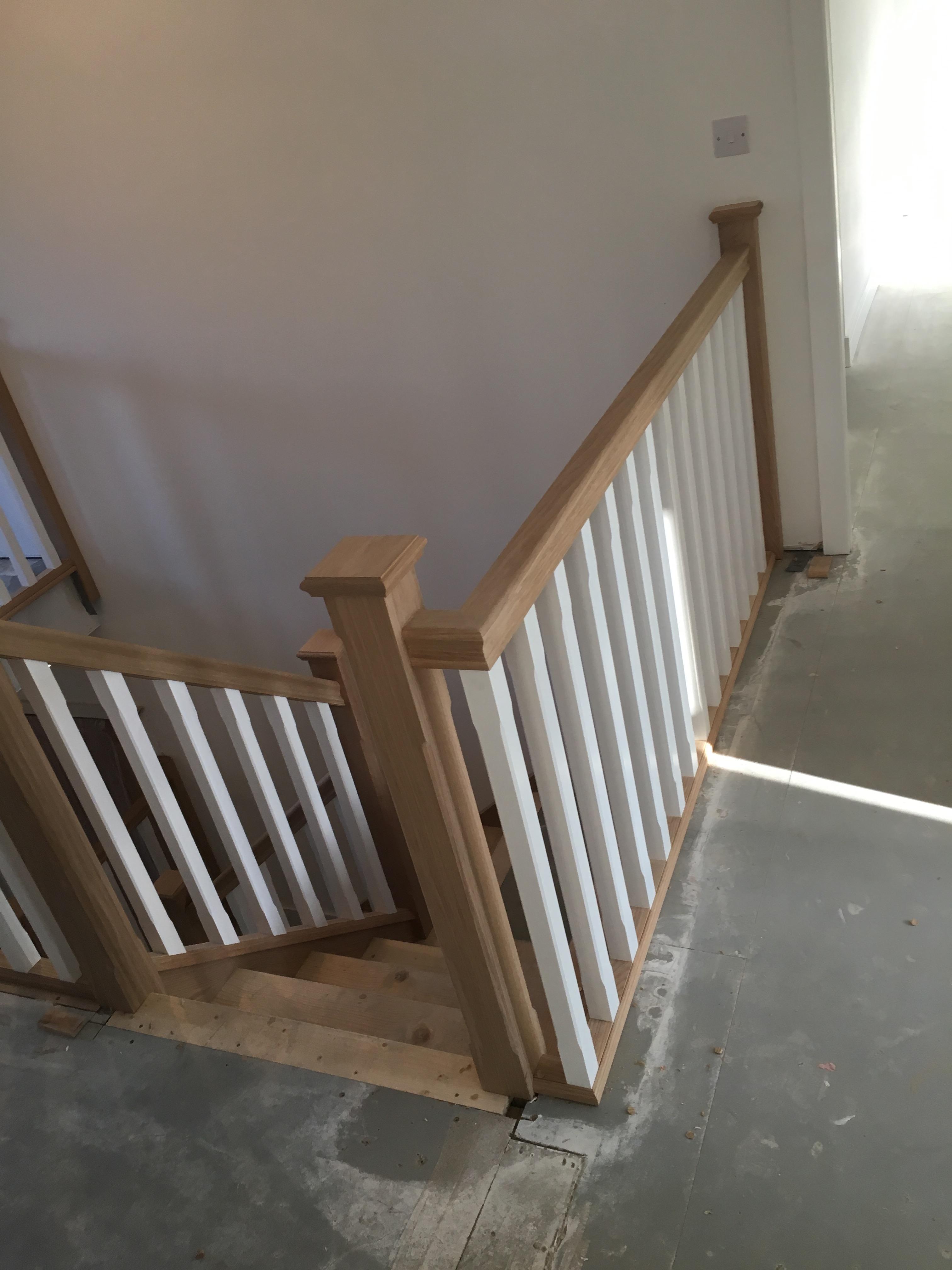

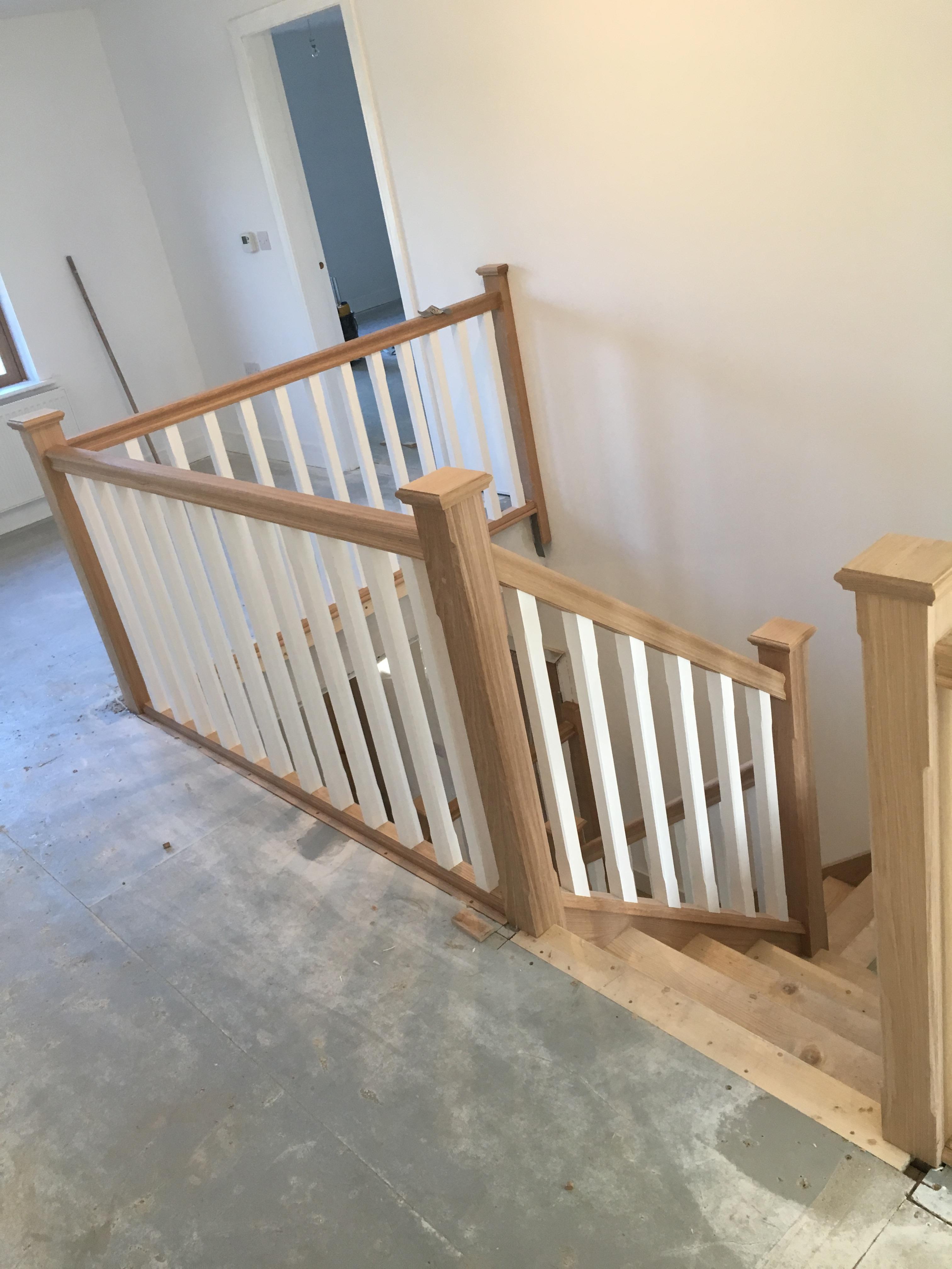

nod Posted November 10, 2018 Author Posted November 10, 2018 12 hours ago, nod said: Just about to start fitting the stairs Lots of bits With me luck Tricky part out of the way 2
nod Posted November 18, 2018 Author Posted November 18, 2018 On 10/11/2018 at 05:26, nod said: Just about to start fitting the stairs Lots of bits With me luck 1
