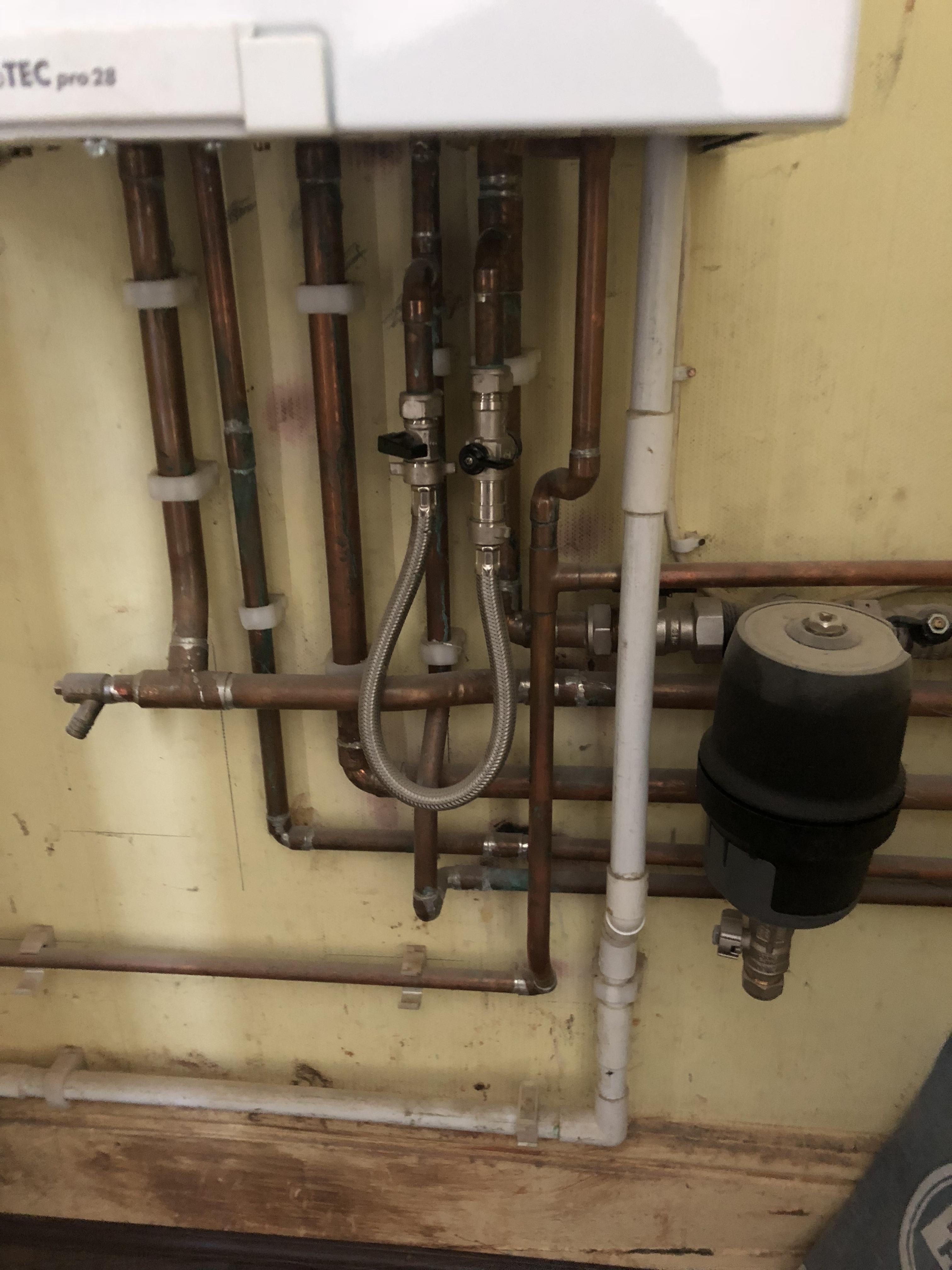

PeterW Posted November 13, 2018 Posted November 13, 2018 3 hours ago, pocster said: It goes into the boiler overflow/expansion pipe (boiler is literally next to the tank) - so any issue will overflow outside which I can easily check. Errrr .... 15mm too ..?? To give an example of the issue you face, find a 22mm pipe at 3bar and try and force it into a 15/22 connector ... hard work, you will get wet and it will spray everywhere ... Now do it with 90c water ..... A boiler over pressure pipe is designed to take a limited - ie reduce the boiler from over pressure to 1.5-2bar - and then stop. It’s not designed to take the full force of 3 bar water, which will flow constantly once this has trigger or failed, that is being supplied through a 22mm mains pipe.... that’s the worst case scenario. Best case is that the PRV blows and it’s only cold water, but still, 22 into 15 doesn’t go... Combining of discharge pipes is allowed but they must be larger at each junction. 1

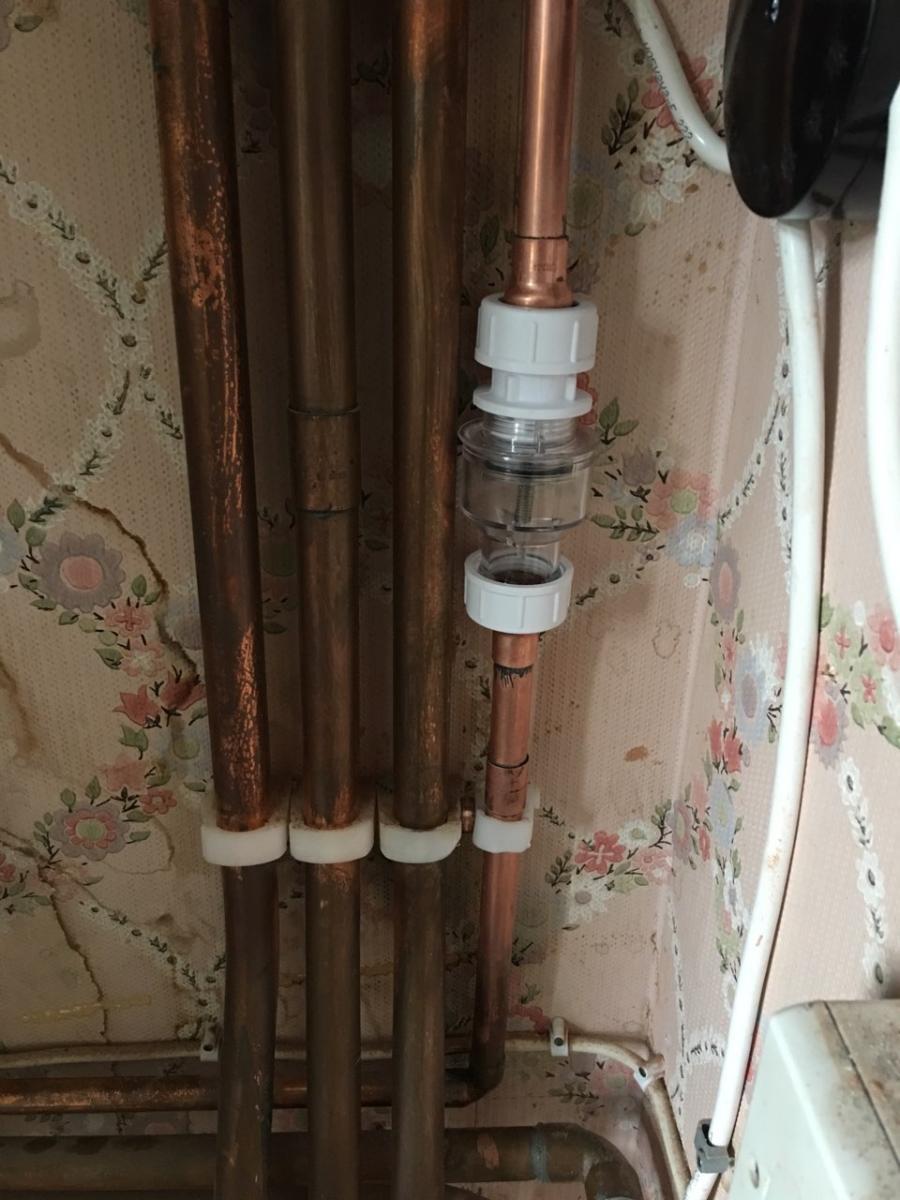

Nickfromwales Posted November 14, 2018 Posted November 14, 2018 8 hours ago, pocster said: He said a tun dish could be installed if I want. He has been requested by other customers due to the corrosion and leaks to remove them (said he would send me a photo if i wished). No and fcuking NO! This guys a total prick. He’s admitting going around making installations lethal. FM! The picture he’s sent you clearly shows water has been running OVER that tundish not THROUGH it. We’ve got a real live one here Im stuck for words, and that is some achievement I can tell you. I woukd 1000% be getting an independent inspection done by someone not known to either you or the fitter. You’ll soon see the rap sheet filling up. Still love to know if he’s done the balanced feeds. I’ll bet my spare ribs he hasn’t. If you ring Telford they’ll give you the number of a local G3 installation agent that they use for maintenance / repairs etc. My mate went through a divorce and let his lapse on a big job so I rang Telford and it cost about £160 to get a guy out to G3 it all. He went through every last nut and bolt. You need this looking at so deffo hold some money back. Guys a tosser. 1

Pocster Posted November 14, 2018 Author Posted November 14, 2018 I’m not at the property but he sent me a photo of the tundish installed .
Nickfromwales Posted November 14, 2018 Posted November 14, 2018 And even then the penis cant do it right! Jeez x2. 22mm D2 minimum pipe size. Maybe print him a few copies off to give to his previous victims?
Pocster Posted November 14, 2018 Author Posted November 14, 2018 17 minutes ago, Nickfromwales said: And even then the penis cant do it right! Jeez x2. 22mm D2 minimum pipe size. Maybe print him a few copies off to give to his previous victims? ? No point me getting back to him on this . I’ll get it ‘serviced’ by another penis ? ; I can also see if the new guy picks up on that .... 1
Nickfromwales Posted November 14, 2018 Posted November 14, 2018 The reason it needs bigger pipe on D2 ( the open part of the tundish ) is because the 15mm D1 is forced out under pressure, whereas the D2 only has gravity to rely on for the water to drain away naturally. With the invert so close to the tundish, I'd have run that in 28mm. At the very least the first elbow after the tundish should have been a bend pulled in a pipe bending machine to give a nice radius. Its so easy to just do right, when you're already there with your tools out. 1
Pocster Posted November 14, 2018 Author Posted November 14, 2018 1 minute ago, Nickfromwales said: The reason it needs bigger pipe on D2 ( the open part of the tundish ) is because the 15mm D1 is forced out under pressure, whereas the D2 only has gravity to rely on for the water to drain away naturally. With the invert so close to the tundish, I'd have run that in 28mm. At the very least the first elbow after the tundish should have been a bend pulled in a pipe bending machine to give a nice radius. Its so easy to just do right, when you're already there with your tools out. Don’t doubt it’s a simple job . He said fitting the tundish took 5 minutes . So it wasn’t about saving time or money ( his ! ) ; just I guess decided it wasn’t necessary . I’ll take better photos of the pipe work . If that’s the only thing that needs altering then perhaps I can get that done as a seperate job .

Nickfromwales Posted November 14, 2018 Posted November 14, 2018 Jesus. This guys underpants are going TNT overnight so he gets them to wear tomorrow. I’ve never, in 23 years on the tools, seen someone cut into a boiler PRV to add D2. AND ALL IN 15mm !!!!? Needs to be 22mm to tundish from outside, as long as the hydruluc ( calculated ) run isn’t >12m. If you tee into the boiler PRV then that too would need a tundish / air break and the downstream pipe work upsized to prob 28 or 35mm. Scrotum. 1
Pocster Posted November 14, 2018 Author Posted November 14, 2018 12 minutes ago, Nickfromwales said: Jesus. This guys underpants are going TNT overnight so he gets them to wear tomorrow. I’ve never, in 23 years on the tools, seen someone cut into a boiler PRV to add D2. AND ALL IN 15mm !!!!? Needs to be 22mm to tundish from outside, as long as the hydruluc ( calculated ) run isn’t >12m. If you tee into the boiler PRV then that too would need a tundish / air break and the downstream pipe work upsized to prob 28 or 35mm. Scrotum. So as he’s joined into the boiler outlet that needs a tundish too ...?? Just double checking
