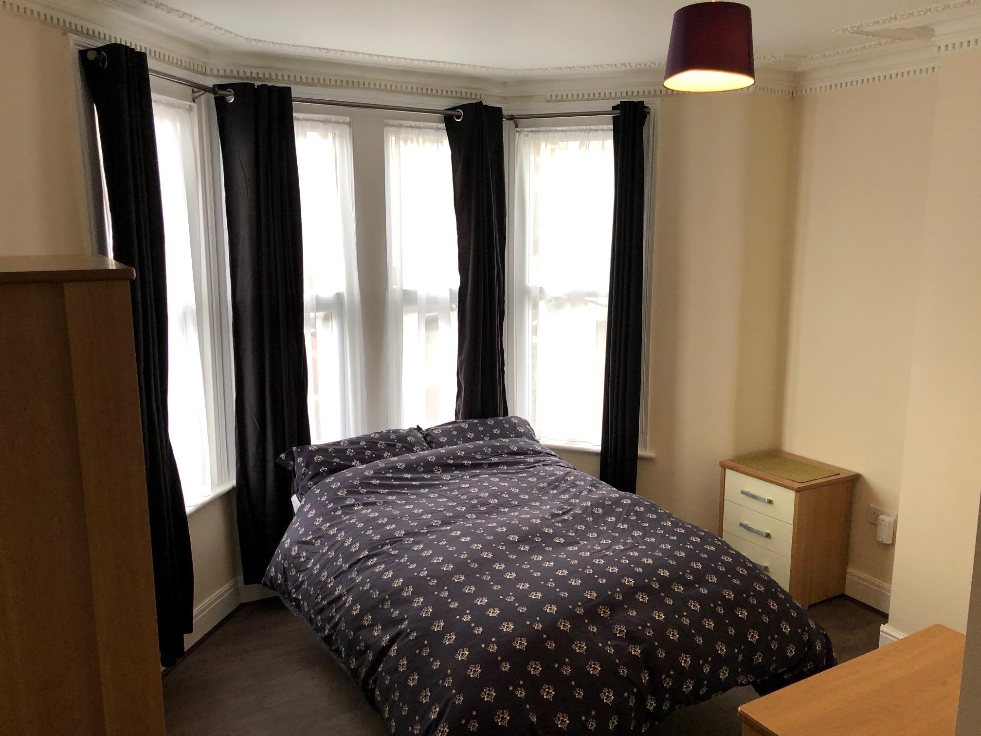

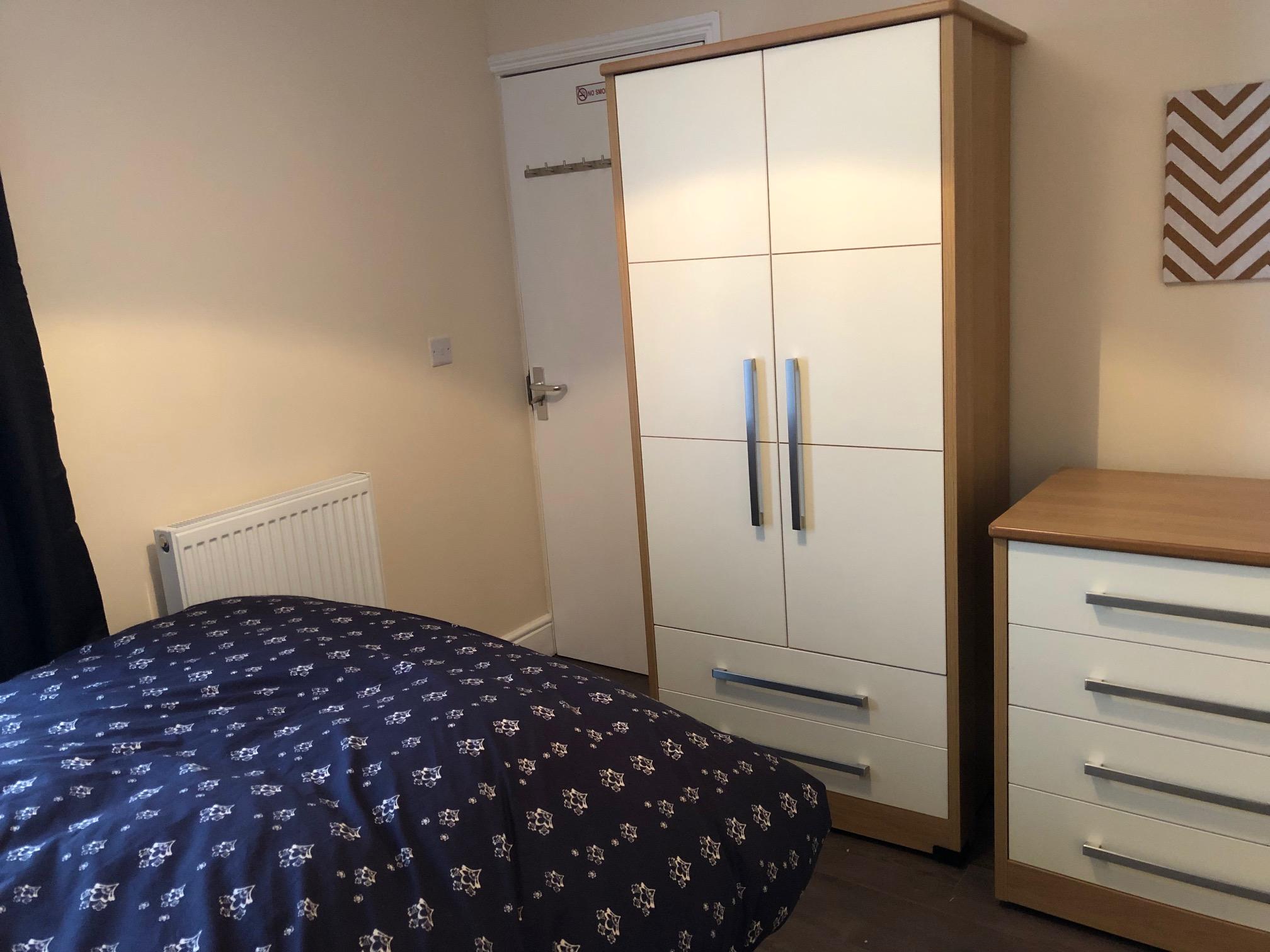

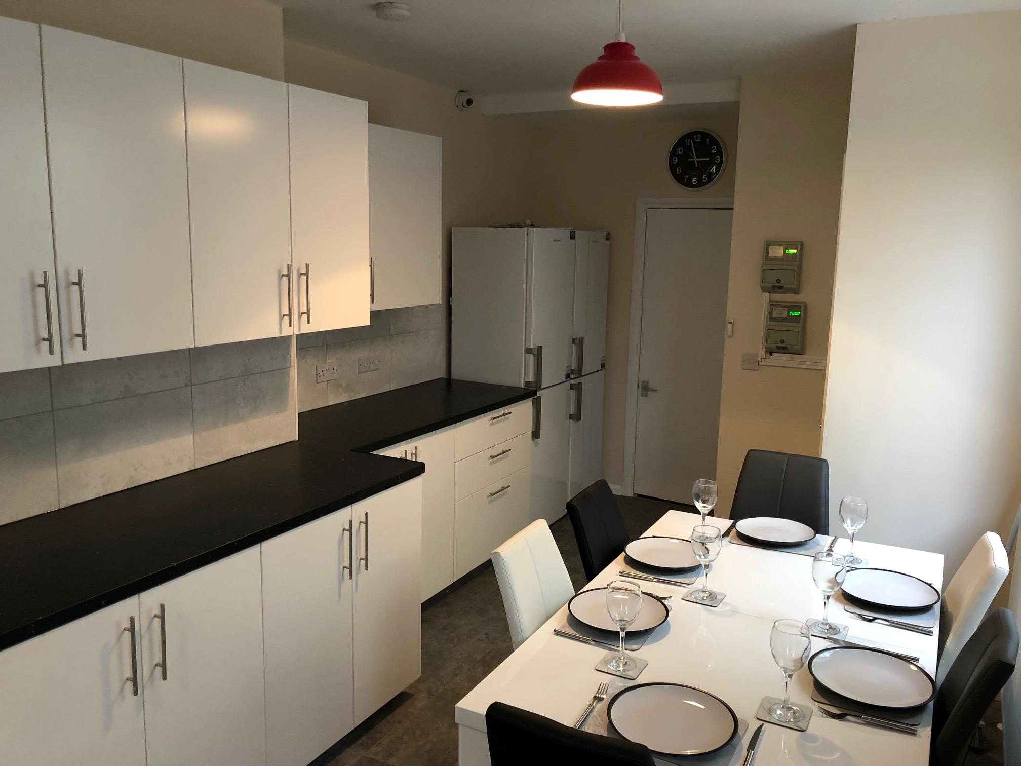

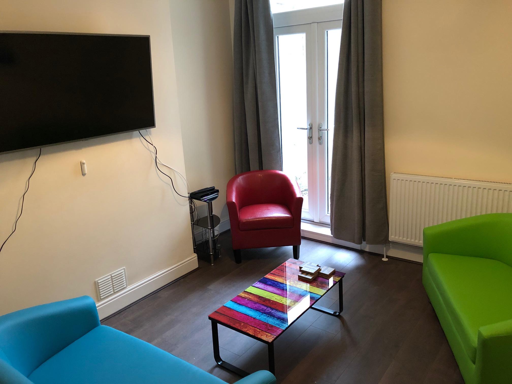

Pocster Posted January 12, 2019 Author Share Posted January 12, 2019 Just about finished!!! 3 Link to comment Share on other sites More sharing options...
ProDave Posted January 12, 2019 Share Posted January 12, 2019 And how long will it stay that nice? Only "complaint" is you could have chased the tv wires into the wall. Link to comment Share on other sites More sharing options...
newhome Posted January 12, 2019 Share Posted January 12, 2019 Looks good? When do people move in? I am trying to visualise those rooms with 50 odd bottles of p*ss on the floor . Hope your tenant screening process is better this time . 1 Link to comment Share on other sites More sharing options...
Pocster Posted January 12, 2019 Author Share Posted January 12, 2019 42 minutes ago, ProDave said: And how long will it stay that nice? Only "complaint" is you could have chased the tv wires into the wall. Not long ? Yeah TV turned up 'late'. Whats annoying is power is one side of it and AV/HDMI etc. is the other! Link to comment Share on other sites More sharing options...
Pocster Posted January 12, 2019 Author Share Posted January 12, 2019 32 minutes ago, newhome said: Looks good? When do people move in? I am trying to visualise those rooms with 50 odd bottles of p*ss on the floor . Hope your tenant screening process is better this time . TBH I don't have that many tenant issues as a percentage . It's simply I can turn over a lot of tenants in a year. Well CCTV is in all communal spaces - so we can watch the bottles of wee build up! Link to comment Share on other sites More sharing options...
Onoff Posted January 12, 2019 Share Posted January 12, 2019 57 minutes ago, pocster said: Not long ? Yeah TV turned up 'late'. Whats annoying is power is one side of it and AV/HDMI etc. is the other! Don't suppose you can whack some D-Line up. Link to comment Share on other sites More sharing options...
Pocster Posted January 12, 2019 Author Share Posted January 12, 2019 (edited) 24 minutes ago, Onoff said: Don't suppose you can whack some D-Line up. I could . If it was my home - no cables would be visible . They’ve got a 50” tv with all the channels and sky sports HD ( not that I care about that ) - are they really going to worry about a few cables ? Edited January 12, 2019 by pocster Link to comment Share on other sites More sharing options...

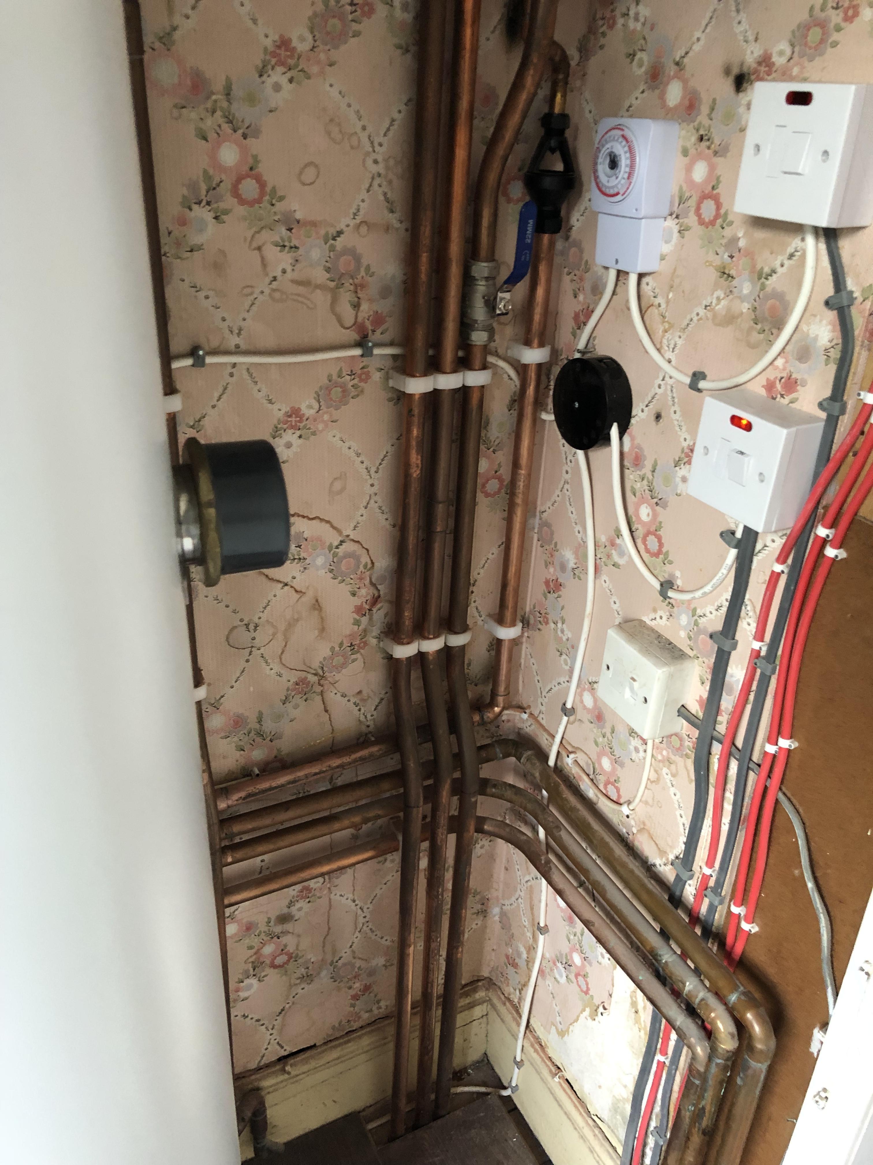

Pocster Posted September 20, 2019 Author Share Posted September 20, 2019 Well there you go ! Fancy that ! Multiple systems to reduce chance of failure simultaneously and they fail today ! Boiler diverter valve failure ( ain’t it always ) also uvc ( not fed from boiler ) has failed !!! . On the same day !! Coincidence?!?!?!? - Link to comment Share on other sites More sharing options...

Pocster Posted September 26, 2019 Author Share Posted September 26, 2019 Well ! Unsurprisingly the guy who installed the uvc has diagnosed the fault and was meant to fix it today . Whats amazing is I have my automated heating system which shows when someone’s in the room . By coincidence the tenant for the room with uvc is away . Guess what ? No one’s been in - though keys are accessible! . Better yet of course I have Cctv !! / nope can’t see uvc guy ! Thats 1 week tomorrow with no hot showers ... Guess i’ll Have to give up on his ‘warranty ‘ repair I.e never turn up and pay someone instead ffs !!! Link to comment Share on other sites More sharing options...
Pocster Posted September 26, 2019 Author Share Posted September 26, 2019 His twat text ( even though he hasn’t been there ) says the thermostat is gone . Looking back at my photo of the tank - where is the thermostat????????? Link to comment Share on other sites More sharing options...
Pocster Posted September 26, 2019 Author Share Posted September 26, 2019 Is the black lump on the tank the stat ?? old photo ! Link to comment Share on other sites More sharing options...
ProDave Posted September 26, 2019 Share Posted September 26, 2019 That looks like the immersion heater to me (which will have a thermostat in it) Being that high up the tank, there are probably 2 of them. Is this direct or indirect, i.e. is the immersion heater(s) the only thing heating it? Link to comment Share on other sites More sharing options...
Pocster Posted September 26, 2019 Author Share Posted September 26, 2019 4 minutes ago, ProDave said: That looks like the immersion heater to me (which will have a thermostat in it) Being that high up the tank, there are probably 2 of them. Is this direct or indirect, i.e. is the immersion heater(s) the only thing heating it? Yes afaik - heated just by electric immersion . Link to comment Share on other sites More sharing options...
ProDave Posted September 26, 2019 Share Posted September 26, 2019 Why is the top switch fuse feeding the time switch turned off? What test equipment do you have e.g a multimeter? Link to comment Share on other sites More sharing options...
Pocster Posted September 26, 2019 Author Share Posted September 26, 2019 Just now, ProDave said: Why is the top switch fuse feeding the time switch turned off? What test equipment do you have e.g a multimeter? That’s just the way it was installed . So in theory I could boost hot water using the timer - but it seems fine with just 1 element heating . As I pay the electric bill ... Link to comment Share on other sites More sharing options...
ProDave Posted September 26, 2019 Share Posted September 26, 2019 Just now, pocster said: That’s just the way it was installed . So in theory I could boost hot water using the timer - but it seems fine with just 1 element heating . As I pay the electric bill ... So I am guessing the bottom switch fuse is the off peak feed feeding the bottom heater? So that's where you need to look, at the bottom heater. Turn the switch fuse off, take the cover off. You should see a thermostat. There will be a (often VERY tiny) overheat trip. If it has popped out, try pushing it in and see if it clicks. Otherwise you need some test gear. 1 Link to comment Share on other sites More sharing options...
