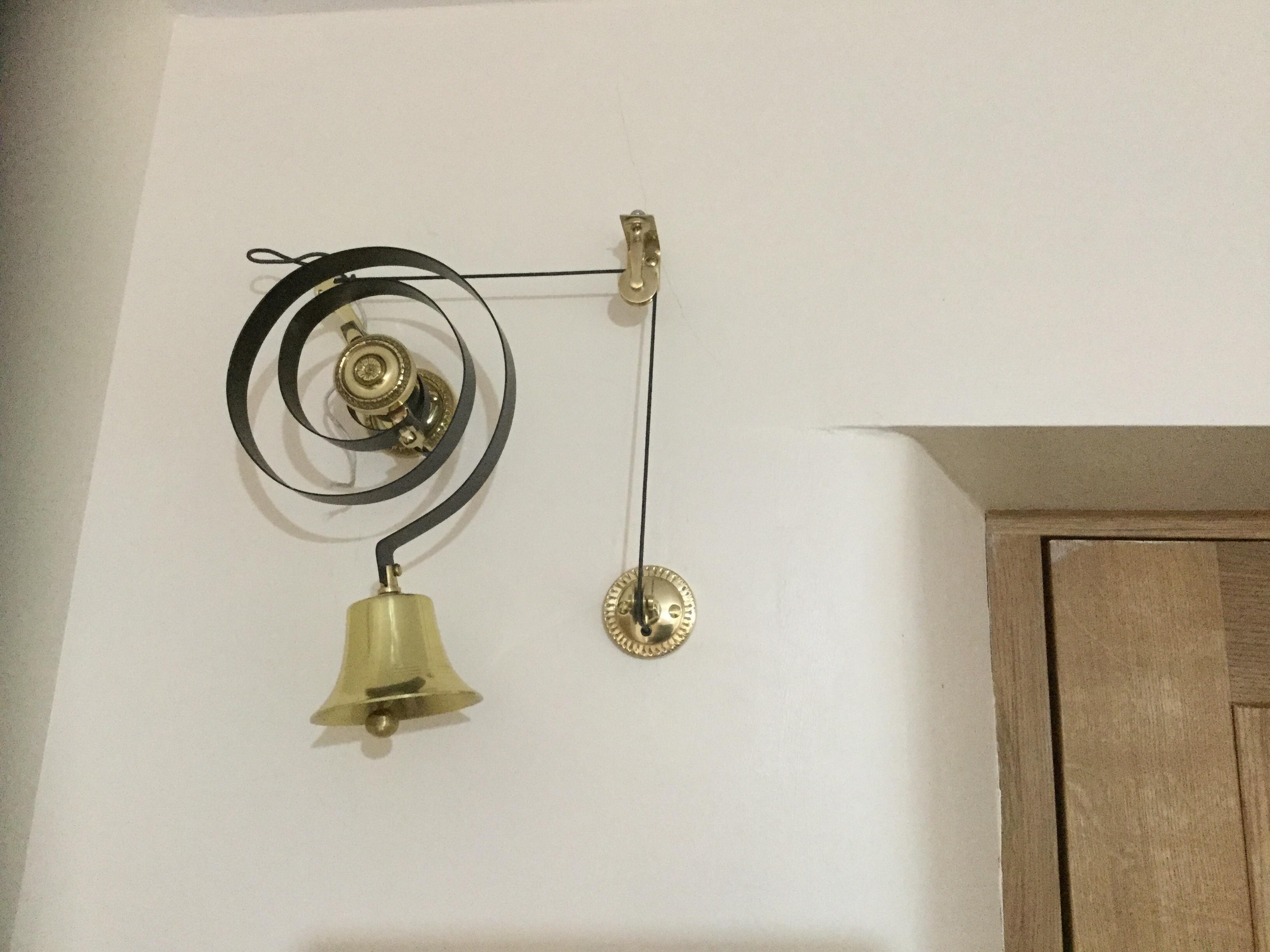

joe90 Posted November 4, 2018 Posted November 4, 2018 I quite like being a Luddite, less to go wrong. A recent visitor liked our new house and commented on our front door bell being reliable and nothing to go wrong!, well I replied, the string could break but I am sure that could be repaired. 3
Roger440 Posted November 4, 2018 Posted November 4, 2018 57 minutes ago, joe90 said: I quite like being a Luddite, less to go wrong. A recent visitor liked our new house and commented on our front door bell being reliable and nothing to go wrong!, well I replied, the string could break but I am sure that could be repaired. I’m liking that. How have you dealt with the hole in the wall?

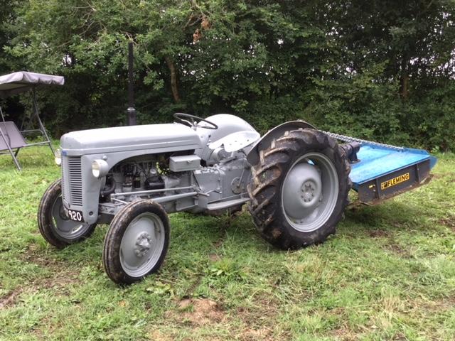

joe90 Posted November 4, 2018 Posted November 4, 2018 (edited) 68 years old and all the spares are still available (and I don’t need a computer to diagnose any faults!) ? P.S. I don’t have an iPhone. Edited November 4, 2018 by joe90
joe90 Posted November 4, 2018 Posted November 4, 2018 2 hours ago, Roger440 said: I’m liking that. How have you dealt with the hole in the wall? 2mm dia string fed through 2.5mm hole in fibreglass rod (old tent pole) from plaster to outside of brick skin, brass cover on the inside has 2mm rubber grommet for string to go through. I deemed this an acceptable cold bridge and break in the airtightness.i had thought about making a rubber diaphragm fixed to the string but think it’s overkill. 1
Roger440 Posted November 4, 2018 Posted November 4, 2018 30 minutes ago, joe90 said: 2mm dia string fed through 2.5mm hole in fibreglass rod (old tent pole) from plaster to outside of brick skin, brass cover on the inside has 2mm rubber grommet for string to go through. I deemed this an acceptable cold bridge and break in the airtightness.i had thought about making a rubber diaphragm fixed to the string but think it’s overkill. Excellent job Im offto buy one!
joe90 Posted November 4, 2018 Posted November 4, 2018 (edited) https://www.ebay.co.uk/itm/Butlers-Bell-Brass-BLACK-IRON-PULL-Full-Kit-Similar-to-Byron-62500K-/230834119650?hash=item35bec923e2 @Roger440 gosh, they have come down in price since I bought mine ? P.S. I stained the white string black with boot polish! Edited November 4, 2018 by joe90
Roger440 Posted November 4, 2018 Posted November 4, 2018 16 minutes ago, joe90 said: https://www.ebay.co.uk/itm/Butlers-Bell-Brass-BLACK-IRON-PULL-Full-Kit-Similar-to-Byron-62500K-/230834119650?hash=item35bec923e2 @Roger440 gosh, they have come down in price since I bought mine ? P.S. I stained the white string black with boot polish! Even more excellent Shall be bought this evening. Im considering extending it a second bell in the hall............

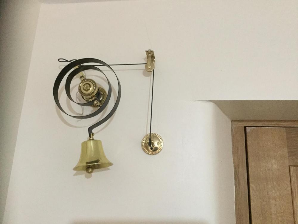

readiescards Posted November 5, 2018 Author Posted November 5, 2018 Same bell but driven by a relay controlled by Raspberry pi monitoring two infrared sensors on my gates. The only trouble is the bell can not be heard in all parts of the house so using Home Assistant and a MQTT broker, I intend for the Raspberry Pi to publish a topic to the MQTT broker when ever the infrared beams are broken and a wifi Sonoff running Tasomota will be subscribed to that topic and will ring a bell, make a buzz elsewhere in the house. Still working on getting the C program on the Pi to call the MQTT broker though. 1 1
readiescards Posted November 5, 2018 Author Posted November 5, 2018 I sourced my Bell here: https://www.houseofbrass.co.uk/bp32-pb-butlers-bell-pulleys-polished-brass?___SID=U 1

Dave Jones Posted November 29, 2020 Posted November 29, 2020 On 04/11/2018 at 13:51, joe90 said: 68 years old and all the spares are still available (and I don’t need a computer to diagnose any faults!) ? P.S. I don’t have an iPhone. TVO ? Start with the gearstick ?
joe90 Posted November 29, 2020 Posted November 29, 2020 56 minutes ago, Dave Jones said: TVO ? Start with the gearstick ? Yes mate, TVO not bothering with tho, can’t buy it anymore, you can make your own but it’s harder on the engine so I only run it on petrol. Great little useful “toy” ?
Dave Jones Posted November 29, 2020 Posted November 29, 2020 1 hour ago, joe90 said: Yes mate, TVO not bothering with tho, can’t buy it anymore, you can make your own but it’s harder on the engine so I only run it on petrol. Great little useful “toy” ? lovely looking machine, did you restore her yourself ? It's on my bucket list to sort a fergie.
