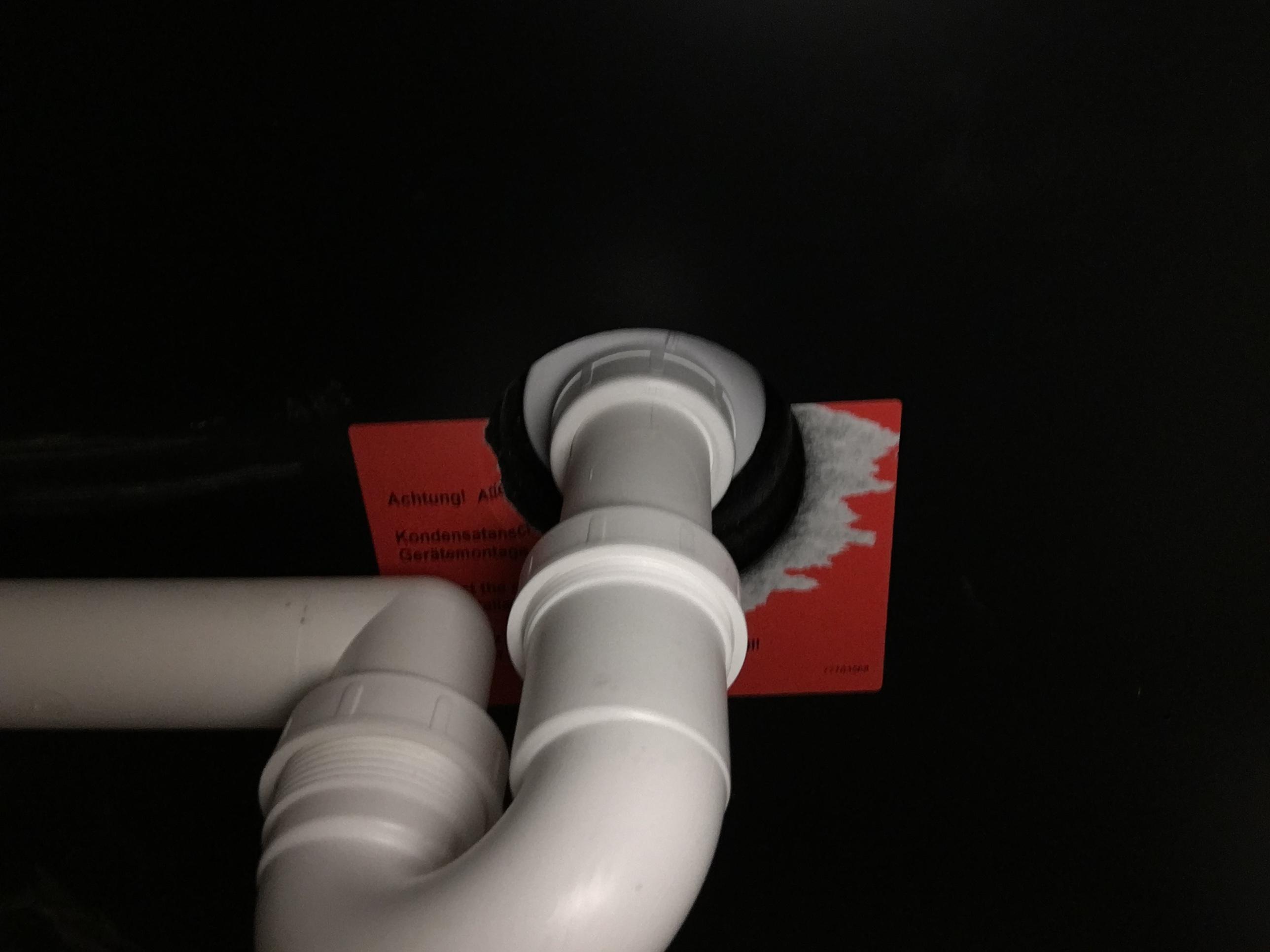

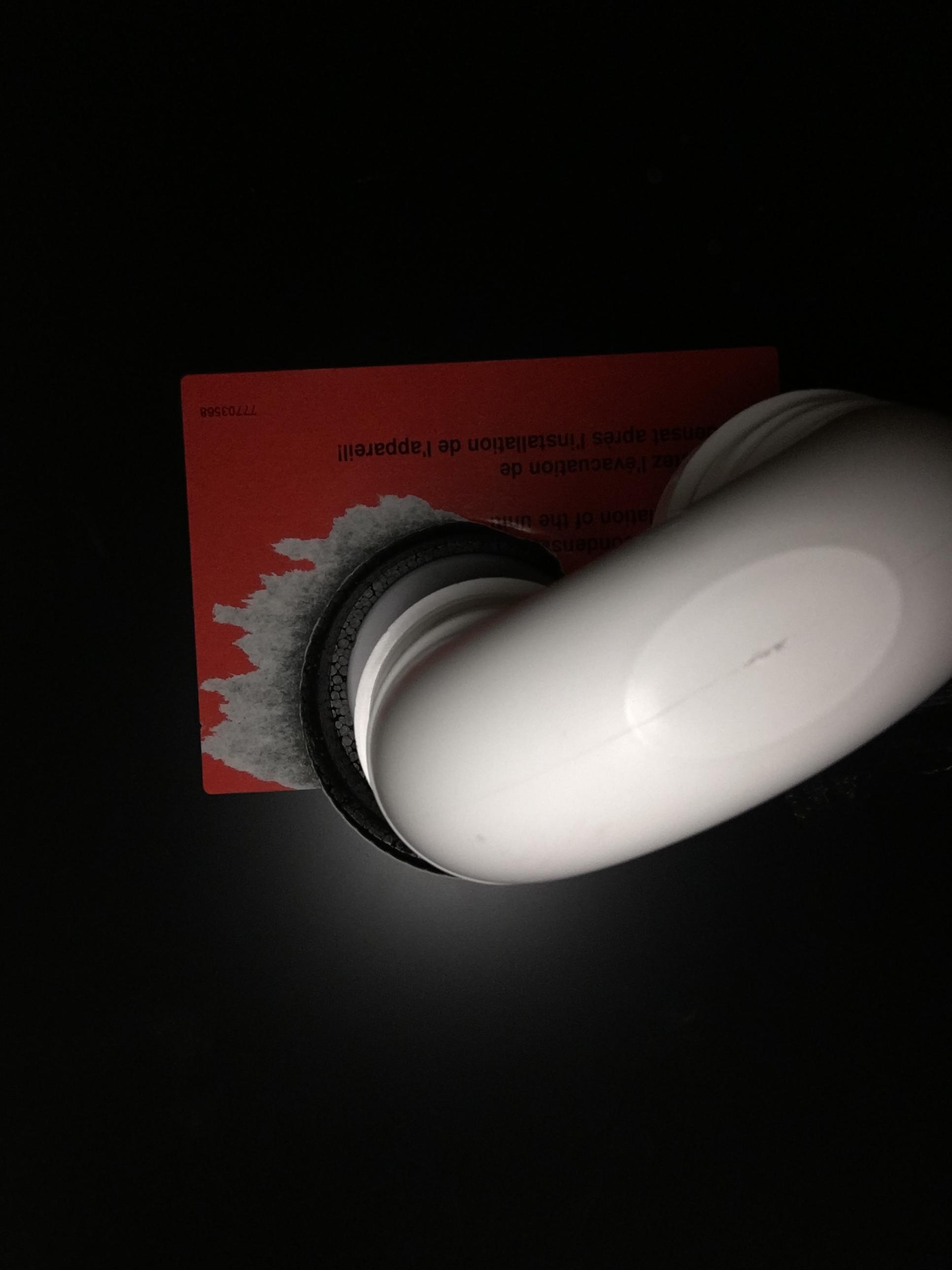

PeterW Posted October 22, 2018 Share Posted October 22, 2018 Thanks @lizzie So the trap is part of the actual unit itself so can’t be replaced. It fits into a 40mm pushfit from the looks of it so it’s a relatively simple fix to put a Hep20 dry trap in the waste and let the u-bend dry out. It needs a slim plumber by the looks of it so @Nickfromwales your luck is out ..! ? 1 1 Link to comment Share on other sites More sharing options...

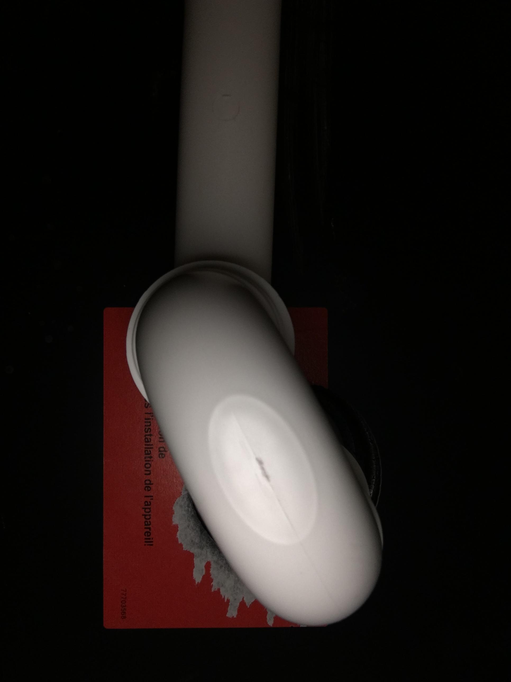

Nickfromwales Posted October 23, 2018 Share Posted October 23, 2018 Enough of this bollocks about buckets and cap ends ? Lizzie, a horizontal waterless trap will do the job. First off though, could you get a pic of the underside of the MVHR unit? I need to see how the trap connects to the MVHR unit if possible ? Ta. 1 Link to comment Share on other sites More sharing options...
PeterW Posted October 23, 2018 Share Posted October 23, 2018 4 hours ago, Nickfromwales said: Lizzie, a horizontal waterless trap will do the job. First off though, could you get a pic of the underside of the MVHR unit? I need to see how the trap connects to the MVHR unit if possible ? Ta. @Nickfromwales you need to catch up... 19 hours ago, PeterW said: So the trap is part of the actual unit itself so can’t be replaced. It fits into a 40mm pushfit from the looks of it so it’s a relatively simple fix to put a Hep20 dry trap in the waste and let the u-bend dry out. Wierd design but the trap is threaded to the bottom of the unit and then you would need to cut both pipes and just put the other waterless trap in the gap as a connector. Link to comment Share on other sites More sharing options...
Nickfromwales Posted October 23, 2018 Share Posted October 23, 2018 That been confirmed then ? Wasn’t how I read it tbh but I’m not the sharpest tack ? There are shallow basin wastes with integral waterless valves ( which could screw onto a 40x32mm adapter if that’s a 40mm trap that is ) and then join the waste to the trap with a flexi connector. No glueing etc and easy, permanent ‘one trap’ fix. https://www.tapwarehouse.com/product/uniwaste for eg. Link to comment Share on other sites More sharing options...
PeterW Posted October 23, 2018 Share Posted October 23, 2018 1 minute ago, Nickfromwales said: That been confirmed then ? Wasn’t how I read it tbh but I’m not the sharpest tack ? There are shallow basin wastes with integral waterless valves ( which could screw onto a 40x32mm adapter if that’s a 40mm trap that is ) and then join the waste to the trap with a flexi connector. No glueing etc and easy, permanent ‘one trap’ fix. https://www.tapwarehouse.com/product/uniwaste for eg. I read the manual ..... Link to comment Share on other sites More sharing options...

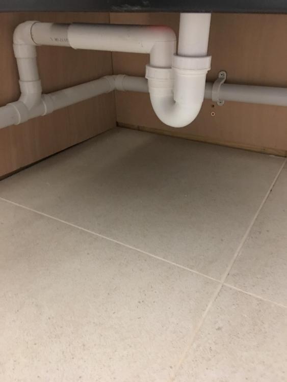

lizzie Posted October 23, 2018 Author Share Posted October 23, 2018 Thanks guys......veryconfused.com here @Nickfromwales pics of underside ofmvhr unit taken from floo looking up. I really appreaciate all the help and advice thank you. Link to comment Share on other sites More sharing options...

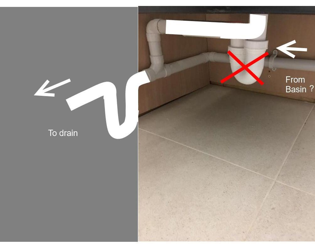

Temp Posted October 24, 2018 Share Posted October 24, 2018 Lizzie, This picture suggests there is another appliance or sink in the same room? Perhaps you can arrange both to share the same trap so that the other appliance/sink keeps the trap full. Might be better than a waterless trap but what do others think? Something like this.. Link to comment Share on other sites More sharing options...
lizzie Posted October 24, 2018 Author Share Posted October 24, 2018 nothing else in there it is the plant room. The pipe that runs around the wall is I think the condensate pipe from the boiler which drains into that waste rather than externally. Link to comment Share on other sites More sharing options...

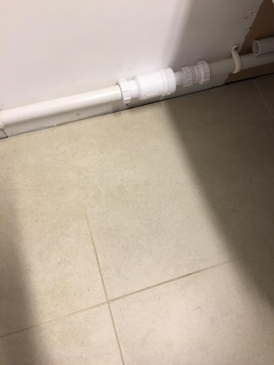

PeterW Posted October 24, 2018 Share Posted October 24, 2018 28 minutes ago, lizzie said: nothing else in there it is the plant room. The pipe that runs around the wall is I think the condensate pipe from the boiler which drains into that waste rather than externally. Is the condensate trap drying out too as that will contribute to the smell. I would put the waterless trap in the straight section after both the MVHR and the boiler join in that case. Link to comment Share on other sites More sharing options...
lizzie Posted October 24, 2018 Author Share Posted October 24, 2018 7 minutes ago, PeterW said: Is the condensate trap drying out too as that will contribute to the smell. I would put the waterless trap in the straight section after both the MVHR and the boiler join in that case. Thank you that makes good sense. I will look for a plumber next. Do you think I should get the waterless trap myself or let plumber supply? I would just ask in the shop what they suggested I buy. Link to comment Share on other sites More sharing options...
PeterW Posted October 24, 2018 Share Posted October 24, 2018 Looks like 40mm solvent weld so you need a HepV0 CV1 and a HepV0 CV3 running adaptor 1 Link to comment Share on other sites More sharing options...

PeterW Posted October 25, 2018 Share Posted October 25, 2018 @lizzie you only need one adapter as the other end is already 40mm 1 Link to comment Share on other sites More sharing options...

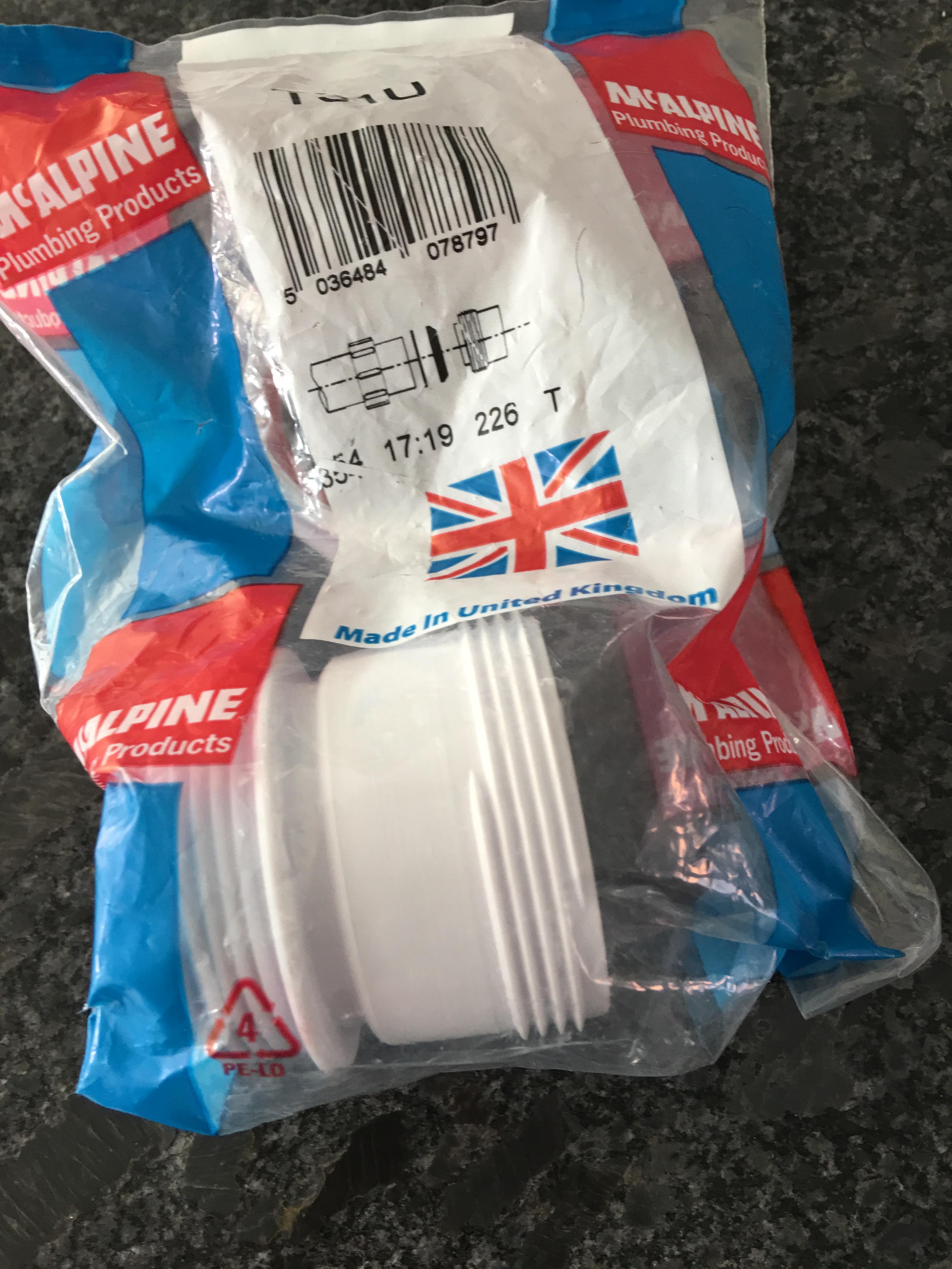

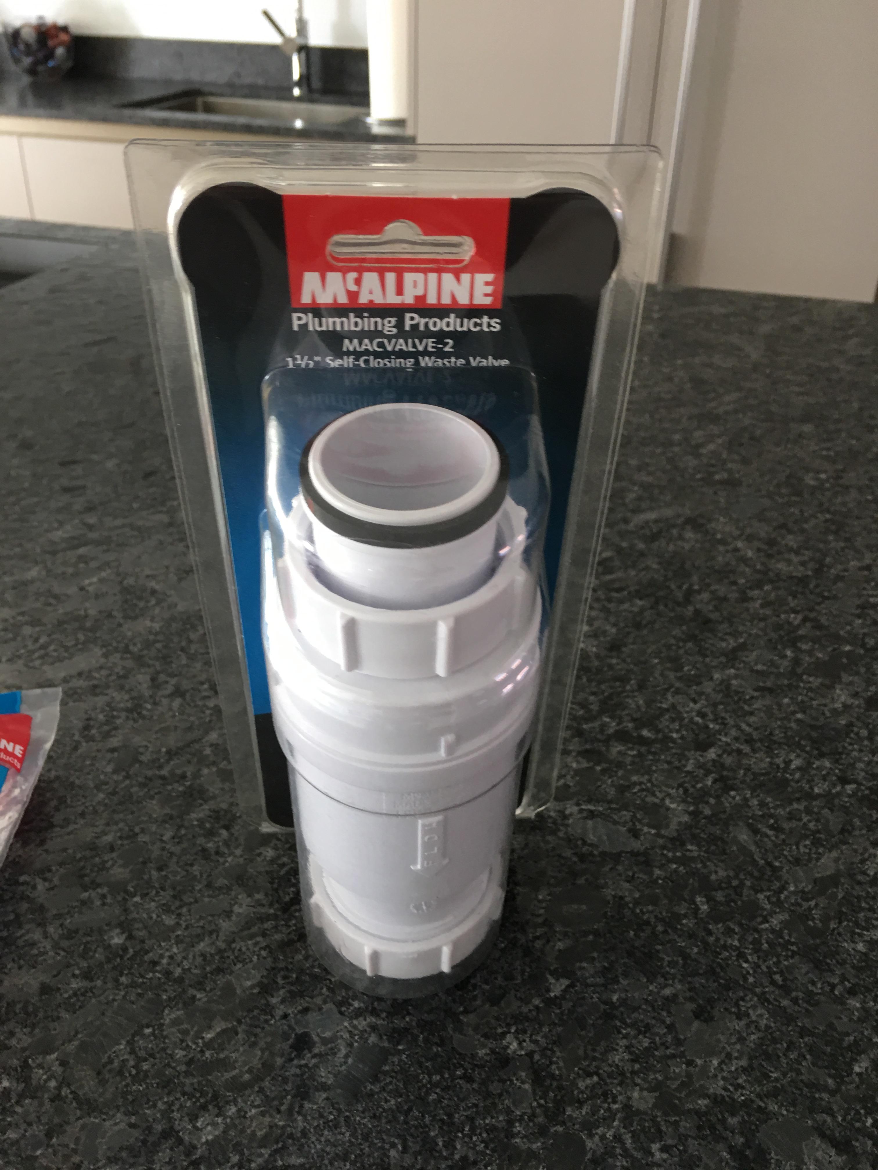

lizzie Posted October 26, 2018 Author Share Posted October 26, 2018 On 25/10/2018 at 11:18, PeterW said: @lizzie you only need one adapter as the other end is already 40mm Thank you. I have been and bought them.....they didnt have the brand you said (despite web site saying in stock) sold me McAlpine which they said are identical...hope so! Trying to find a plumber now. Link to comment Share on other sites More sharing options...
