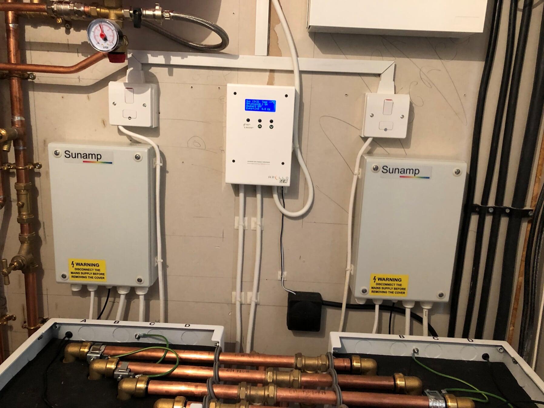

As @Barney12 and I have just discovered, with the Apollo GEM in this instance, not very well at all :(.

Oh and to keep the thread exciting how about a picture :)

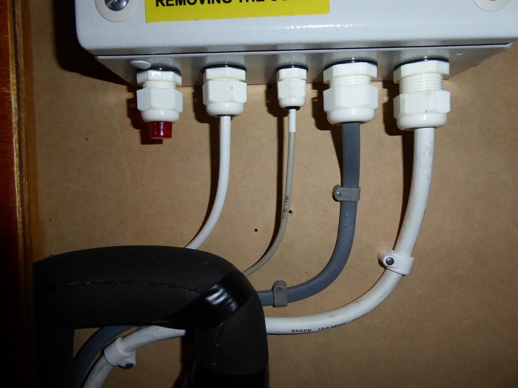

2 hours ago, JSHarris said:
One slight snag with the Sunamp Uniq models that have an electric heating element is that you can't tell whether or not the power relay is on.  I fixed this on mine by adding a 230 VAC neon indicator to the power relay A1 and A2 terminals, with the indicator fitted into one of the spare cable glands on the box.  I can now see at a glance whether the Sunamp is calling for heat or not, which is very useful, IMHO.
I need to do this! Have you got a part number or link to the neon you used?
I can't understand why a PV diverter needs to know the temperature of anything.  Mine only knows about the power flowing into or out of the house supply and needs nothing more to work perfectly.  Others are similar to the way mine works, as I looked at how a few work before building mine, although I haven't heard of the Apollo GEM before now.  The main variation between the different makes available is how they switch excess power to a load (and it can be any load, doesn't have to be a water heater).  Mine uses an energy bucket principle, with bursts of power being zero-crossing switched to the diversion load, others use a variable power switching method, either by using phase control or by using a zero-crossing pulsed control.  None should need anything other than instantaneous power sensing at the meter tails to work properly.
I just boost mine by switching out the PV diverter and applying power directly from the supply to the Sunamp.  I have a time switch to do this, in series with a 20 A  switch to isolate the boost function in summer.  Dead easy to wire up and allows the time switch to provide an early morning two hour boost in winter when there's not much PV generation, or a manual boost by pushing the over ride button.
The neon I used came with nice long leads that will easily reach the relay A1 and A2 connections, £1.90 from eBay, including postage.  It's 10mm in diameter so is a nice snug fit in the spare cable gland: https://www.ebay.co.uk/itm/Red-Neon-Indicator-Pilot-Signal-Lamp-AC-220V-w-Cable-UK-Seller/372357642057?hash=item56b23eb749:g:vTAAAOSw7mpbPRpC:rk:1:pf:1
Have you got a photo. I can't get that straight in my mind.
This photo isn't that clear and doesn't show that there are four wires coming from the PV diverter into the timer and boost enable switch, an always-on line direct from the 20 A isolator, a switched line from the PV diverter, and a neutral and PE.  The switch in the time switch is connected in series with the boost enable switch below, so timed boost only works when the boost enable switch under the time switch is on.  The timer has an over ride push button that allows a manual boost at any time.
329257961_AnnotatedSunampUniQeHWinstallation.thumb.JPG.b3094b0d6ff4172b3c3b8c6be4369a12.JPG
The RCBO protected 20 A supply from the consumer unit runs to the 20 A DP isolator, and from there one cable runs to the PV diverter and another runs to the 5 A fused connection unit.  The two cables from the FCU run to the Sunamp control box and the flow switch that controls our preheat pump.  The PV diverter only switches the line conductor on and off, using a 25 A solid state relay.  It's fine to just bypass this solid state relay with the time switch contacts.
