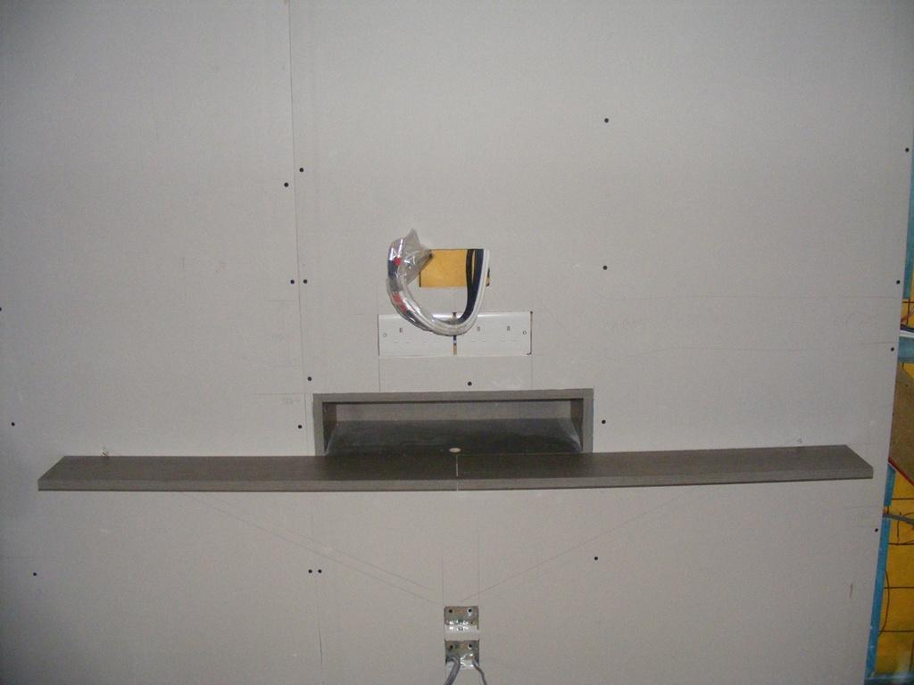

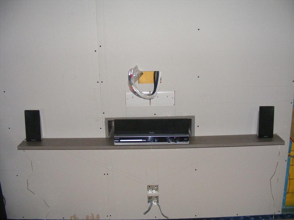

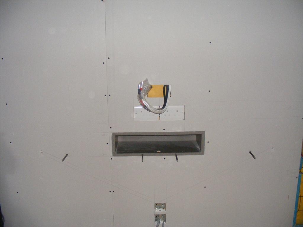

ProDave Posted October 15, 2018 Author Posted October 15, 2018 I used the "brackets" I linked to a few posts ago. Here is the "pocket" already in the wall and the pins screwed in place. As I guessed, the bit that goes into the wall is an M6 thread, that screws nice and snug into a 5.5mm hole drilled into the wood. The shelf slides onto those pins. I drilled 9.5mm holes to make it a less snug fit. It is important to drill these carefully, I used the pillar drill. Not much room for error drilling a 9.5mm hole into a 19mm thick shelf. And this it what is it for. The surround sound unit and the front speakers. The tv will be mounted on the wall immediately above, and as near to touching (but not quite) the front centre speaker as I can get it. 1

ProDave Posted December 5, 2018 Author Posted December 5, 2018 Just to finish the thread off, here is the finished item: 1
