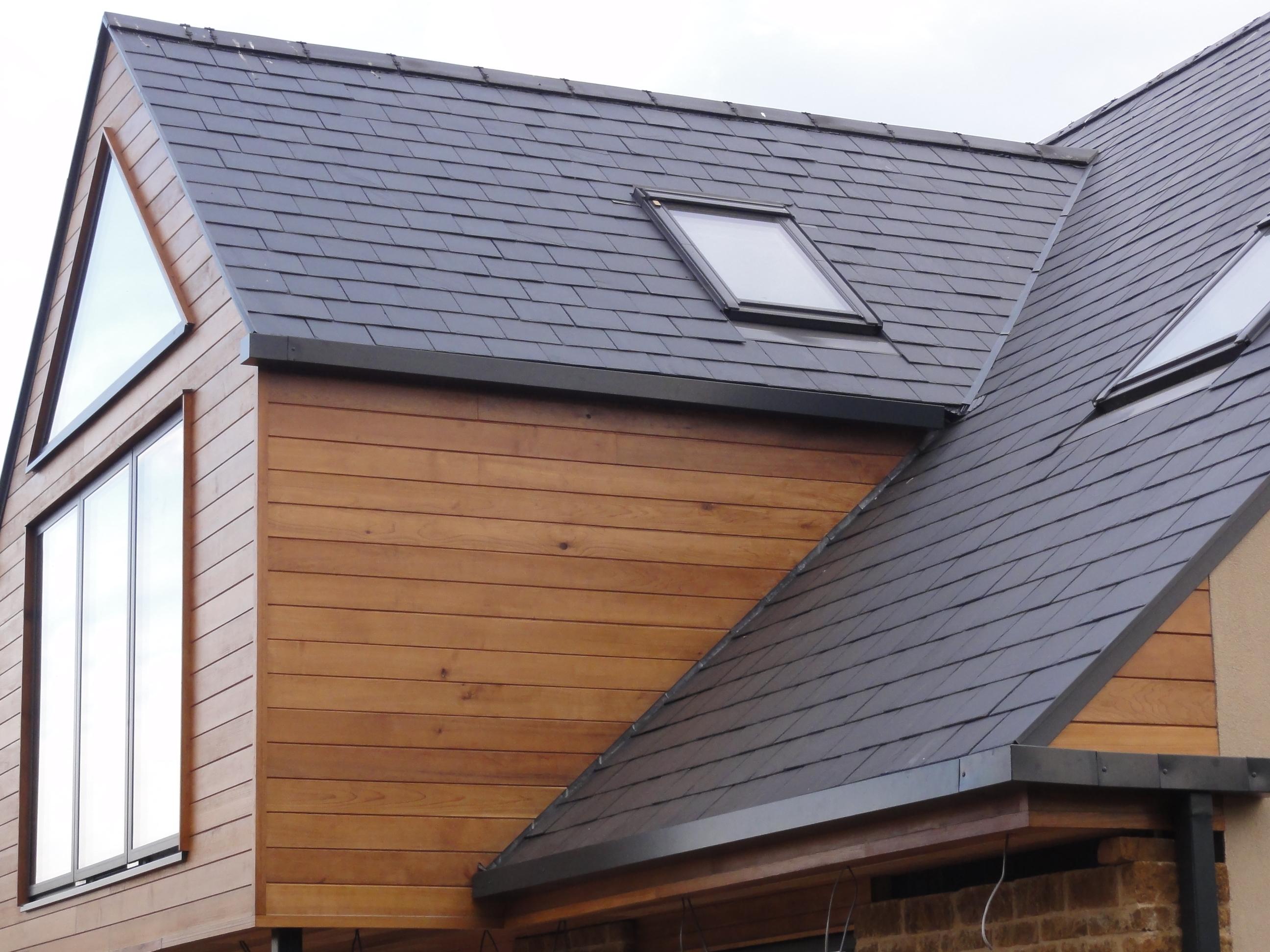

Moira Niedzwiecka Posted October 1, 2018 Share Posted October 1, 2018 We have used exterior Osmo oil with the oak stain as we did not want the cedar to silver. We used the clear osmo to start with but found out it doesn't have great UV protection. The cedar started to lose its colour & grey quite quickly. The new stain looks good & is showing no signs of weathering yet. We tried the other colours available but the oak was nearest to the original colour of the cedar. As it is translucent it there is still a variation between the cedar planks. The cedar stain is too orangey red. I would get a sample sachet & try it in a discreet place. 2 1 Link to comment Share on other sites More sharing options...
Weegaz Posted October 1, 2018 Author Share Posted October 1, 2018 58 minutes ago, Moira Niedzwiecka said: We have used exterior Osmo oil with the oak stain as we did not want the cedar to silver. We used the clear osmo to start with but found out it doesn't have great UV protection. The cedar started to lose its colour & grey quite quickly. The new stain looks good & is showing no signs of weathering yet. We tried the other colours available but the oak was nearest to the original colour of the cedar. As it is translucent it there is still a variation between the cedar planks. The cedar stain is too orangey red. I would get a sample sachet & try it in a discreet place. Thanks Moira, Looks closer to the colour we are after, we have White rendered house so the greyness isn’t contrasting well enough. Did you do any prep work, like sanding? Was it greying before you stained? Link to comment Share on other sites More sharing options...
Moira Niedzwiecka Posted October 2, 2018 Share Posted October 2, 2018 It was just starting to grey slightly, it looked faded & had lost the lovely variation of colours it had when new. I think if we had left it any longer it would have silvered quickly in certain places and looked patchy. Our site is quite exposed to both sun & rain Our render is a soft sand colour & grey would not look good with it or the ironstone. Osmo advised me that the clear oil would need treating every couple of years and the stained one about 5 years. It has only had one coat of the oak stain oil. I would give the technical department at osmo a call for advice or the cedar supplier. If you have any spare pieces that have greyed try it on them without sanding initially. We were nervous that it would look really false but it looks quite smart. Happy! Link to comment Share on other sites More sharing options...

laurenco Posted February 27, 2019 Share Posted February 27, 2019 (edited) On 01/10/2018 at 20:36, Moira Niedzwiecka said: We have used exterior Osmo oil with the oak stain as we did not want the cedar to silver. We used the clear osmo to start with but found out it doesn't have great UV protection. The cedar started to lose its colour & grey quite quickly. The new stain looks good & is showing no signs of weathering yet. We tried the other colours available but the oak was nearest to the original colour of the cedar. As it is translucent it there is still a variation between the cedar planks. The cedar stain is too orangey red. I would get a sample sachet & try it in a discreet place. Hi @Moira Niedzwiecka Sorry for jumping on the post. I love the photo of your house and am wondering what to ask for to get this type of gutter? It looks brilliant. Edited February 27, 2019 by laurenco Link to comment Share on other sites More sharing options...
CADjockey Posted March 2, 2019 Share Posted March 2, 2019 On 01/10/2018 at 20:36, Moira Niedzwiecka said: We have used exterior Osmo oil with the oak stain as we did not want the cedar to silver. We used the clear osmo to start with but found out it doesn't have great UV protection. The cedar started to lose its colour & grey quite quickly. The new stain looks good & is showing no signs of weathering yet. We tried the other colours available but the oak was nearest to the original colour of the cedar. As it is translucent it there is still a variation between the cedar planks. The cedar stain is too orangey red. I would get a sample sachet & try it in a discreet place. Your treatment looks similar to how part of ours is designed to look. And we have a triangular window planned like that. My wife is now concerned about how we cover the triangle at night so we don’t wake with th birds every morning. What have you done if you don’t mind me asking? Link to comment Share on other sites More sharing options...

Moira Niedzwiecka Posted March 7, 2019 Share Posted March 7, 2019 On 27/02/2019 at 12:30, laurenco said: Hi @Moira Niedzwiecka Sorry for jumping on the post. I love the photo of your house and am wondering what to ask for to get this type of gutter? It looks brilliant. Hello, Sorry not to reply sooner. We used ARP Ltd from Leicester for the guttering. Really pleased with it. Very good quality. They were really helpful. I purchased directly as they are only about 30 mins away & their sales rep came out & measured up & specified what was needed. ARP also sell via builders merchants. 1 Link to comment Share on other sites More sharing options...
Moira Niedzwiecka Posted March 7, 2019 Share Posted March 7, 2019 @CADjockey I am not covering the top triangle as no one can see in. It is a landing/sitting/study area not a bedroom so not really necessary to cover it. Link to comment Share on other sites More sharing options...
