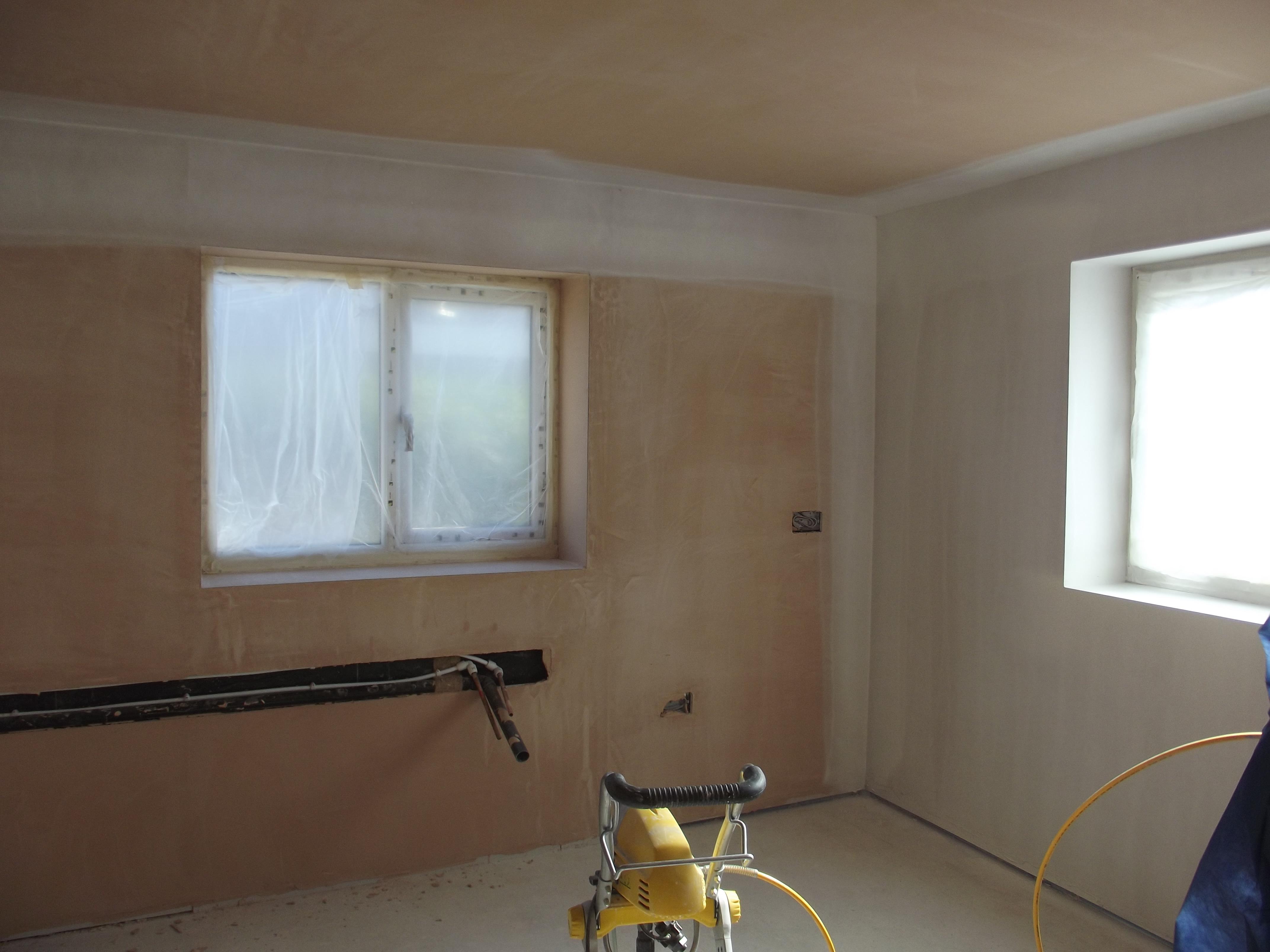

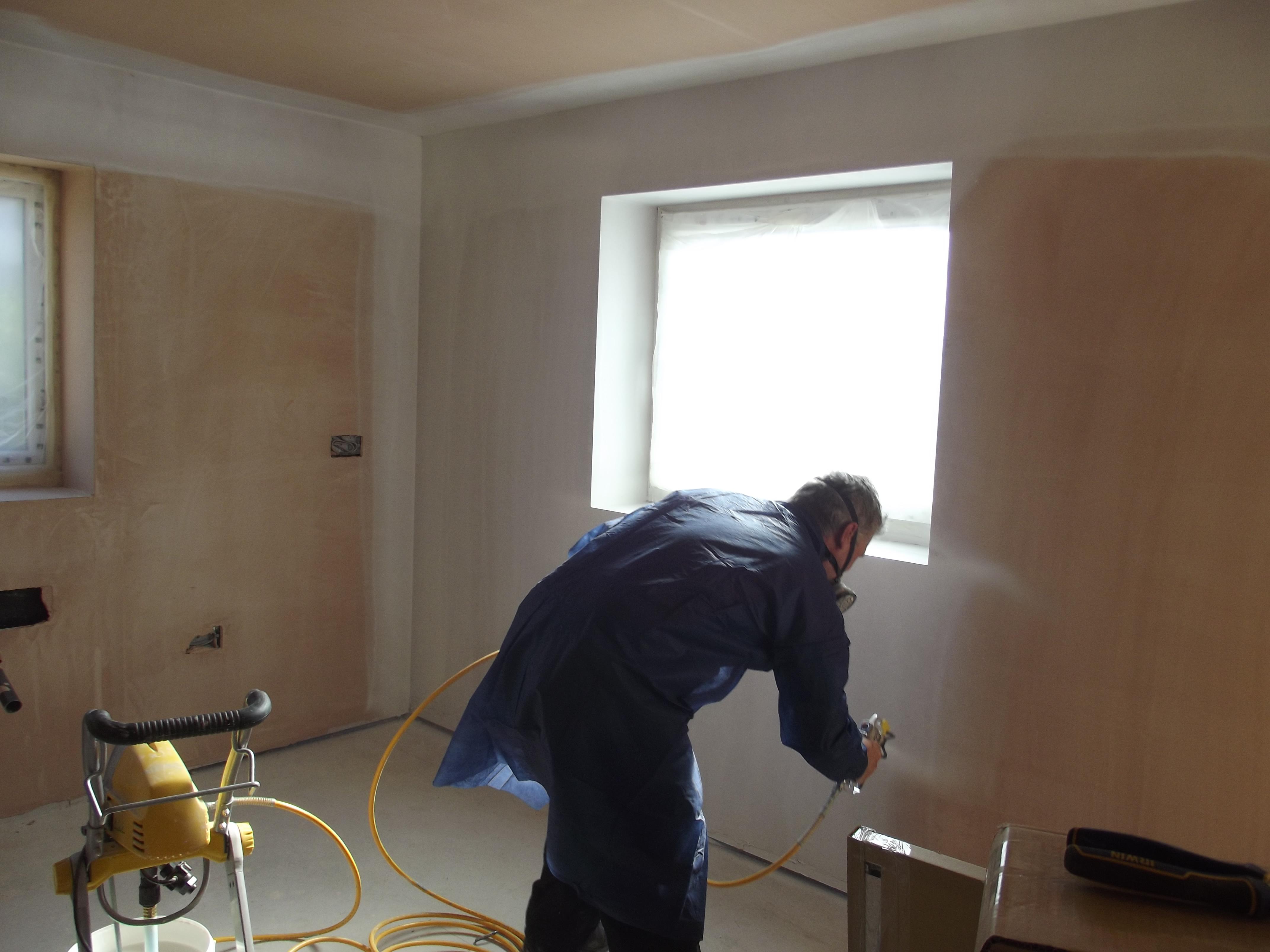

Jeremy Harris Posted September 26, 2018 Posted September 26, 2018 I sprayed the inside of my workshop. Dead easy, no need for masking if you get the settings right - as @Ferdinand says, the key is to keep the pressure down to give a good finish without paint bounce. I found I could easily spray to within a couple of inches of door frames, with no overspray on to the frame, with a bit of practice. I didn't backroll, but managed to get a pretty good finish with the gun. I was amazed at the speed with which you can apply paint - a 5 litre drum of paint seems to just disappear in no time. My pressure sprayer isn't an expensive one (in fact I may well sell it, as I'm not sure I'll use it again) but it still did an impressive job. I've used conventional air-driven spray systems a fair bit, both high pressure and an HVLP unit, and so knew enough to be able to handle the gun OK. The critical thing seemed to be getting the paint really, really well mixed. It's absolutely essential that the paint is power mixed for a lot longer than you might think necessary, as it only takes a small bit of thick stuff to clog the gun filter. I didn't mask anywhere, but used a big painters george, held in my free hand, as a portable mask, as shown in this US video:

Hecateh Posted September 26, 2018 Posted September 26, 2018 Ask me tomorrow - paint spraying is starting then. No flooring down, only first fix electrics and plumbing

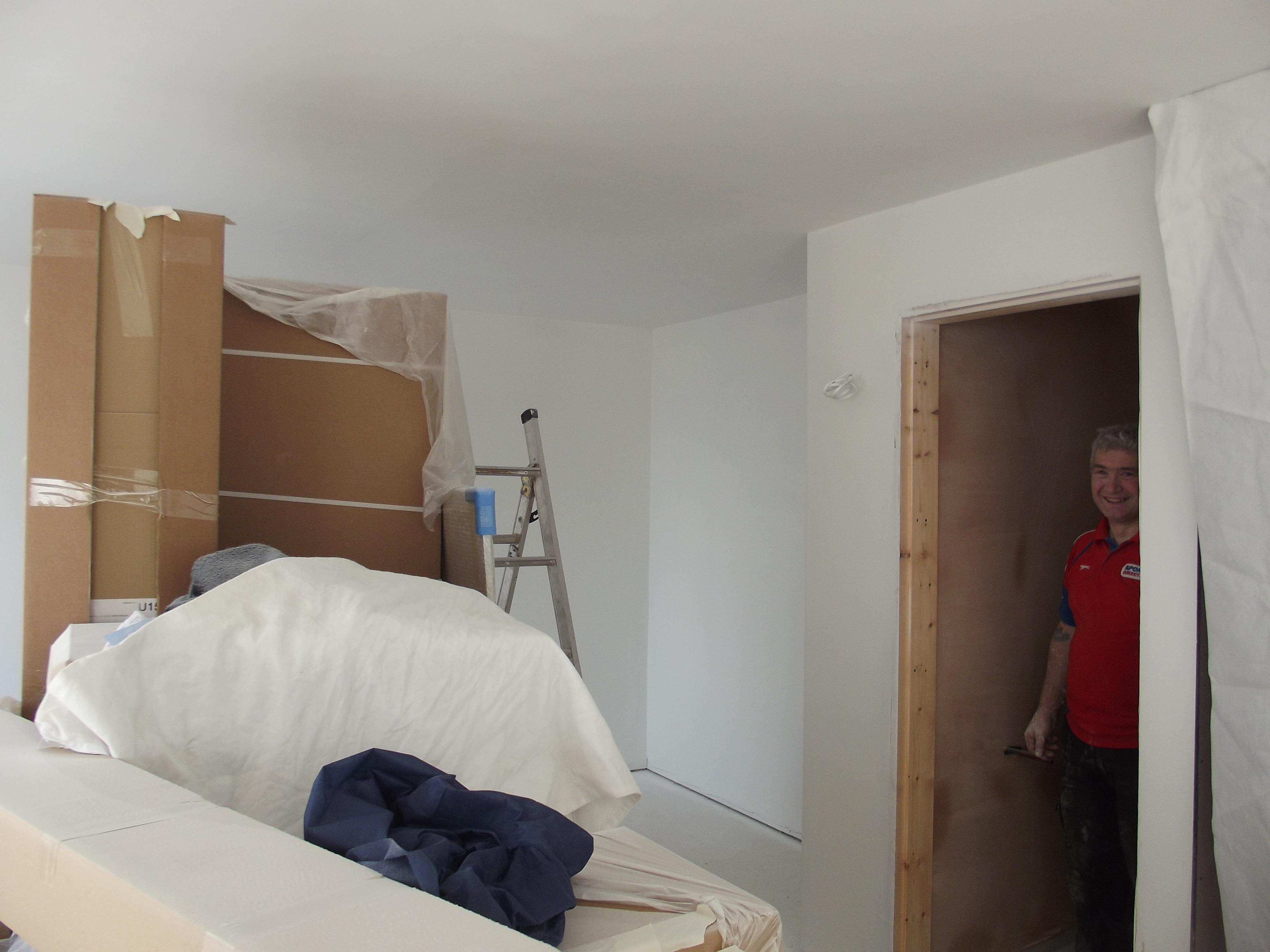

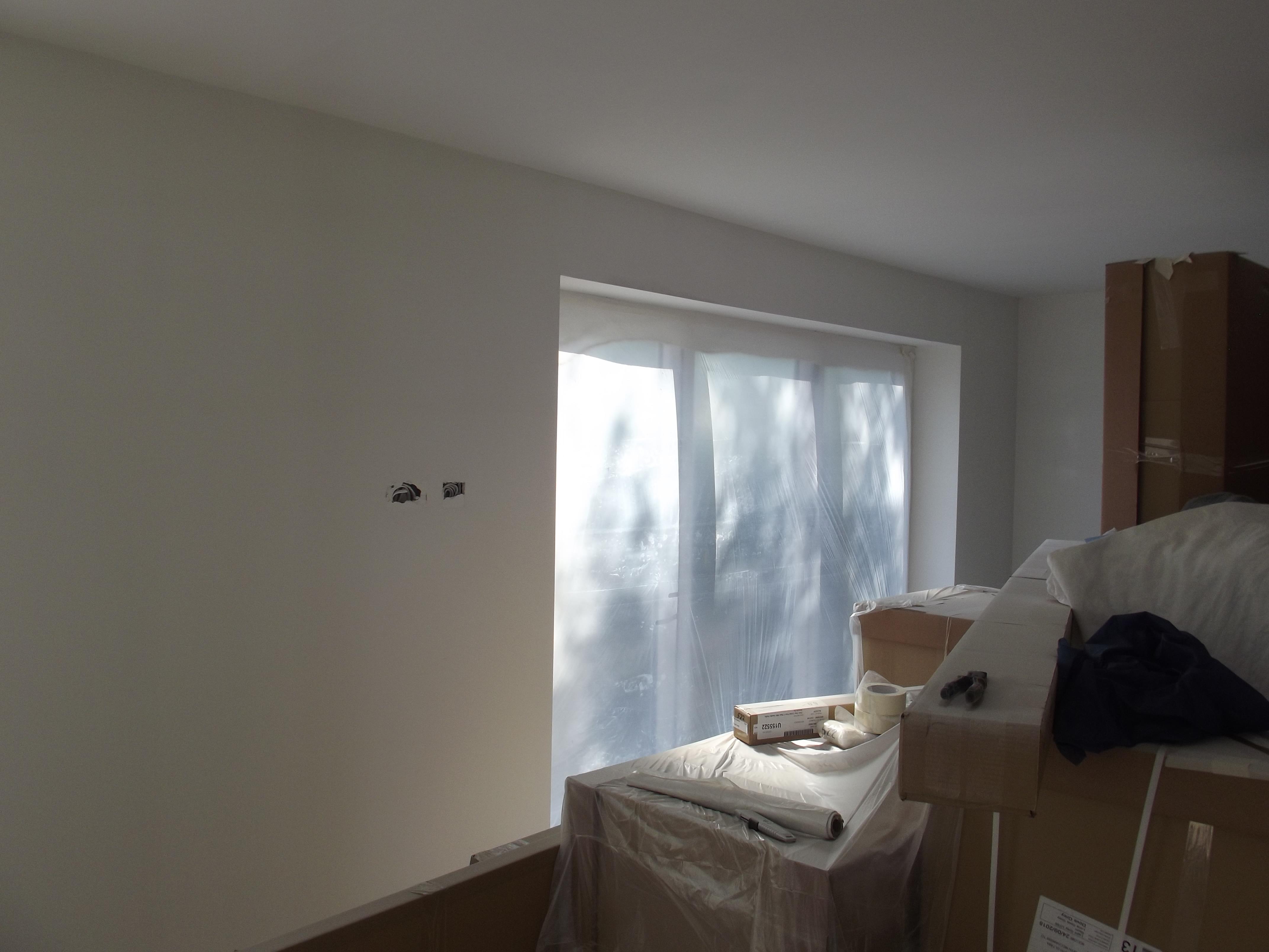

Hecateh Posted September 27, 2018 Posted September 27, 2018 All in the space of a few hours. I did a video but it's an AVI file so I can't upload it (Pics posted with permission)
Hecateh Posted September 27, 2018 Posted September 27, 2018 14 minutes ago, JSHarris said: Impressive, isn't it? Oh Yes converted the video DSCF1416_x264.mp4 DSCF1416_x264.mp4 1
