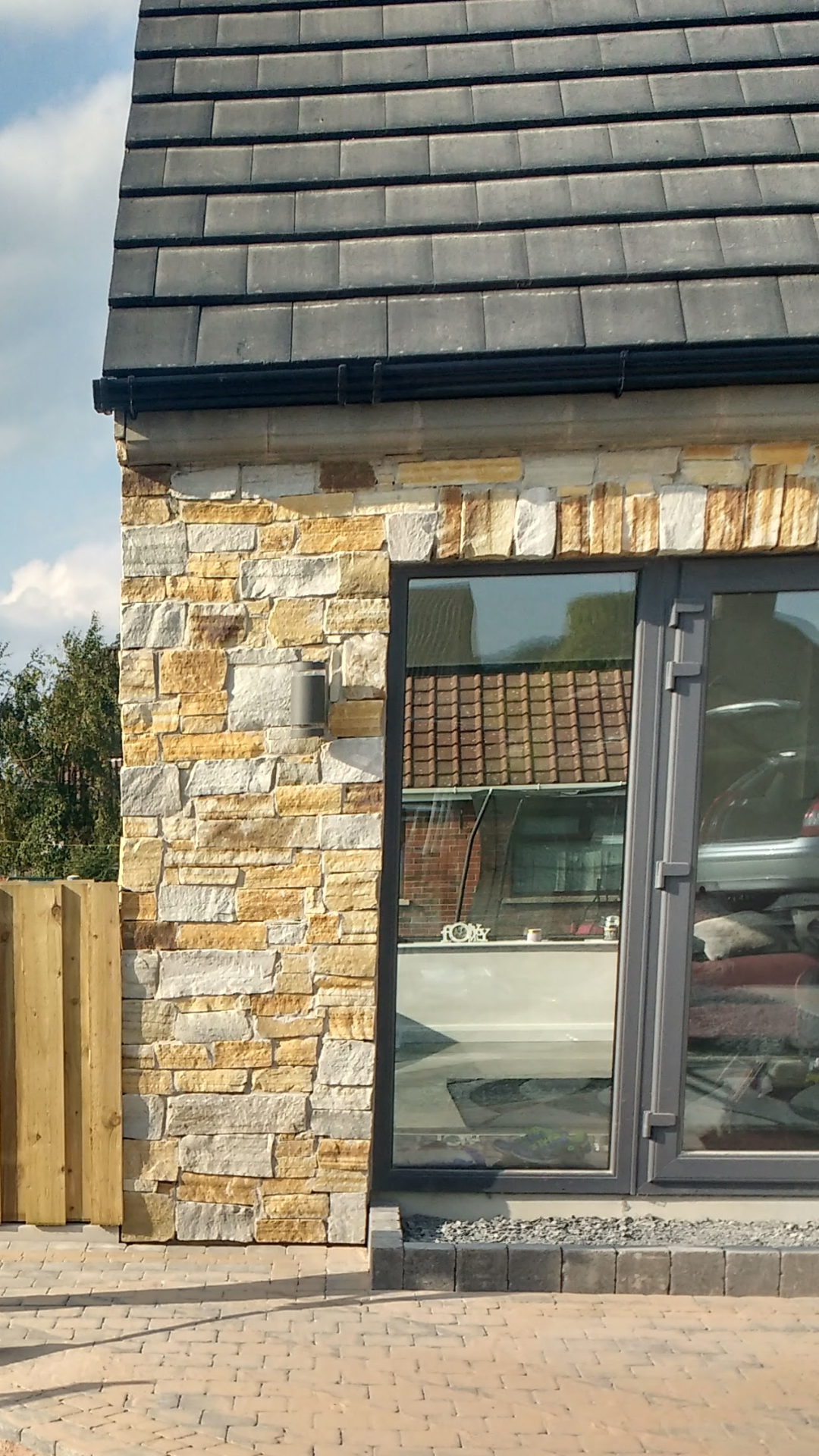

Declan52 Posted September 26, 2018 Posted September 26, 2018 I used a company in co Donegal called mcmonagle stone. They do both the cladding type and normal stone. I only have 2 pics on my phone. The corners are L shaped so look more like real stone work. Mine is silver and gold quartzite. I have the same silver quartzite flecks in my dash so when it's sunny they sparkle. 1

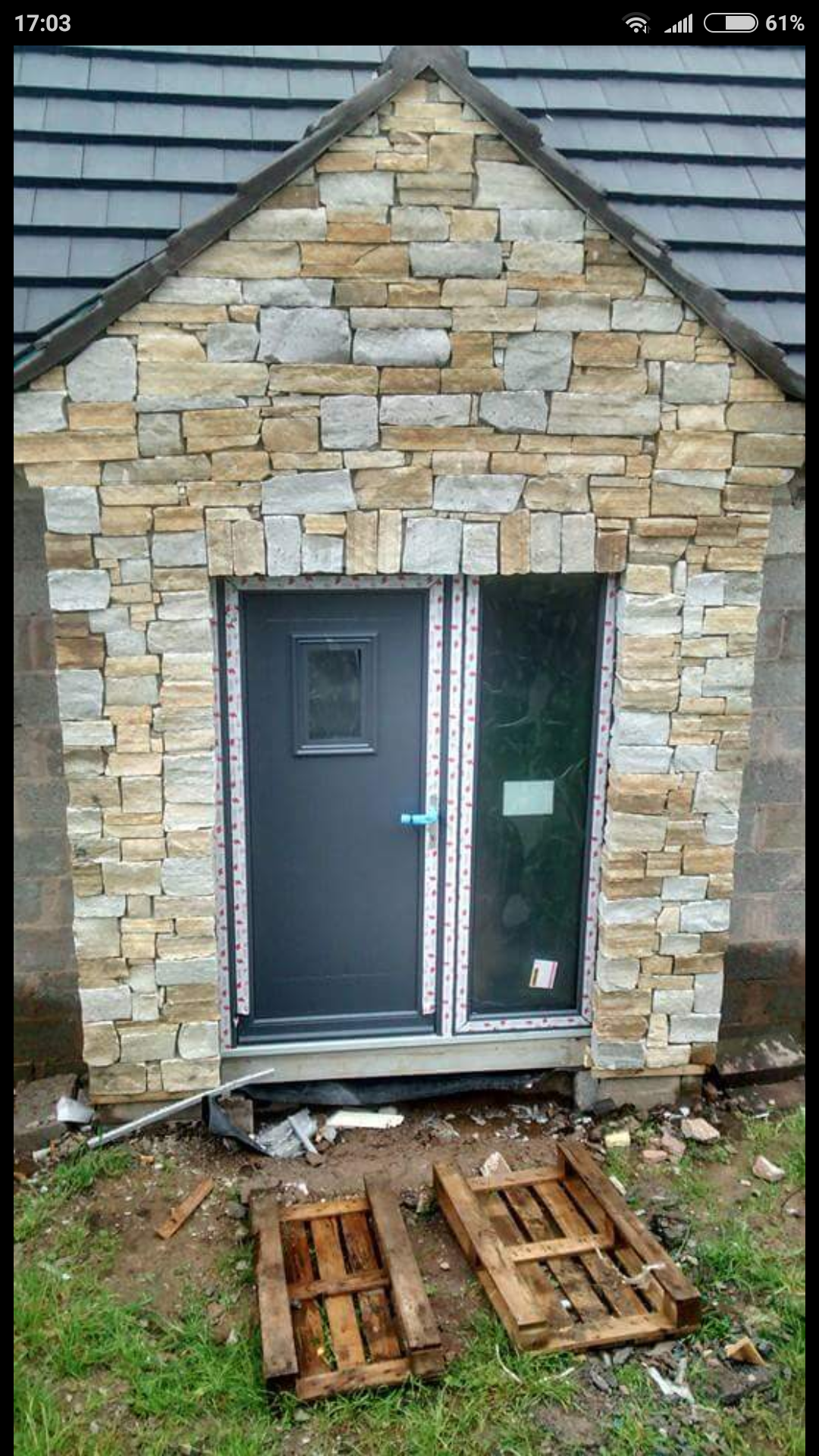

Alexphd1 Posted October 3, 2018 Posted October 3, 2018 We are using a 140mm and 40mm deep sandstone on a mix of concrete blocks and nudara ICF. I dont see a problem with doing around windows etc .

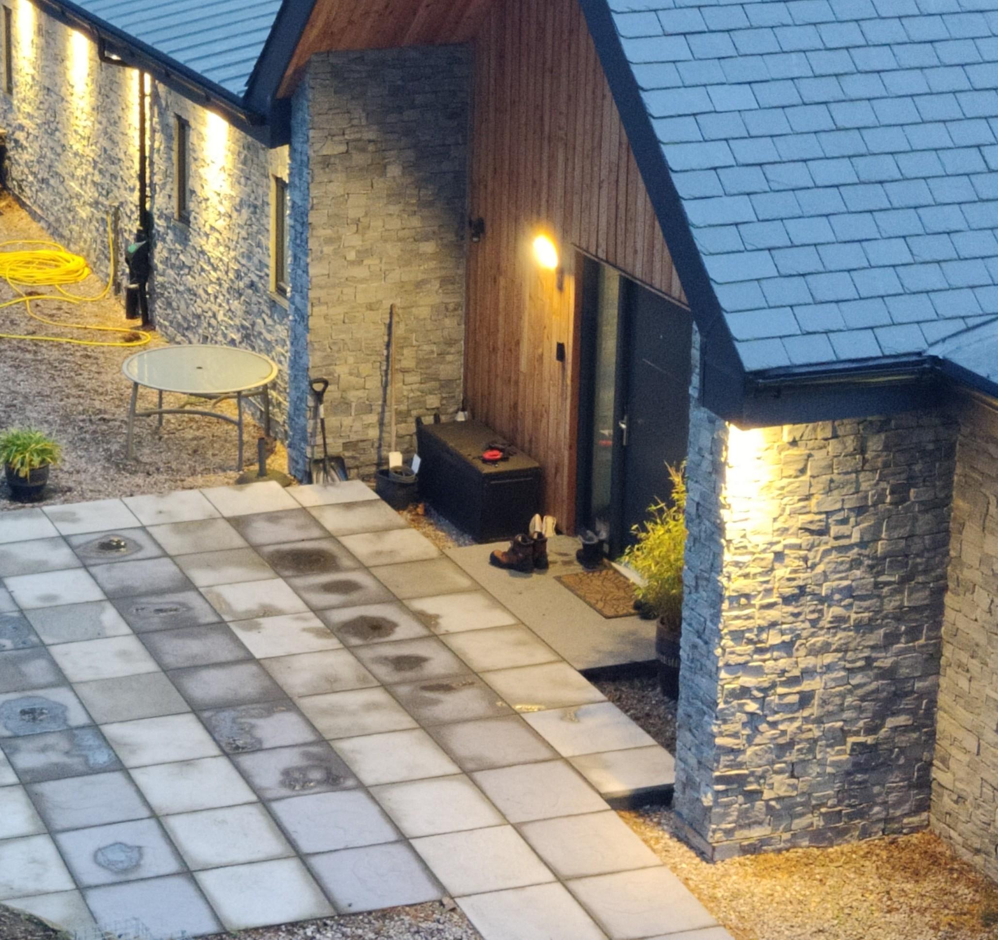

JohnMo Posted February 28, 2024 Posted February 28, 2024 Woodcrete ICF, used exterior quality tile cement and real stone slips direct to the ICF. Photos were taken a couple of years apart. 3

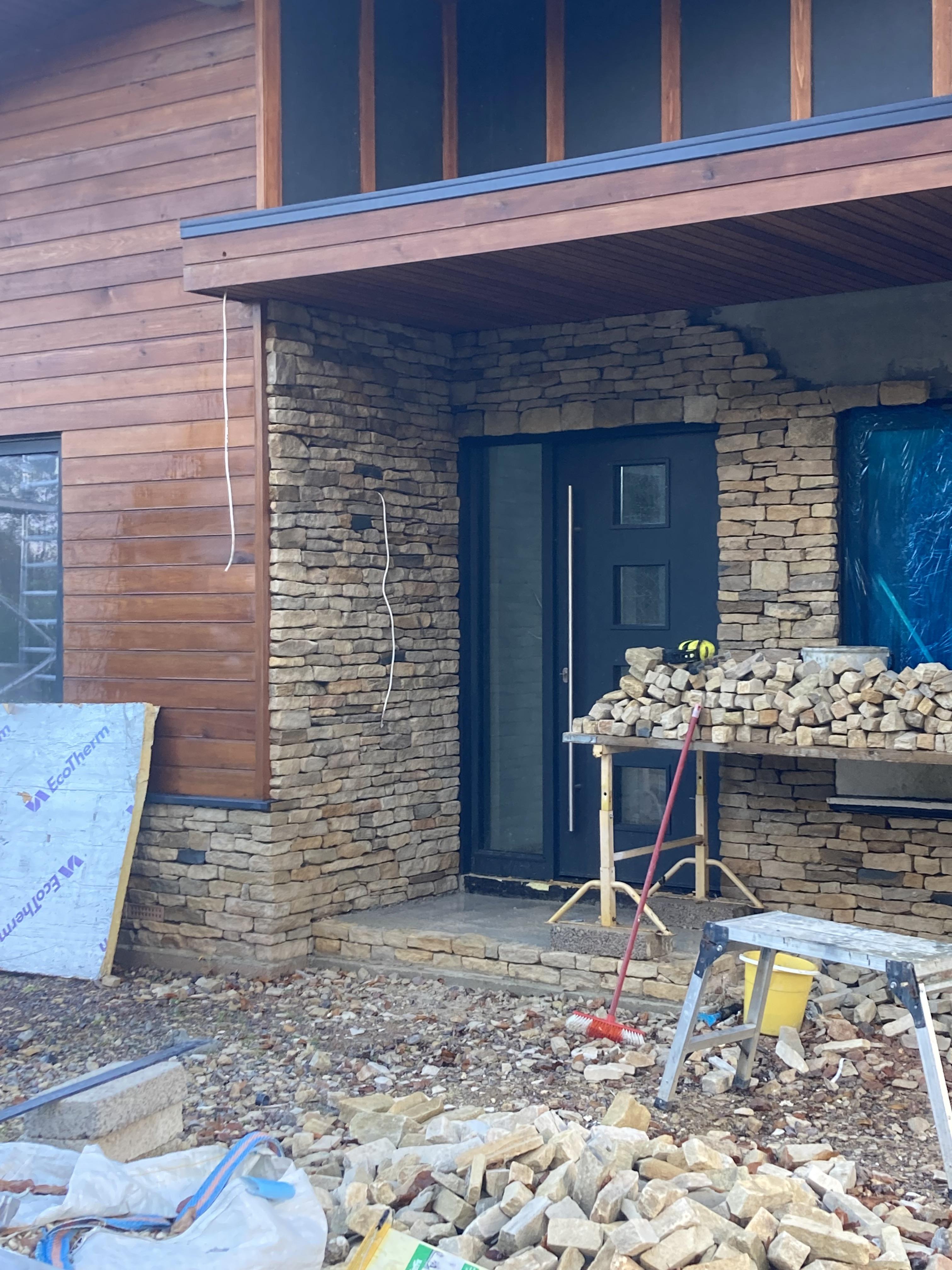

Russell griffiths Posted February 28, 2024 Posted February 28, 2024 im doing this, Cotswold stone cut down to form a stone slip. 3

WiltshireLink Posted February 29, 2024 Posted February 29, 2024 23 hours ago, Russell griffiths said: im doing this, Cotswold stone cut down to form a stone slip. Did you use a carrier board? How much stone have you had to cut!? How did you go about cutting it? Ta
Russell griffiths Posted March 1, 2024 Posted March 1, 2024 12 hours ago, WiltshireLink said: Did you use a carrier board? How much stone have you had to cut!? How did you go about cutting it? Ta No carrier board, waterproof render with mesh on the icf. exterior slip adhesive on the back of the stone onto the render, with stainless steel ties into the plastic webs. I cut the stone in half so only needed to buy half as much. if you can do this job yourself then all good, if you need to pay for it, it will be too expensive. you would need to go for one of the tile products. as labour will make the cost horrendous, I spent 5 days just cutting the stone down, clipper petrol brick saw. 1

JohnMo Posted March 5, 2024 Posted March 5, 2024 8 hours ago, ConorB said: Any idea how thick that stone was or what weight it had per m2? About 40 to 50mm thick, weight no idea per m2 1
