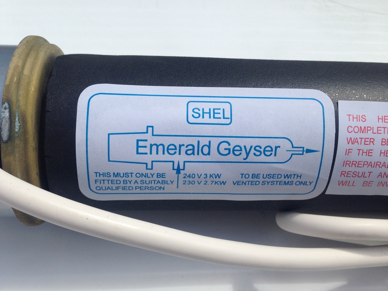

Siiimon Posted September 24, 2018 Posted September 24, 2018 At the suggestion of Alphonsox, I've been reading the descriptions of UFH systems heated by a willis heater. I'm seriously considering using one in our barn conversion in place of the intended wood burner. However, willis heaters appear to be only for vented systems and I'd rather have unvented for ease of install. How have people dealt with this?
ProDave Posted September 24, 2018 Posted September 24, 2018 Who says they are only for vented systems?
Siiimon Posted September 24, 2018 Author Posted September 24, 2018 Well that's what it says on the side of a popular make
Guest Alphonsox Posted September 24, 2018 Posted September 24, 2018 I don’t think this is an issue. This is effectively a pressure restriction from the Willis point of view. A vented DHW system will run with the pressure from the cold water tank in the loft - say 1.5 bar max. Your UFH is unlikely to be running at anything over 1bar.
PeterW Posted September 24, 2018 Posted September 24, 2018 It’s to do with getting a decent thermosyphon as a Willis in a tank situation uses the cold of the header tank and the rising water temperature in the feed to create the thermosyphon effect. In this instance it’s only on when the pump is on so doesn’t require the thermosyphon to work. The other factor is thermostat failure on the immersion so it could boil however most modern thermostats have a secondary non resettable fail stat at 80c.
