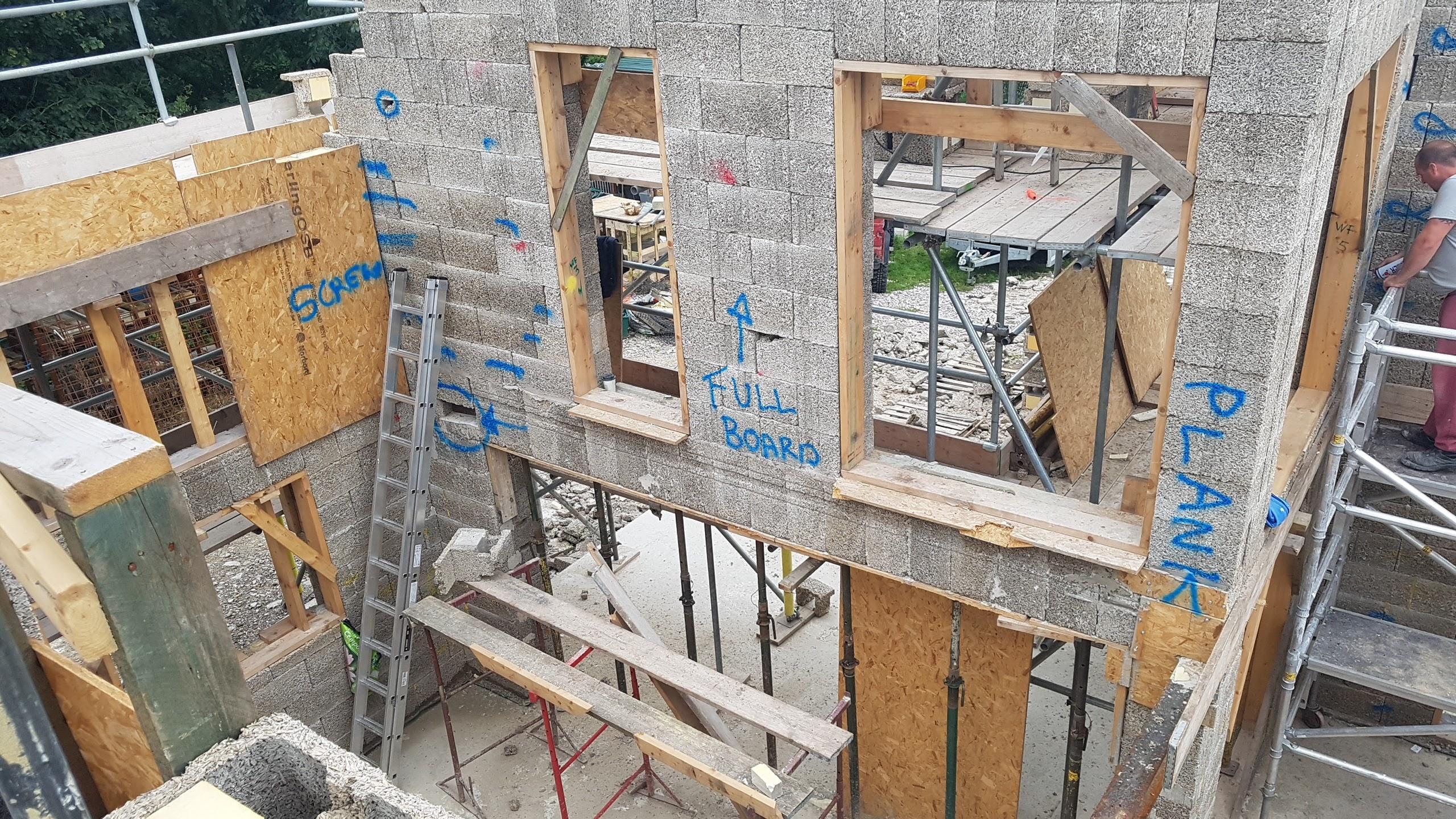

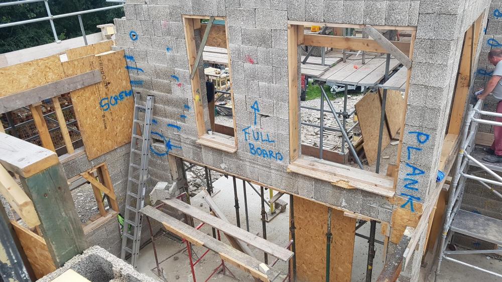

ToughButterCup Posted September 20, 2018 Posted September 20, 2018 53 minutes ago, Russell griffiths said: [...] im afraid the hire cost has scared the c##p out of me so I’m thinking of buying my own to sell on afterwards [...] You'll be aware of our little hiccup with a system that, ostensibly, didn't need bracing. And maybe Durisol doesn't - but it sure as Hell does if one of the people installing it has a criminal lack of care. Got the video. So, we had to make our own shuttering. Like this.... The photo shows the boarding on left ready for the second pour and the exposed wall just before being boarded (blue writing). We used 3 by 3 timbers and sheets of 22mm supported by through bolts - M12 , nuts, washers and bolts. Any scaffold planks we could scrounge were also pressed into service. Part of the issue to be considered will be the amount poured in any one session. We didn't pour more than 4 meters in one go. That is two sheets of OSB stacked vertically. In terms of cost, I have re-used almost all of the timber and sheeting, but not the threaded bar. Given lemons, we appear to have made some lemonade. By accident, not design
