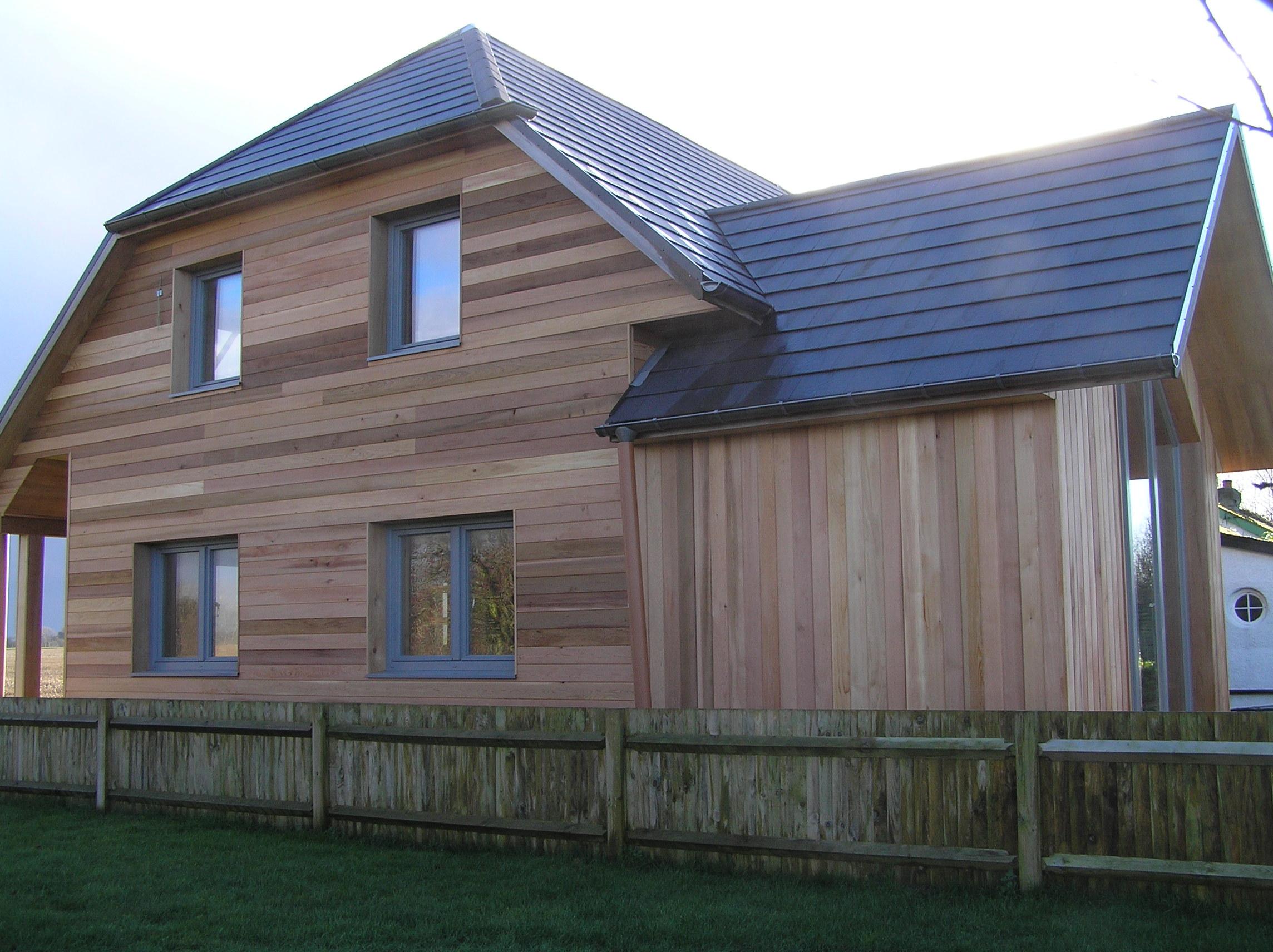

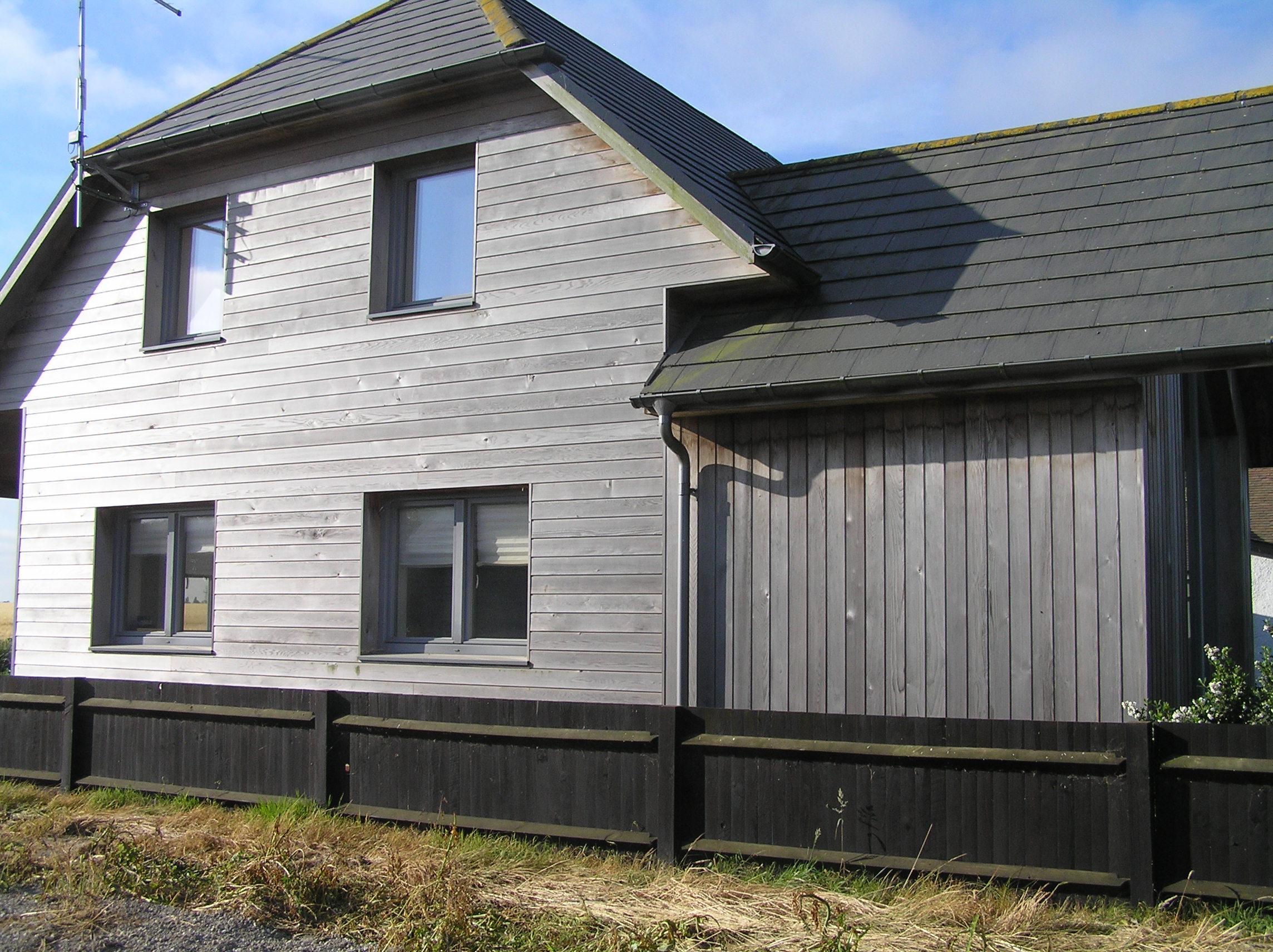

That's exactly our experience with our cedar cladding. Where the rain blows under the verandah there is a diagonal line of faded cladding below and original colour above. This is the north side before and after with about four years between.

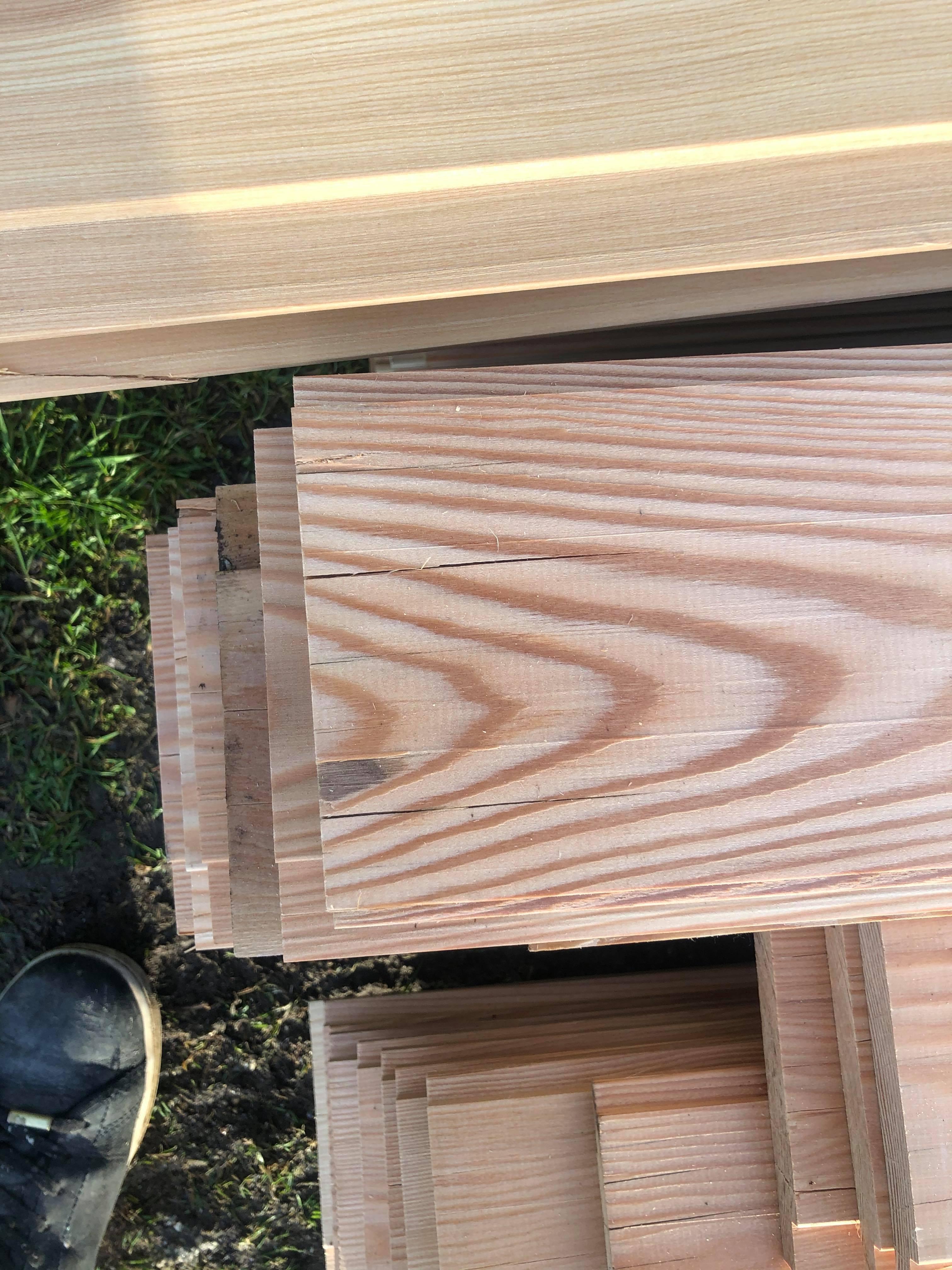

Is it normal to have some boards with split ends? I guess I just try and work around it and count it as wastage. This is an example in the middle of the photo - a couple more at the bottom of the photo.
