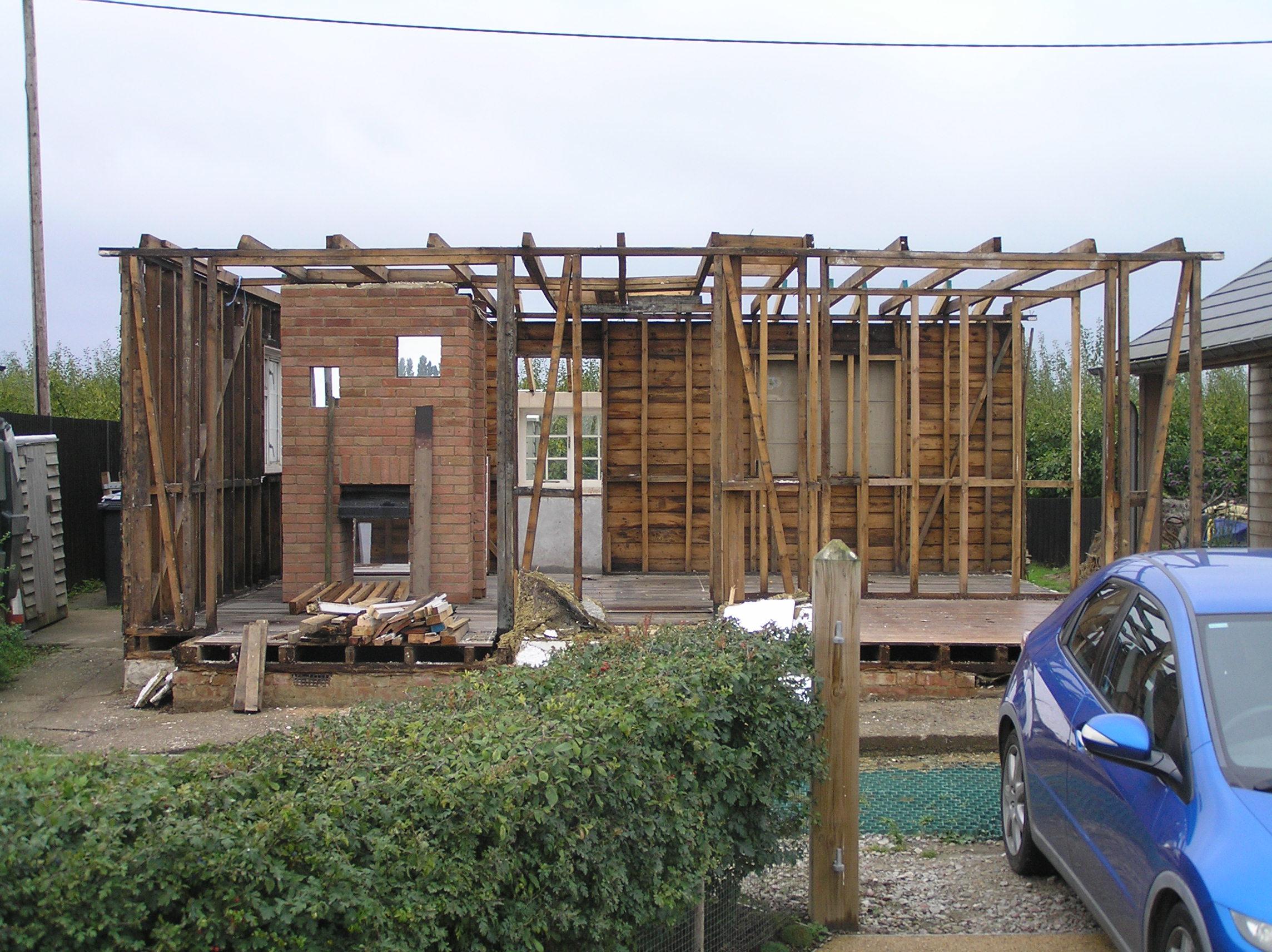

Gone West Posted September 6, 2018 Posted September 6, 2018 (edited) We're just coming to the end of the dismantling of our timber framed bungalow. It had a 30 degree roof so working on that was easy for removing slates and sarking boards. We were lucky that it was constructed largely of 4x2 and Freecycling that was easy. The old 1920s bricks from the chimney found a home via Freegle. So far the only cost has been for asbestos removal and electricity disconnection. We hope to crush the blockwork and concrete floor from the kitchen/bathroom extension and reuse it. You'll have no trouble. Edited September 6, 2018 by PeterStarck
