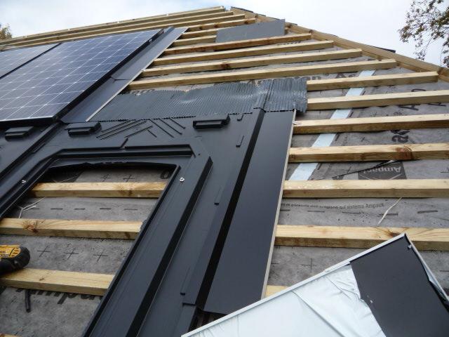

Jeremy Harris Posted August 28, 2018 Share Posted August 28, 2018 From memory, the parts needed, apart from the trays, are side flashings (pretty simple thin black anodised aluminium, bent to fit the side ridges on the trays and with a small upstand under the slates/tiles at the sides), top flashings, again, pretty simple aluminium flashing that goes under the slates, tiles at the top (and ends up hidden), and simple clamps that hold the panels down to the additional bits of timber batten that have to be laid where the fixing points are. TBH, it's not a very complex system and some of the special flashing can be replaced with ordinary non-lead flashing anyway (at the top and bottom, for example). The key parts needed are the trays, the panel clamps and EPDM gaskets, the wide-head screws (that also have EPDM washers) and the side flashings. The rest can be done using off the shelf stuff. You can probably substitute ordinary metal roofing screws and washers for the ones they use Link to comment Share on other sites More sharing options...

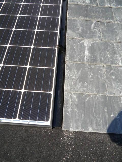

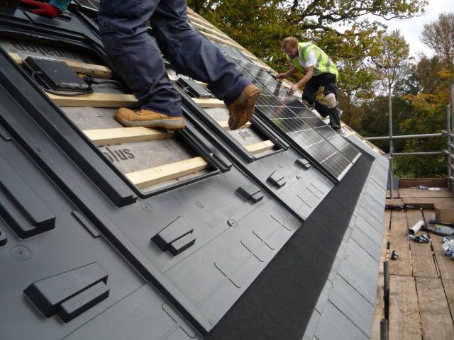

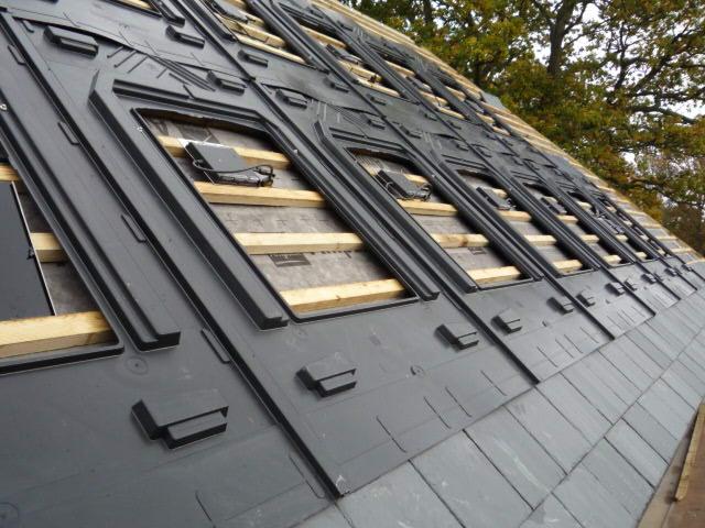

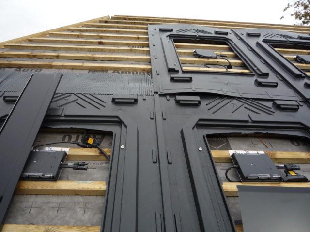

HerbJ Posted August 28, 2018 Share Posted August 28, 2018 17 minutes ago, JSHarris said: TBH, it's not a very complex system and some of the special flashing can be replaced with ordinary non-lead flashing anyway (at the top and bottom, for example). That's what my fitters used - see photos 1 Link to comment Share on other sites More sharing options...
Triassic Posted August 28, 2018 Share Posted August 28, 2018 What are the boxes in the bottom photo? I had assumed all the electronic stuff went inside the house? Link to comment Share on other sites More sharing options...
PeterW Posted August 28, 2018 Share Posted August 28, 2018 6 minutes ago, Triassic said: What are the boxes in the bottom photo? I had assumed all the electronic stuff went inside the house? Micro inverers or potentially panel optimisers. Link to comment Share on other sites More sharing options...
le-cerveau Posted August 28, 2018 Share Posted August 28, 2018 8 minutes ago, Triassic said: What are the boxes in the bottom photo? I had assumed all the electronic stuff went inside the house? Look like Enphase micro inverters M215/M250 1 Link to comment Share on other sites More sharing options...
HerbJ Posted August 28, 2018 Share Posted August 28, 2018 (edited) Those are the Enphase micro inverters - M250. One per panel. It wasn't possible to locate these inside the house. In any case, I think they need to be outside for ventilation/cooling and also the cable runs would have more complex than I would want. I think there is an ongoing thread on cable connection inside the roof space which discusses the pro/cons of this Edited August 28, 2018 by HerbJ added microinverter Ref No Link to comment Share on other sites More sharing options...

dpmiller Posted November 13, 2018 Share Posted November 13, 2018 planning Q for @JSHarris or anyone else with experience of the GSE system- what's the closest one can get to the verge- as we're using a Kytun- style strip, can the GSE tray go straight into that or does there have to be a side flashing (what's it's width, fitted?) or must there be (say) a slate and a half first? And is there really no other treatment required if you end the tray into the gutter at the eaves? Does it need to stop short to stop the water from cascading off the panel and past the gutter? Now that we've roof timbers in-situ and we know how wide the valleys are I'm trying to take a punt at how many panels we can cram in. I've tried Midsummer's online planner but I'm not sure how much side flashings can overlap valleys by etc... Link to comment Share on other sites More sharing options...
Jeremy Harris Posted November 13, 2018 Share Posted November 13, 2018 There has to be a side flashing, which is black aluminium as standard, like the Kytun dry verge (we used this, it's very good). At a guess, I'd say that the side flashing is around 150mm wide, with an overlap over the edge of the tray that may be around half of that. I think it should be possible to fit the GSE trays and flashing pretty close to the verge, or you might be able to get Kytun to add a lip on the inner edge to replicate that on the GSE side flashing. The only other things to sort out would be how to raise this custom dry verge up a bit so that it sits neatly over the edge of the GSE frames, and how to resolve any interface above or below with the roofing slates/tiles. Link to comment Share on other sites More sharing options...
dpmiller Posted November 14, 2018 Share Posted November 14, 2018 Thanks Jeremy. Our verge trim is a 50mm special for the chosen clay tile so there should be space there to sneak the edge of the GSE side flashing in too. Gets us pretty close to the edge without needing to faff too much. What about at valleys? We'll be using an upstand dry valley like your own, I presume the mounting plate could overlap the valley tray as long as the side flashing was trimmed back as necessary? Link to comment Share on other sites More sharing options...

Jeremy Harris Posted November 14, 2018 Share Posted November 14, 2018 1 hour ago, dpmiller said: What about at valleys? We'll be using an upstand dry valley like your own, I presume the mounting plate could overlap the valley tray as long as the side flashing was trimmed back as necessary? Should be OK, as there's a slight ridge in the valley mouldings to catch any rain or snow that gets blown under the slates/tiles and I can't see an obvious reason why just trimming the panel side flashing to fit shouldn't work, although it is really designed to go underneath slates/tiles, rather than over them. The only problem to solve would be how to secure the flashing neatly. With slates/tiles, they sit over the top of the flashing fixings, the same as for the Kytun dry verge, so they stay hidden. 1 Link to comment Share on other sites More sharing options...
