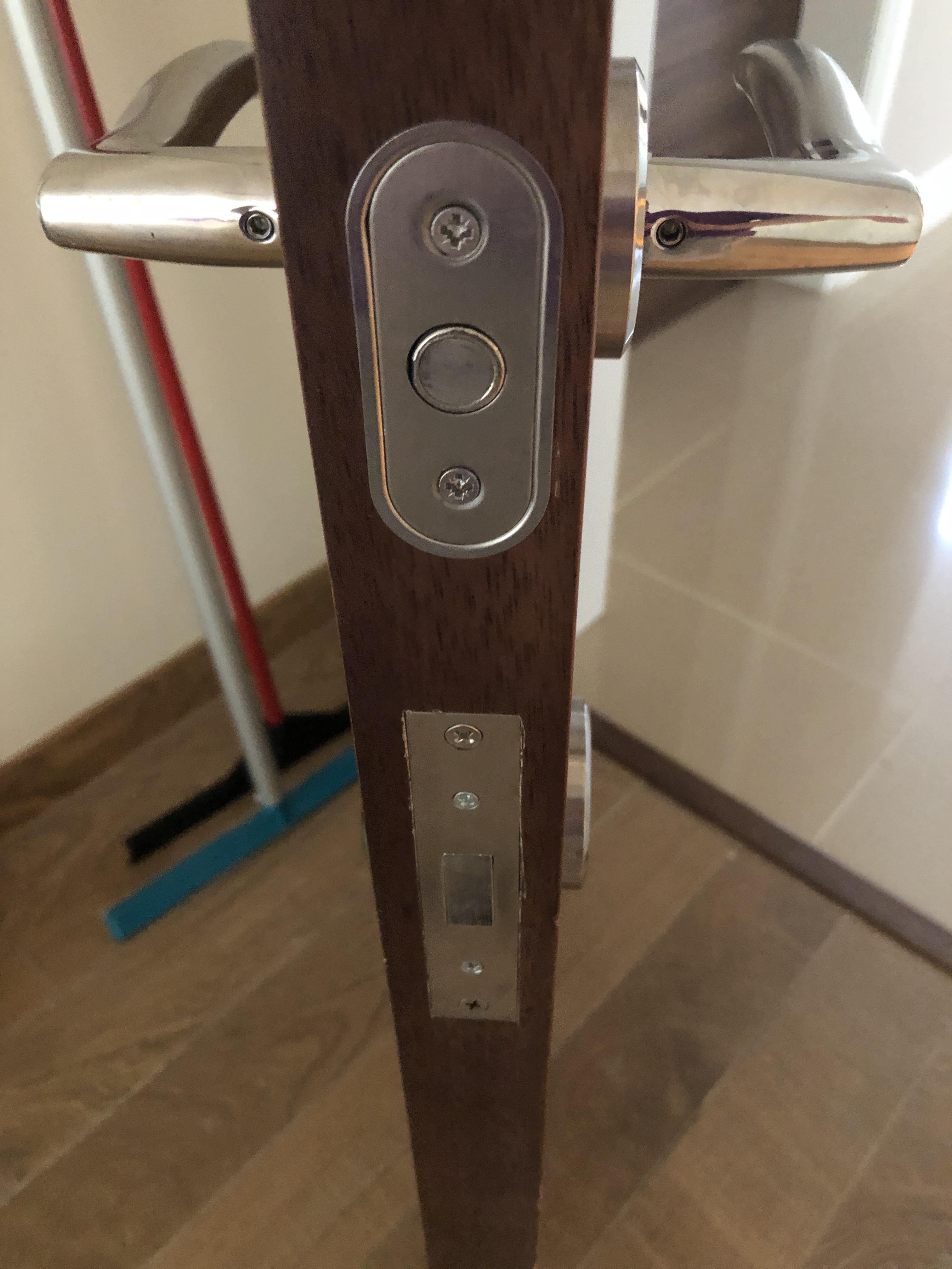

Onoff Posted November 14, 2020 Posted November 14, 2020 On 19/05/2020 at 20:13, AliG said: Is that top magnetic catch not dead central to the door?
AliG Posted November 14, 2020 Author Posted November 14, 2020 It is not, looking at a few of them, I think they have maybe set them back a bit so that the strike plate is not too near the edge of the frame.
Onoff Posted November 14, 2020 Posted November 14, 2020 28 minutes ago, AliG said: It is not, looking at a few of them, I think they have maybe set them back a bit so that the strike plate is not too near the edge of the frame. At least you've got "proper" doors! ? I had to get mine dead centre and dead square, these cheap doors are so thin.
