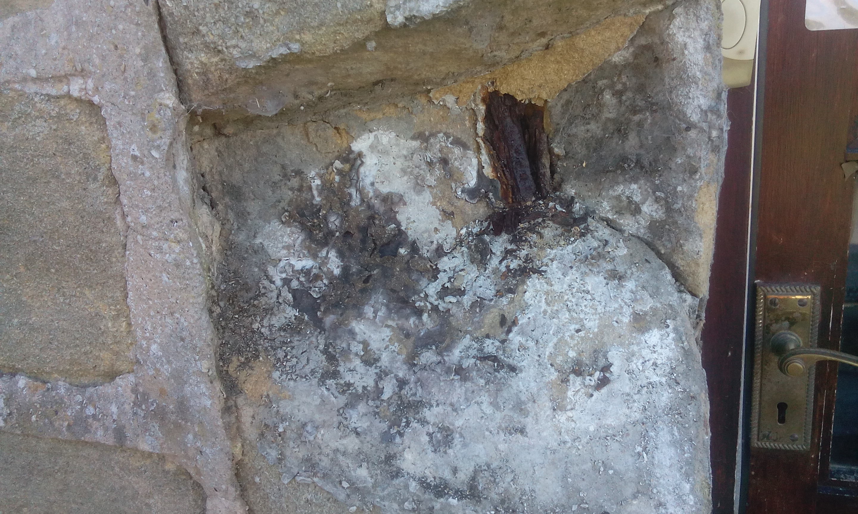

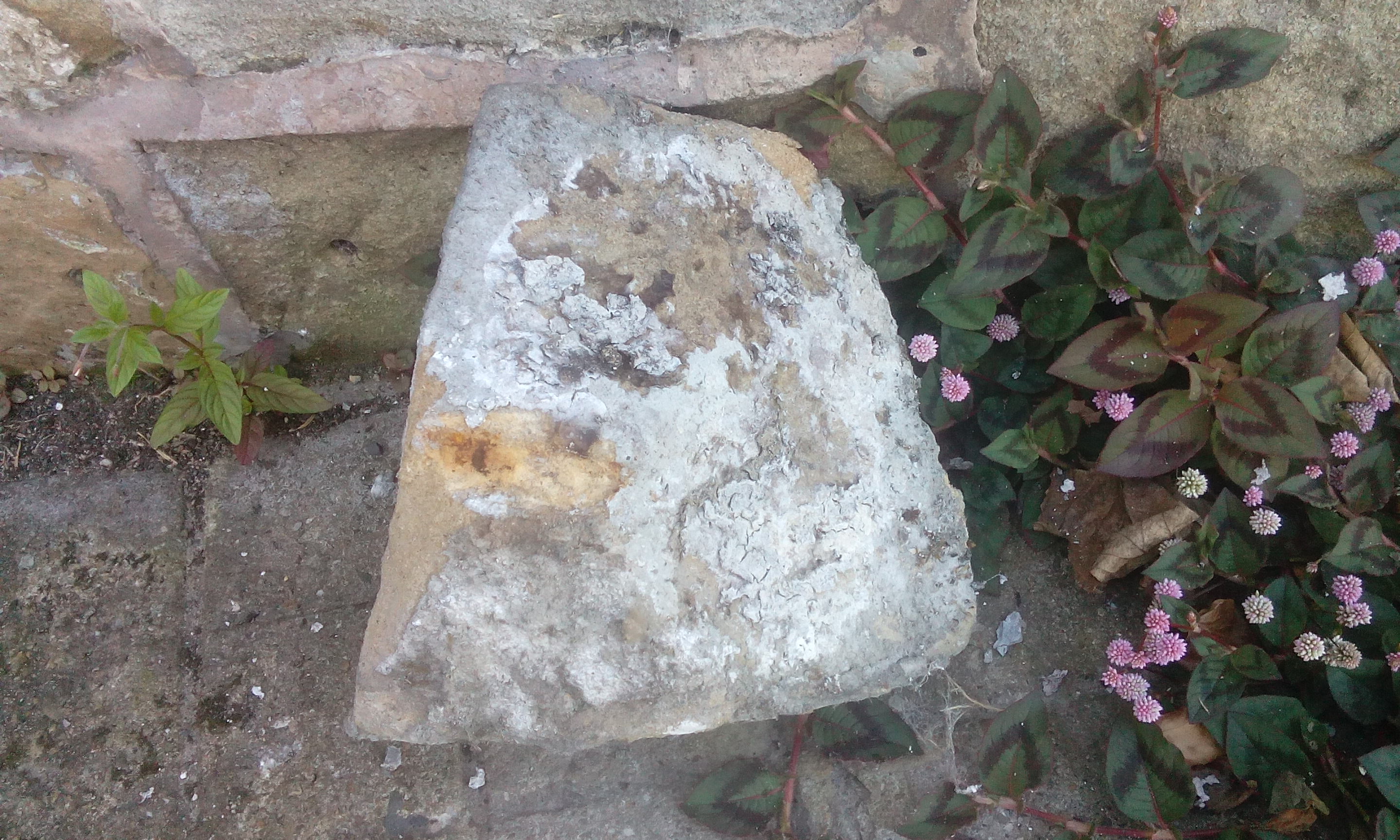

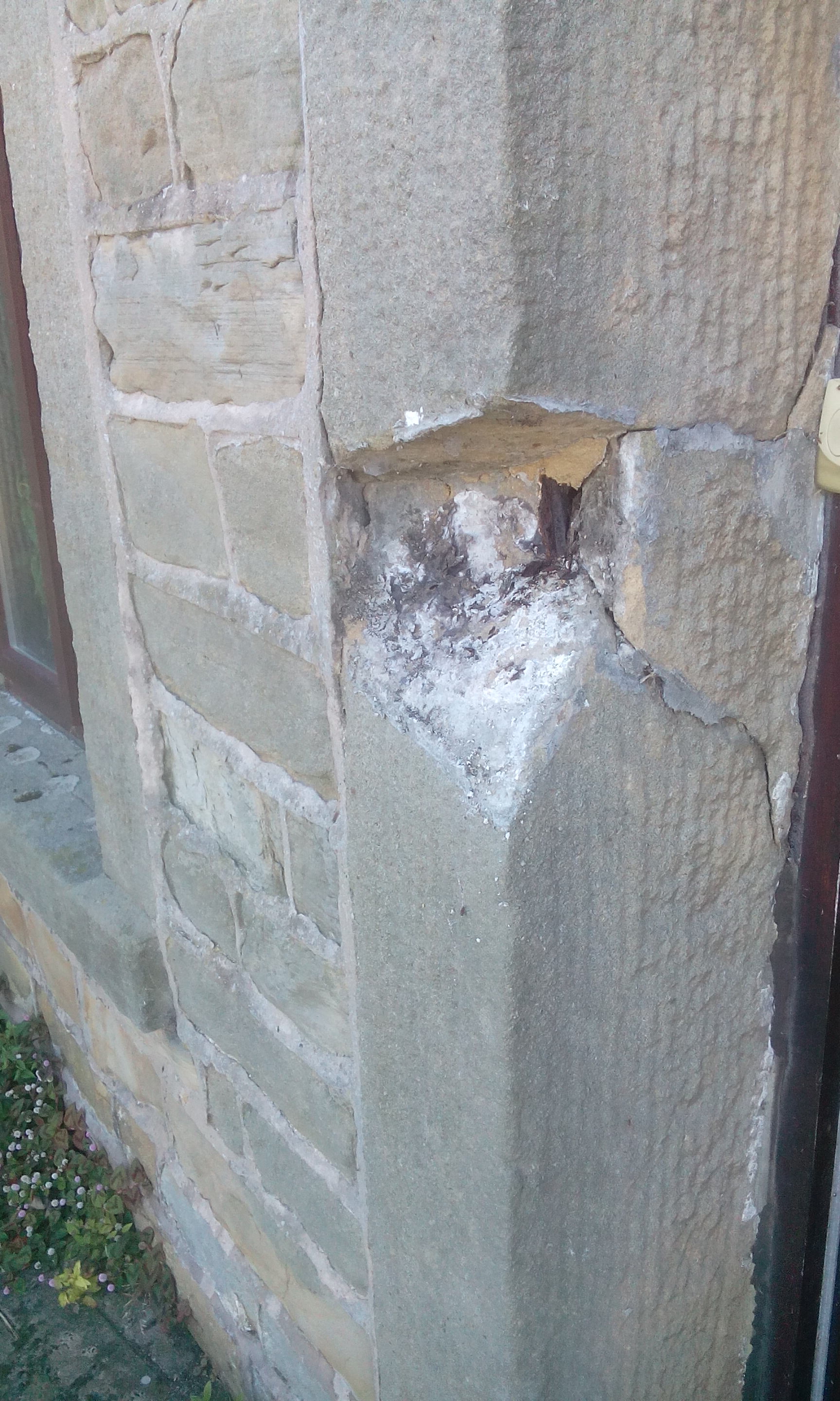

ToughButterCup Posted July 18, 2016 Share Posted July 18, 2016 This is what happened at lunchtime today. "Oh, woops" says I. And look down to see this next to his trainer-clad foot "Indeed" says he. "Woops just about covers it" And here's the detail That blackish smudge at the back is solid rust where it has been mended before. What's next (apart from buy a Lottery ticket : I could not have been luckier if I had tried to be. 2 mm from the Postie's foot ) Replace the lot? Make-do and mend? Or make-do and mend AND replace? And, as a minor by-the-by how the hell do I mend this well? Link to comment Share on other sites More sharing options...
Barney12 Posted July 18, 2016 Share Posted July 18, 2016 Assuming its natural stone there is really only one way. Stainless steel pins drilled and resin bonded. Link to comment Share on other sites More sharing options...

Barney12 Posted July 18, 2016 Share Posted July 18, 2016 (edited) Dragging it back to the problem...... you could do worse than: thoroughly clean both surfaces. grind some v shaped groves in both faces. bond it with a stone resin glue. Tenax is a good product and stands up fairly well. There are some better products but not so easily sourced. http://www.ebay.co.uk/itm/131323847075 Ideally though those stainless rods I mentioned earlier should be included to provide strength. if you want a more "traditional repair then once bonded. Very carefully v out the cracked join and fill with mortar. Edited July 19, 2016 by Barney12 eBay item was ended so have provided an alternative link. 1 Link to comment Share on other sites More sharing options...

ToughButterCup Posted July 19, 2016 Author Share Posted July 19, 2016 7 hours ago, Barney12 said: Dragging it back to the problem...... you could do worse than: thoroughly clean both surfaces. grind some v shaped groves in both faces. bond it with a stone resin glue. Tenax is a good product and stands up fairly well. There are some better products but not so easily sourced. https://www.ebay.co.uk/itm/131245094553 Ideally though those stainless rods I mentioned earlier should be included to provide strength. if you want a more "traditional repair then once bonded. Very carefully v out the cracked join and fill with mortar. Want to know why I love this forum? Link to comment Share on other sites More sharing options...
