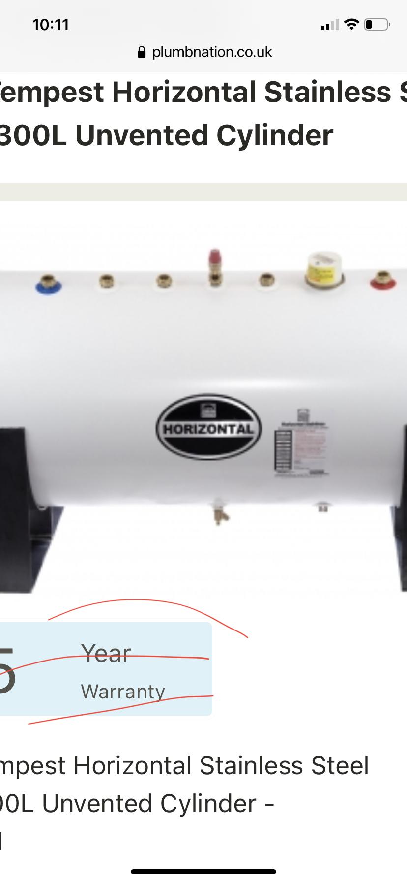

Adsibob Posted April 27, 2021 Share Posted April 27, 2021 On 15/07/2018 at 21:29, Nickfromwales said: Get the boiler and the cylinder up the attic The only person to see that ever again is your service agent. Earn some brownie points with the extra storage of not having the plant in valuable living space. @Nickfromwales looks impressive, but didn’t you need to leave more space above the cylinder for removing/servicing the heating element? I’m looking at a horizontal Telford Tempest which requires 11 inches clearance above it for that purpose. Link to comment Share on other sites More sharing options...
Nickfromwales Posted April 27, 2021 Share Posted April 27, 2021 (edited) 1 hour ago, Adsibob said: I’m looking at a horizontal Telford Tempest which requires 11 inches clearance above it for that purpose. Not for that one as the immersions are both left snd right hand loaded. They slide out horizontally which is in-keeping with the whole idea of a cylinder being installed in a reduced height compartment! I’ve not seen one with a top loaded immersion as that’s probably the worst possible place for it, what with heat rising etc. Do you have a link to the one you refer to? Edited April 27, 2021 by Nickfromwales Link to comment Share on other sites More sharing options...
Nickfromwales Posted April 27, 2021 Share Posted April 27, 2021 (edited) Well, shut my mouth Why on earth have they done that ?!? ?♂️ Email Trevor@cyliners2go and ask if they can relocate the immersion perhaps? Bespoke cylinders aren’t an issue with him usually. Edited April 27, 2021 by Nickfromwales Link to comment Share on other sites More sharing options...
Adsibob Posted April 27, 2021 Share Posted April 27, 2021 1 hour ago, Nickfromwales said: Well, shut my mouth Why on earth have they done that ?!? ?♂️ Email Trevor@cyliners2go and ask if they can relocate the immersion perhaps? Bespoke cylinders aren’t an issue with him usually. Thanks @Nickfromwales. I can only guess that the reason they've put them on top is that that way the immersion heater can be removed for servicing/replacement without having to drain the cylinder. Is it a pain to drain the cylinder when you service one like the one you've photographed? What does the annual service actually involve? Link to comment Share on other sites More sharing options...
