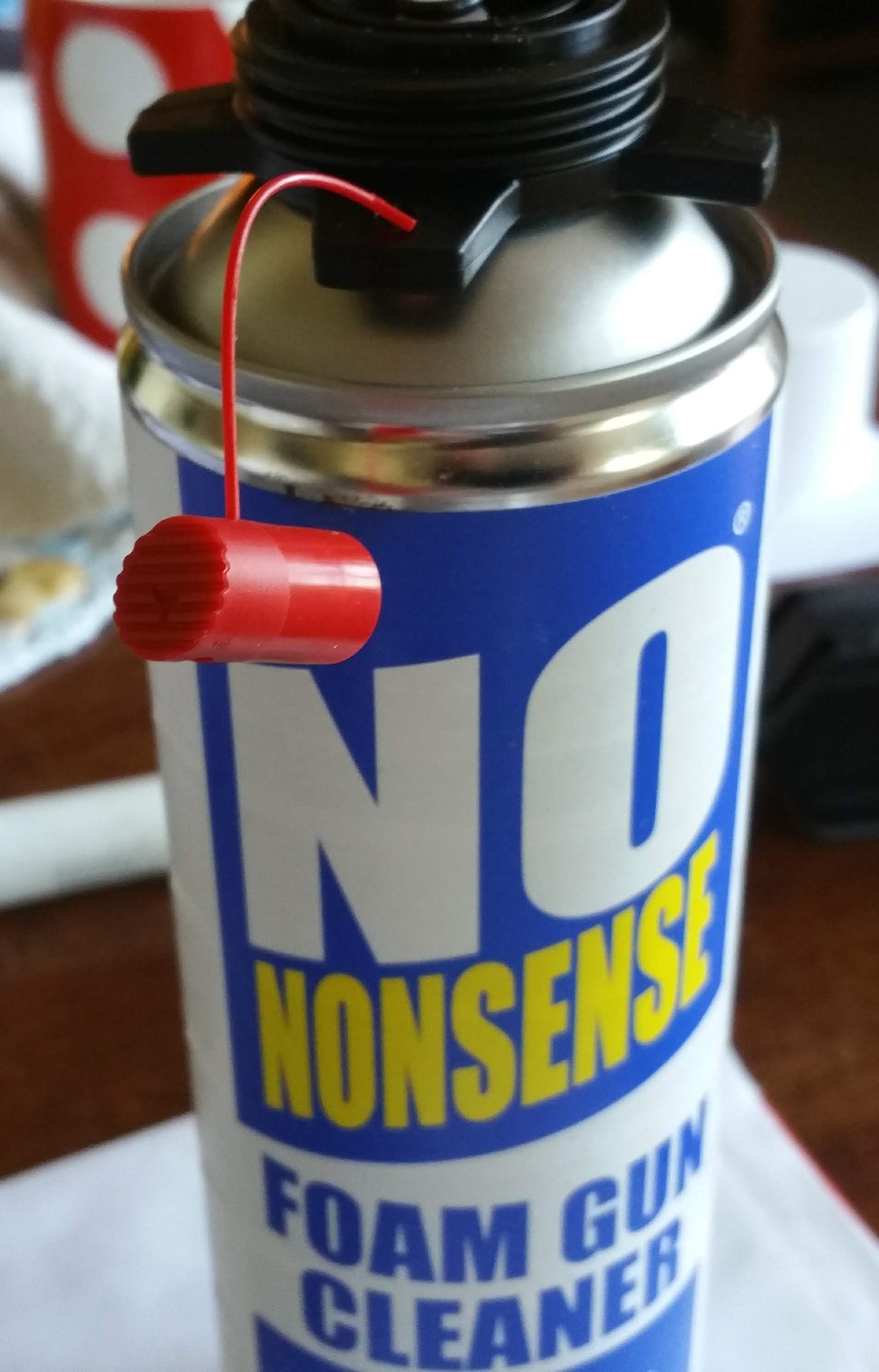

ToughButterCup Posted July 11, 2018 Posted July 11, 2018 You'll know of my adventures with foam. ? And so you can imagine how careful I now am about using the stuff. Got more foam gun cleaner cans than cans of foam. Imagine then how I feel when the little spray attachment is as detachable as Trump's wig. It threatens to fall off as soon as you look at it. And when three fall off when on the top of the scaffolding to disappear into the maw of the mess that accumulates under the scaffolding. The little lanyard is about as thick as Donald Trump's skin : the spray attachment falls off at the slightest excuse. Who has solved this annoying little issue?
Onoff Posted July 11, 2018 Posted July 11, 2018 (edited) Drop of mastic on it. Oh, and save them off of the empty cans! Edited July 11, 2018 by Onoff

ToughButterCup Posted July 11, 2018 Author Posted July 11, 2018 Well, I see you lot do not in fact have an answer to the question of what to do if you lose the little red widget at the end of the can...... So, I've had a brainwave. Yes indeed. But another gun and leave it permanently attached to the pressurised can of cleaning fluid. That way I always have the wherewithal to clean out my other dirty gun screw couplings! Simples! ( as NFW would say)

Onoff Posted July 11, 2018 Posted July 11, 2018 (edited) 8 hours ago, recoveringacademic said: Well, I see you lot do not in fact have an answer to the question of what to do if you lose the little red widget at the end of the can...... So, I've had a brainwave. Yes indeed. But another gun and leave it permanently attached to the pressurised can of cleaning fluid. That way I always have the wherewithal to clean out my other dirty gun screw couplings! Simples! ( as NFW would say) That's what I do sort of but without the extra gun, have two cans of cleaner on the go. Especially handy when changing cans. Use the one with the red widget on to blast around where the new can screws on and the one without the widget to screw on and blast thru the gun if cleaning out. Edited July 11, 2018 by Onoff

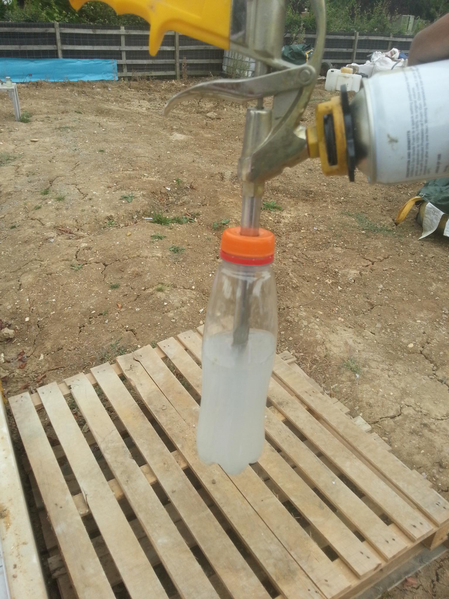

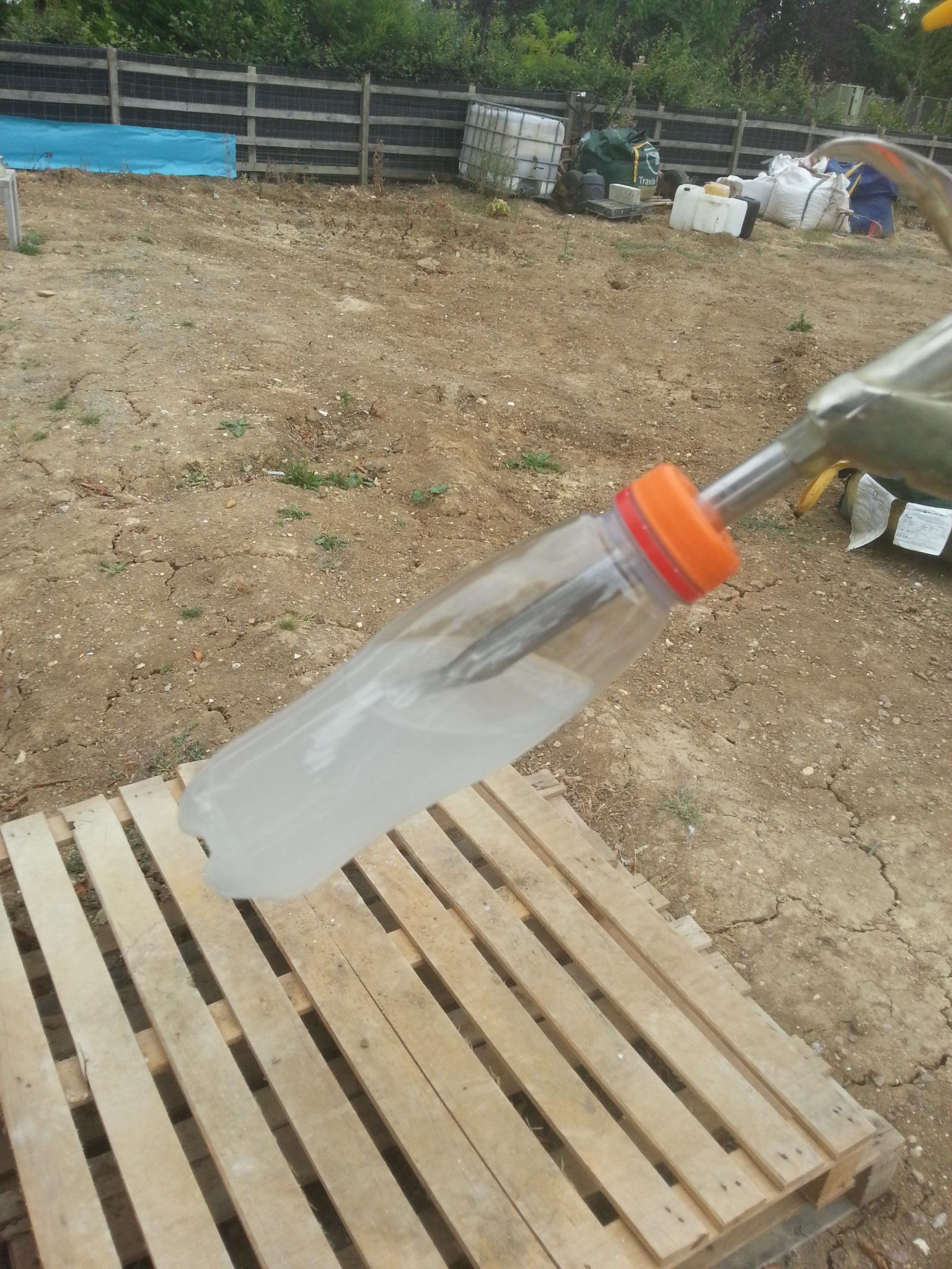

Vijay Posted July 17, 2018 Posted July 17, 2018 Just thought I'd post up a simple idea I had and works really well to keep the gun nozzle clean. Simply drill a hole slightly smaller than the gun neck in a small clear bottle (I used a Lucozade one) and half fill with acetone. When you've finished with your gun, simple push the neck though the hole into the bottle of acetone 1

SteamyTea Posted July 19, 2018 Posted July 19, 2018 4 hours ago, recoveringacademic said: foam that dries in the threaded part Never heard of that problem, it has never happened on an PU moulding machines I have ever used. If only the industry knew of a cheap, non flammable, low environmental damaging liquid that could sort it our if it ever happened.
Jeremy Harris Posted July 19, 2018 Posted July 19, 2018 Not happened to me, either. I left one of my guns for several months with a part used can of foam on and all it needed to get it going again was the end of the nozzle cleaning. As long as the pin valve at the nozzle is working OK and not leaking, the liquid inside the gun itself should just stay liquid.
PeterW Posted July 19, 2018 Posted July 19, 2018 8 hours ago, recoveringacademic said: I’d patent that if I were you. Now the only problem that needs to be solved is the foam that dries in the threaded part ; especially where the can nozzle mates with the gun. Spray the thread and the top of the can when you change cans and get all the foam off before you put a new can on and that doesn’t happen ...
