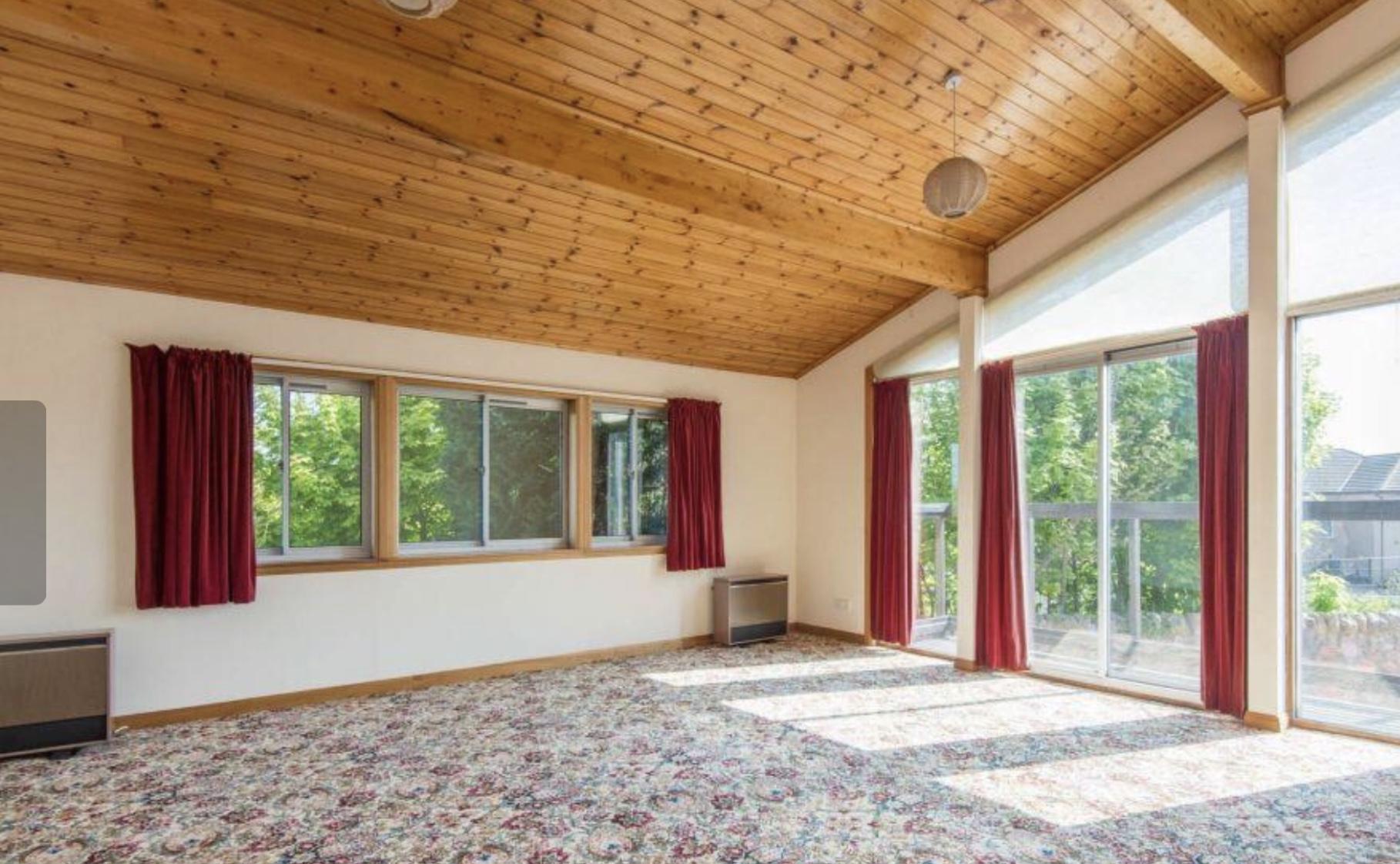

newhome Posted July 13, 2018 Posted July 13, 2018 Still doesn’t have my house or the new build next door. The other side has a score of 34 (listed cottage) and the strange Swiss chalet looking house at the farm behind has a score of 21 ?

PeterW Posted July 13, 2018 Posted July 13, 2018 1 hour ago, newhome said: the strange Swiss chalet looking house at the farm behind has a score of 21 That can’t be right as it wouldn’t meet building regs and it’s brand new !!

newhome Posted July 13, 2018 Posted July 13, 2018 1 hour ago, PeterW said: That can’t be right as it wouldn’t meet building regs and it’s brand new !! Nope it’s about 70s / 80s looking at the decor.
PeterW Posted July 13, 2018 Posted July 13, 2018 3 minutes ago, newhome said: Nope it’s about 70s / 80s looking at the decor. Thought you meant that new one ..!!
newhome Posted July 13, 2018 Posted July 13, 2018 Just now, PeterW said: Thought you meant that new one ..!! No, the one across the back where the farm is. LPG and storage heaters is the only heating in that. The new one next door doesn't have an EPC either. They have an oil boiler and radiators.
