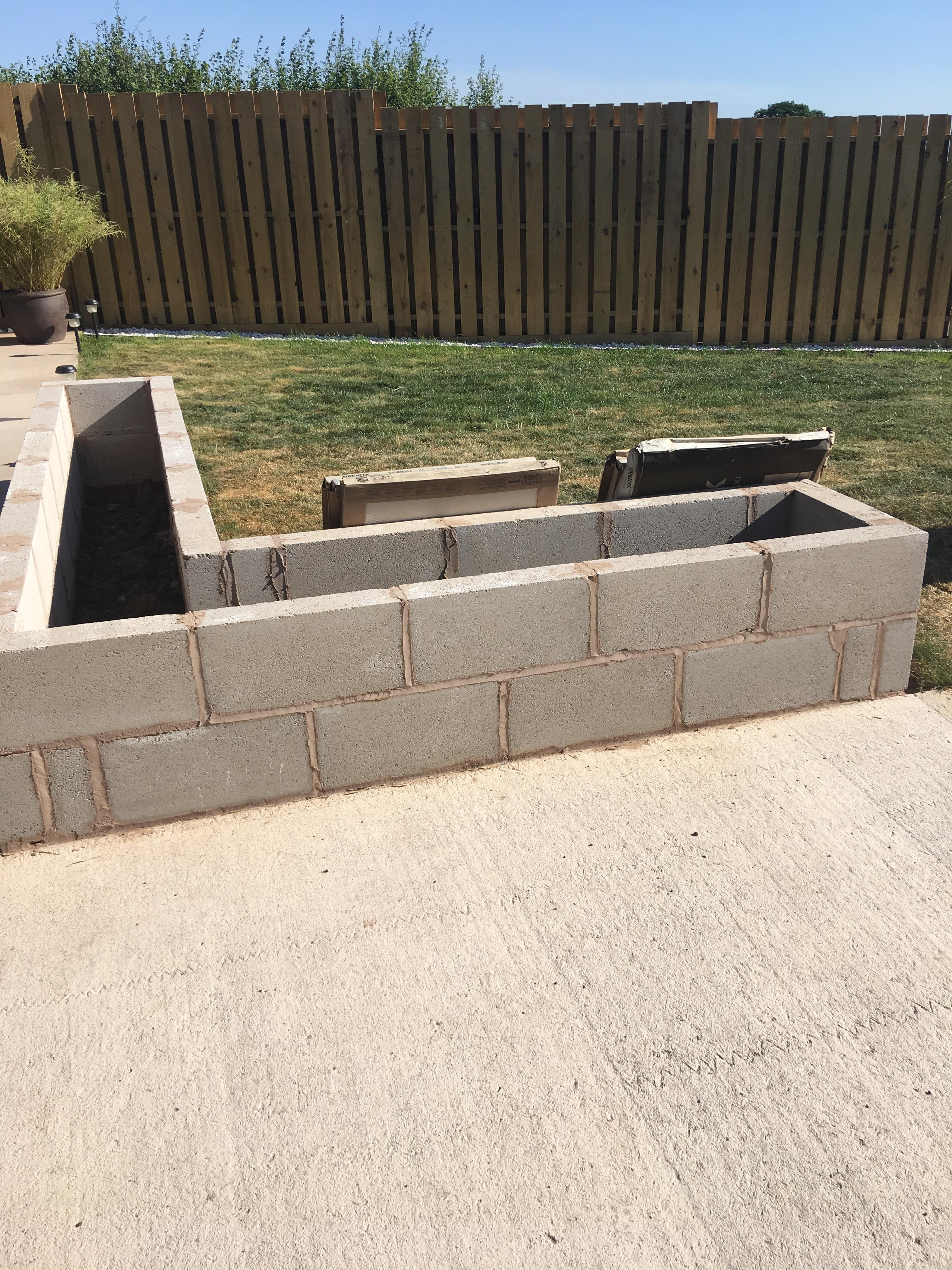

lizzie Posted July 6, 2018 Posted July 6, 2018 I have had some planters built in block and am going to have them rendered (sand and cement) and then paint them with Masonry paint I think I should do some sort of waterproofing inside? Any suggestions for an easy to use non toxic substance, I will be doing it myself.
Ian Posted July 6, 2018 Posted July 6, 2018 what about some cheap pond liner. It would probably need some holes along the bottom unless you're planning on growing bog plants. 1
lizzie Posted July 6, 2018 Author Posted July 6, 2018 Thats a good idea @Ian everything I have seen on line is toxic tar paint (blackjack type stuff). I really only need to line the sides the bottom is open to the ground and its the blocks I want to give some protection too..................no bog plants its hot as hades out there south facing. Lavender or some other dry hot tolerant plant.

Tennentslager Posted July 6, 2018 Posted July 6, 2018 There should be some visqueen scraps kicking around which would do the job. Visqueen is thick plastic damp proofing seen everywhere on a build ?
Russell griffiths Posted July 6, 2018 Posted July 6, 2018 You need to do this job really well with a liquid type dpm not plastic sheet as you will never join it neatly enough to be effective my friend had exactly the same built and lined them badly, he has regretted it ever since, the render has started to spall the paint blisters it is a total mess the damp is trying to travel from the inside and escape through the very porous blocks. Have you tried a product called synthaprufe.

Jeremy Harris Posted July 6, 2018 Posted July 6, 2018 I lined the large planter that I've put some trees in with heavy duty DPM. It seems to work pretty well. I left it open at the bottom, with plenty of drainage. 1
Stones Posted July 6, 2018 Posted July 6, 2018 I've just built a couple of timber planters. I lined one with some EPDM roofing membrane (pond liner in effect) and the other with DPM I retrieved from the skip when the house was being built, large drainage holes at the bottom. Both perfectly good for lining.

canalsiderenovation Posted June 15, 2023 Posted June 15, 2023 @lizzie what did you use? We are having ours rendered and we contacted the Ecorend as we didn't really want silicone render but they do a monocouche render to match the house. We asked the render company for advice and they said; Planters are notoriously difficult. We would advise that these are tanked from behind with a waterproof membrane. This should reduce the moisture coming through from the soil/plats etc when they are back filled. I would also advise a coat of W2 Waterproof bonding coat to the front surface that is being rendered this again will help with any moisture from the back. Then apply a basecoat and leave with a keyed finish to receive the required topcoat of either Monocouche or SR15. What waterproof membrane did you use? Anyone else got any other suggestions? Like @lizzie our planters are open to the ground below so we are planning on some gravel for drainage in the bottom of the planters.
