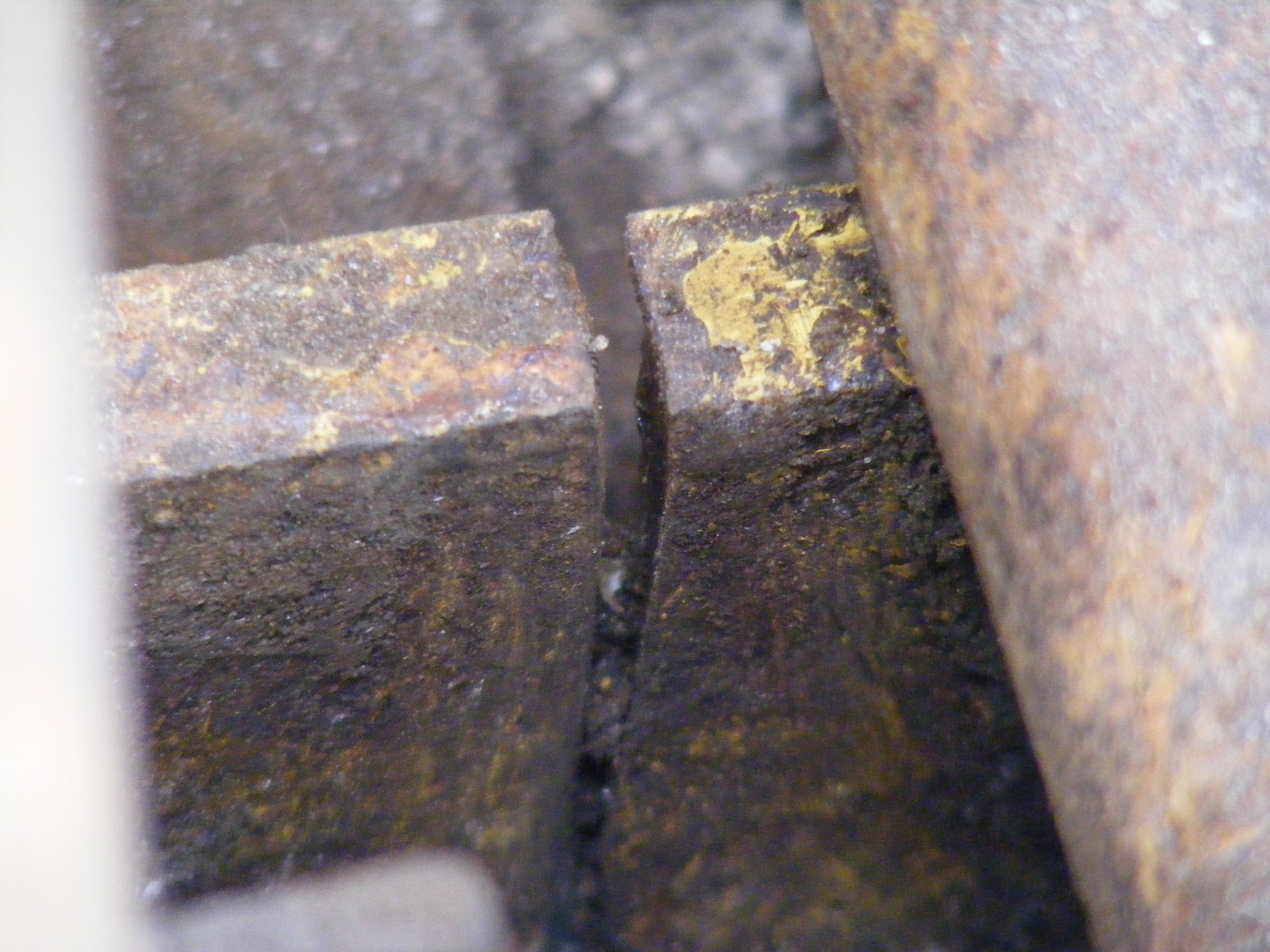

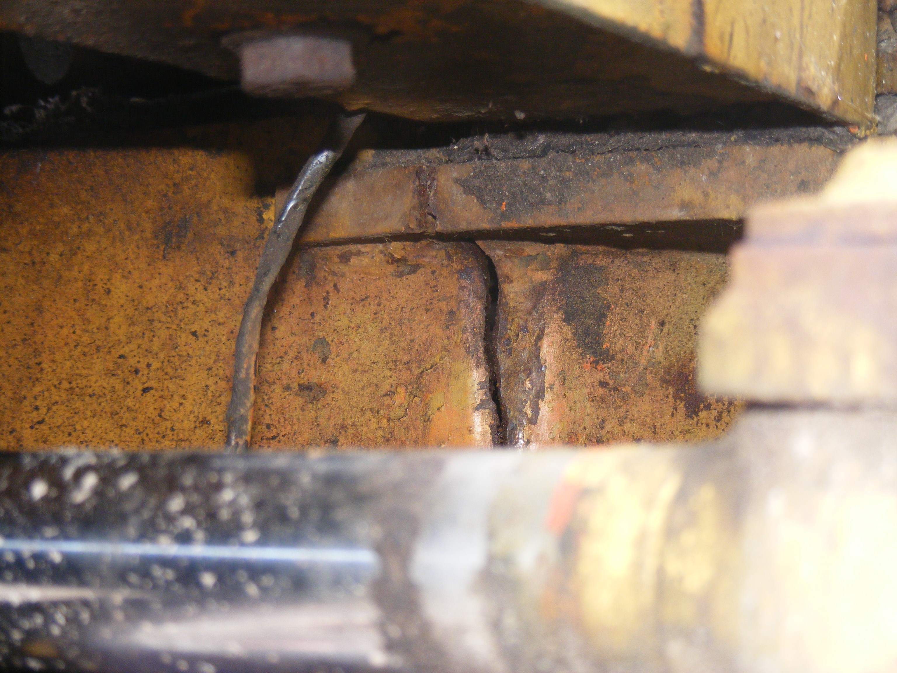

ProDave Posted July 13, 2016 Author Posted July 13, 2016 So here's the damage. First the crack that I can see from underneath. I think by removing the tank I will be able to get at that one from above. It's to far over to be accessed by removing the floor plate. But I did remove the floor plate and here I found crack no 2 My guess is one of these has been cracked for some time and the other has only recently opened up. I can close both gaps to where they should be by pushing down on the bucket. The plan is to weld crack 2 from above with the tank still in place. This is much further from the tank but I will still dothe wet towel thing. I hope that will then be enough to hold both cracks closed while I drain and remove the tank to weld crack 1.
PeterW Posted July 13, 2016 Posted July 13, 2016 That second one looks very clean ..??? are you planning on welding it up and plating over for additional strength ..?? 1
Nickfromwales Posted July 13, 2016 Posted July 13, 2016 51 minutes ago, PeterW said: That second one looks very clean ..??? are you planning on welding it up and plating over for additional strength ..?? It doesn't look like you'll get much filler material into the crack tbh, so I'd say plate as well. Looks like a major stress point too.
Jeremy Harris Posted July 13, 2016 Posted July 13, 2016 2 hours ago, ProDave said: So here's the damage. First the crack that I can see from underneath. I think by removing the tank I will be able to get at that one from above. It's to far over to be accessed by removing the floor plate. But I did remove the floor plate and here I found crack no 2 My guess is one of these has been cracked for some time and the other has only recently opened up. I can close both gaps to where they should be by pushing down on the bucket. The plan is to weld crack 2 from above with the tank still in place. This is much further from the tank but I will still dothe wet towel thing. I hope that will then be enough to hold both cracks closed while I drain and remove the tank to weld crack 1. Definitely looks like a very old crack. When welding, don't empty the fuel tank, fill it right to the brim. Diesel liquid doesn't burn, only diesel vapour is flammable, and then only when there is lots of oxygen around, so if the tank id full of diesel it's effectively inert and safe; any fire can only start outside the tank if the vapour concentration is high enough (which needs the diesel to be hot) and if there is enough air around.. I've welded near petrol tanks on old cars (Mini van and traveller rear subframe repairs!) many times, and the key was to fill the tank up to the brim, poke the TIG nozzle down the filler and just squirt in argon (with the power off, it displaces any air left in there) put a cold, wet towel over the filler cap (to cool any vapour that may escape down below flash point) and then weld in short sections, with wet rags to cool off hot bits and stop the heat spreading. In your case I'd just fill the tank with diesel, put the cap on, put a wet towel over it and have a hose nearby so to can cool things down after a few minutes welding. As above, it would be best plated on the top and bottom if you can (not the sides, there's very little stress in the web - the main loads are taken top and bottom). It'll need a lot of grinding out, and I'd make a nice big vee down the break with the grinder and run several beads in there to fill it, concentrating on getting the best weld top and bottom, where the stress is, so probably best to start in the centre and work towards the top and bottom, so any inclusions are more likely to be in the near-zero stress region in the middle.
