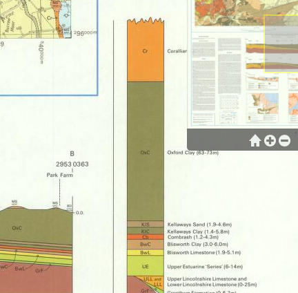

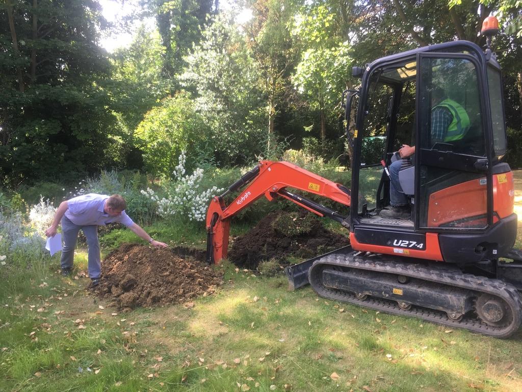

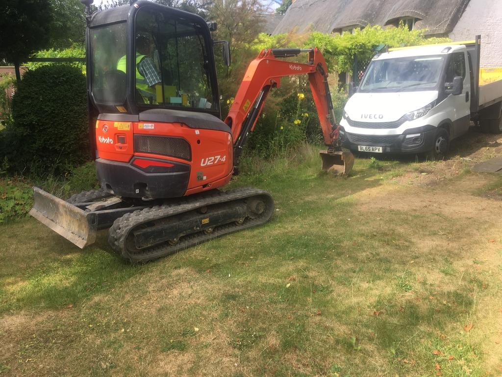

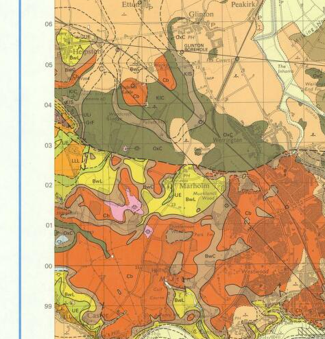

Cambs Posted June 29, 2018 Posted June 29, 2018 Following on from @newhome's post earlier, here's another good news story.... We had our soil survey done today, so it finally feels like we are getting started after two years of buying the plot and getting planning permission for our plot which sits in the curtilage of a listed building. I went out to four or five structural engineers nearby who could do the survey - prices ranged from £620 + we supply the digger and driver to almost £4K!! We went with the £620 one - his response was professional, they were a local firm and our groundworker knew of him and, I have to say, we weren't disappointed in how today went. The groundworker turned up just after 8am, unloaded his little Kubota digger, grubbed up a few bushes to make access easier and was on site within half an hour. The structural engineer turned up as promised at 9am, took his geological map out, looked at the area and said "I expect to hit sandstone at about one and a half metres down" He then said to the digger driver "Dig a hole there...." The groundworker is a bit of a JCB artiste, so we had a hole almost exactly one small bucket wide. We stopped about a metre down so the engineer could have a look and take some photos. After another half a metre there was a clank as we hit the expected solid stone. A few more photos, the engineer looked over what we dug out and said he knew exactly what we had, so need need to go any deeper Another hole dug at the back of the plot (there are some large poplars at the end of the plot) - same process again, dig a metre, stop, have a look and keep digging until the "clank" happens as we hit stone at about one and a half metres down. There are a few roots from the poplars among the mix of soil, light clay and stone, but nothing to worry about. Looking at what comes out of the holes, Structural engineer says no need to take "shear vane tests to estimate safe bearing pressure in clay soils" and no need to spend an extra £250 on further soil testing "if clay soils are apparent" - the bits in quotation marks are what was mentioned in his quote to us. Groundworker fills the holes in. You'd hardly know he had been there. We now wait for the structural engineer's report, but foundations should be fairly straightforward which is a big weight off any self builder's mind - you can plan for everything once you get out of the ground. Had a walk round with the groundworker and found the water - running in a straight line along the pavement a couple of feet from the front of the plot - as expected from the DigDat data that I had got earlier and then spotted the mains sewer (with a manhole we may be able to tap in to) in the middle of the road, again, exactly as expected from the DigDat data. Two more good outcomes..... Meeting the timber frame company on site to look at access later on today - hope that goes as well as this morning has gone. Here are some photos ....... The moment that ground was broken Let's see what we've got here ...... .... and after the second hole was filled in. 2

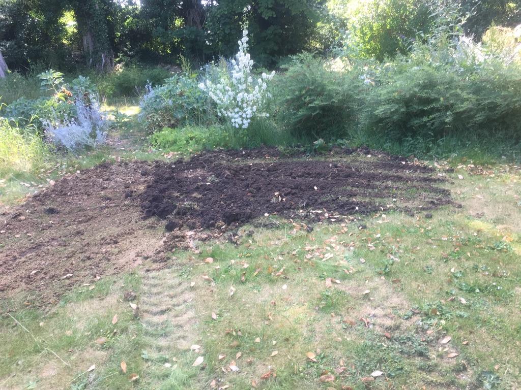

Temp Posted June 29, 2018 Posted June 29, 2018 You've got some nice looking young trees in the background, will you be able to keep them?
Cambs Posted June 29, 2018 Author Posted June 29, 2018 3 hours ago, Temp said: You've got some nice looking young trees in the background, will you be able to keep them? Some will actually end up in next door's garden - it's their side garden that we've bought, but we'll keep what we can
