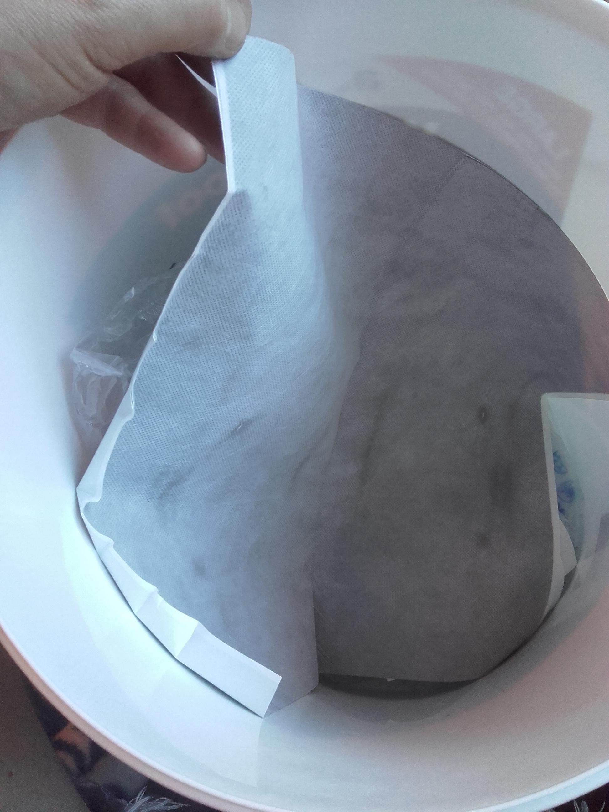

Figured I might as well ask some questions on the subject of tanking a wet room on it's own thread! Might assist someone else.
I have an Aquaseal Large Waterproof Tanking Kit. First off it comes with a "Waterproof Tanking Drain Mat", this:
It's about 400x400mm. It's meant to go under / around the shower waste. However, as I'm having a Geberit wall drain that has a membrane built in:
20180614_181948
20180614_182405
I was wondering if I could then use the now spare Drain Mat over the shower mixer?

I'm going to apply the strip to:
- the floor / wall junction
- floor to ceiling either side of the Notre
- over the mixer
2018-06-26_09-38-10
I'm not sure ref the pockets though? Do the internal AND external corners with strip?
As an aside on the pockets I'm still debating whether to put a slope of a few degrees on the bottom to aid water run off? If I do, how to do it? Some sort of packer to raise the back of the tile up maybe or a series of accurately cut wedges?
@Nickfromwales, in the link you cover the mixer with tape but there's a gap in the centre. Any reason why I cant just cut 3 accurate holes in mine and slip it on?
Use that adhesive you bought to fill the gaps and put a fillet on the shelves

Share on other sites
Not 45 degrees or the shampoo won't stay put :D
Just a couple of degrees will be ample. Water won't completely run off anyway as you'll have stuff on the shelves, so I wouldn't go mad.
+1 to packing first, then tanking. Make the ramp out of a solid bed of tile adhesive. Wait until it's 75% cures and then drag an engineers rule over it to 'scrape' it flat. Fill any dinks AFTER it dries and then tank.
Theres not much point in going crazy over the shower valve TBH, as you need access later down the road anyhoo.
When you tile around the shower valve it's better to keep the tile adhesive about an inch away from the cutout, and then go around the cement board with CT1 or Sikaflex. Start at 7 o'clock and apply a nice continuous fat bead up and over all the way around to 5 o'clock leaving a gap at 6 o'clock for a drip gap. That'll manage any water away from the opening, should some ever get in there.
Be very careful with the tanking strip, especially when overlapping from one to another, as you'll soon have created a high spot a good 4-5mm proud of the wall. Then you have to bring the rest of the wall out to that point so you don't get kickers. Butt them where there's no continuous water eg most of the walls, and only overlap on the floor to wall junctions and the floor to ceiling junction. All the walls / pockets you can butt and just tank the shit out of it ( over it ).
Remember that tanking alone is bombproof, and stretchy too, so the strip is only for junctions where dissimilar materials meet and you expect movement. On the walls and the pocket shelves you won't get any such movement so it's really not needed. Adding it for the sake of adding it can cause problems ( with high points ) not solve them ( as stated above ).

I need to get some more tanking strip if not another complete large tanking kit as I need to do around the bath and long pocket there. That pocket rear face is just mrpb. The bath deck and up to the pocket is 12 & 18mm marine ply.
I'm planning strip at the rear of the bath on the ply and up the mrpb wall. I'll tank that ply wall then to the height of the pocket.
Where the pocket is I'll put a strip from the ply bath deck up where it goes vertical - there's a black / white Sikaflex EBT seem at the junction you can just see. Then in the pocket a strip over the ply/mrpb interface. Then tank the lot and try and not get it on the bath!
Ref tanking...not being known for speed can I tank and then come back to tiling a bit later? This assuming I don't puncture the tanking in the meantime.
Just on this, you shouldn’t be relying on the tanking to stop water getting through - it’s the absolute last line of defence ! Tiles and grout are reasonably waterproof - just look at a swimming pool for example. A full bed of adhesive is also pretty watertight, so with tiles, grout and adhesive, any water getting through will be minuscule and the tanking is there to provide a final layer.
Be aware that the Aquaseal stuff doesn’t look like it’s fully covered but you put it on in two layers at right angles with a brush and it does work well. Don’t be tempted to put it on too thick or it will flex and the grout will move.
