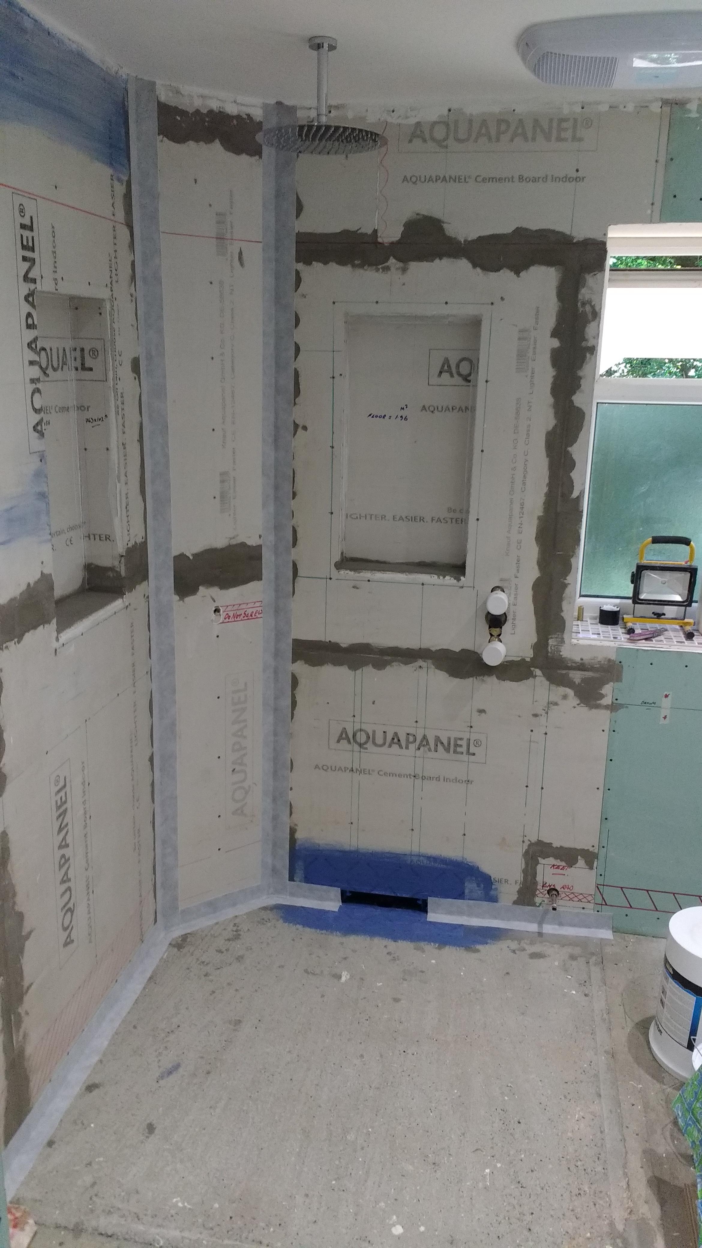

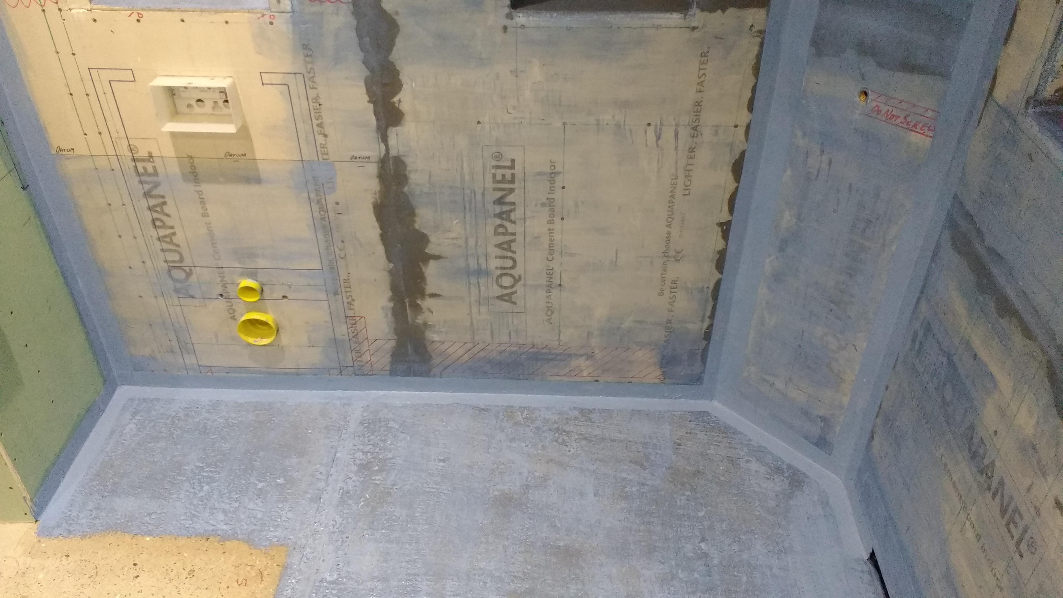

Can I "stop 'n start" with tanking?
I'm thinking, given the advice, to do the 1.3 x 1.3 floor area, pocket edges and filled joints with membrane. Then tape the wall to floor junction - that'll be +3m of the tape used up o/of 10m.
Option to tape the vertical joints either side of the mitre...I think I should?
 (Leaves me 7m of tape for round the bath).
I was thinking tape the joint between the flat (marine ply) deck the bath sits on, up the mrpb wall at the back and the ply on the long side:

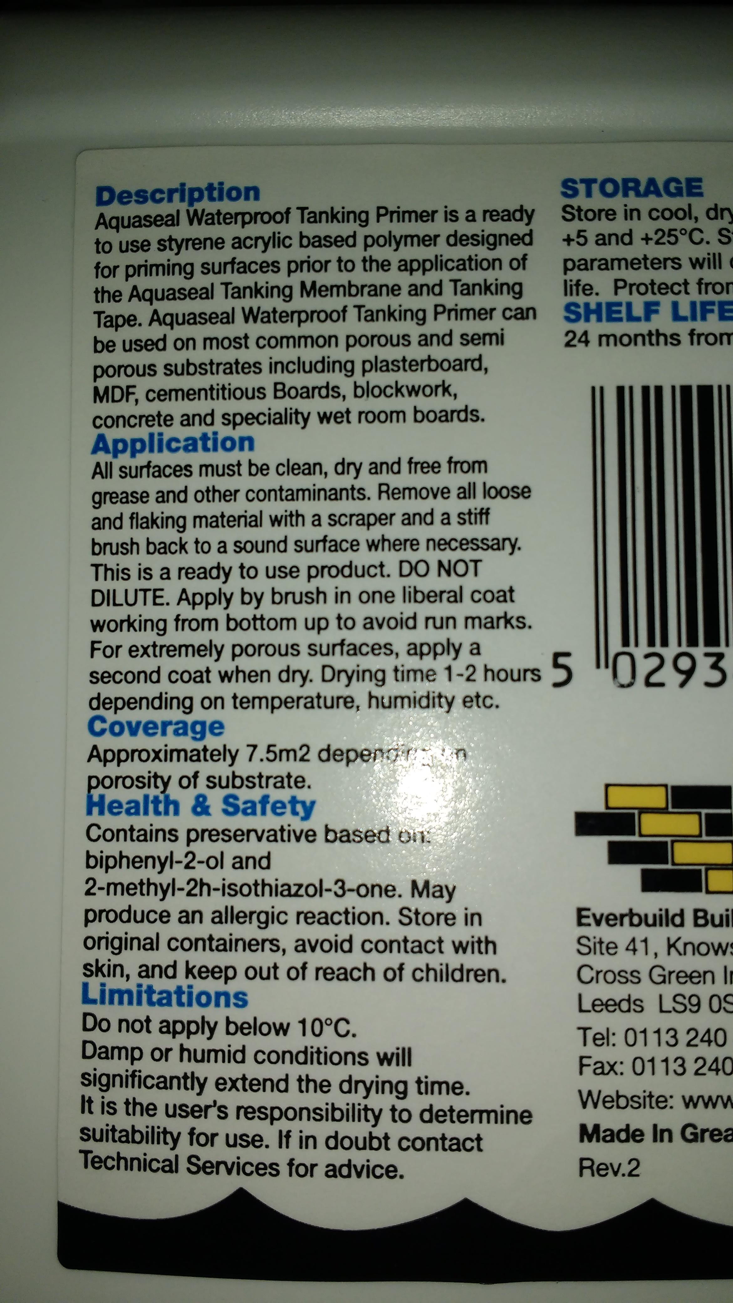

Says on the primer label that it can be used on "cementitious boards...and speciality wet room boards".
Does that not suggest ALL the Aqua Panel needs doing not just the joints?

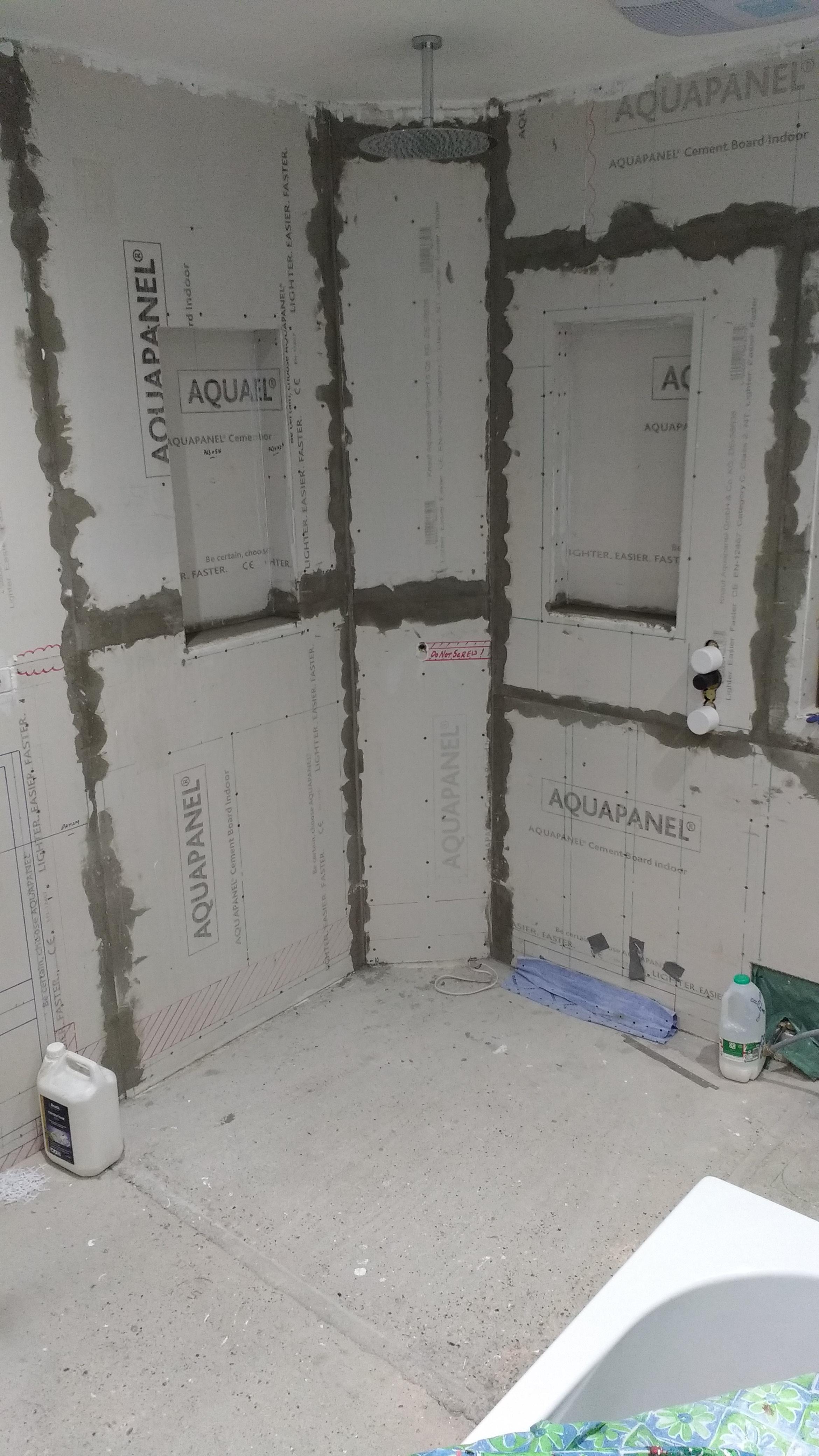

I was originally intending to, at a minimum, tank the wet room corner floor, nom 1.3 x 1.3 AND all the walls including the pockets above this area - roughly straight up in line with the SBR container on the left and milk container on the right:
As said before if I do that, the 7.5m sq. kit isn't really enough to do this which works out as below. I wonder if I could maybe do the higher section of the wall in SBR?
Wet room corner floor is 1.3x1.3 so 1.7m2
The mitred wall bit is 1m2
Each wing with the pocket in is 2.47x1.3 so 3.2m2 x 2 = 6.4m2
 Over 9m2 just there!
Edited by Onoff

& how the Hell is 1L of primer in the kit supposed to cover 7.5m2 it's just not possible?

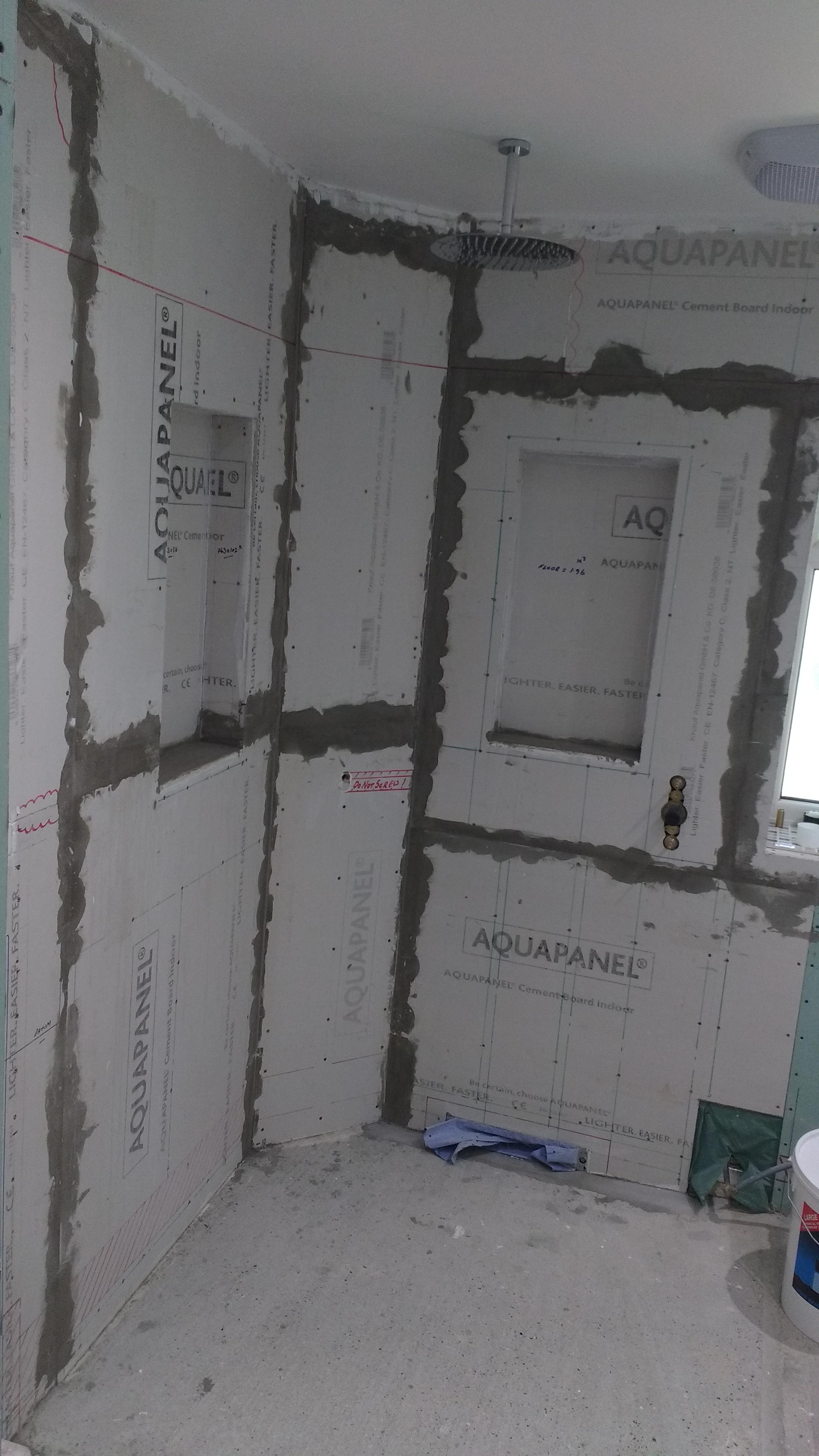

Posted

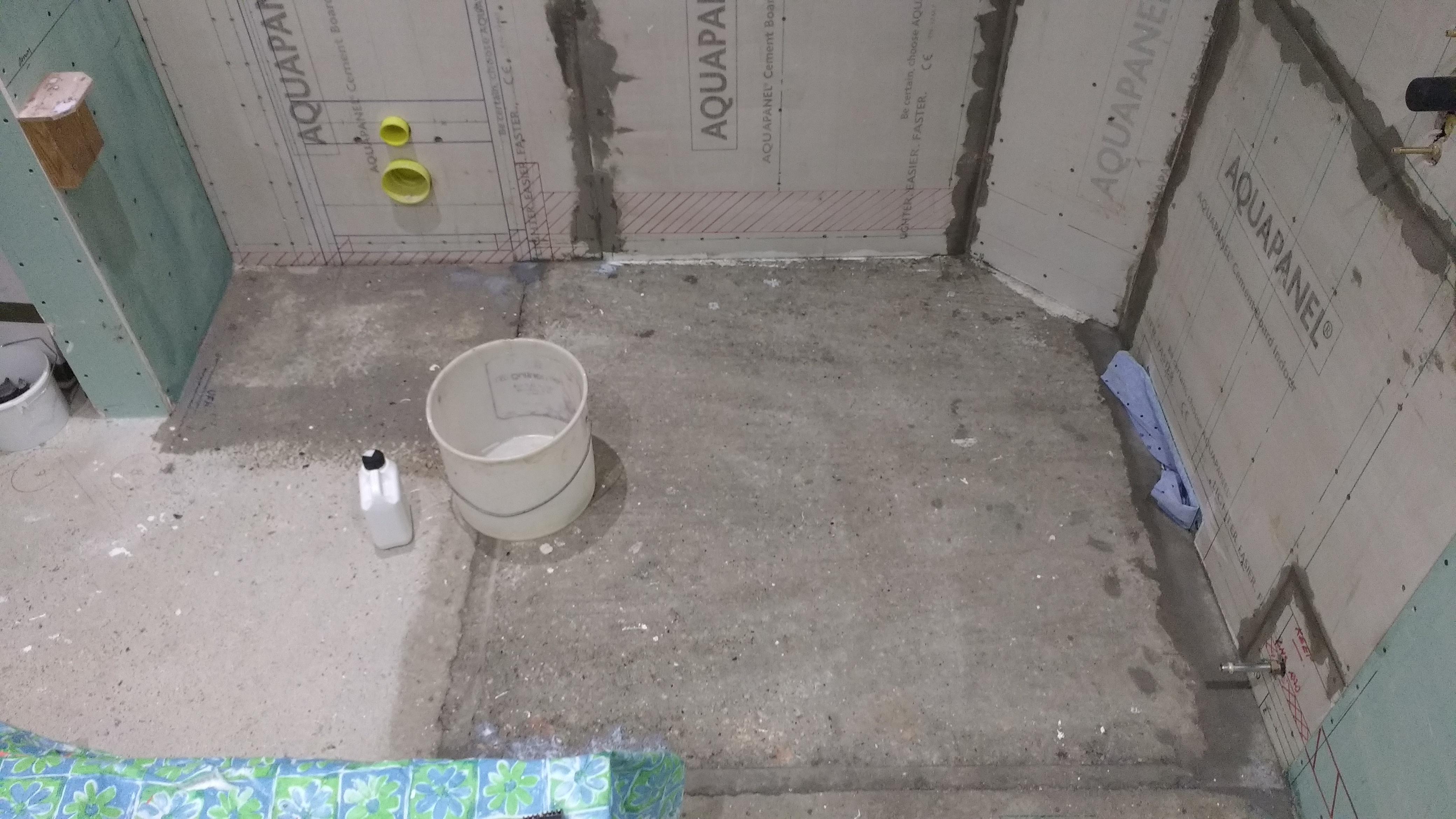

I've calculated that if I stop the tanking 2.1m up the wall (below the red line) I should have enough in the 7.5m sq kit to do all the walls pockets and floor area.
Just got to make sure this towel radiator loop is holding pressure and I can get that bit of board on round the pipe and tank!
Going to start from the red line and prime working down then onto the floor. Tbh if I run out I'm going to finish off with SBR before applying the membrane.
I've also ordered another 7.5m2 tanking kit for around the bath etc.

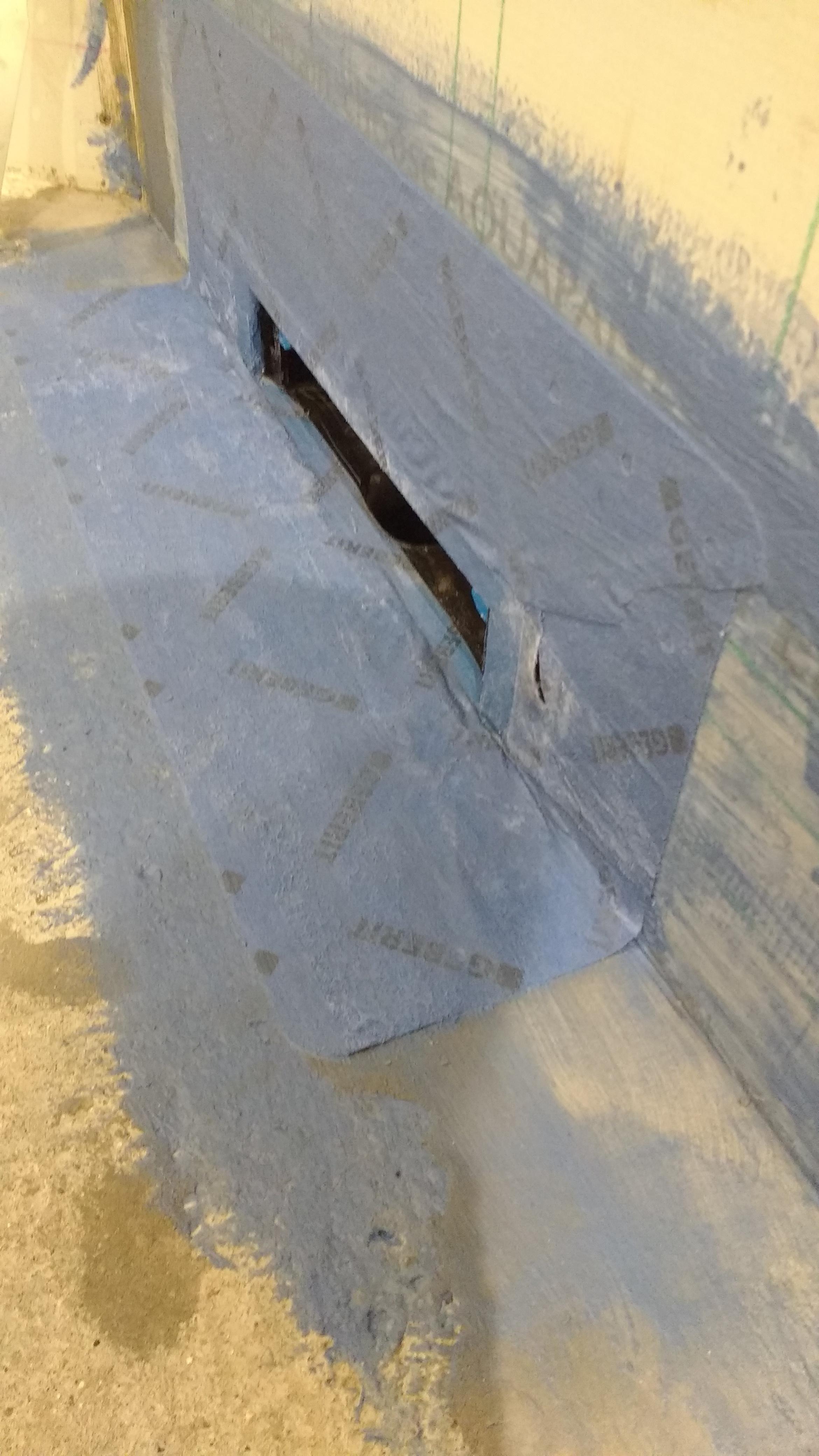

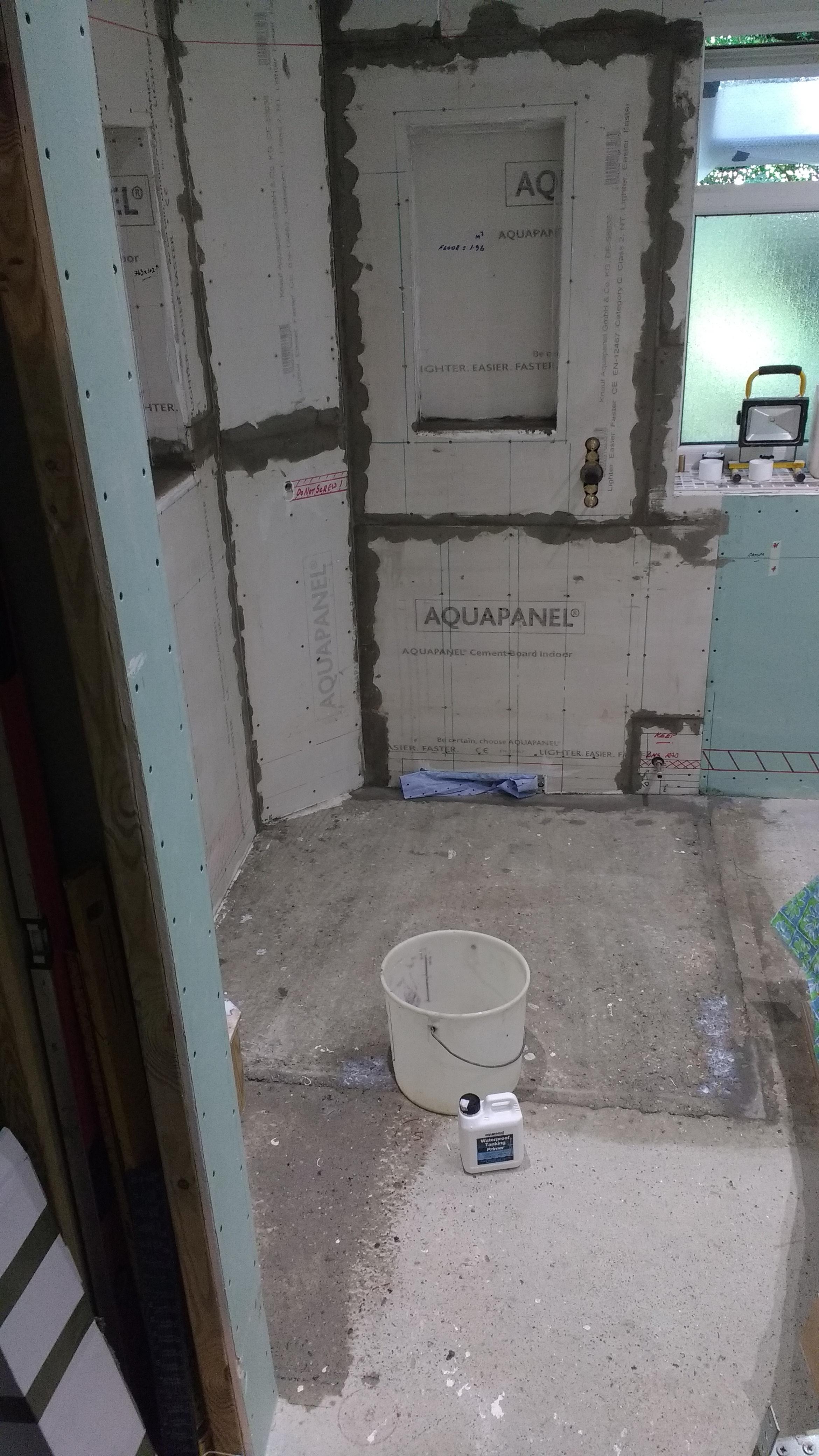

Posted (edited)
Turns out 1L of  Aquaseal Primer goes quite a way! In face quite a bit more than the 7.5m2 they say. Only needed one coat as the mrpb and Aquapanel aren't by nature overly porous. Even the DIY cast shower area concrete didn't take it in too much as it was laden with SBR when I mixed it.
So all primed inc the area under and behind the wc.

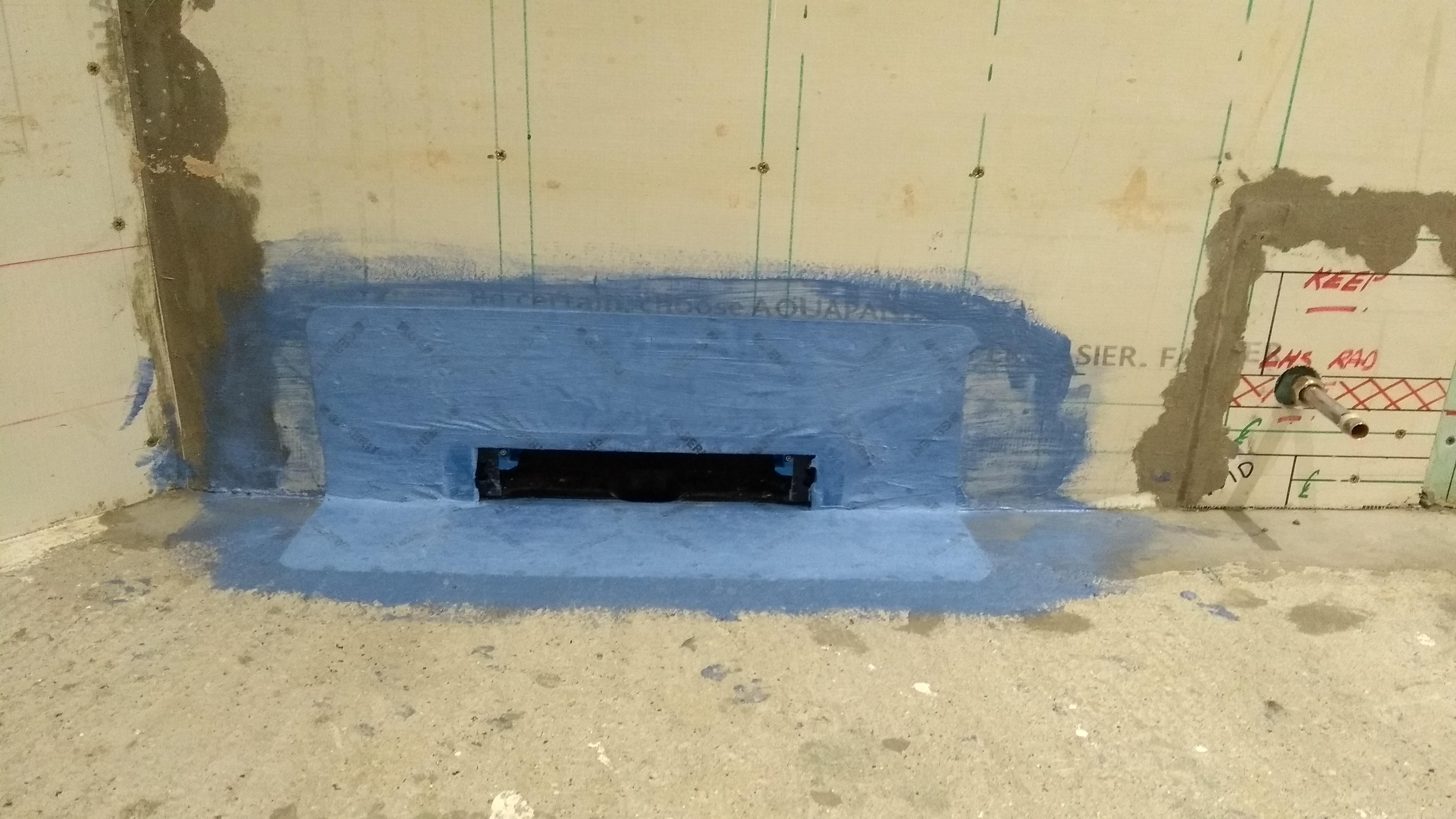

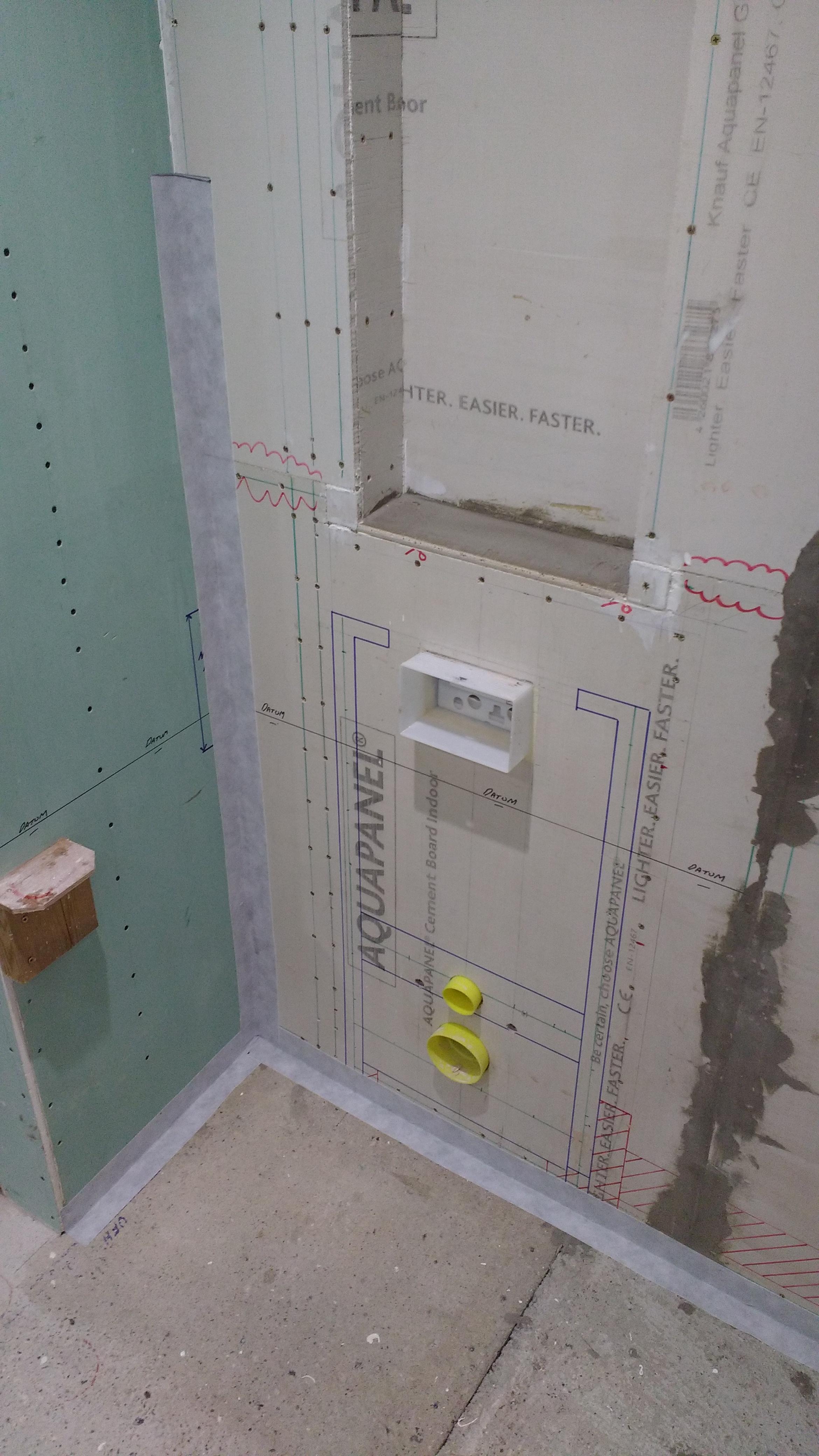

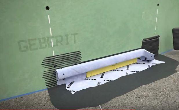

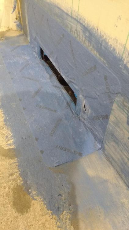

Then onto tanking EXCEPT I needed to incorporate the Geberit wall drain's own tanking "flaps" into it all. For this I've used the liquid tanking membrane as @Nickfromwales said.

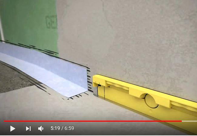

The video reckons the flaps fold out all nice and neat like in this still shot.

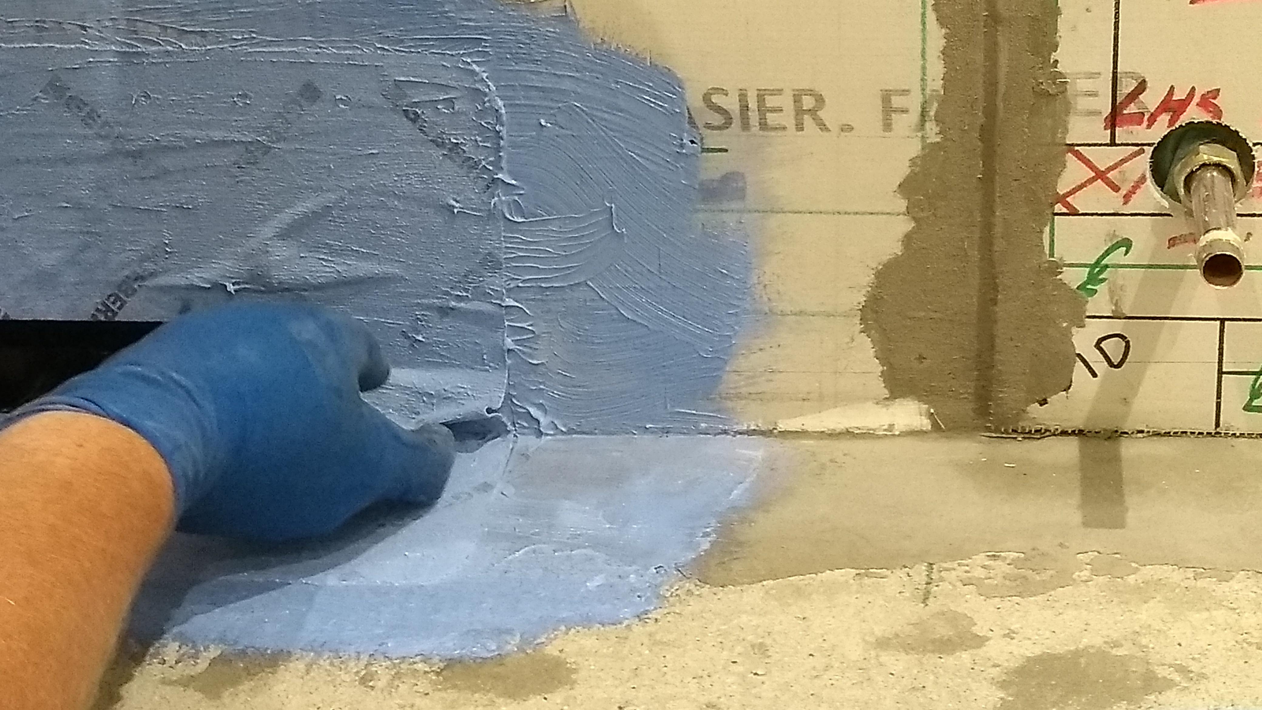

They also appear to bed it down on tile adhesive but the thought was this will be too thick. So with the kit's 3" brush I liberally applied liquid membrane behind where the flaps go and left to go tacky. Maybe should have left longer as a couple of bubbles that won't stick down for love nor money! Tbh not that bad really.
Mine were a bit rouched at the sides. I think maybe the drain is set a little lower than it should have been.
Only thing was to CUT the inbuilt membrane on the vertical face and overlap as best as.
The video shows the wall drain flaps (under the pink area) being overlapped by the tanking strip that goes at the wall/floor interface.
BUT I need to wait for the liquid membrane that beds the drain flaps to go off. Then I'll run the tap over that like in the still above.

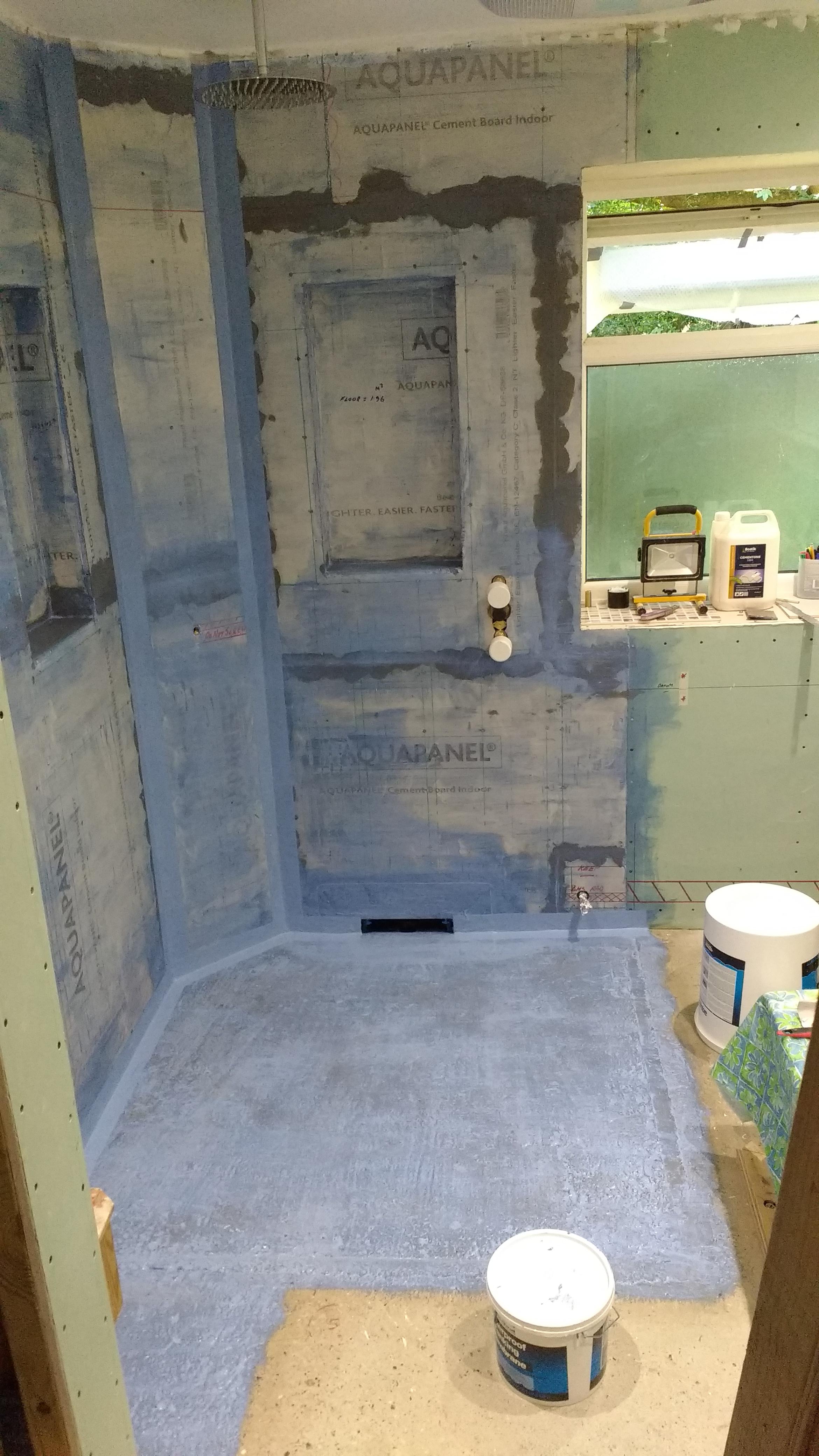

Looks like this now:
So I'm waiting! Will probably do the strips in the morning and put on the first main coat of tanking membrane (brushed horizontally) on the walls, pockets and floor. Might then go get my Larsen primer and adhesive and do the second tanking coat (brushed vertically( when I come back.

The Geberit wall drain area has dried off really well tbh, better than I thought. There's one bit where I cut it due to the rouching that I need to stick down. Was even thinking a dab of CT1 in that hole and push it down? You can see on the rhs where I had to (jagged) cut on the diagonal the stuff due to the rouching. It's tough as old boots and a pig to cut! The top bit laps over the bottom bit of course.

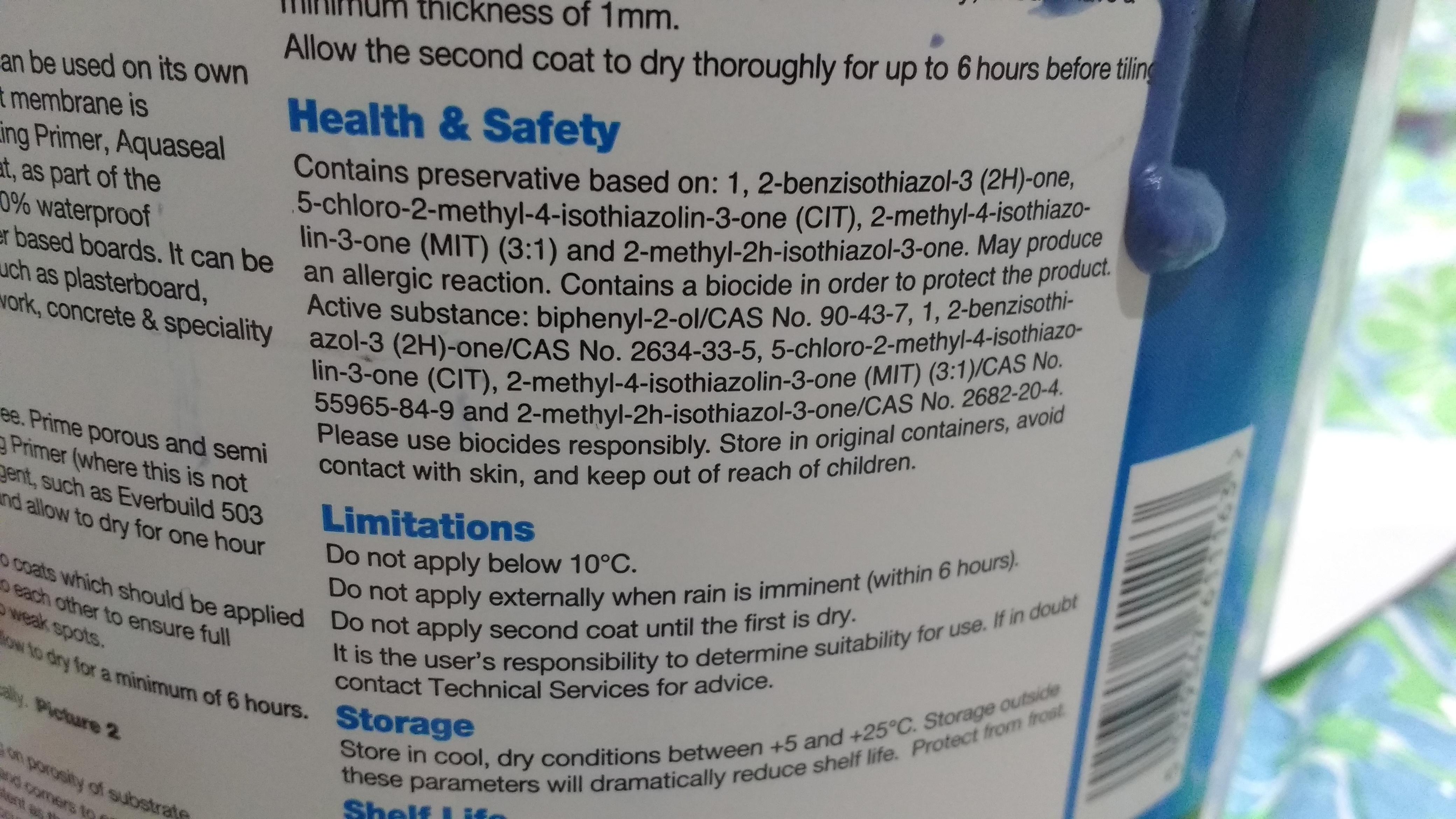

A random thought but using the tanking membrane I recognised the smell. It's I think identical to Febond Blue Grit I'm sure (aside from the grit). I got the Blue Grit for my plastering attempt. Tried it and then decided not to use it (despite much advice not to even bother :ph34r: ). Skimming the labels and looks pretty much the same to me.
Aquaseal Tanking Membrane:
Febond Blue Grit:
Guessing I could have saved myself a few quid on the second kit by priming the area with SBR then after letting dry used the Blue Grit? Of course I'd have still needed more Aquaseal Tape.
Posted
It just tells you the preservative is the same - not the contents of the container !!
Mixing parts of a system and changing components without understanding the underlying chemistry is a really bad idea...
  • Like 1
Posted
Ta. So is all that ingredient list just for the biocide?

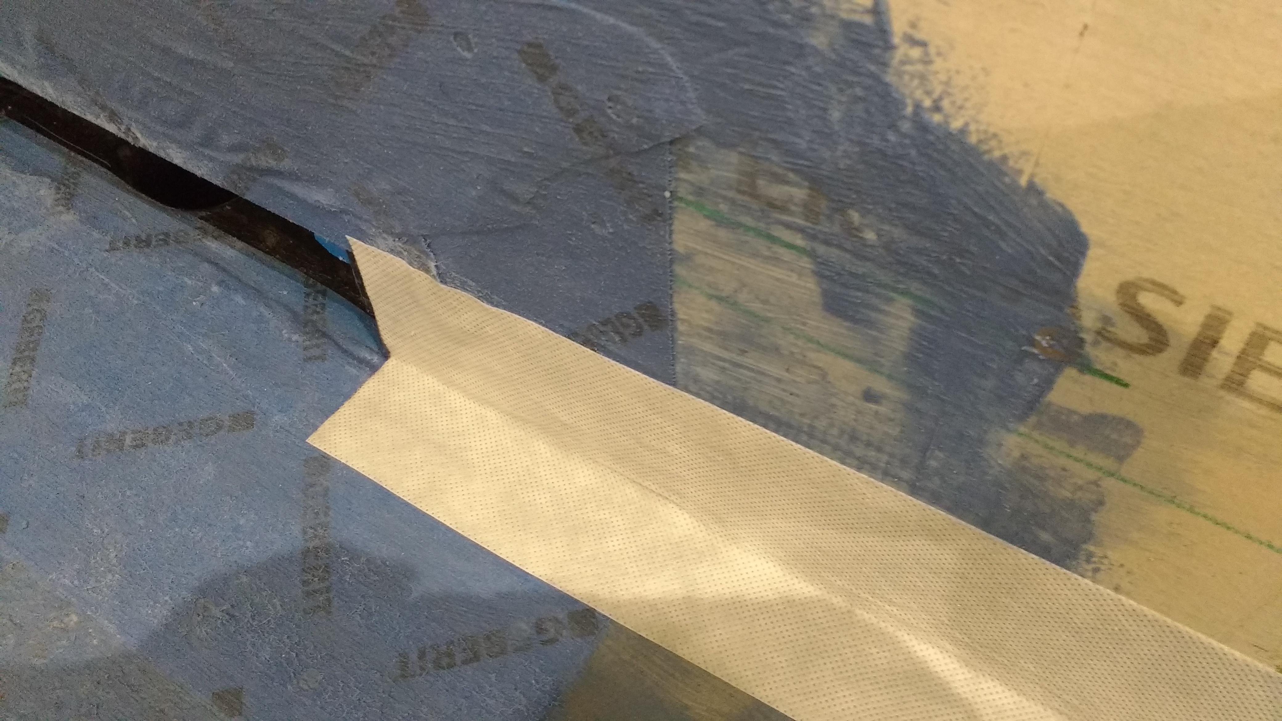

I would seal that slit and then loads of tanking over the top.
I found it dried quickly (it was during that really hot spell) - so with the three areas I was doing I could just keep going until I run out of the tanking fluid.
Posted
That's 10m of tape used! Did round the WC too.
The tape pretty much covered that nick so I'll just load with membrane over the top.

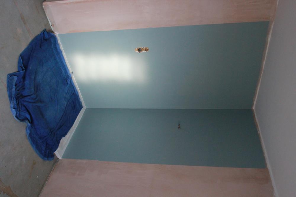

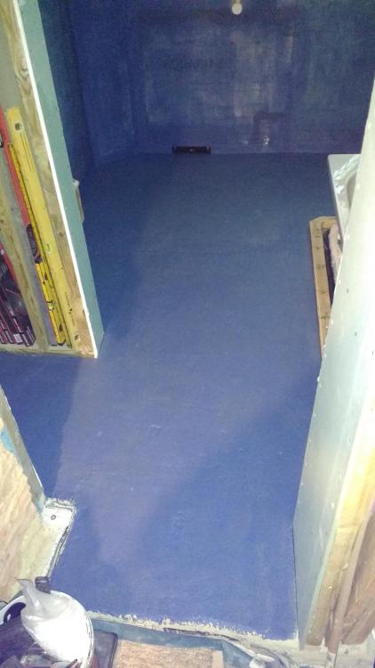

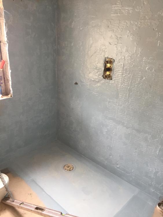

Posted (edited)

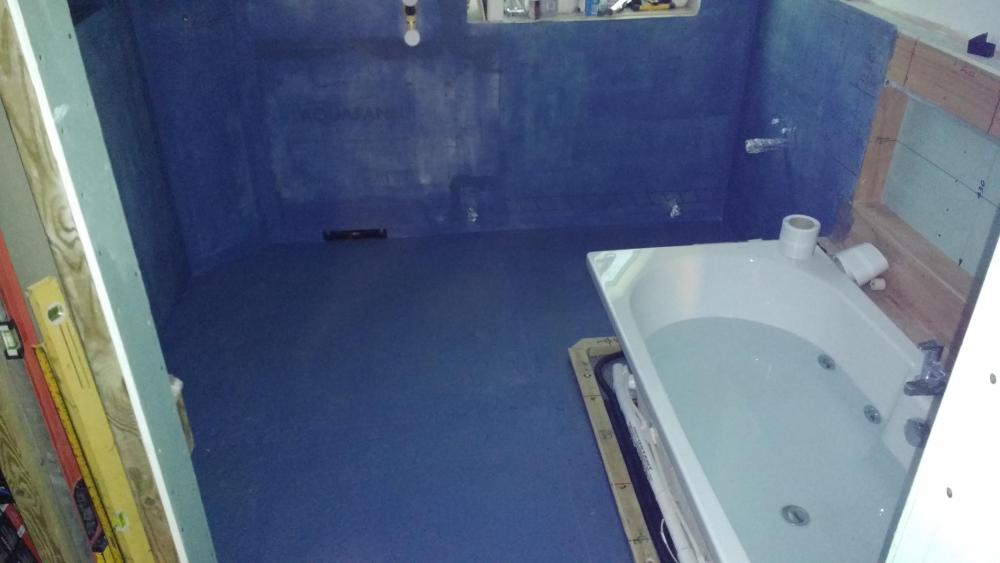

Tanking the Aquapanel is weird...like the membrane isn't keen to "cover". Takes a second coat to get it looking 'bluer". The Geberit flaps and Aquapanel tape suck up the membrane and look much bluer though.
Used half the tanking membrane. First coat. Darker patches where I've gone over it again. Genuinely done ceiling to floor. Wonder if I need some more applied higher up, especially over those jointed areas?
I've not gone all the way up the wall behind the WC...figured my aim isn't that bad! Besides, with age I find the velocity isn't what it was... :)
Edited by Onoff

Posted
1 hour ago, PeterW said:
Have you not tanked the ceiling..?? Should really do the ceiling - and the back of the door ....
Seriously though does it look alright?
Posted
I'd have chosen a different colour but that's down to personal preference I guess.
keep slapping it on.
  • Haha 1
